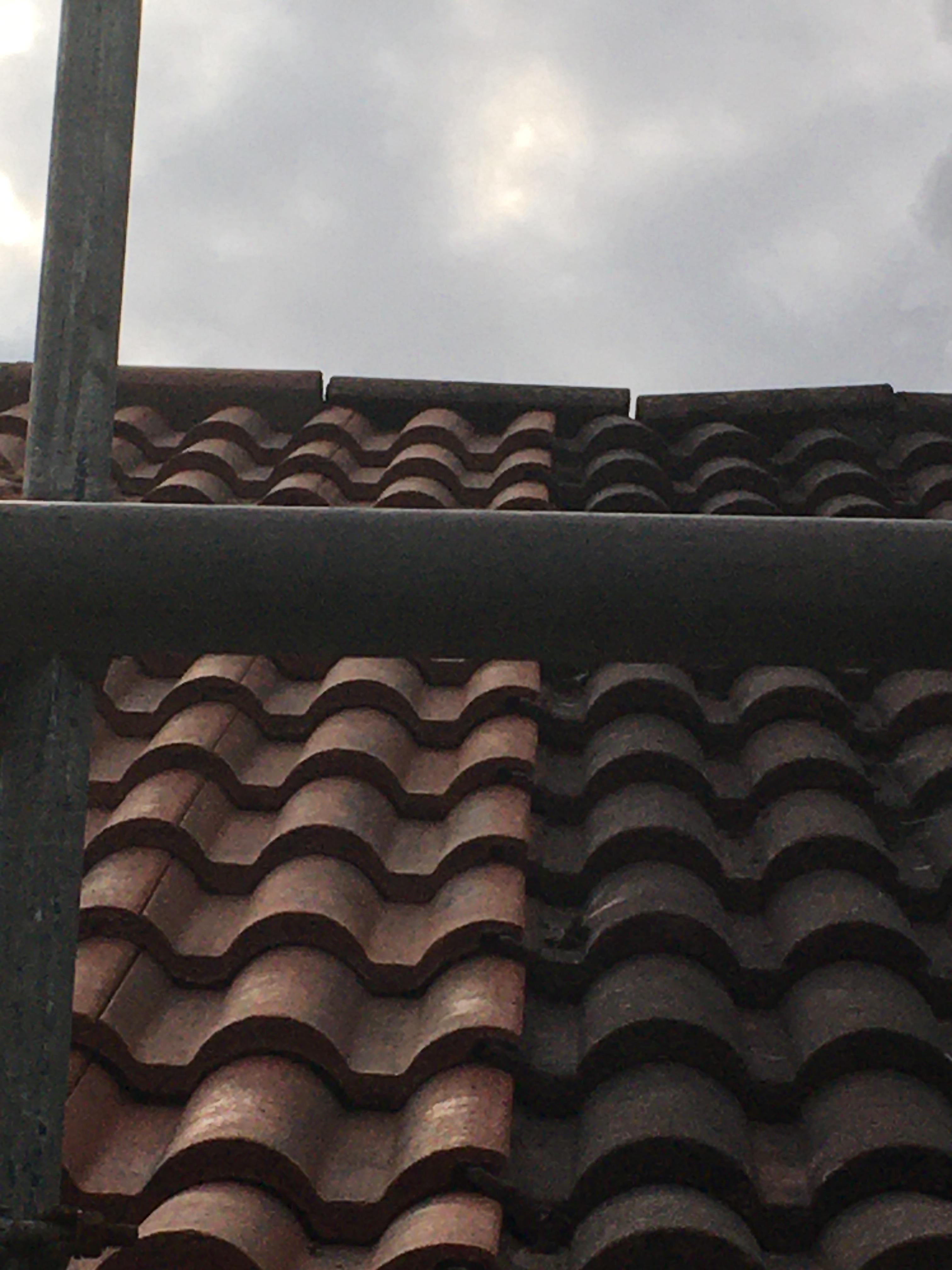

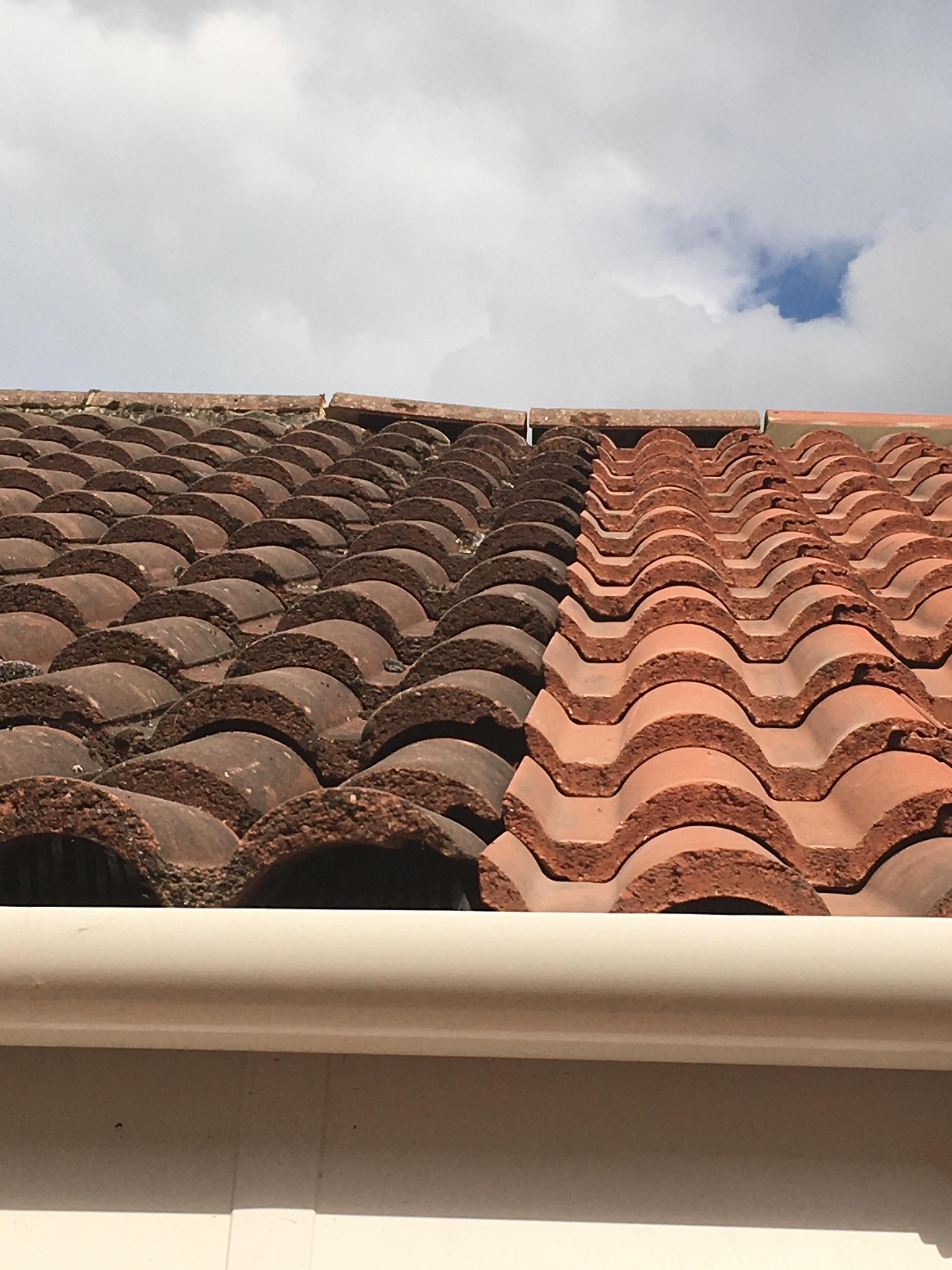

Vaders brother Posted August 2, 2020 Posted August 2, 2020 I’m near the end of an extension project and the tilers came in yesterday. They should be coming back Monday to finish eg to fix the loose ridge tiles in the pics below and do the mortaring in at the fascia. But what have they done in the first picture? They have cut the left side of the tile and butted up against the existing tiles, where I would expect them to be interlocked or under the existing tiles. The other side of the roof is fine where the tiles are laid over the existing tiles. Yes they sit a bit high but will do their job and gradually weather and darken over time. The tiles were hard to source and are not exact matches, but pretty close. We had to wait about 6 weeks for delivery due to the existing problems with the pandemic but I do feel a bit frustrated as I don’t understand why the tiles are laid like this and nothing was said on the day. Can anyone throw any light on this for me before I catch up with the tilers tomorrow? Many thanks in anticipation.

ProDave Posted August 2, 2020 Posted August 2, 2020 Second picture is just plain WRONG. The only thing stopping that leaking is the under felt.
JFDIY Posted August 2, 2020 Posted August 2, 2020 Only way to salvage that is a joining strip to provide a proper drainage route, gate to say it but only places you'll see them is where they re-roof a semi-detached and leave the neighbours original, see it a lot on local authority housing where the privately owned one next to it isn't done at the same time.
Declan52 Posted August 2, 2020 Posted August 2, 2020 All it might have needed was the tongue on the left hand side of the new tile grinded down 20mm+ to allow it to slide under the old tile. Then start at the join and work to the right. Either they come up or your going to end up with something like a 300mm wide strip of lead down the roof in lengths to suit 3/4 tiles with enough tucked under the top tile each time to hold it in place. Will not be the nicest looking but will keep the rain out. What you have now won't keep anything out. 1
Temp Posted August 2, 2020 Posted August 2, 2020 +1 They really must fix that. May have to move the whole lot left a bit so they go under the old ones like you say they do on the other pitch.
wozza Posted August 2, 2020 Posted August 2, 2020 It looks like you have 2 different brands of tiles, that is a terrible bodge that is not fit for purpose - the join is not water tight so you will be relying on the felt / membrane to keep water out. Marley Bold Roll, Redland Regent and Sandtoft (not sure on the tile name) all look very similar but do not lock in together correctly - they are all slightly different. They look the similar to mine - I have Marley Bold Roll on one roof and and Redland Regent on another. Marley stopped making Bold roll a while back so you cannot buy new ones, so we chose Redland. (Marley Bold Roll are available from a lot of reclamation yards but are silly money. The quickest fix for your issue would be a bonding gutter, but I would want it done correctly if it were my roof.
Hobbiniho Posted August 3, 2020 Posted August 3, 2020 would it be possible that you could cover 1 elevation with the old tiles and tile the other with all new tiles or is there not enough old tiles? i have worked on a couple of roofs like this, also has the added benefit that the elevation that is seen from the road had all old tiles so couldnt tell there was an extension, you might also have a few old tiles left over for future repairs. As declan said they would probably fit with a small amound ground off, what they have done is absolutely shocking really
PeterW Posted August 3, 2020 Posted August 3, 2020 It’s wrong. Wouldn’t pay until it’s lapped correctly and I’m pretty sure building control won’t sign that off anyway as it will leak.
Timedout Posted August 3, 2020 Posted August 3, 2020 Who bought the new tiles? Did the roofer supply them or did the client source them? If the client bought them and said, “fit these tiles” then the client is responsible. If the roofer supplied the tiles then the roofer is responsible. The client can’t expect the roofer to do the impossible or price for the variation of trying make mismatched tiles fit together. it would have been reason to expect a skilled roofer to point out that this was not going to work before the job was done.
makie Posted August 3, 2020 Posted August 3, 2020 (edited) This will be fine as long as they have made a secret gutter under the tiles. This can be done with either lead or GRP Edited August 3, 2020 by makie
