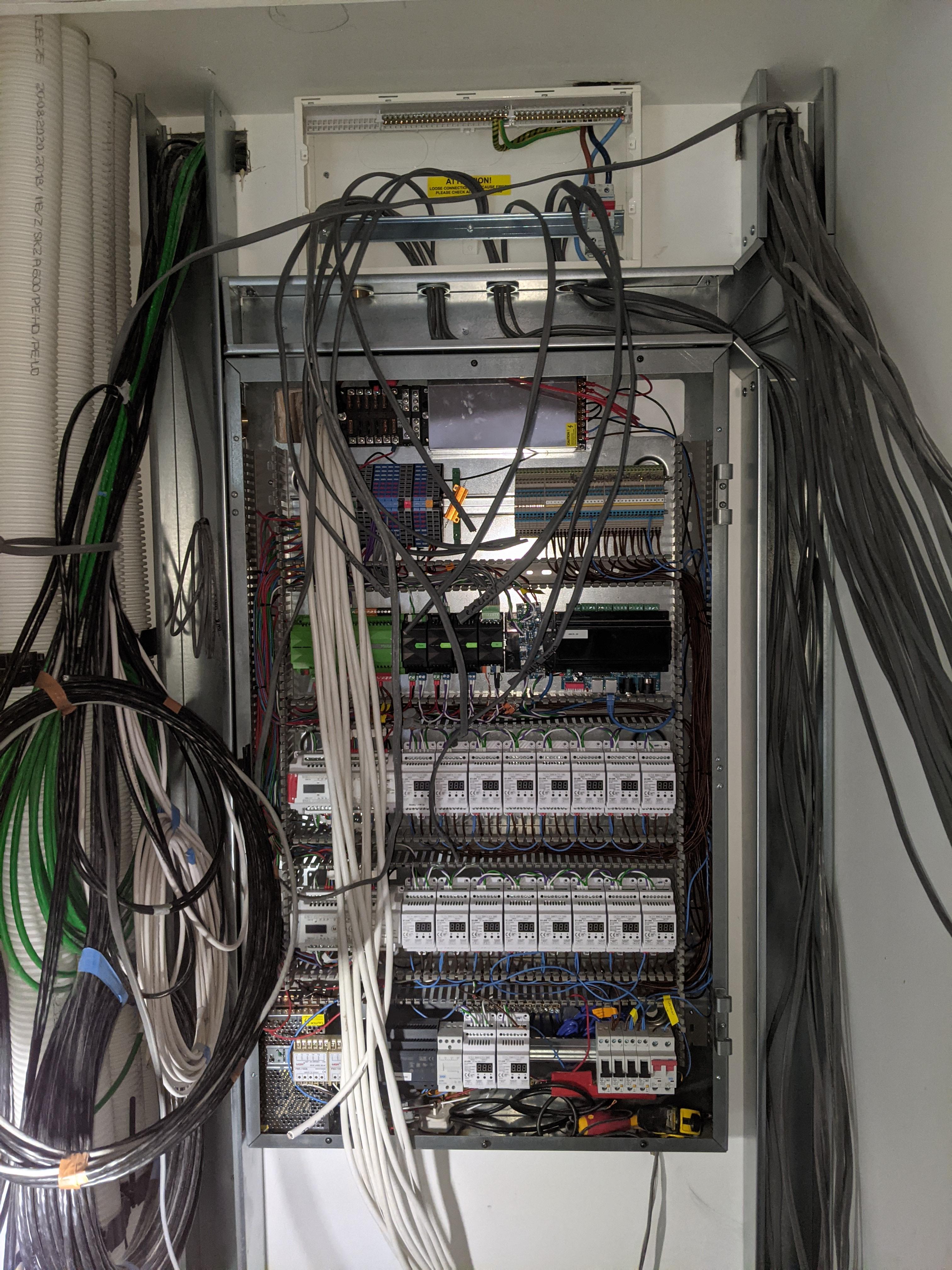

joth Posted December 10, 2020 Author Share Posted December 10, 2020 Exciting step forward today - LXN5 panel is on the wall. I start my Christmas "holidays" tomorrow, may the extensive termination festivities begin!! 2 Link to comment Share on other sites More sharing options...

Dan F Posted December 15, 2020 Share Posted December 15, 2020 On 10/12/2020 at 13:37, joth said: LXN5 panel is on the wall. Any idea if there are any requirements regarding how high the panel has to be off the floor (particuarly when there is mains/RCBO's on the bottom rail) for building regs? Or does @Rob99 know? While we still plan to use DALI, if I use central RGBW extensions for lots of LED strips and central relays for blinds/UFH too then the cabinet fills up very quickly. While everything would probably just about fit in a LXN5 cabinet there would be no room for expansion, let alone to give an audioserver a go. Looks like either need to: - Potentially get a larger cabinet - Use two cabinets; one for lighting/relays and another one for low-voltage and audio. - Move to the more distbributed approach I considered initially. i) Use nano tree relays around the house for blind control. ii) use RGBW tree compact or DALI RGBW drivers around the house. Link to comment Share on other sites More sharing options...
TonyT Posted December 15, 2020 Share Posted December 15, 2020 Look up part M of the building regs i emailed my building control dept as I wanted the switches in my extension to be the same as the old part of the house. different heights from non compliant to compliant - they were quite relaxed about it, so may be worth an email Link to comment Share on other sites More sharing options...
Rob99 Posted December 15, 2020 Share Posted December 15, 2020 There are regs on height of consumer unit MCBs/RCBOs which from memory I think is 1350-1450 from floor level. Providing your control cabinet is fed from RCBO's in the consumer unit then local RCBOs in your cabinet can be at any height. 1 Link to comment Share on other sites More sharing options...
joth Posted December 16, 2020 Author Share Posted December 16, 2020 (edited) Yeah as you can see in the photo above our new consumer unit is smack bang up against the ceiling. Renovation so that's ok. Originally I wanted to put all the rcbos in the loxone panel (hence why I shelled out for the 18th ed compliant LXN panel) but our contractor's electrician preferred to keep the rest of the electrics out of it and as I'm DIYing the loxone install I was fine keeping life easy as I can for him on the rest of the job. Should have another update soon, been a busy few days swapping in the final dimmer configuration based on final lighting design Edited December 16, 2020 by joth 1 Link to comment Share on other sites More sharing options...

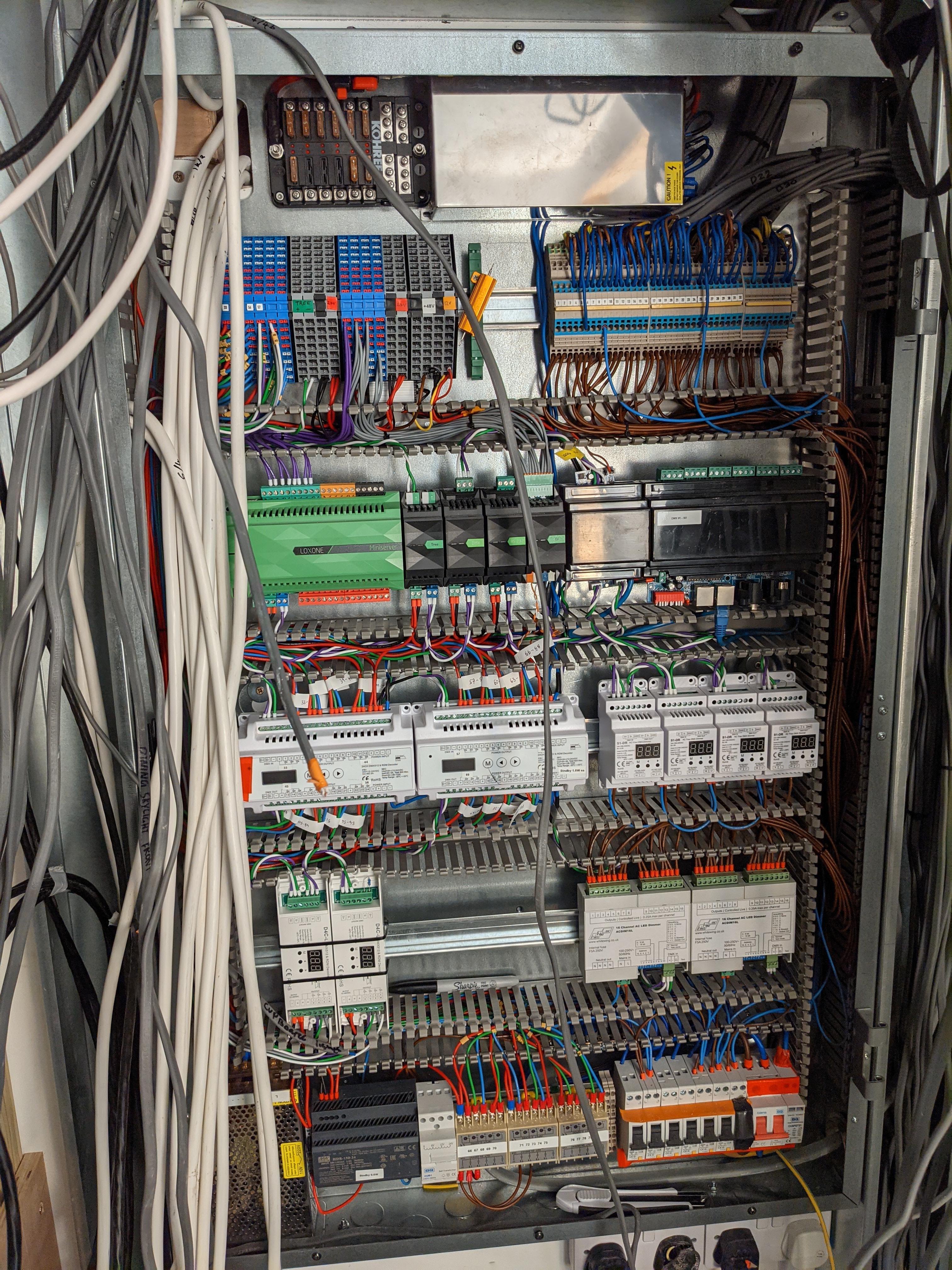

joth Posted December 22, 2020 Author Share Posted December 22, 2020 Milestone reached today: all the Mains dimming circuits are terminated to the panel. Slight frustration of the Weidmuller terminal blocks is the Live core is hidden under the neutral wire, so if you have a few circuits not yet terminated at the fixture end it's tricky to make them safe on the panel. In theory the spring clips should make it easy to disconnect unused cores. The WhiteWorks dimmers are very nice. The built in test modes very handy indeed. 3 Link to comment Share on other sites More sharing options...
Rob99 Posted December 24, 2020 Share Posted December 24, 2020 Looking good Joth ?? 1 Link to comment Share on other sites More sharing options...

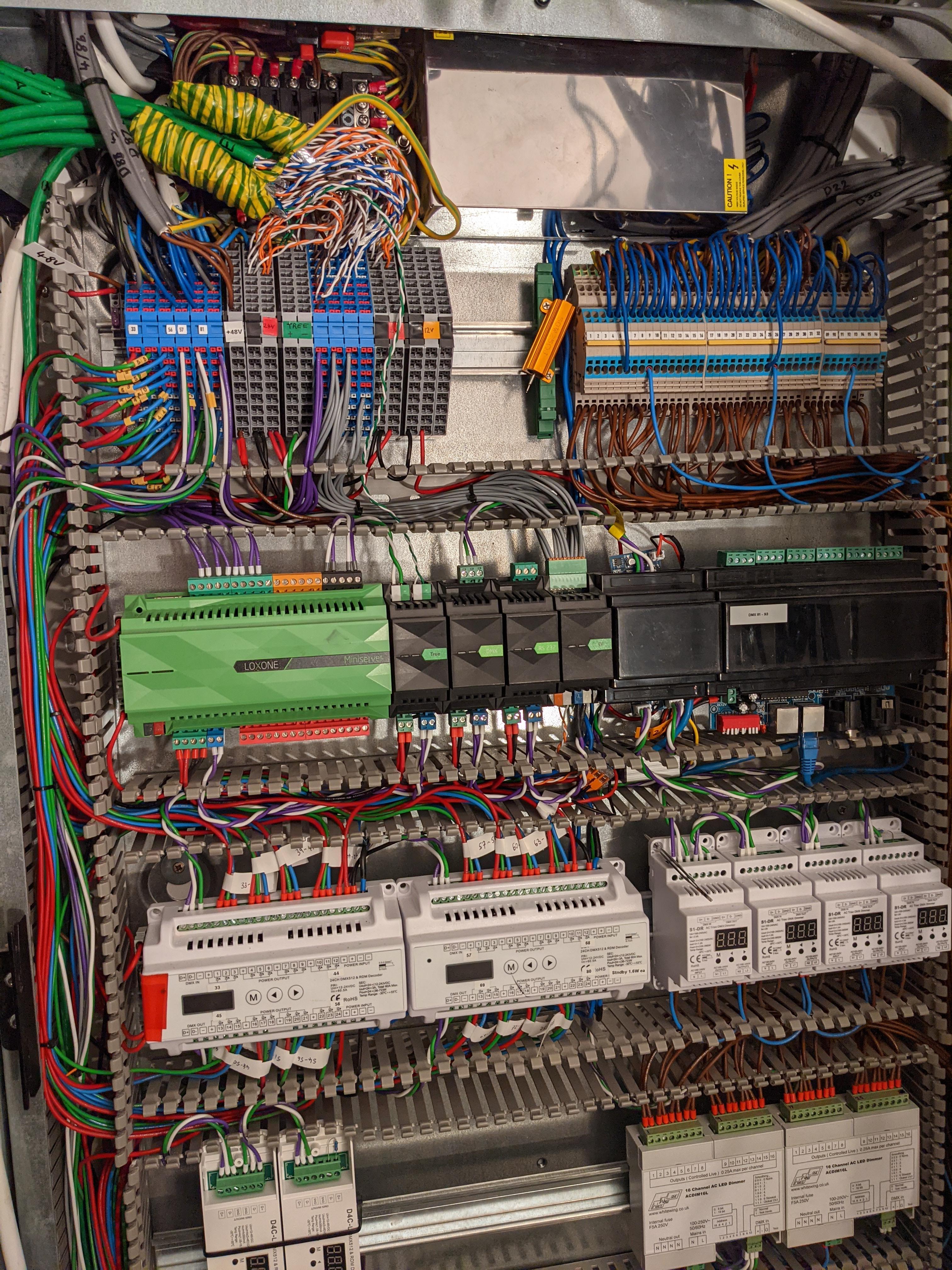

joth Posted December 28, 2020 Author Share Posted December 28, 2020 Couple more hours and I've got most of the low voltage runs terminated - top left corner. This is 24V LED strips, constant current fixtures and all the light switches and motion sensors. As I have used U/FTP CAT6A I have a lot of spare cores on each sensor run (max 3 devices per run). I also have to earth the shielding. For now I just bundled up all the spare cores and the drain wire and wrapped some copper earthing around it. Not very pretty but it does the job. Interested how others manage this (if you've used screened CAT cable). Pictures invited! 4 Link to comment Share on other sites More sharing options...

ProDave Posted December 28, 2020 Share Posted December 28, 2020 That's very neat, I would have been happy for that as the control cabinet for a small machine. Just make sure you document it all or the next owner will not be speaking highly of you. Link to comment Share on other sites More sharing options...
