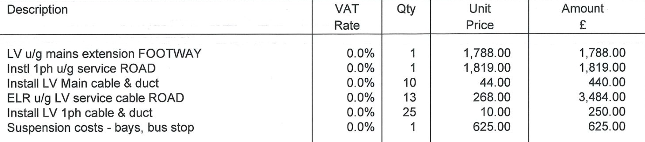

Dreadnaught Posted July 19, 2020 Share Posted July 19, 2020 For electricity, my quotation from UKPN was as follows (in mid 2019): For complicated reasons, which I won't bore you with, I got a refund so only ended up paying £4,682. 1 Link to comment Share on other sites More sharing options...
