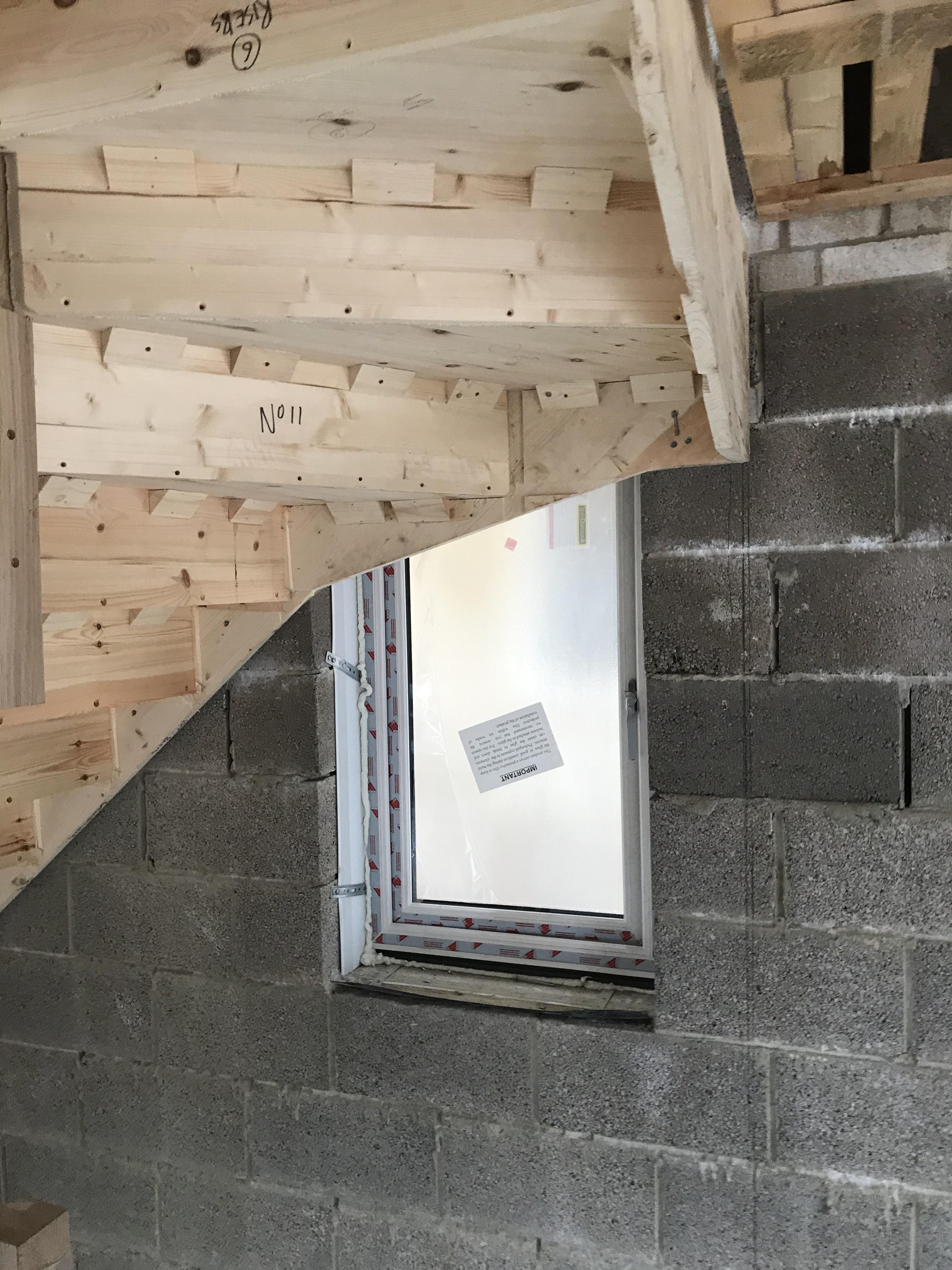

nod Posted July 16, 2020 Share Posted July 16, 2020 Just started Framing on a new site today The first nine have see design error Link to comment Share on other sites More sharing options...

Reiver Posted July 16, 2020 Share Posted July 16, 2020 Ooops! ....how did they miss that on the drawings - I thought using CAD was meant to show up stuff like that. May I ask what remedy (if any) is going to be applied? Link to comment Share on other sites More sharing options...
the_r_sole Posted July 16, 2020 Share Posted July 16, 2020 (edited) Hah! Have seen this happen before, the danger of only giving a brickie the plan drawing and not the elevation for the window on a stair turn/landing... Edited July 16, 2020 by the_r_sole Link to comment Share on other sites More sharing options...
Mr Punter Posted July 16, 2020 Share Posted July 16, 2020 I like that they just fitted the stairs anyway. Link to comment Share on other sites More sharing options...

nod Posted July 16, 2020 Author Share Posted July 16, 2020 It does happen But nine Site manager said do your magic ? Link to comment Share on other sites More sharing options...
nod Posted July 16, 2020 Author Share Posted July 16, 2020 It’s not like it’s spoiling the view 1 Link to comment Share on other sites More sharing options...
dpmiller Posted July 16, 2020 Share Posted July 16, 2020 was it actually meant to be above- or below- and if below is it just an understair or an open room? Link to comment Share on other sites More sharing options...
the_r_sole Posted July 16, 2020 Share Posted July 16, 2020 That's some turd you have to polish ? Link to comment Share on other sites More sharing options...
JFDIY Posted July 16, 2020 Share Posted July 16, 2020 Board it over and pretend it never happened... Link to comment Share on other sites More sharing options...
Bitpipe Posted July 16, 2020 Share Posted July 16, 2020 'Feature window'. Link to comment Share on other sites More sharing options...
Declan52 Posted July 16, 2020 Share Posted July 16, 2020 Putting up a set of curtains on that window will be a bit challenging. Link to comment Share on other sites More sharing options...

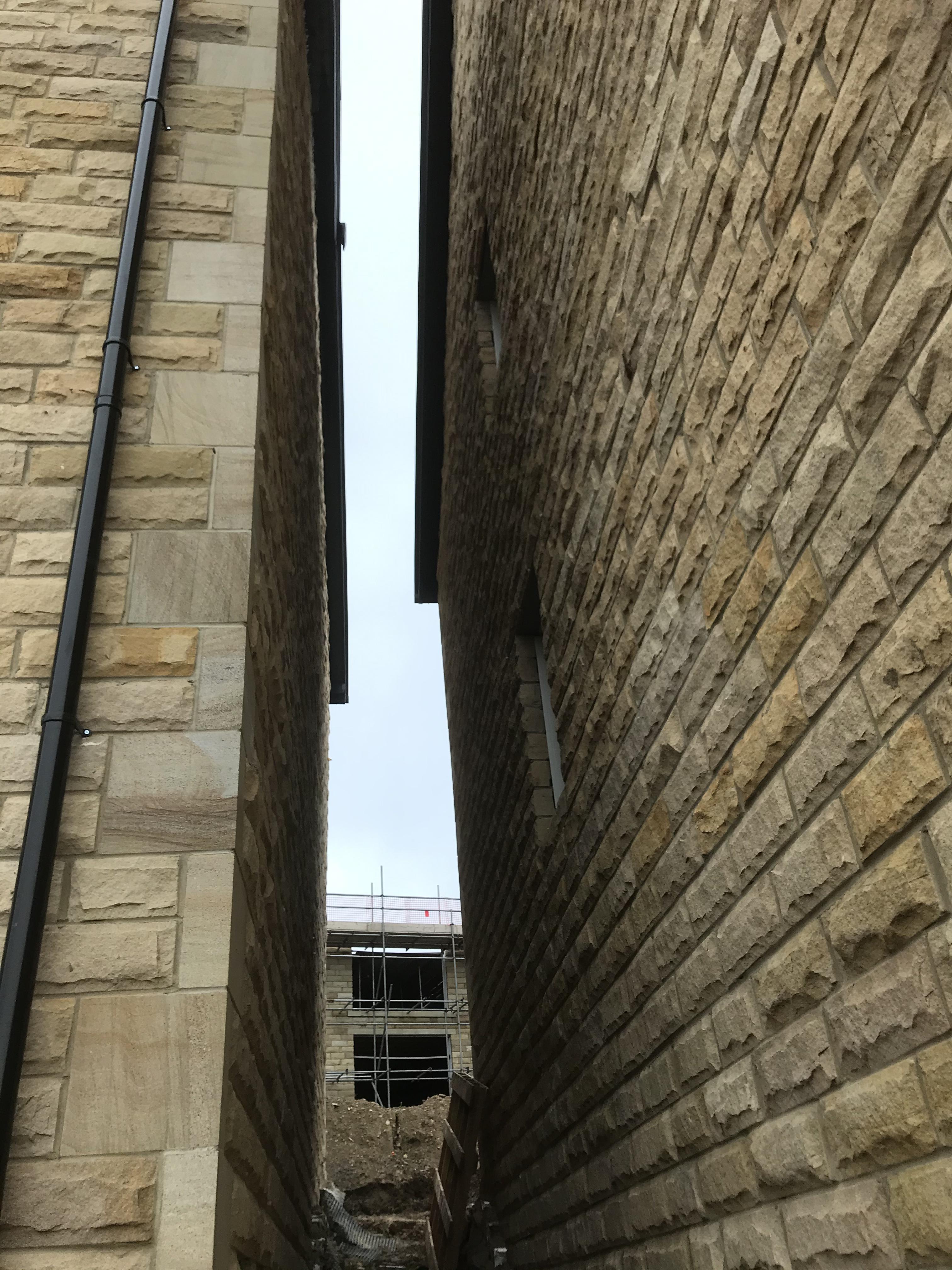

DevilDamo Posted July 17, 2020 Share Posted July 17, 2020 What is the point or purpose of the window? Wouldn’t it have been better to just not have it? Link to comment Share on other sites More sharing options...
Temp Posted July 17, 2020 Share Posted July 17, 2020 3 hours ago, DevilDamo said: What is the point or purpose of the window? Wouldn’t it have been better to just not have See the post by @the_r_sole The thinking is they only intended the window on the landing/first floor. Link to comment Share on other sites More sharing options...
DevilDamo Posted July 17, 2020 Share Posted July 17, 2020 2 hours ago, Temp said: See the post by @the_r_sole The thinking is they only intended the window on the landing/first floor. But it’s obscured glazed and is in very close proximity to the neighbouring flank wall so offers little, if any light!?! Just seems a little pointless. Link to comment Share on other sites More sharing options...
ProDave Posted July 18, 2020 Share Posted July 18, 2020 16 hours ago, DevilDamo said: But it’s obscured glazed and is in very close proximity to the neighbouring flank wall so offers little, if any light!?! Just seems a little pointless. It would have to be a fireproof window wouldn't it being that close to the neighbour? Link to comment Share on other sites More sharing options...
DevilDamo Posted July 18, 2020 Share Posted July 18, 2020 It would depend on where the boundary line is. If the access shown belongs to the house on the right, then it looks like the neighbouring house is 1m away!?! If so, you can generally have as many windows and openings as you like (under BR’s of course). Any window within 1m would need to be made fire resisting and have no openings so permanently fixed shut. Although those latter requirements may have already been set by Planning anyway. Link to comment Share on other sites More sharing options...
