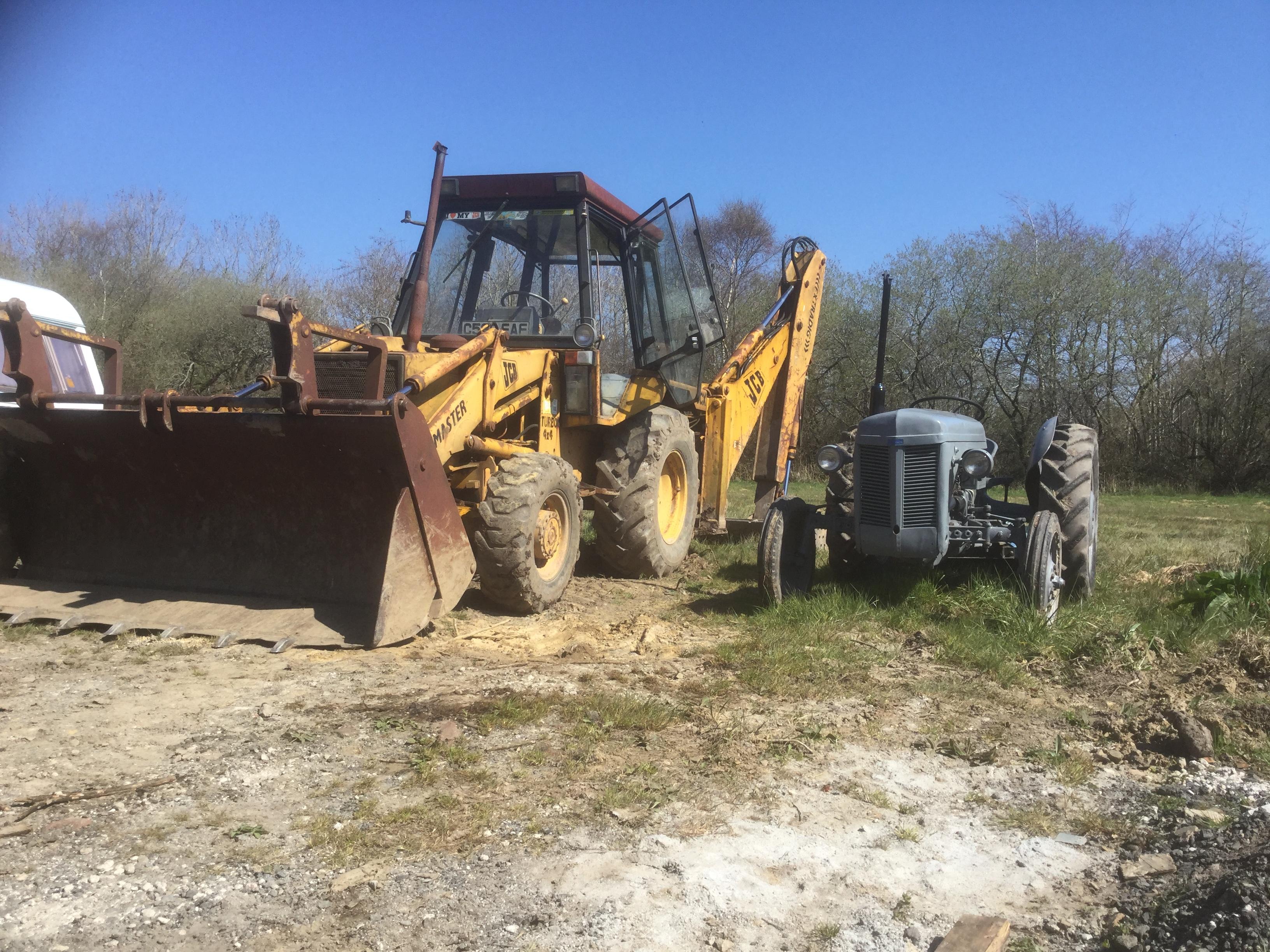

joe90 Posted July 11, 2020 Posted July 11, 2020 @Omnibuswoman just added a pic to show HOW big (against my 60 year old furgy) ?

Omnibuswoman Posted July 11, 2020 Author Posted July 11, 2020 3 minutes ago, joe90 said: @Omnibuswoman just added a pic to show HOW big (against my 60 year old furgy) ? What a monster!!!
Omnibuswoman Posted July 11, 2020 Author Posted July 11, 2020 Just now, Omnibuswoman said: What a monster!!! @joe90 I'm guessing that's more than 2m wide, eh?!!!!
joe90 Posted July 11, 2020 Posted July 11, 2020 2 minutes ago, Omnibuswoman said: @joe90 I'm guessing that's more than 2m wide, eh?!!!! just been out and measured it, 2.4m wide. Also it weighs in excess of 8.8 tons and will destroy your ground (it did mine) a tracked digger will do a lot less damage (should have got one really). I like the suggestion above of going to digger world and “playing”. I have been told the micro ones are not worth it (unless you need it to go through a doorway). 1
