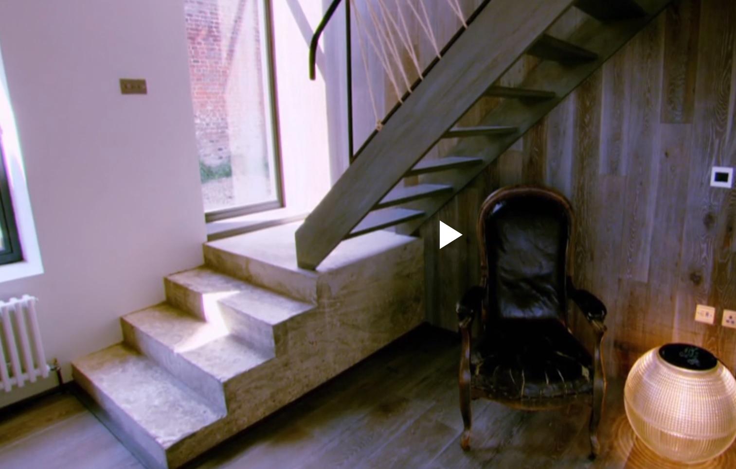

ToughButterCup Posted May 18, 2020 Share Posted May 18, 2020 Watching Building the Dream the other day ( Series 9 Episode 8 , 21:50 ish) Debbie saw this staircase and loves it.... The concrete winder that is.... or concrete block or whatever you call it. I like it as well, partly it because it also simplifies the stair run. The bottom of our stairs are surrounded on two sides by concrete walls. To make Debbie's dream come true, all I need to do, I think, is pour a concrete block of exactly the right dimensions to enable a BRegs compliant stair run to be built on top of it. The block itself also needs to be exactly correct in terms of risers and run. And that means serious shuttering and a sore back I expect. Cure time doesn't matter too much, we have some nicely textured wood left over for the top surface. I think I can make this happen. Any gottchas you can think of? Link to comment Share on other sites More sharing options...

Adrian Walker Posted May 18, 2020 Share Posted May 18, 2020 In the is example, because of the difference in runs on the concrete base, it's not going to be very nice to climb IMHO and, I would expect a few tumbles until you get use to it. Link to comment Share on other sites More sharing options...
ToughButterCup Posted May 18, 2020 Author Share Posted May 18, 2020 Exactly @Adrian Walker. It'll need to be designed carefully just like other elements of the build. Perhaps better put my question is; In terms of the construction phase , is it just a matter of proper shuttering and correct concrete mix? Link to comment Share on other sites More sharing options...

ProDave Posted May 18, 2020 Share Posted May 18, 2020 The rise and going of all stairs in a flight must be the same. I have always taken that to mean ALL if them. Are you suggesting this is treated as two separate flights so they could be different? I think that would be very odd, so I would try and make them all the same. How about creating what you want with pre case concrete steps You will get a better, guaranteed finish on each step. you just have to build up blockwork at both sides to support them, and render the blockwork. 1 Link to comment Share on other sites More sharing options...

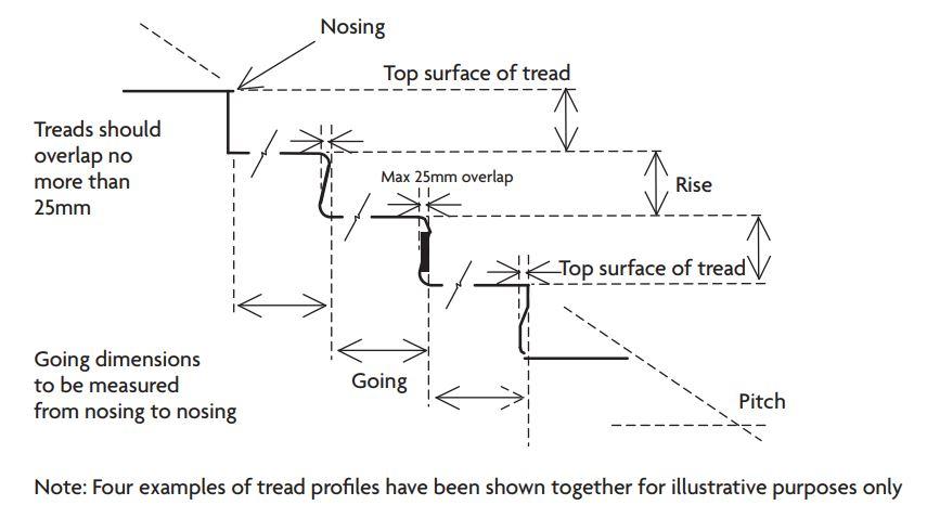

Ian Posted May 18, 2020 Share Posted May 18, 2020 @AnonymousBosch If you are DIYing the whole thing then it's likely that the design will be a bigger issue than the construction. Eg: that initial flight of stairs from the Building the Dream house in your photo doesn't comply with Part K of the Building Regs in numerous areas of its design. The risers & goings are all different from each other as well as being different from the timber section of the stair. The riser can't be vertical like that but should be angled as the diagram below from Part K. Also, the landing width is made non-compliant by the way in which the sides of the timber stair bears onto the concrete landing, obstructing the full width of the stair. The handrail is also non-compliant for numerous reasons but that's a separate issue. 1 1 Link to comment Share on other sites More sharing options...

ToughButterCup Posted May 18, 2020 Author Share Posted May 18, 2020 48 minutes ago, Ian said: @AnonymousBosch If you are DIYing the whole thing then it's likely that the design will be a bigger issue than the construction. ... So far I have the design needs to be BR compliant : read Part K does not need to be solid concrete : pad it out with blocks or similar : 100mm of concrete is fine consider how to radius the steps : silicone , plastic ; careful with the landing width line the block with soffit board maybe? consider adapting precast blocks It's obvious that @Ian's point is the key to success on this one. So, I'll get on with the design and post it here. Thanks everyone. Ian 1 Link to comment Share on other sites More sharing options...
