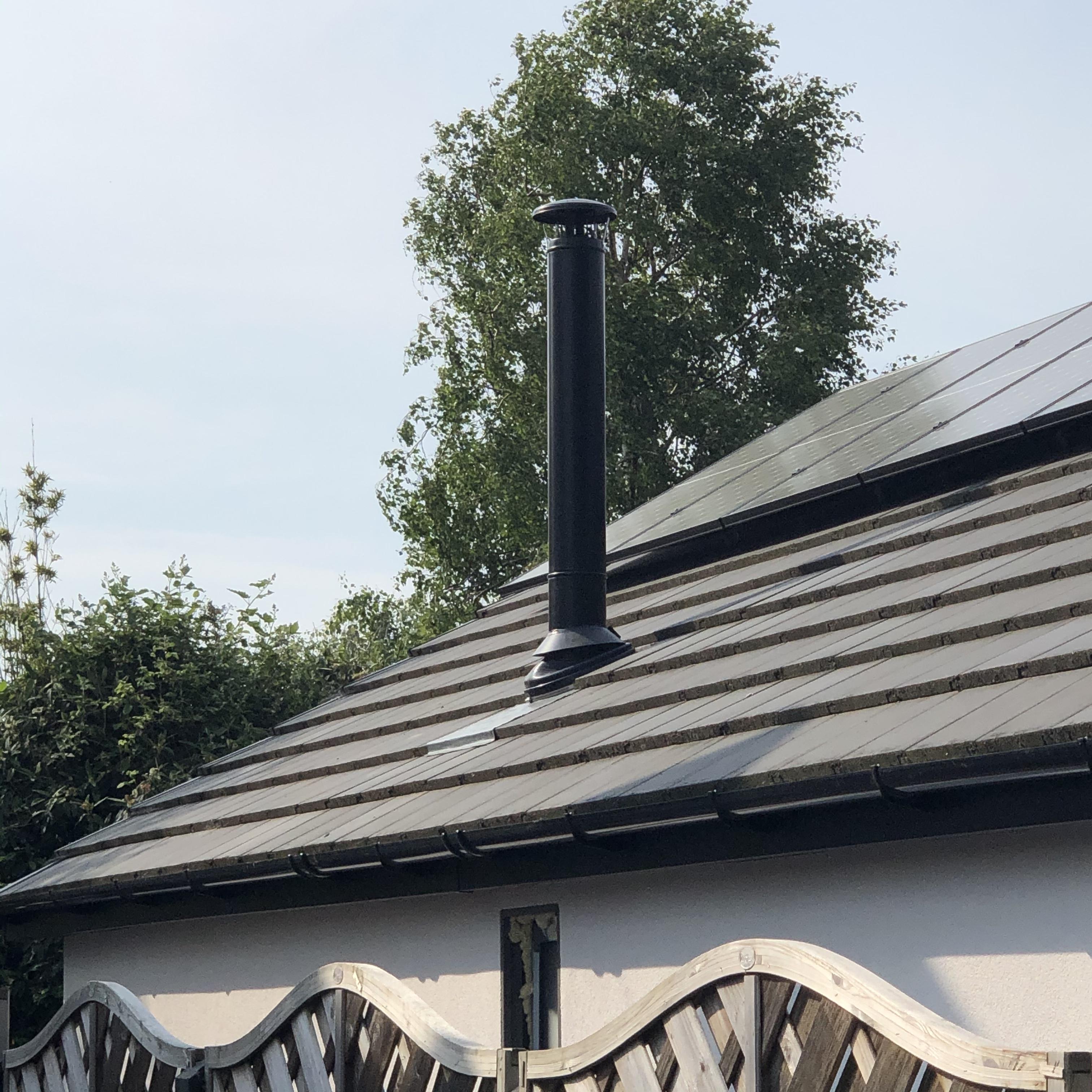

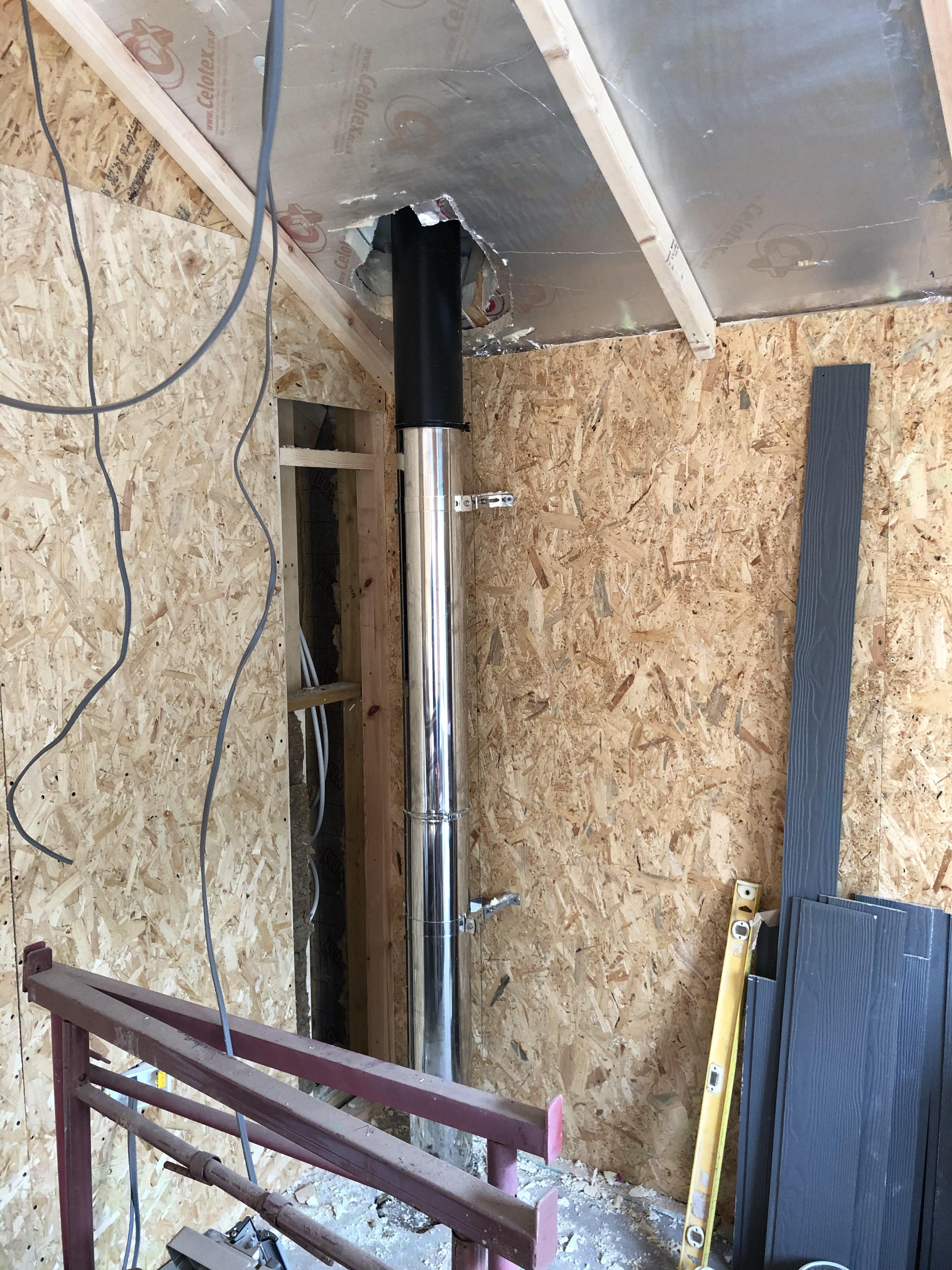

Pocster Posted May 10, 2020 Author Share Posted May 10, 2020 Flue Installed I asked him about The air bricks etc. He suggested one with a ‘float’ in - so it’s not just an open draft .. Link to comment Share on other sites More sharing options...

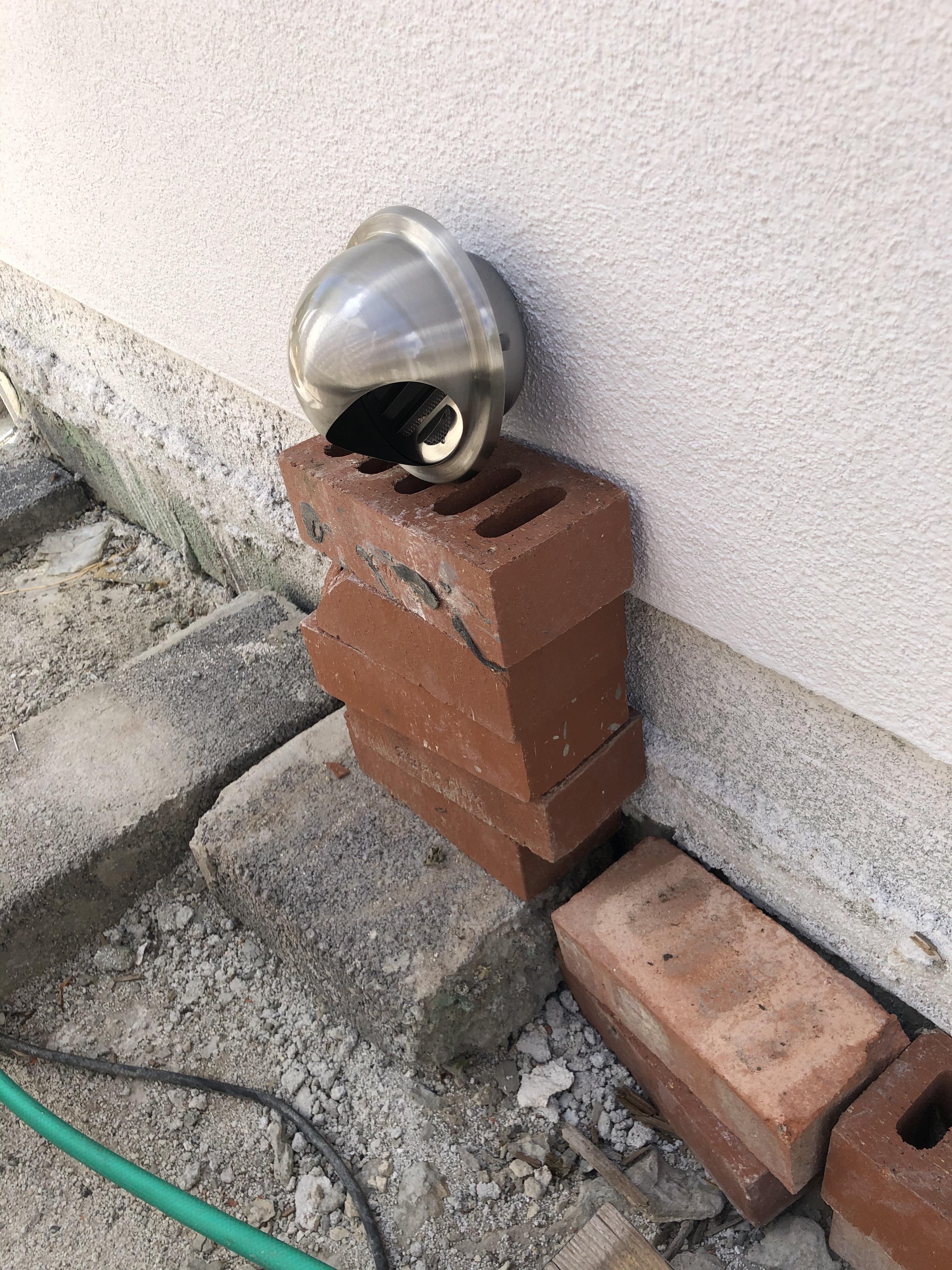

Pocster Posted June 5, 2020 Author Share Posted June 5, 2020 As I have to run my ‘air brick ‘ via a duct to the underground ceiling was thinking of placing it here . Will it look ‘odd’ being so low ? . Admittedly I choose a ‘look at me’ cone for it rather than a cheap white plastic grill . Link to comment Share on other sites More sharing options...
