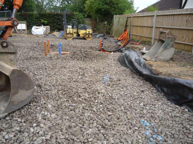

PeterW Posted April 27, 2020 Posted April 27, 2020 @rufusmacdoofus give your builders merchant a call and ask for bulk road stone. It should be £12-14 per tonne, you are being quoted by bulk bag looking at those prices I’ve done a quick calculation and it is around 120 cubic metres. That is near enough 250 tonne delivered bulk and compacted at 150mm layers. To do that I would get it in 20 tonne loads, a 5T excavator and a 3T Bomag roller. You will need to get 4 loads per day over 3 days, and spread and level as you go, assuming you can tip at all edges to the site.

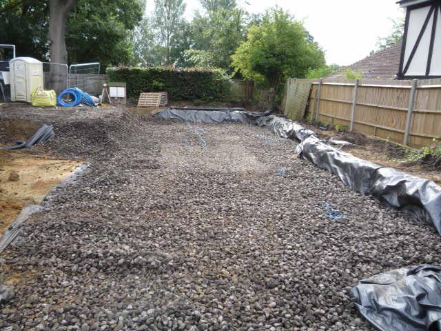

HerbJ Posted April 27, 2020 Posted April 27, 2020 (edited) 18 hours ago, Bitpipe said: I recall that others used reclaimed, cleaned railway ballast if that is cheaper. Yes, that what we used. The depth of our this material was deeper for our design 850mm for the front third, then 600mm for the middle third then 450mm for the rear third. our SE specced this because of two oak trees on the front boundary. Somewhere, I have the number of truck loads of railway ballast delivered to site, but I can't ;lay my hands on it. The ballast was installed pretty much as proposed by @PeterW 17 hours ago, PeterW said: To do that I would get it in 20 tonne loads, a 5T excavator and a 3T Bomag roller. You will need to get 4 loads per day over 3 days, and spread and level as you go, assuming you can tip at all edges to the site. Some photos Edited April 28, 2020 by HerbJ
HerbJ Posted April 28, 2020 Posted April 28, 2020 17 hours ago, HerbJ said: Somewhere, I have the number of truck loads of railway ballast delivered to site, but I can't ;lay my hands on it. I had 16 loads, each 20 tonnes, of railway ballast
