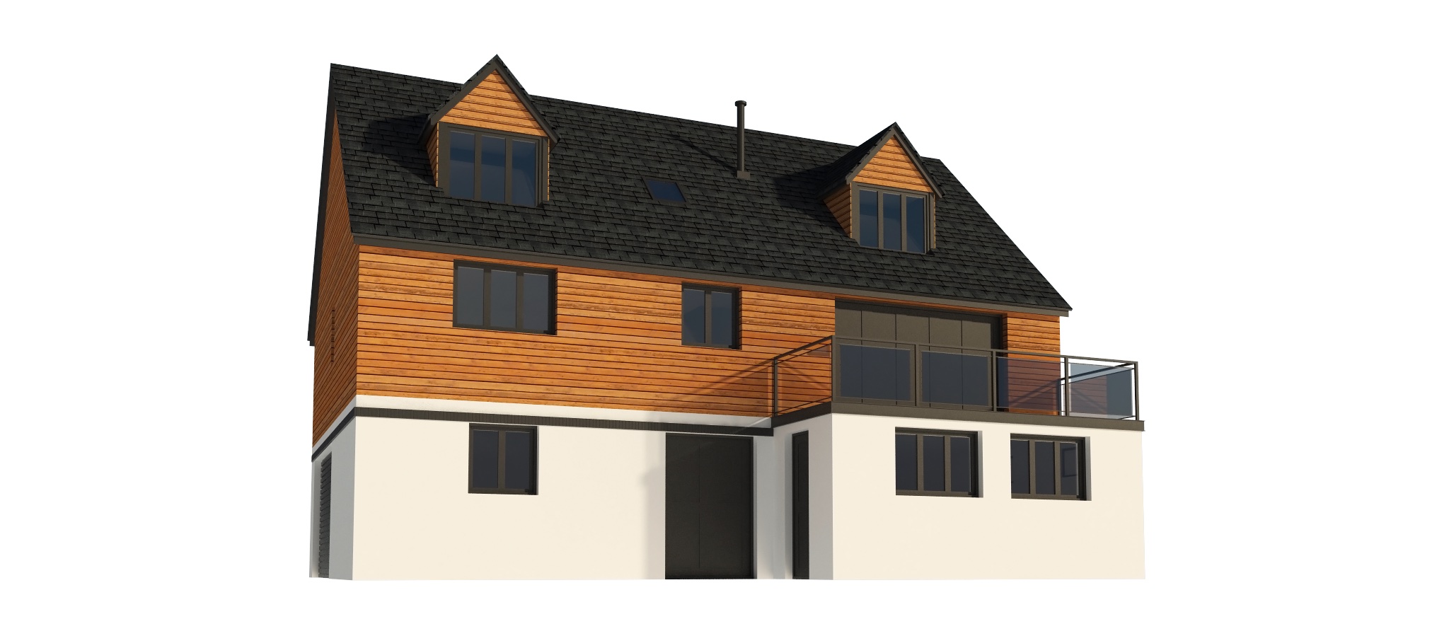

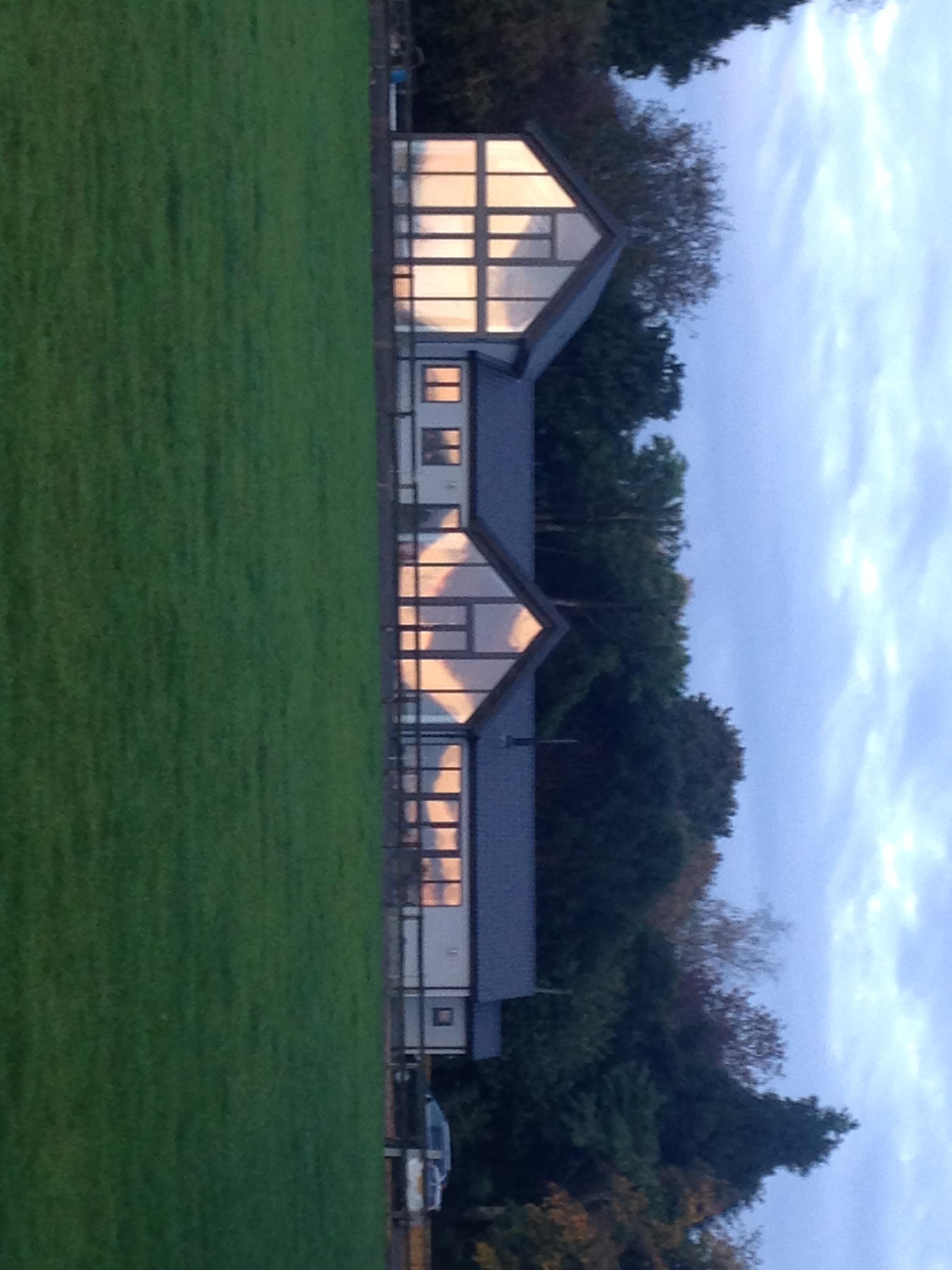

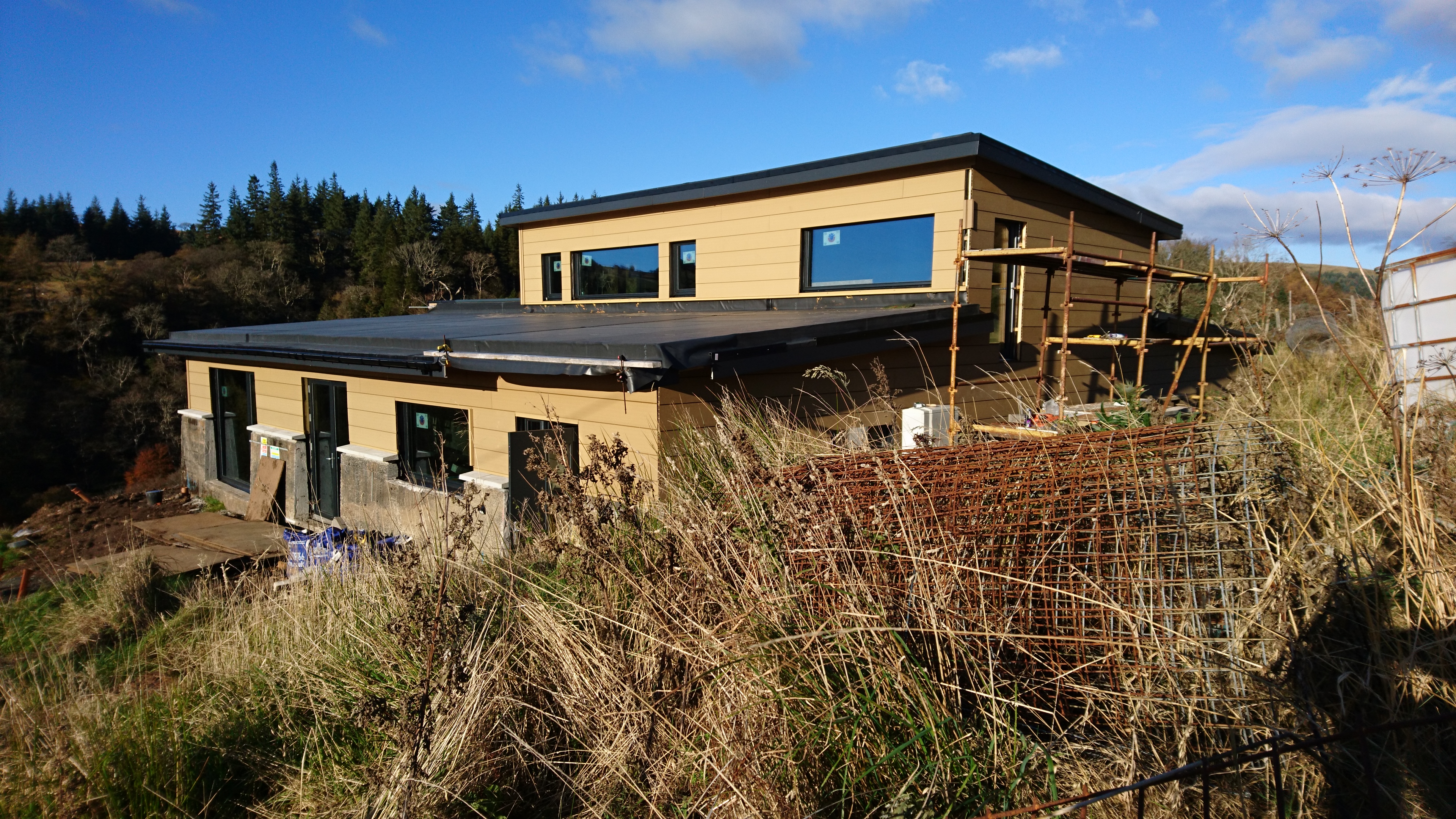

Grosey Posted December 1, 2016 Posted December 1, 2016 (edited) I'm planning to use Marley Cedral in light oak to mimic brand new red cedar, it's coming up to crunch time now so glad this topic popped up now offering alternatives. This is the look I'm after, will let you know what I choose in the end. A few few other options I haven't heard mentioned a great deal - Canexel - Hawthorn timber appear to be UK distribution, they do a variety of claddings. Got some samples, not that impressed. Trespa Pura - www.performance-panels.co.uk - got samples, very nice clean product, sort of immaculate finish. Edited December 1, 2016 by Grosey

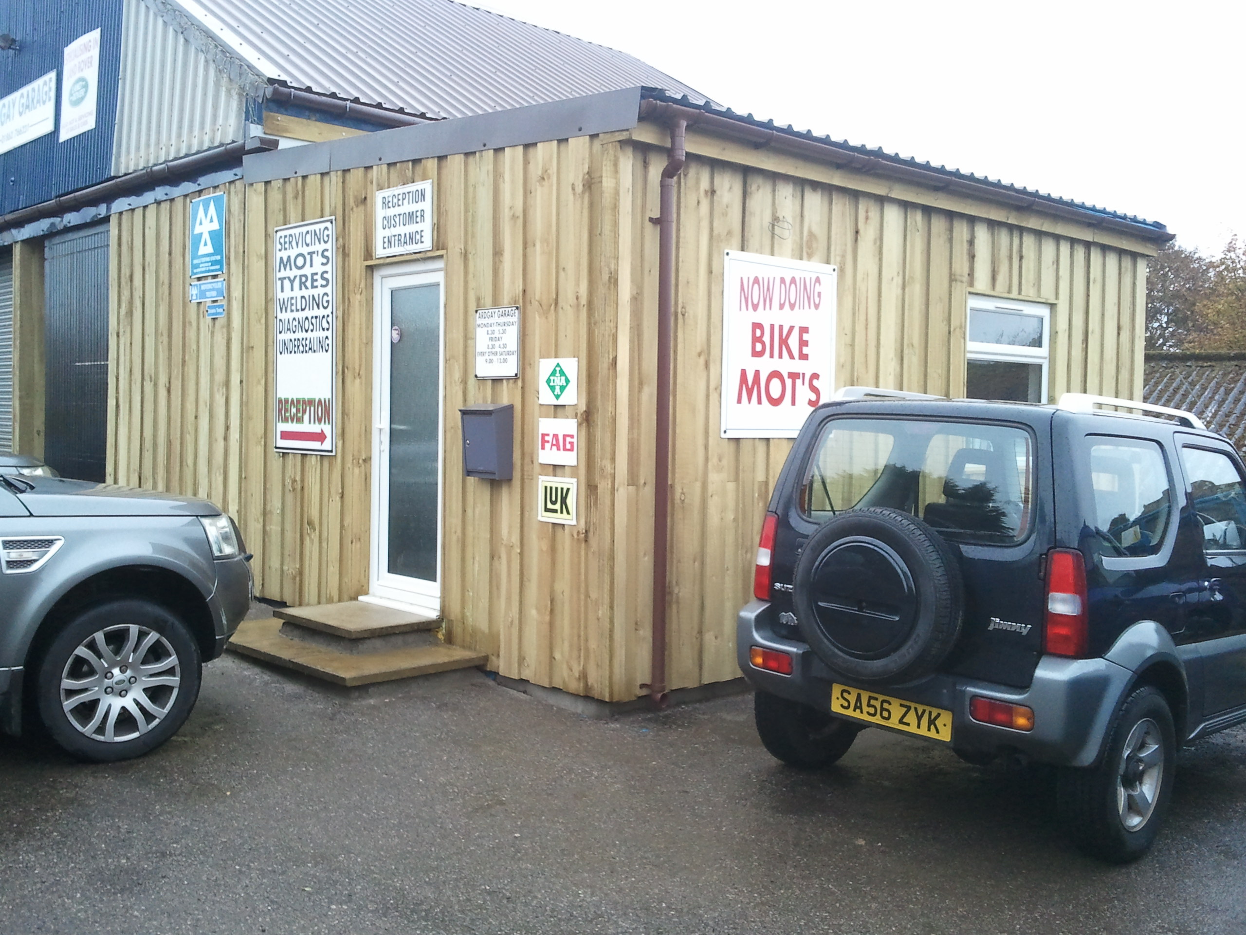

ProDave Posted December 1, 2016 Posted December 1, 2016 Am alternative I am looking at is cheap pressure treated softwood. I know most people look at various hardwoods for cladding. But how about this: It's pressure treated (presumably softwood) cladding from Jewsons. This has just been applied to my local garage (that's a new single storey extension) I will be looking with interest how this weathers over the next couple of years and see if it retains an even colour any better than untreated hardwoods. I guess you could stain it any colour you want, but any stained colour is likely to fade over time.

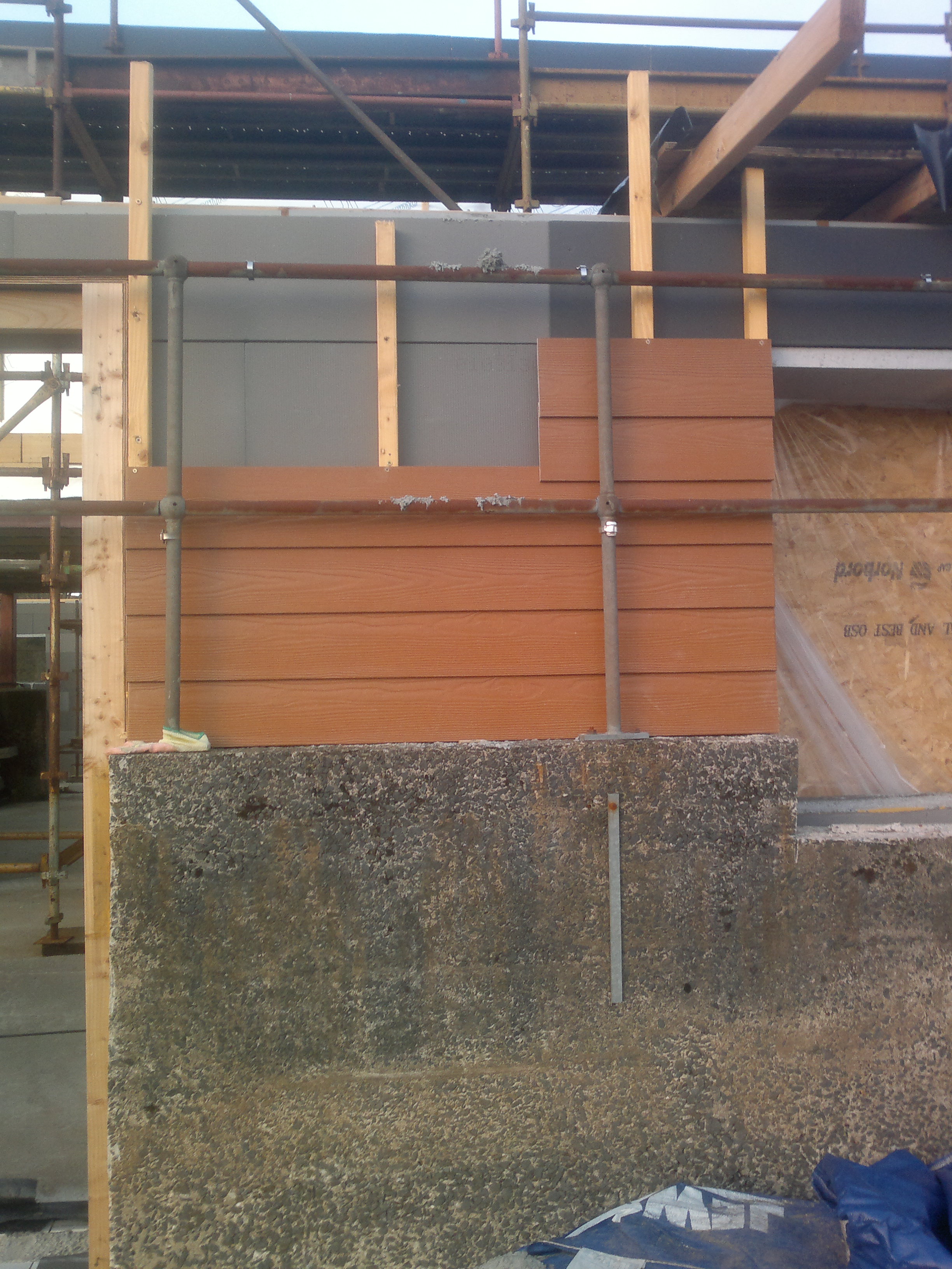

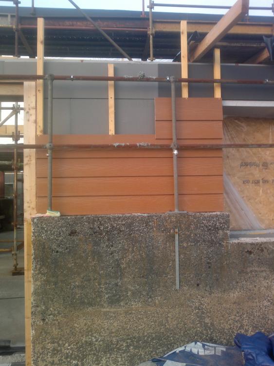

jamiehamy Posted December 1, 2016 Posted December 1, 2016 27 minutes ago, Grosey said: I'm planning to use Marley Cedral in light oak to mimic brand new red cedar, it's coming up to crunch time now so glad this topic popped up now offering alternatives. This is the look I'm after, will let you know what I choose in the end. A few few other options I haven't heard mentioned a great deal - Canexel - Hawthorn timber appear to be UK distribution, they do a variety of claddings. Got some samples, not that impressed. Trespa Pura - www.performance-panels.co.uk - got samples, very nice clean product, sort of immaculate finish. Tresta Pure is lovely, with a lovely price to go. I think we got a Marlay light oak full board and really didn't like it - having a bigger area changed how it looked compared to a sample. Will try dig out pics when I get home.
Grosey Posted December 1, 2016 Posted December 1, 2016 2 minutes ago, jamiehamy said: Tresta Pure is lovely, with a lovely price to go. I think we got a Marlay light oak full board and really didn't like it - having a bigger area changed how it looked compared to a sample. Will try dig out pics when I get home. Yeah that would be great, we've only seen a sample and it's a big commitment to base on 6inches... ? Difficult to find many photos of the light oak installed anywhere online.
jamiehamy Posted December 1, 2016 Posted December 1, 2016 @Grosey - pretty sure this is the light oak - we ordered a single board and put what we could up. 1
