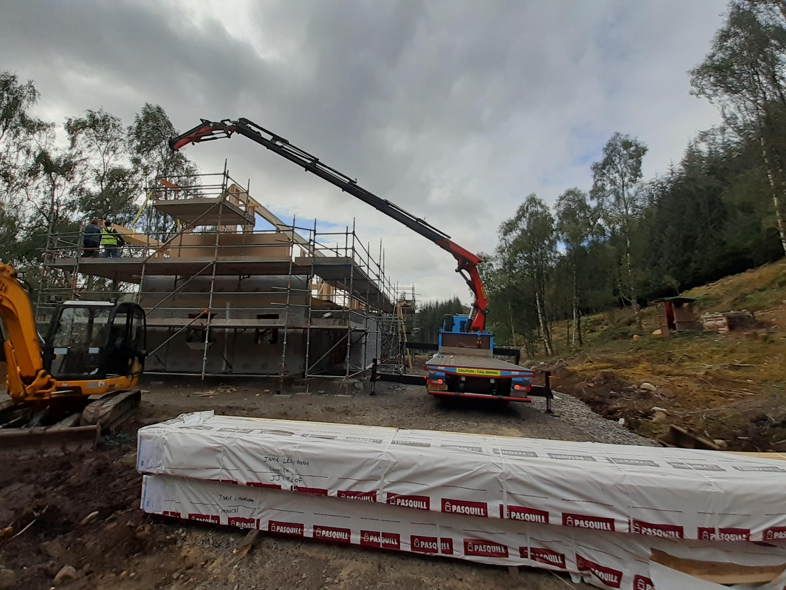

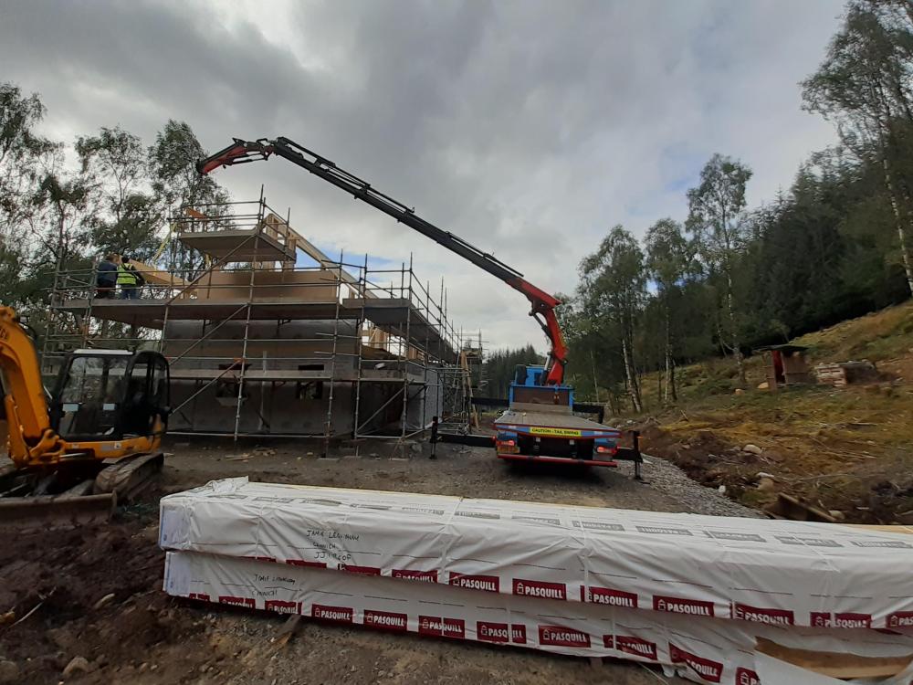

Tennentslager Posted May 11, 2020 Share Posted May 11, 2020 5 hours ago, Willow said: All went well thanks everyone next lets hope it continues, although having a nightmare trying to get the structural warranty sorted bit late in the day I know Pictures please? Link to comment Share on other sites More sharing options...
Willow Posted June 29, 2020 Author Share Posted June 29, 2020 1 Link to comment Share on other sites More sharing options...
Willow Posted June 29, 2020 Author Share Posted June 29, 2020 Link to comment Share on other sites More sharing options...
Mr Punter Posted June 29, 2020 Share Posted June 29, 2020 That was indeed a lot of trusses. A fair size house. It will look a better fit once the scaffolding is down. Was this a replacement dwelling plot? Link to comment Share on other sites More sharing options...
Vijay Posted June 29, 2020 Share Posted June 29, 2020 Did you fit as you got them up or got them all up and then fitted? Link to comment Share on other sites More sharing options...
Willow Posted June 30, 2020 Author Share Posted June 30, 2020 20 hours ago, Mr Punter said: That was indeed a lot of trusses. A fair size house. It will look a better fit once the scaffolding is down. Was this a replacement dwelling plot? Hi yes it was a replacement dwelling Link to comment Share on other sites More sharing options...
Willow Posted June 30, 2020 Author Share Posted June 30, 2020 17 hours ago, Vijay said: Did you fit as you got them up or got them all up and then fitted? it took 2 days with the telehandler they fitted the big ones as they went up but then got the rest up to the following day, to be honest half a day was taken up organising etc the can't wait to get the scaffold down just waiting for them to collect it Link to comment Share on other sites More sharing options...
