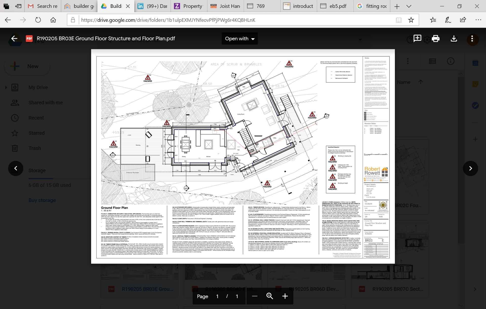

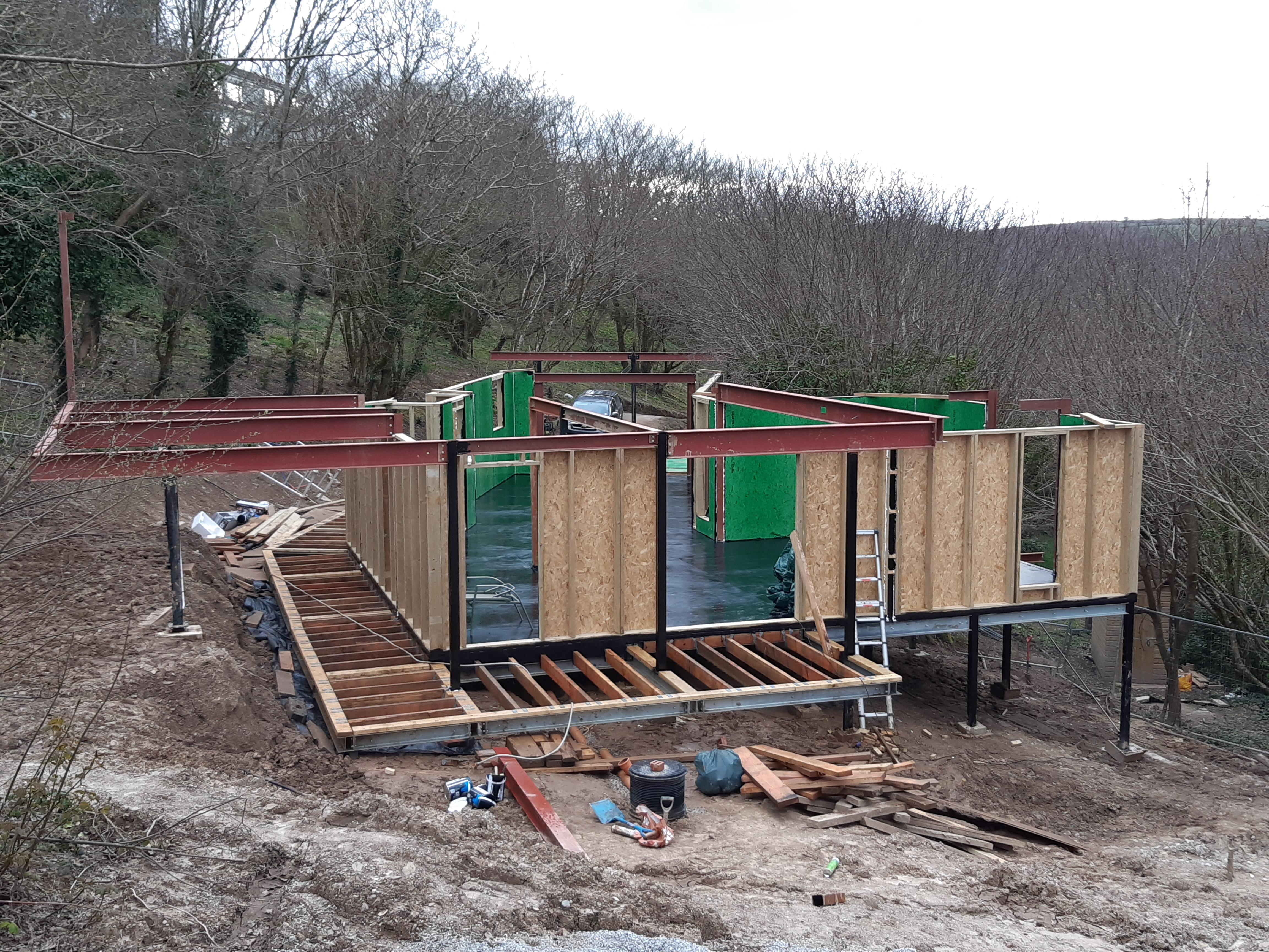

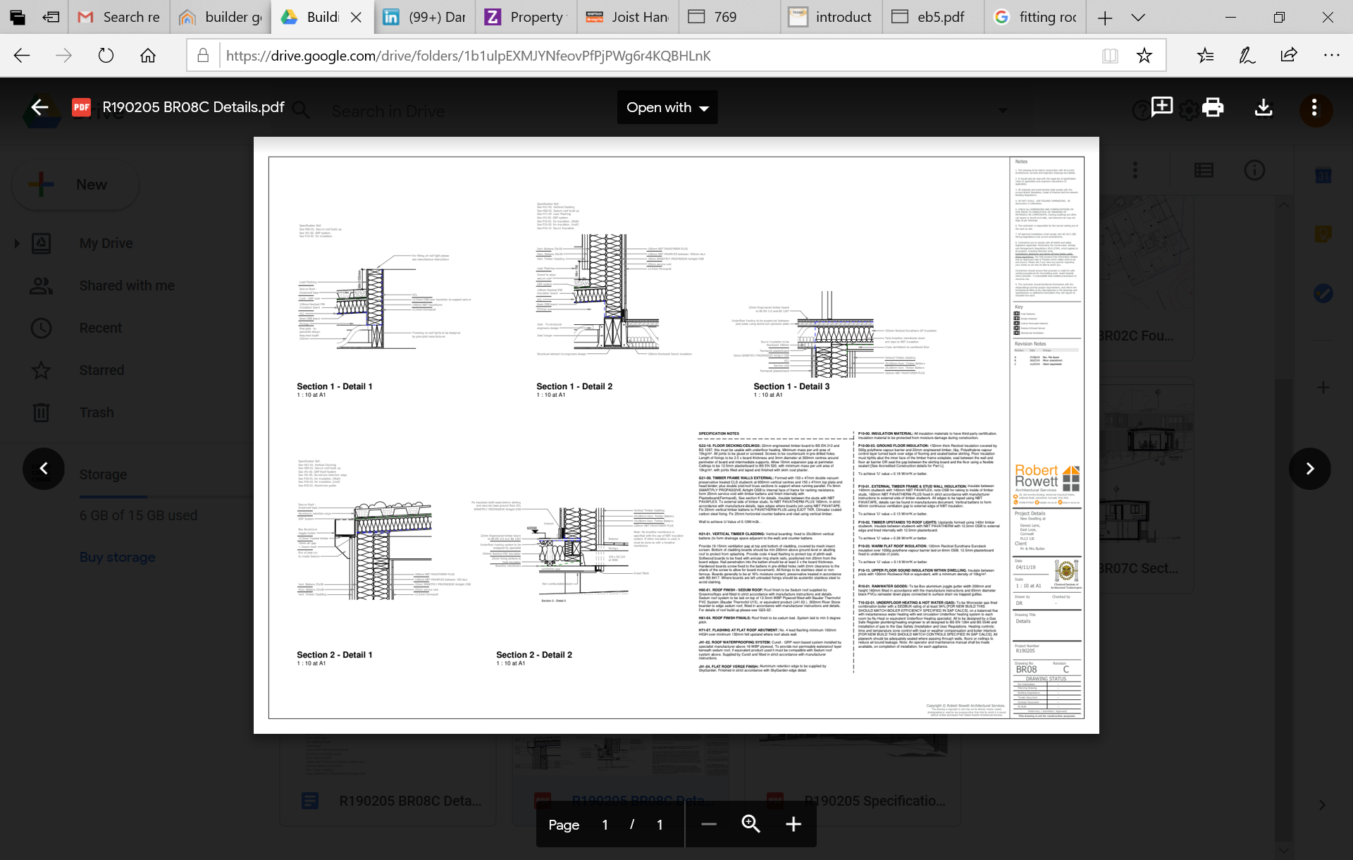

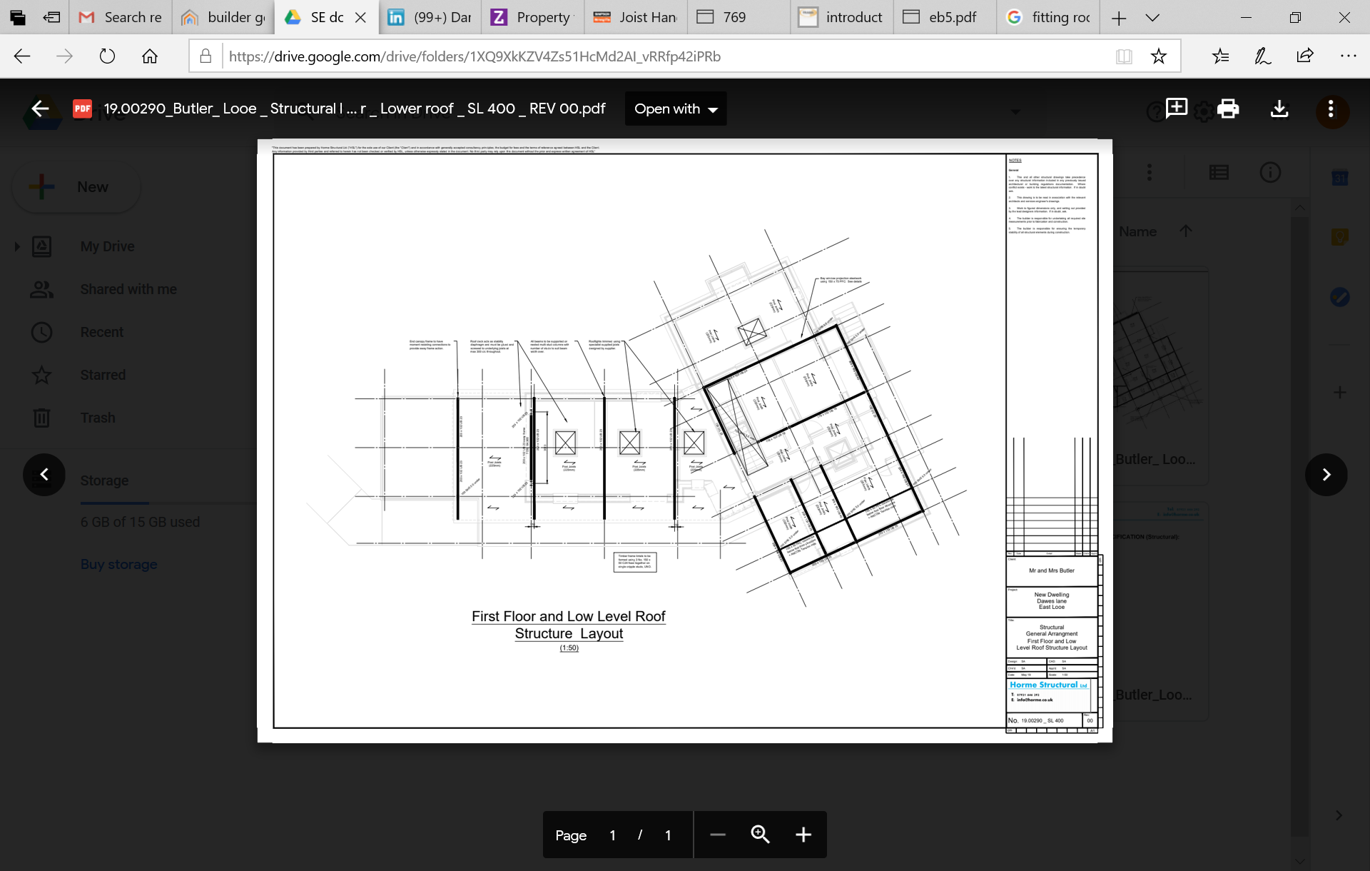

redtop Posted April 19, 2020 Share Posted April 19, 2020 So timber frame, 1st floor walls and OSB sheafing done and builder gone! Don't ask, its cost us a fortune which means doing rest myself. Kitchen area and half of lounge is 1 floor with flat roof. 2nd floor site over half lounge with large overhang, again flat roof. Lots of steels as you can imagine which are all fitted. I desperately need to get on with build, could someone point me at some images, threads where I can see how you fix joists to top of ground floor walls, or ANY images of a stick build that show how the next stage fits together. Sorry for the rather wide ranging nature of the question but this has been completely unexpected and I must get on with getting at least some of it watertight. Note we are using solid timber joists and these have already been delivered, thanks everyone Link to comment Share on other sites More sharing options...
ProDave Posted April 19, 2020 Share Posted April 19, 2020 Has he gone because of CV-19 or gone because you have fallen out? Do you have all the jousts and the rest of the timber frame kit? Do you have the drawings from the architect / TF company showing how it aall goes together? Pictures of where you are now? Link to comment Share on other sites More sharing options...
redtop Posted April 19, 2020 Author Share Posted April 19, 2020 2 minutes ago, ProDave said: Has he gone because of CV-19 or gone because you have fallen out? Do you have all the jousts and the rest of the timber frame kit? Do you have the drawings from the architect / TF company showing how it aall goes together? Pictures of where you are now? CV-19 was the excuse, further digging and well. I cant say at this stage.... Yes we have 100 joists for next stage, pro-passive for sheafing and 50 pack of OSB for flat roof. so most of it. designs and pics attached Link to comment Share on other sites More sharing options...

dpmiller Posted April 19, 2020 Share Posted April 19, 2020 why is the membrane on the INSIDE of the panels? 1 Link to comment Share on other sites More sharing options...
jamieled Posted April 19, 2020 Share Posted April 19, 2020 @dpmiller isn't that propassiv osb rather than a membrane? Link to comment Share on other sites More sharing options...

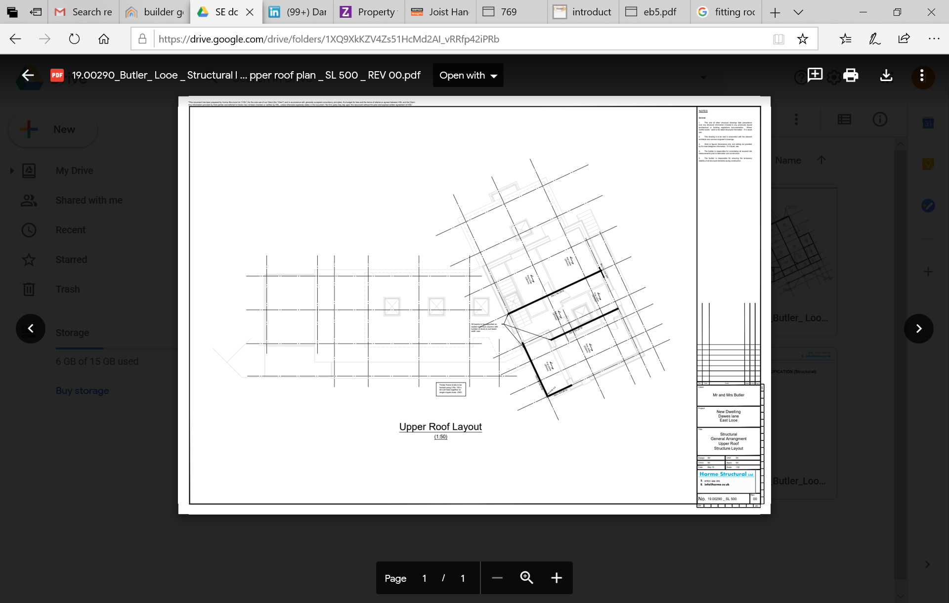

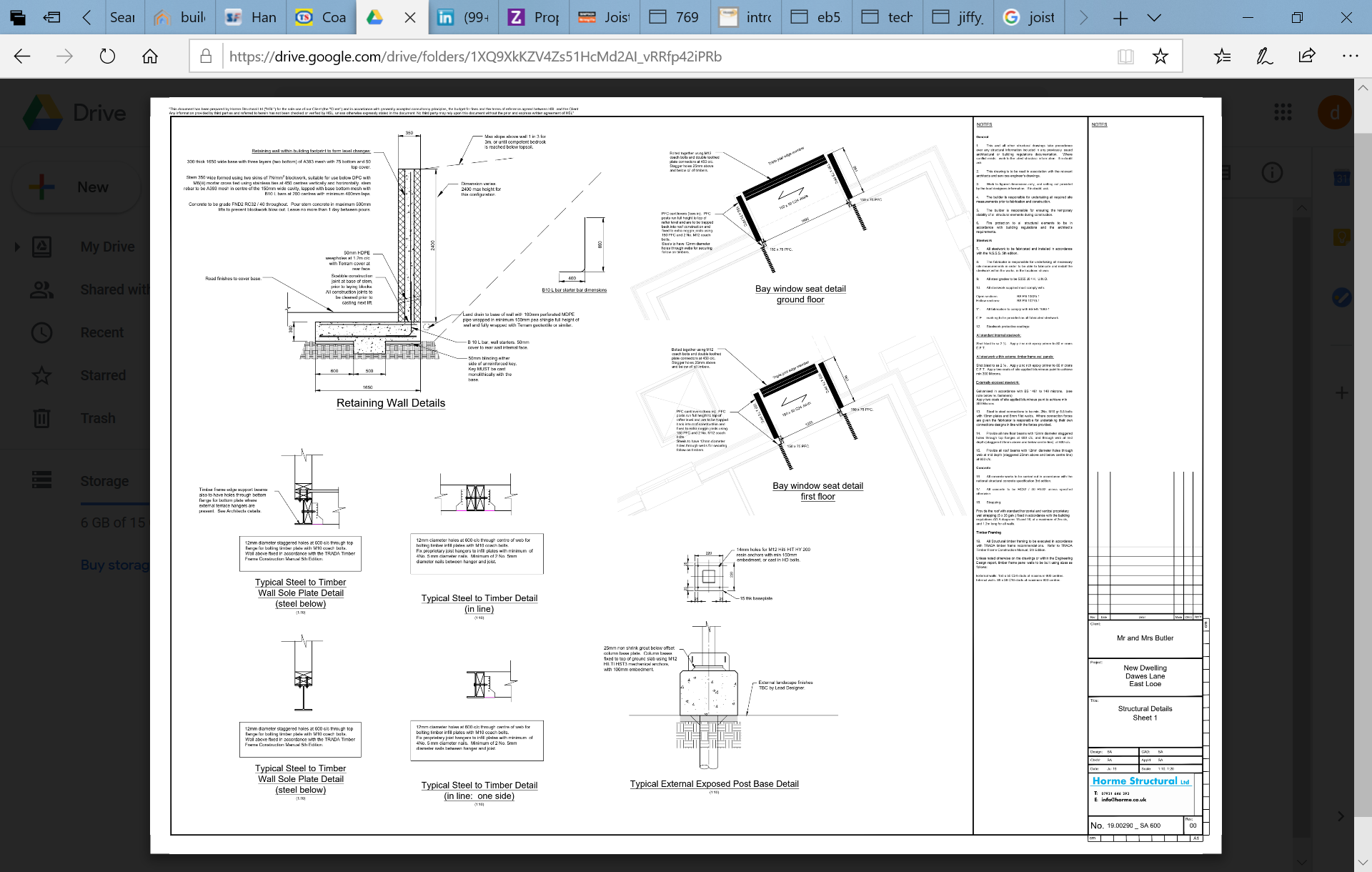

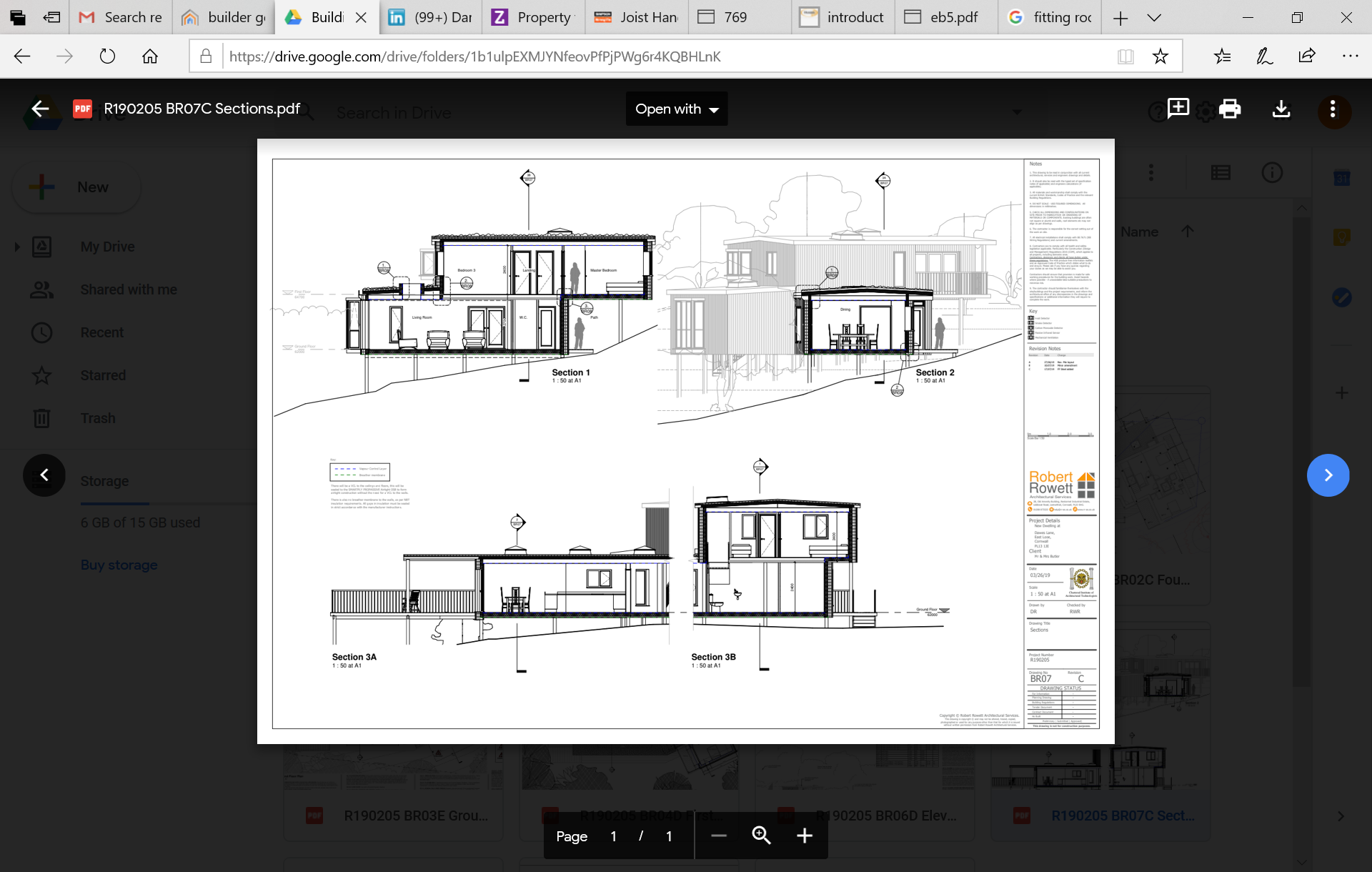

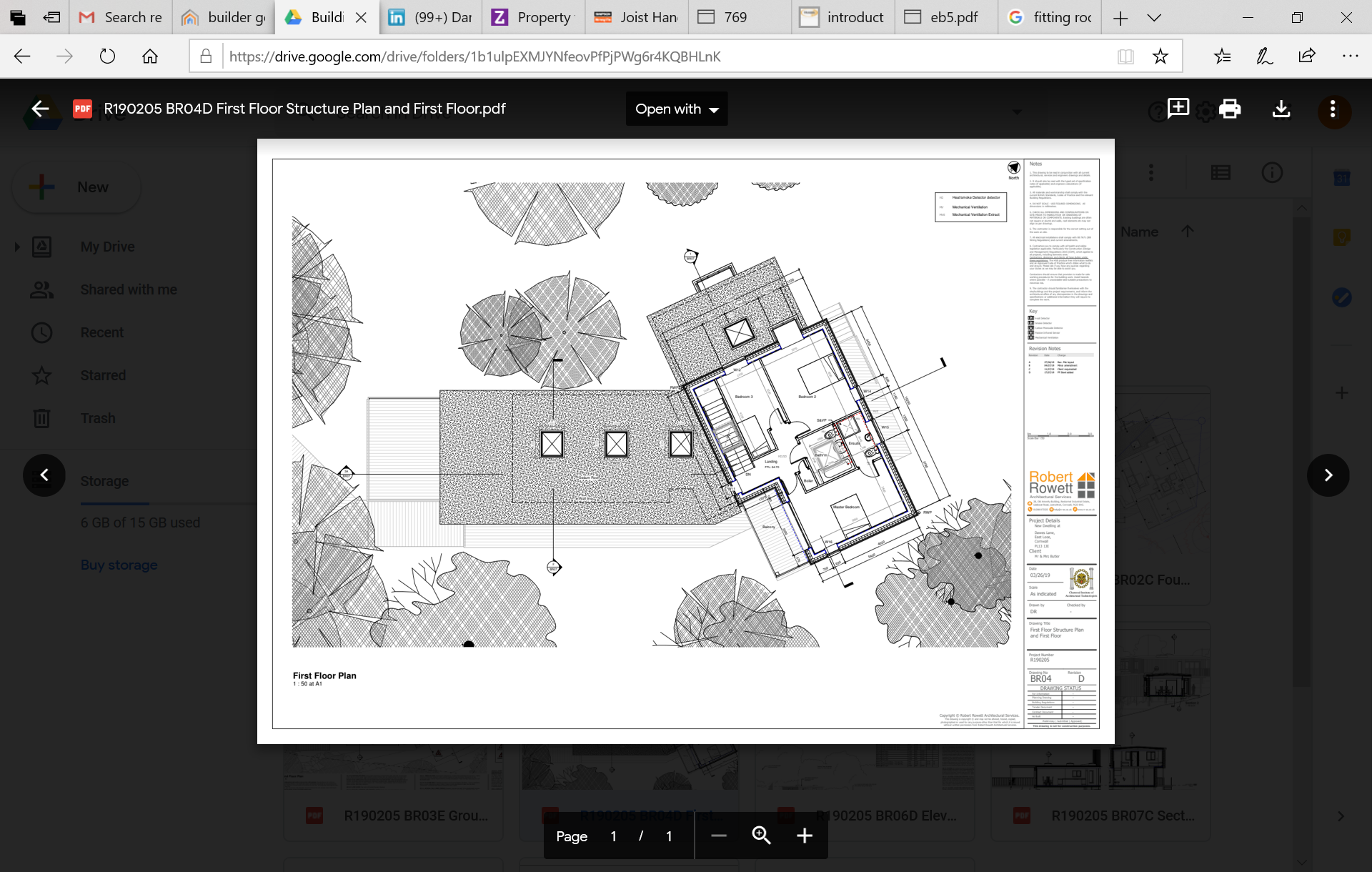

ProDave Posted April 19, 2020 Share Posted April 19, 2020 What is going on the outside? I don't see enough detail in those drawings. There should be some drawings that show more detail like joist plans and details of important junctions. If you don't have them ask the designer / TF company for them. Link to comment Share on other sites More sharing options...
redtop Posted April 19, 2020 Author Share Posted April 19, 2020 its propasive OSB and floor ply has just been treated to keep it weatherproof while build stalled. joists are at 400mm centres, drawings below show details at junctions plus SEs drawings. Not a chance of getting more detailed drawings. note all this is being stick built on site due to horrible access and I have hand balled 100 joists and 50 OSB sheets for next phase Link to comment Share on other sites More sharing options...

PeterW Posted April 19, 2020 Share Posted April 19, 2020 Ok so if I’m reading this correctly @redtop you’ve still got another full panel system to build on top of that steel frame that is there ..? You’ve also got joists to add to make the floor up ..? First and foremost, you’ll need to understand some more on those designs as the key joints between steelwork and the timber joists are identified as being “to structural engineers design” so you need to know what that is. From looking at it, there seems to be a timber infill into to the face of the steels, and then a proprietary joist hanger but that would need the engineer to confirm - you can’t guess that sort of thing from looking at a drawing. It looks like the floor hangs below the top of the steels which is unusual - I wonder if you could potentially redesign with a timber ring beam on top of the steel and reduce the topside wall panel height slightly to compensate. I would seriously get an SEng involved though - the BCO will ask for the engineers details and if you’ve paid for it then it’s rightfully yours. Link to comment Share on other sites More sharing options...

redtop Posted April 19, 2020 Author Share Posted April 19, 2020 6 hours ago, PeterW said: Ok so if I’m reading this correctly @redtop you’ve still got another full panel system to build on top of that steel frame that is there ..? You’ve also got joists to add to make the floor up ..? First and foremost, you’ll need to understand some more on those designs as the key joints between steelwork and the timber joists are identified as being “to structural engineers design” so you need to know what that is. From looking at it, there seems to be a timber infill into to the face of the steels, and then a proprietary joist hanger but that would need the engineer to confirm - you can’t guess that sort of thing from looking at a drawing. It looks like the floor hangs below the top of the steels which is unusual - I wonder if you could potentially redesign with a timber ring beam on top of the steel and reduce the topside wall panel height slightly to compensate. I would seriously get an SEng involved though - the BCO will ask for the engineers details and if you’ve paid for it then it’s rightfully yours. one advantage I have is the whole house sits on steel posts and then a steel ring beam. and these are infilled, joist hangers and joists; already done and passed by BC. so the roof and 2nd floor joists are exactly the same as ground floor. Timber in fill and wood on top and then standard hangers. I have all the timber; green and joists. its actually not a complicated build timber wise; 2 rectangles on ground floor with a triangle joining them and one rectangle on 1st floor with steels doing most of the support work. have I built a house before, nope. but I have renovated quite a few so know my way around the basics and have all the tools. I have done the underground drains, can do the plumbing, electrics, UFH, etc. original plan was to finish ourselves once roof was on. TBH I have spent ages going round correcting the mistakes the builder made, was just shoddy work. Link to comment Share on other sites More sharing options...
