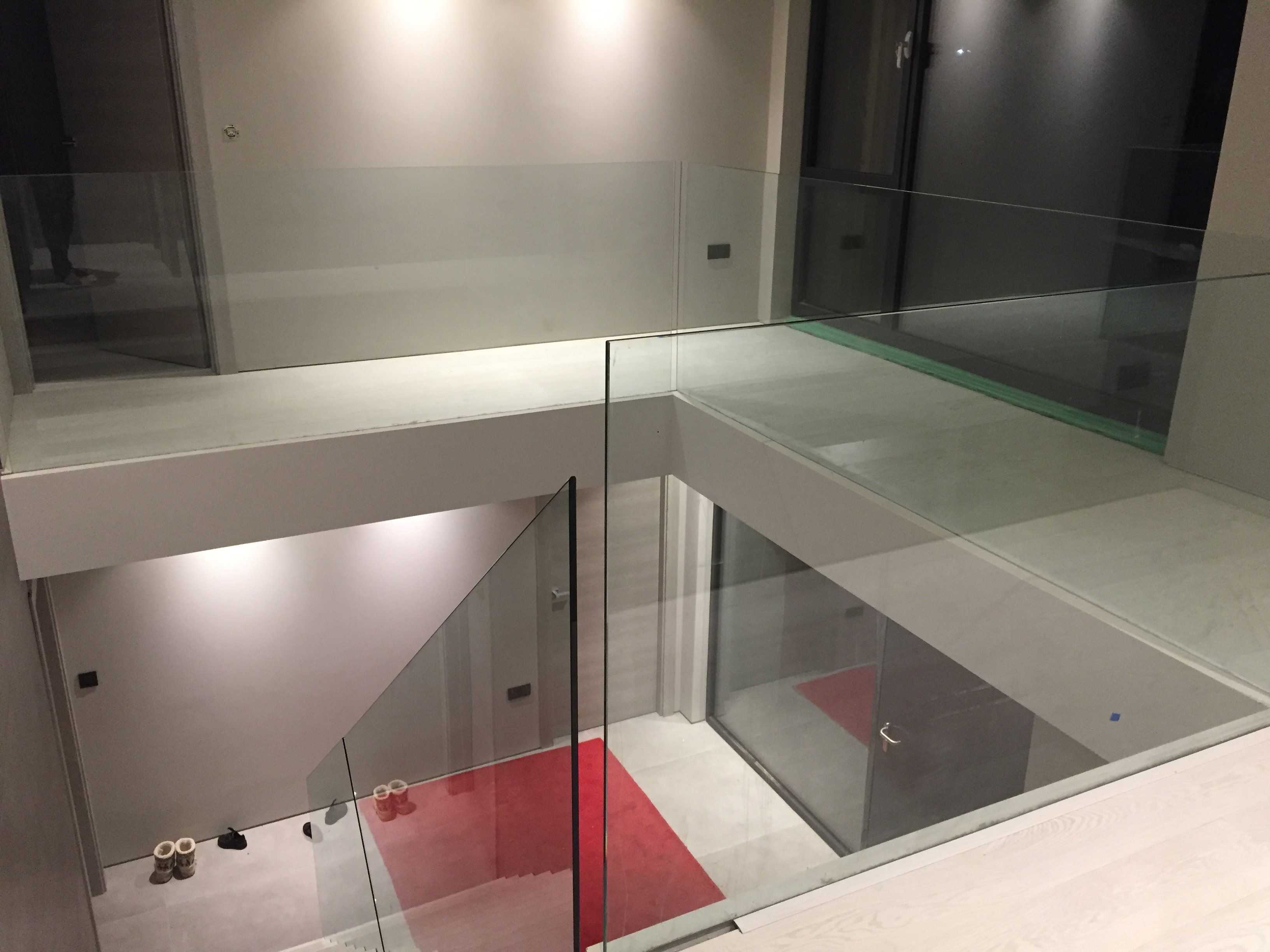

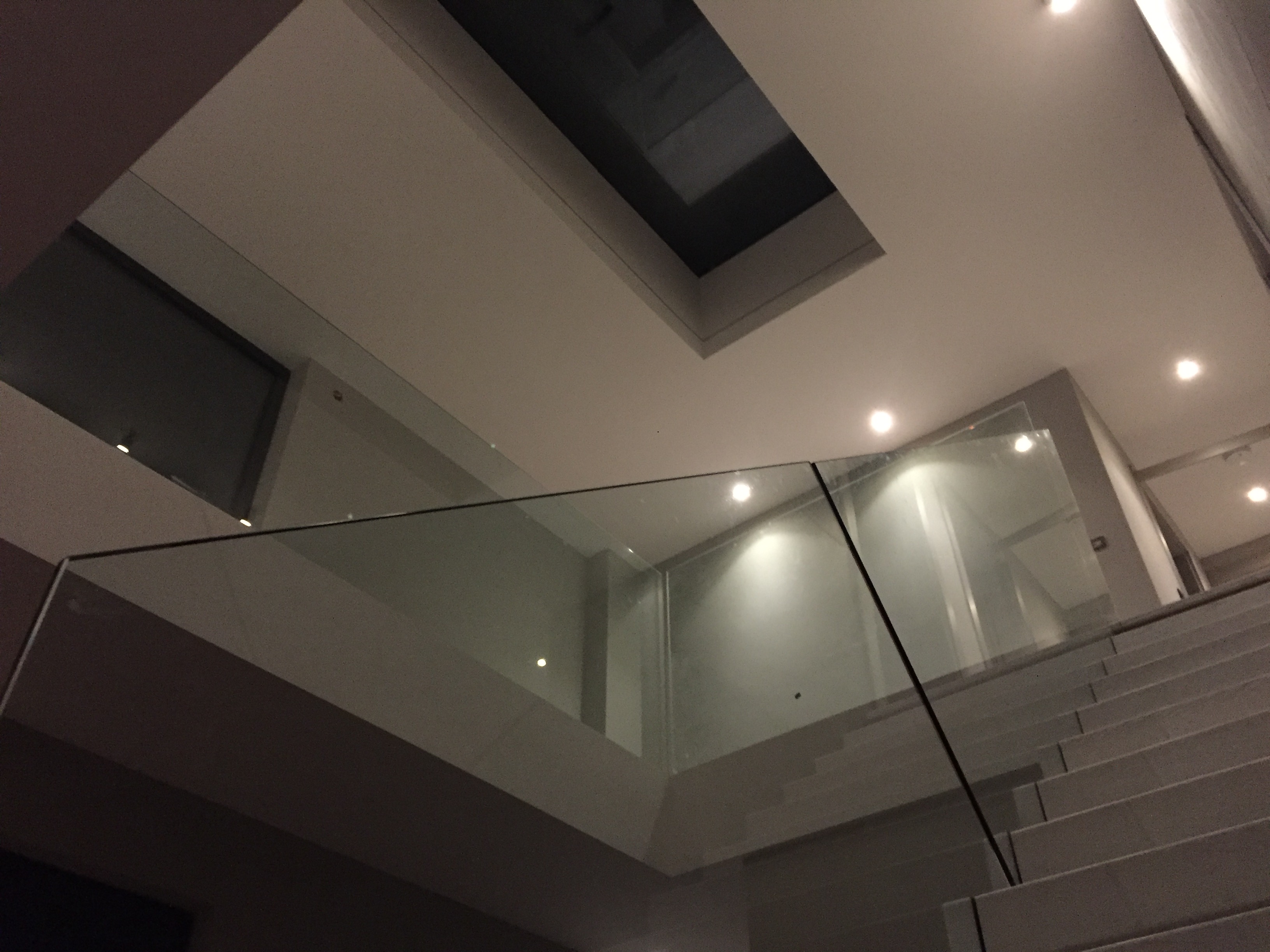

Trw144 Posted November 29, 2016 Posted November 29, 2016 (edited) I checked with my local building rega and they were happy with 12 mm toughened. Will take a picture in a bit if anyone is interested in how it finished up after? Edited November 29, 2016 by Trw144 1
jamiehamy Posted November 29, 2016 Posted November 29, 2016 1 hour ago, Trw144 said: I checked with my local building rega and they were happy with 12 mm toughened. Will take a picture in a bit if anyone is interested in how it finished up after? Please do

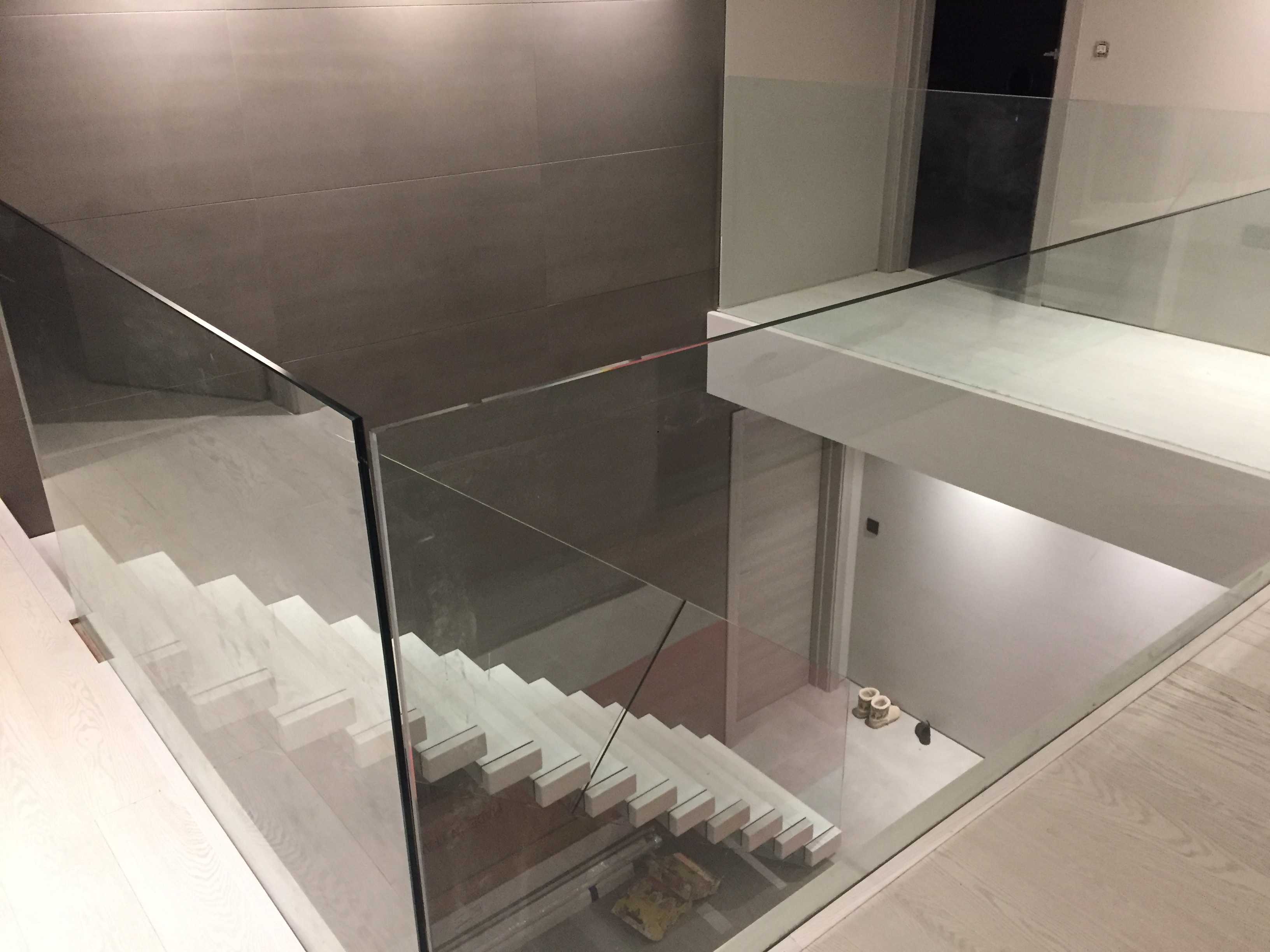

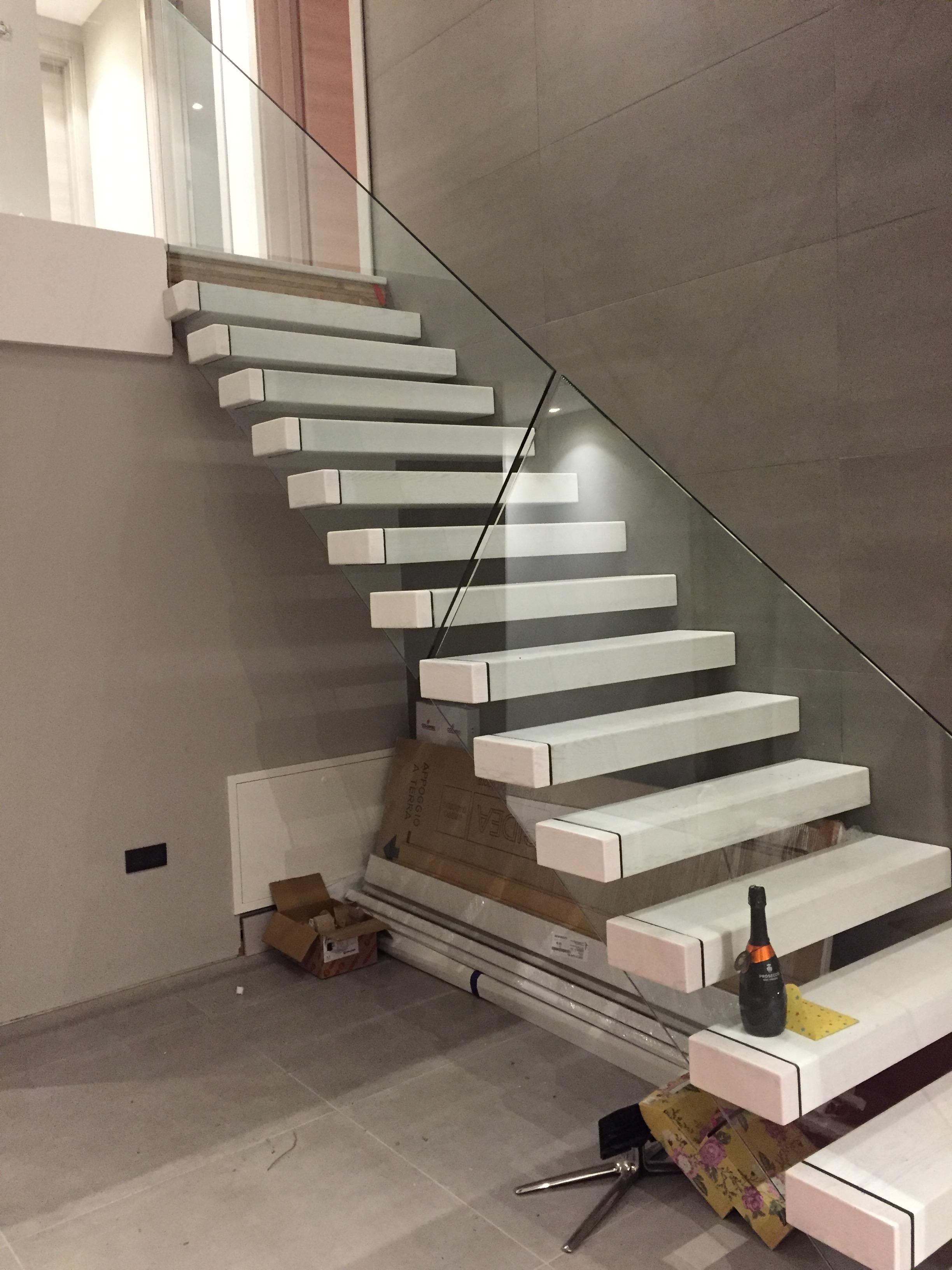

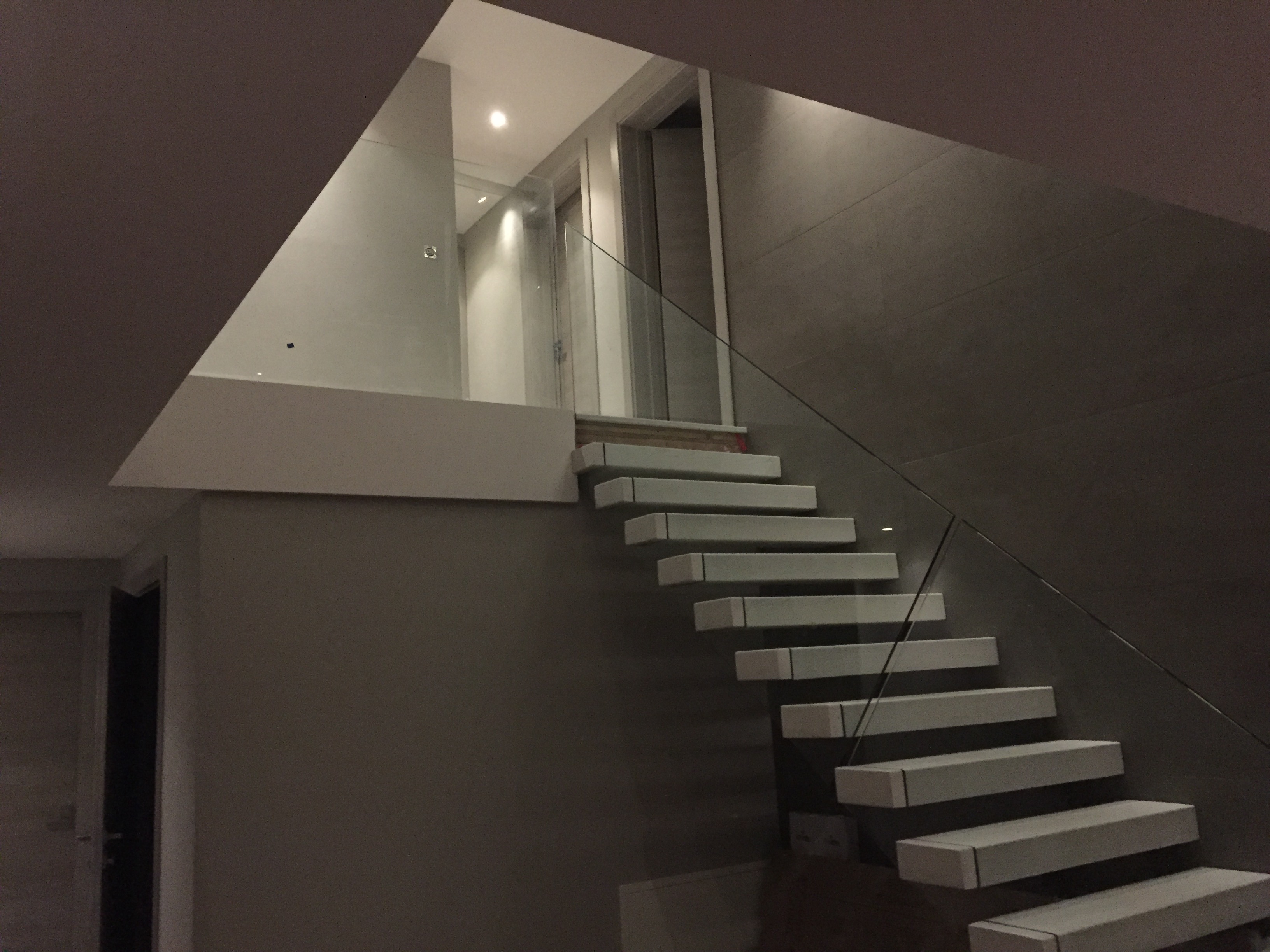

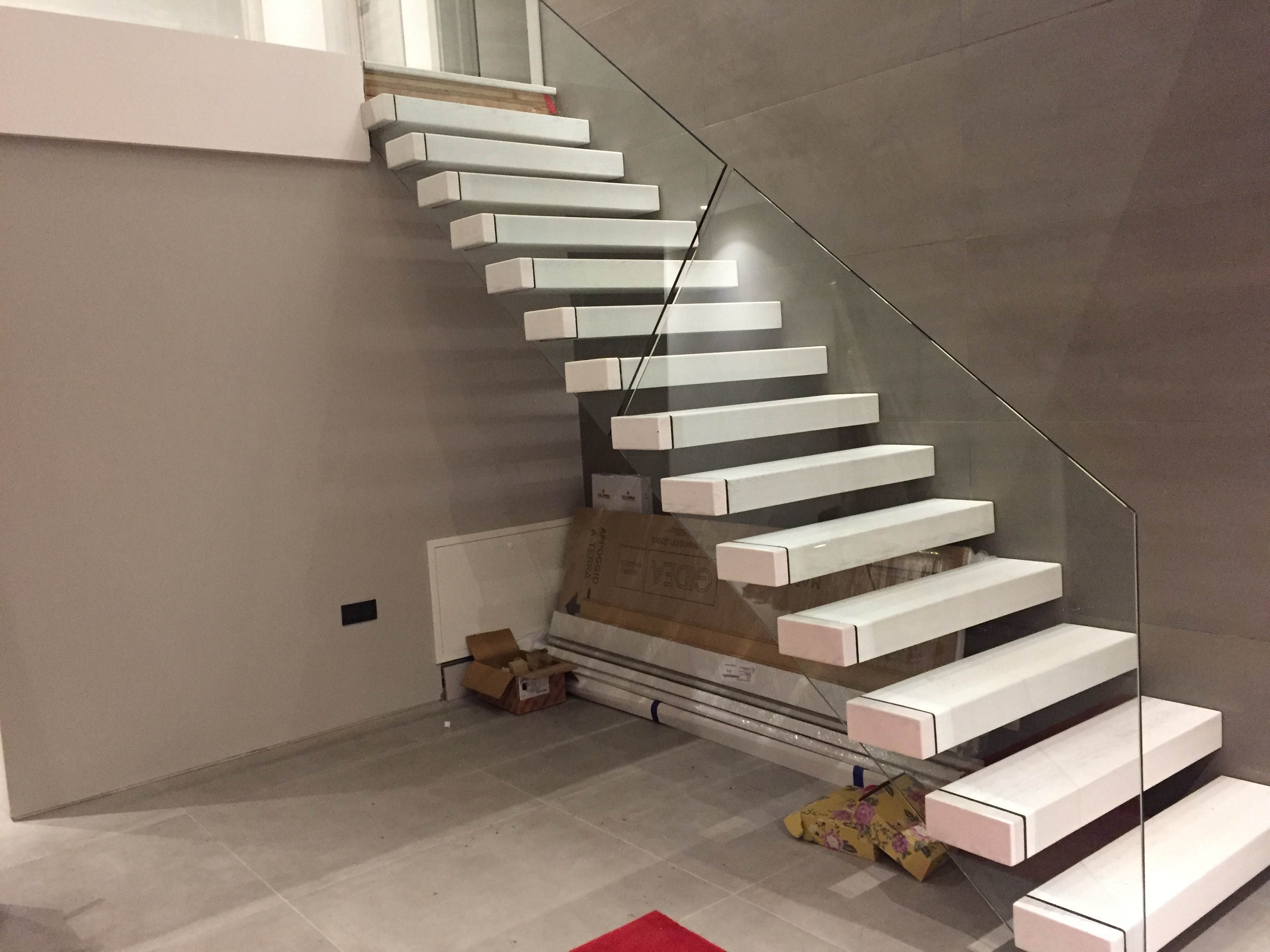

Trw144 Posted November 29, 2016 Posted November 29, 2016 3 minutes ago, jamiehamy said: Please do Ok, well excuse the mess and the ensuite door that is sat under the stairs, moved in on Saturday but some trades still doing final pieces..... I need to give the glass a good clean, and I m having a white powder coated plate to go just above the top tread to hide the joist:floor build up that needs to go on. 5

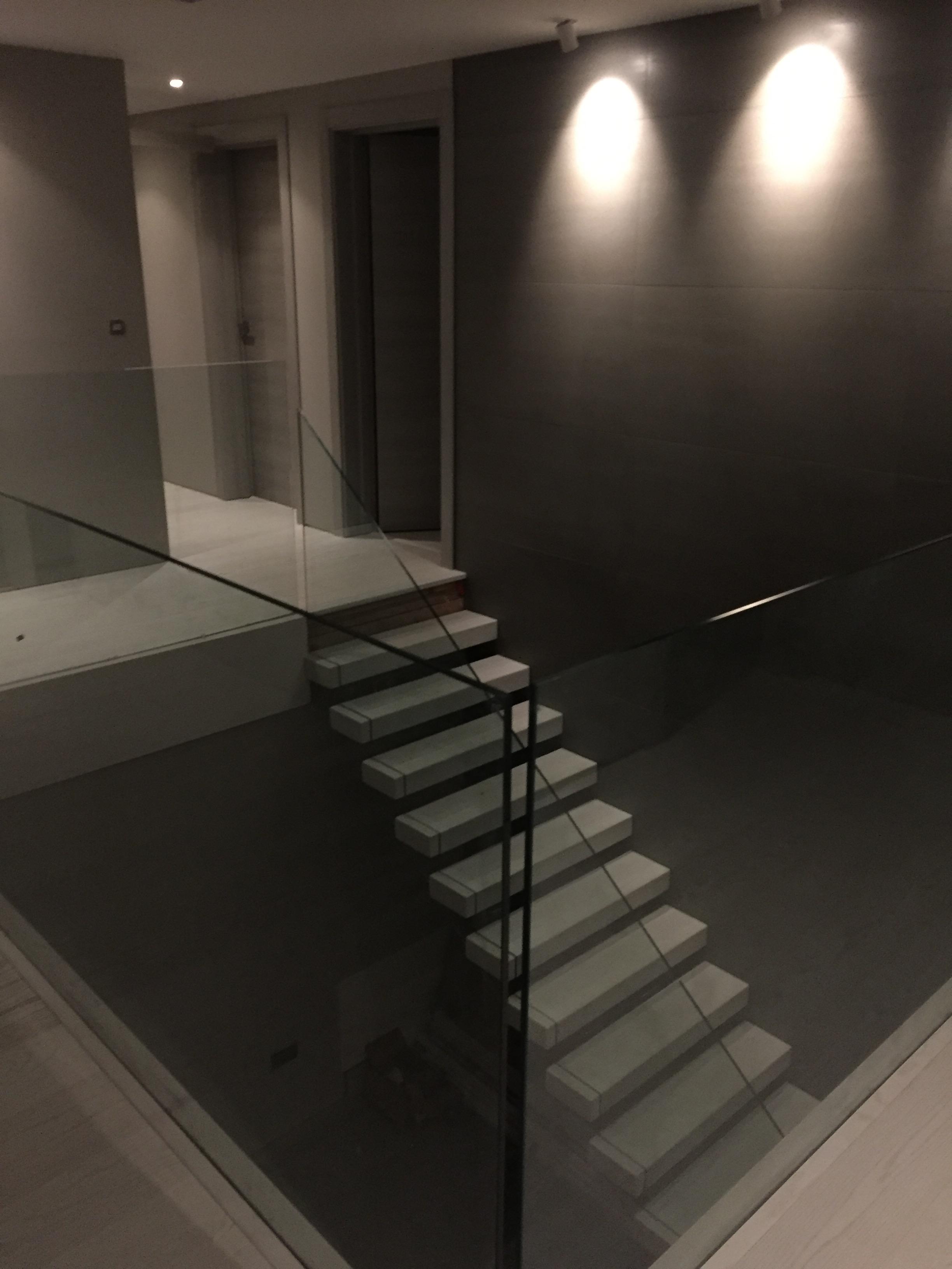

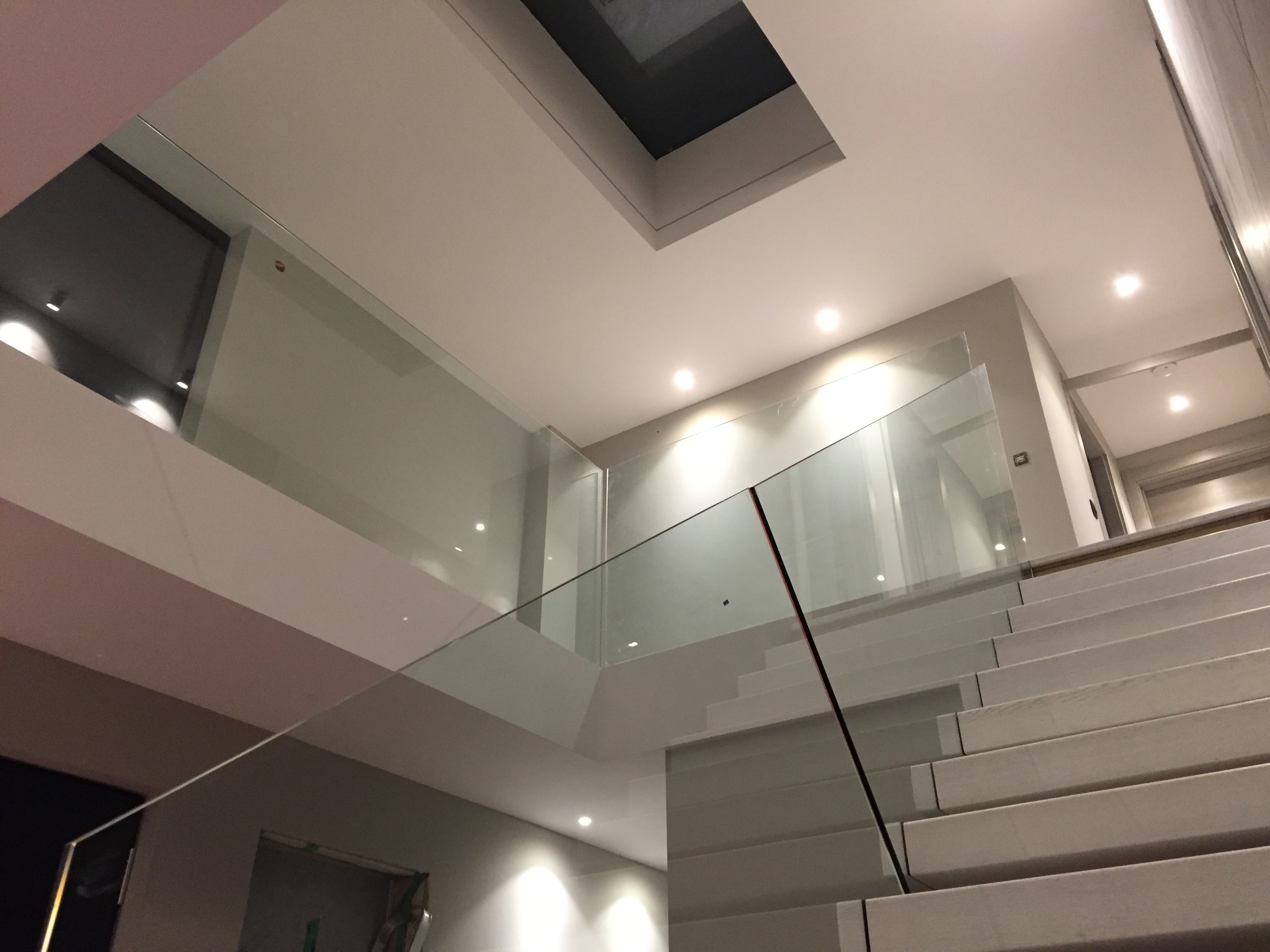

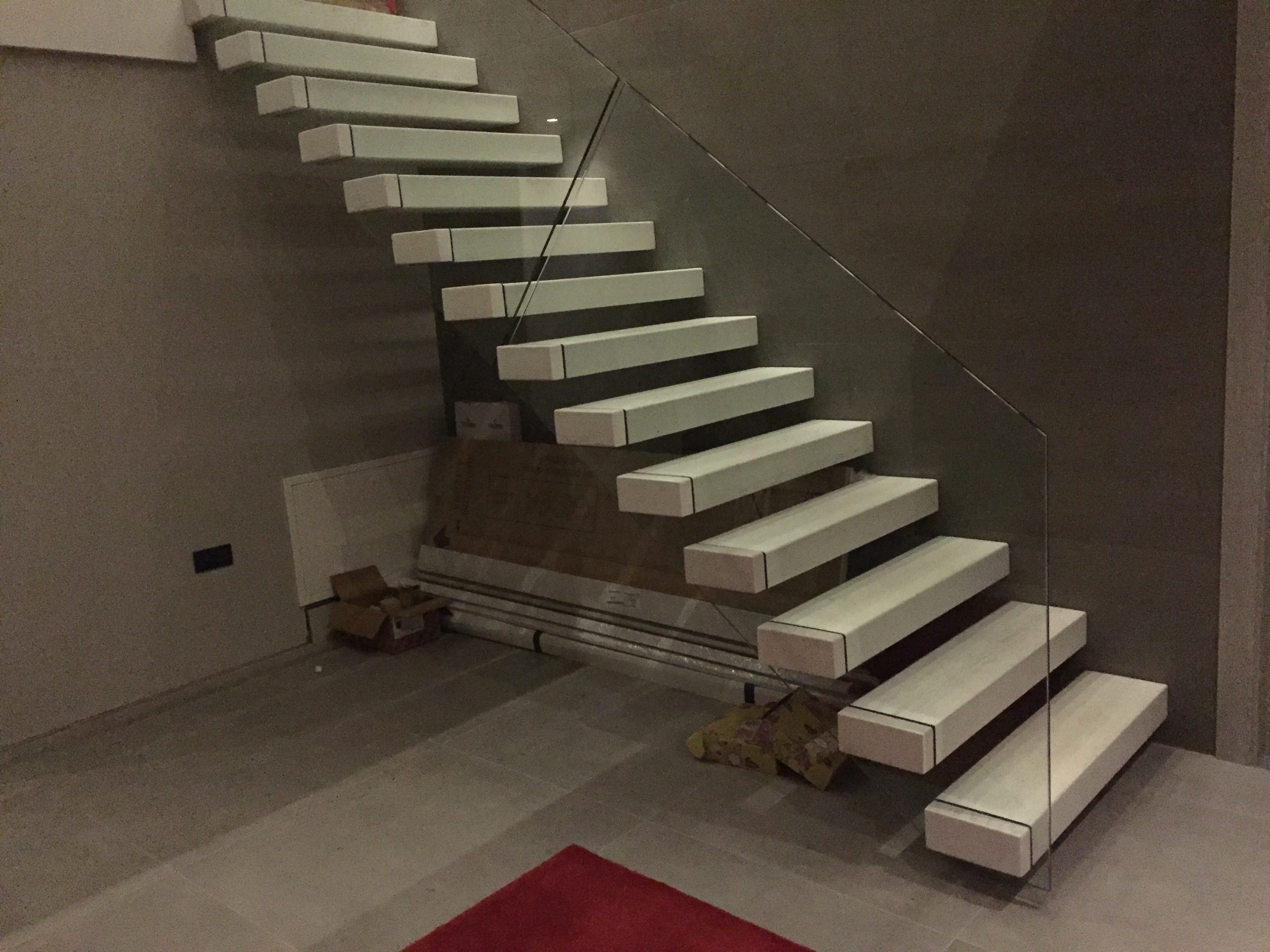

Trw144 Posted November 29, 2016 Posted November 29, 2016 Probably better with the lights on properly...... 6 1
Barney12 Posted November 30, 2016 Posted November 30, 2016 +1 Stunning. Love the lack of skirting board too.
Stones Posted December 1, 2016 Posted December 1, 2016 Looks fantastic. Utterly impractical for us - would be covered in small hand prints within 5 minutes! 1
pauldoc Posted December 8, 2016 Posted December 8, 2016 On 11/29/2016 at 20:15, Trw144 said: I checked with my local building rega and they were happy with 12 mm toughened. Will take a picture in a bit if anyone is interested in how it finished up after? Love the stairs and the wall. Can you tell me what you used on the wall? are they large tiles?? Looking do do something similar myself
ToughButterCup Posted December 8, 2016 Posted December 8, 2016 Lord love a duck that's looking brilliant. I'm guessing that we will only be able to afford the Tupperware equivalent.
ProDave Posted December 8, 2016 Posted December 8, 2016 Can I ask how that glass was fixed? i guess the glass was bolted or screwed to the structure, then "something white" was applied as a cladding over it with no visible fixings. It's the lack of visible fixings that give it the crispness, but my simple mind can only think of "glue" for something like that.
Trw144 Posted December 8, 2016 Posted December 8, 2016 7 hours ago, pauldoc said: Love the stairs and the wall. Can you tell me what you used on the wall? are they large tiles?? Looking do do something similar myself Yes, large format tiles from Living Ceramics and two very good (and patient) tilers. 1
Trw144 Posted December 8, 2016 Posted December 8, 2016 27 minutes ago, ProDave said: Can I ask how that glass was fixed? i guess the glass was bolted or screwed to the structure, then "something white" was applied as a cladding over it with no visible fixings. It's the lack of visible fixings that give it the crispness, but my simple mind can only think of "glue" for something like that. The glass was fixed with "normal" off the shelf glass fixings, screwed through the joist and with a bolt/plate behind. I then had an mdf frame made up to support the plasterboard/slim without being fixed to the glass so that the small amount of flex in the glass balustrade did nt cause any cracking. There are some photos on the forum somewhere as this was a discussion point for me a few weeks back....

Oz07 Posted December 8, 2016 Posted December 8, 2016 Also what are treads covered in? i assume those end caps hide the fixings from glass to treads?
Trw144 Posted December 8, 2016 Posted December 8, 2016 1 hour ago, Oz07 said: I remember the discussion anyone got a link. Does look good. Well done Here s the post of how it was before.... http://forum.buildhub.org.uk/ipb/topic/1209-flexible-plaster-or-another-solution/
Trw144 Posted December 8, 2016 Posted December 8, 2016 1 hour ago, Oz07 said: Also what are treads covered in? i assume those end caps hide the fixings from glass to treads? The metal treads are covered in oak that has been smoked and brushed white, the end caps are the ends from the treads made in one piece so it matches through.
Oz07 Posted December 9, 2016 Posted December 9, 2016 So how does that chunk of oak join the steel frame? Sorry to be nosey just looks really good. minimal
