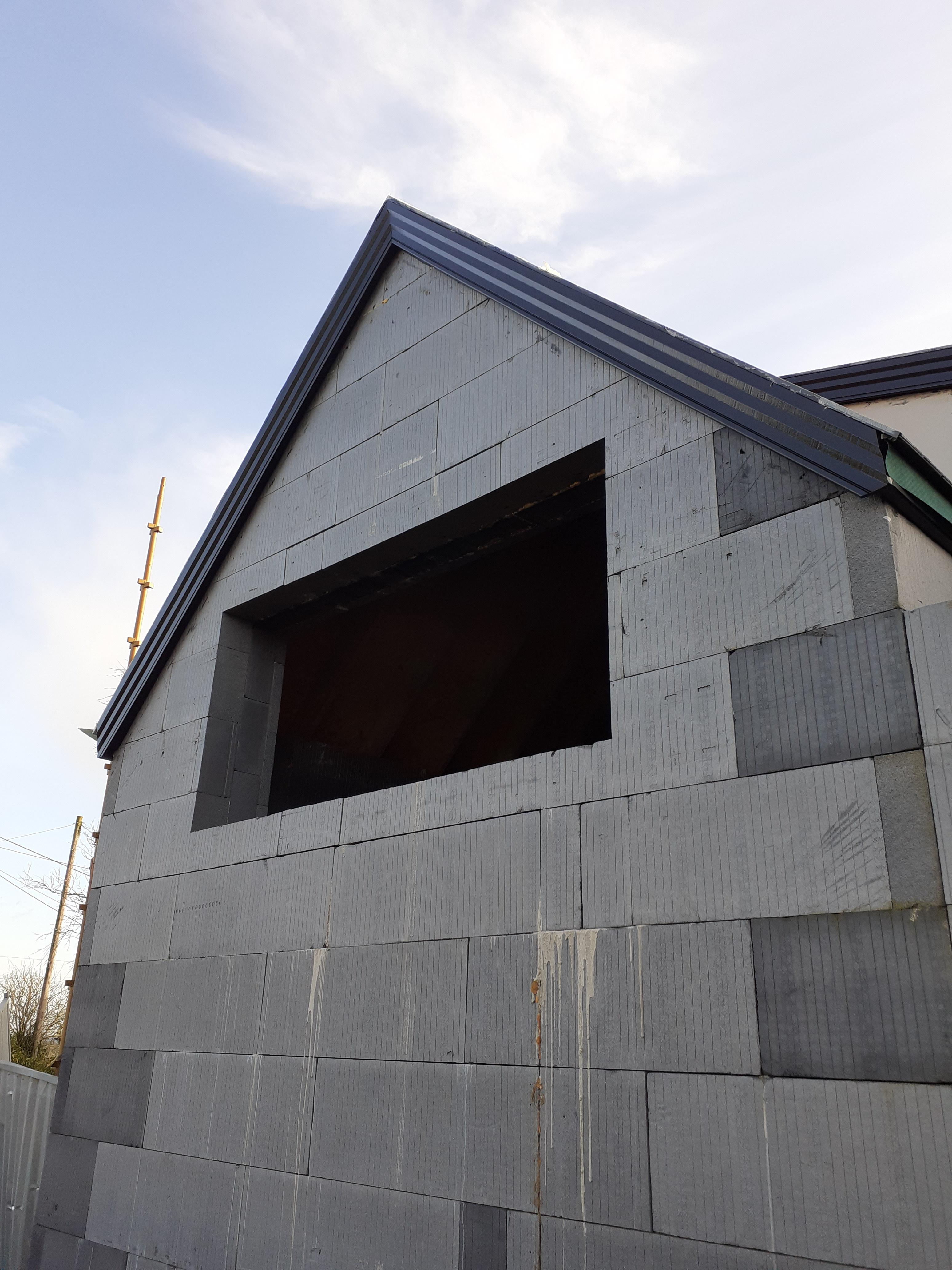

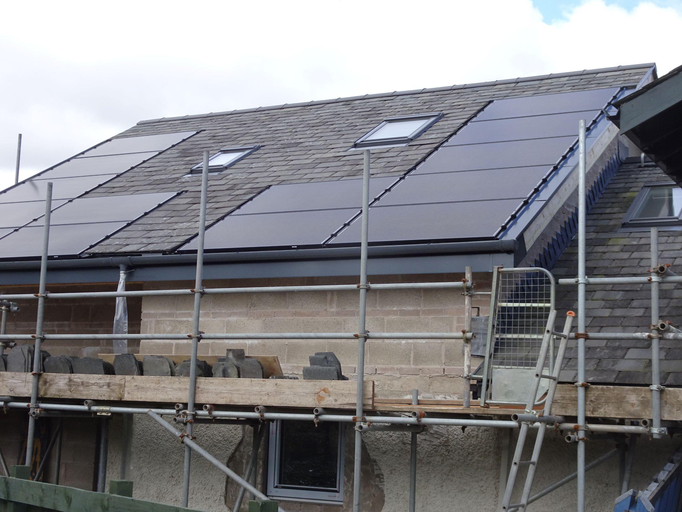

Chablais Posted April 4, 2020 Posted April 4, 2020 Just finished fitting my facias and soffits, chose Marley Alutec facia and barge boards, hopefully no maintenance, and a claimed 50 year lifespan. To keep costs down used plastic soffit. wanted to use the Marley Alu gutters, but had to draw the cost line somewhere, and have fitted Floplast plastic, difference of nearly 2k! saved. Although if the plastic gives up, it will cost to refit safely, as easy now with whole house scaffolded, but a large cost to scaffold just for gutter replacement.

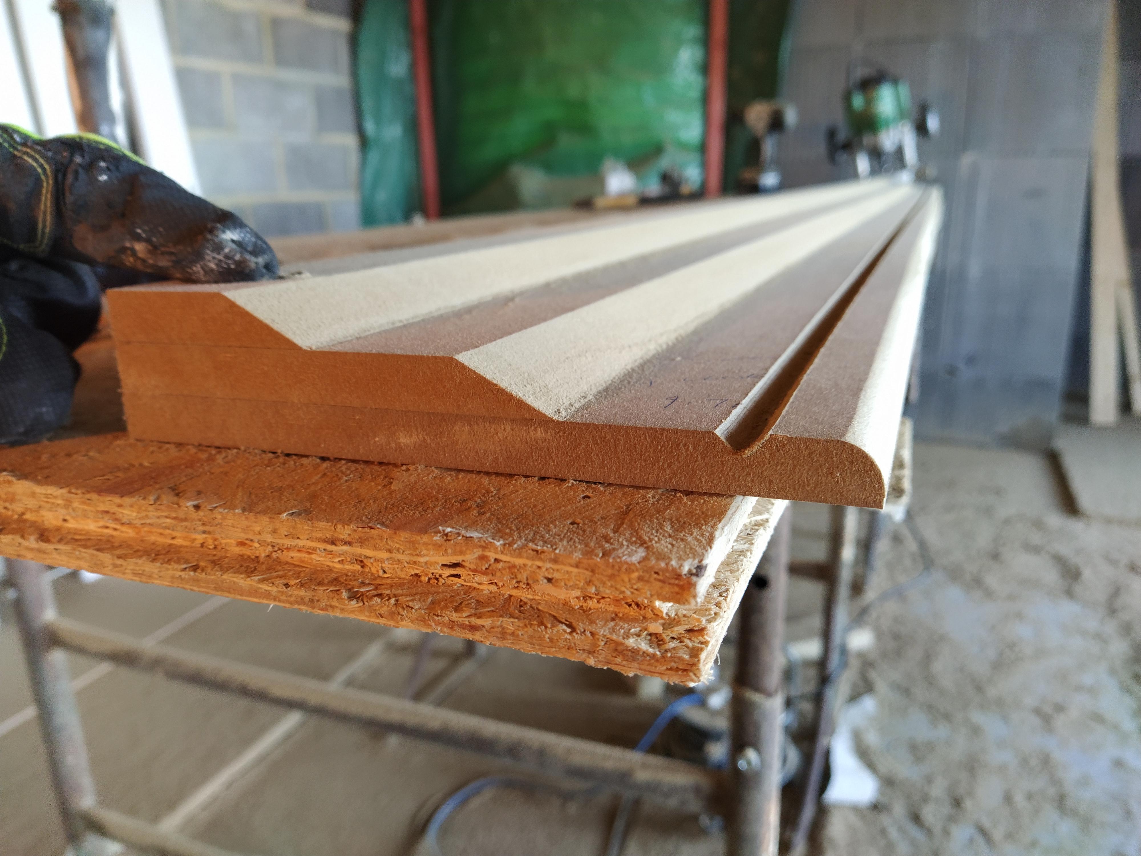

willbish Posted April 5, 2020 Posted April 5, 2020 2 hours ago, Simplysimon said: you could if you wished use accoya or medite extreme mdf as these will give you many years use without maintenabce, price is a consideration though. This is the route I wanted to take but the Medite Tricoya Extreme was prohibitively expensive. I settled for Medite Exterior, which has a 15 year guarantee (instead of 50+) and as long as I keep the paintwork good it should last. 1
