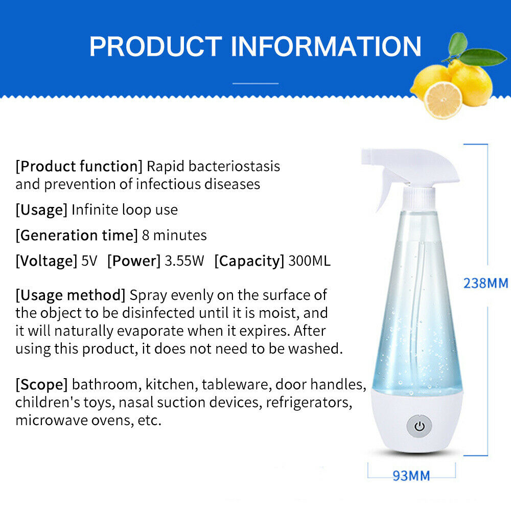

Some progress, although I'm still waiting for stuff to arrive.  Rather bizarrely, the only thing ordered from China, a supposed "hypochlorous acid generator" has been the first thing to arrive.  This is what it looks like:
First thing I did was take it apart to see what's inside and how it works.  It is really simple, just a timer circuit that switches a controlled current through a couple of titanium electrodes that spiral around the base, and which are covered with a plastic grille.  The timer runs for 8 minutes when the button is pressed.  All the instructions are in Chinese and are indecipherable (I've spent an hour trying to just get the basics, to no avail).
I went back to basic chemistry and decided that the starter solution probably needed to be about 1.2g of sodium chloride to 300ml of water electrolysed for 8 minutes at about 1 A, in order to give a solution with about 500 to 800ppm of hypochlorous acid (that's a pretty strong disinfectant, 50ppm would probably just about be OK).  This thing cannot just produce hypochlorous acid, and produces a fair bit of sodium hydroxide in the end solution.  Not enough to cause any significant harm, and it may well mean the solution is a bit better at cleaning surfaces.
The main issue is that the pH increases way above the point where the hypochlorous can remain stable for long.  I ended up with a final pH of around 8, and ideally this needs to be below 5, perhaps down around 3 to give a few weeks of shelf life.  I've tried to assess the free chlorine, as a crude measure of hypochlorous acid concentration, but failed, as my test kit can't work up at this range, which bodes well for it actually having worked (as does the slight smell of chlorine).  I have some stuff on order, including a high range chlorine test kit, that should allow a better assessment of the effectiveness of this thing.  I also have some acetic acid on order, as I want to try lowering the pH to see how that impacts the shelf life.  I'd like to try using very cold water as a starter, too, as that may increase the solubility of the chlorine gas liberated from the anode in the water.  The hydrogen liberated from the cathode when the thing is running is just vented to the air.
Also on order are some larger titanium electrodes, as I want to have a go at making a proper hypochlorous acid generator, one that separates out the hypochlorous acid from the sodium hydroxide, and allows better control of the pH.  This will need an ion exchange membrane to separate the anode and cathode, but I'm hoping I can knock something up using standard waste pipe fittings.
More to follow once I get more stuff delivered.
  • 2 weeks later...
Just finished doing some more experimentation with the Chinese unit bought from eBay.  I managed to decipher the Chinese characters for "salt", "gram" etc in the instructions and found that they seemed way off, 15g of salt for 300ml of water, with a probable electrical energy into the water of about 0.7 Wh.  I tried this, but there was a massive excess of salt left in the solution.  However, reducing the salt to 1.2g, seems to work, although at best it seems that the concentration of free chlorine is only a bit over 100ppm.  I stabilised the pH with acetic acid (white vinegar) so that the starting pH (before electrolysis) was about 4.  I used just a couple of drops of 70% concentrated acetic acid, but if using weaker white vinegar about 2ml might be needed to get the pH about right.  This seems to work OK, and at this pH the solution should be pretty stable.
From what I've read, anything over about 50ppm hypochlorous acid concentration is very effective as a disinfectant, so the ~100ppm solution that one of these units produces should be fine.  It needs to be stored in a cool, dark, place, though, as heat and light will tend to cause it to breakdown more rapidly.  In theory it should breakdown back to sodium chloride, so just plugging it in and giving it another burst of power should bring it back up to full strength again.
The next stage is to try and get the bigger, home made version working.  The plan is to get this to produce pure hypochlorous acid if I can, without the residual sodium hydroxide.

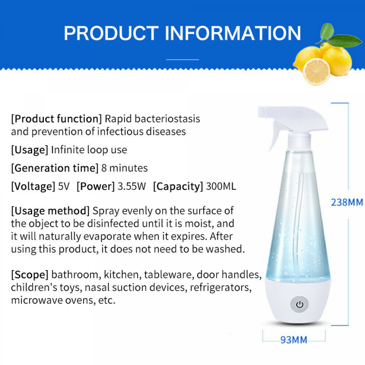

Hello Jeremy,
I found this forum and your post while I was doing research about the electrolyzed water. Someone suggested it as a safer way of disinfecting surfaces at work when we open after the lockdown. Your post was very helpful, however since I am not familiar with chemistry I have a few questions that I will appreciate if you help me with.
https://mangatabox.com/collections/best-seller/products/300ml-disinfection-sterilizing-hypochlorous-acid-water-making-machine-spray-bottle?variant=33571800842299
The model in the link above looks like the one you purchased from China. Most of the similar models advertise them as 'Hypochlorous Acid making machine' but in their description they says it is making 'Sodium hypochlorite' which is different and it's bleach, if am I right? Then they say it is completely safe, chemical free and non-toxic and can be used to disinfect anything even food! This is very confusing as nobody in their right mind would use bleach on their fruits or vegetables!! So I don't understand. Can you please shed some light on this??
Many thanks.
