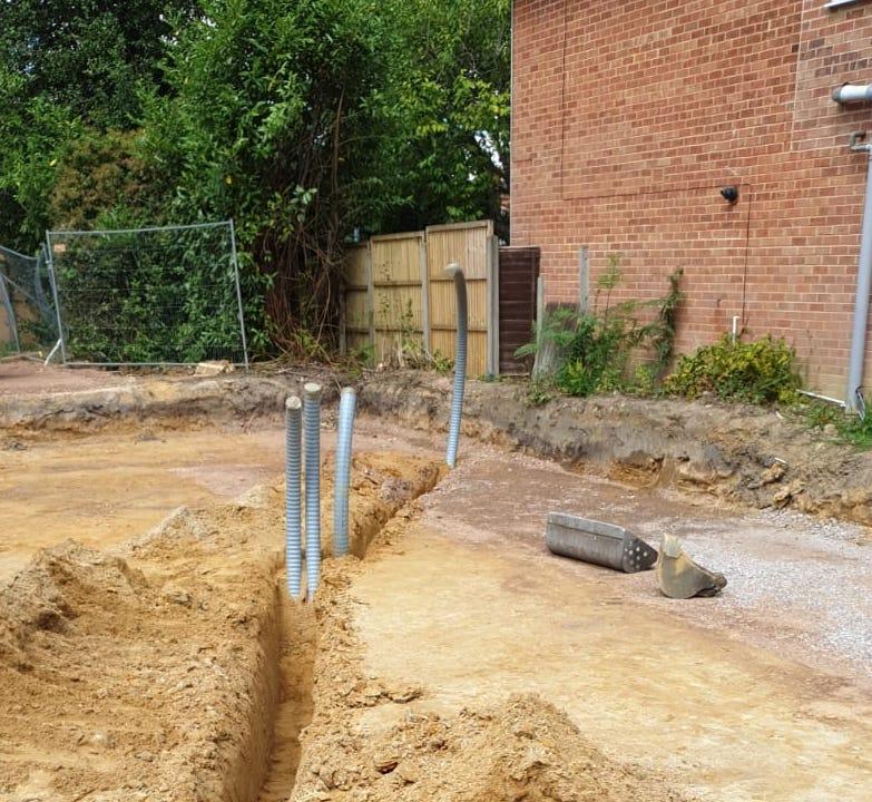

Dan F Posted April 10, 2020 Share Posted April 10, 2020 Just had this discussion with M&E consultant yesterday. He has suggested using 3 seperate ducts rather any more innovative Uponor products just to ensure as much flexibility as possible. Unsure exactly what duct is proposed though, currently allowing 3x75mm ducts. In our case ASHP will be about 6m away. I've seen some people take duct through EPS, but thinking we'll probably just use a pre-insulated pipe and take it under EPS. Link to comment Share on other sites More sharing options...
Dan F Posted June 29, 2020 Share Posted June 29, 2020 These are our pre-insulated pipes put in below the sub-base. 3 x REHAU RAUTHERMEX 25mm+25mm/111mm DUO PIPE 1 Link to comment Share on other sites More sharing options...

Meabh Posted May 18, 2023 Share Posted May 18, 2023 On 29/06/2020 at 17:18, Dan F said: These are our pre-insulated pipes put in below the sub-base. 3 x REHAU RAUTHERMEX 25mm+25mm/111mm DUO PIPE Hi - how deep did you have to go (and across what distance) to get the pipes like this? Thanks Link to comment Share on other sites More sharing options...
Dan F Posted May 18, 2023 Share Posted May 18, 2023 2 hours ago, Meabh said: Hi - how deep did you have to go (and across what distance) to get the pipes like this? Thanks This is directly related to the min bend radius of the product you are using. Rauthermex Duo is 0.6m, which means that if you want the pipe to be vertical up through the concrete slab you need to go 0.6m below this. Link to comment Share on other sites More sharing options...
