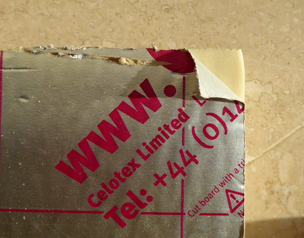

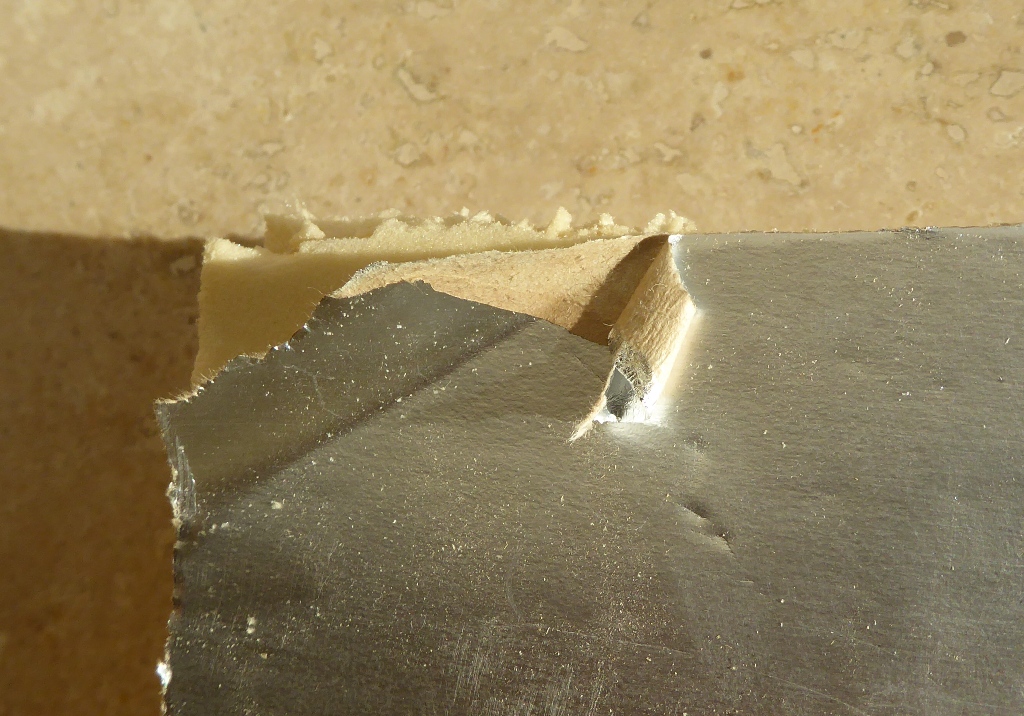

Jeremy Harris Posted September 16, 2017 Share Posted September 16, 2017 (edited) 11 minutes ago, PeterStarck said: That's interesting because I used a small amount of Recticel in my build and that had a reasonably thick aluminium layer. I even went to the bother of sealing all the cut edges with aluminium tape because I thought there was potential for the Pentane or whatever gas it was to leak out. This was several years ago and things may now have changed. I think things may have changed, Peter, as the bit of 100mm PIR I used to insulate our old loft hatch definitely had a shiny aluminium foil layer, much as you describe, but the last sheets of 50mm Celotex I bought (when I was adding insulation to the old thermal store) seemed to have very thin aluminium foil on one side and what looked like silver painted paper on the other. I've no idea what particular type of Celotex it was, it was just whatever was on the shelf at the local BM. It was offcuts of this I used to make an insulated lid to go under our borehole cover, to prevent the pipes from freezing, and when I stuck aluminium foil tape to it, and then pulled it off to correct an error, it was clear that the silver layer was really just like paper. Edited September 16, 2017 by JSHarris Link to comment Share on other sites More sharing options...

Jeremy Harris Posted September 20, 2017 Share Posted September 20, 2017 On 15/09/2017 at 19:22, JSHarris said: The stuff about aluminium "foil" on PIR is just a bit of scaremongering. Go and look at a sheet of PIR. What you will find is that the silver surface is really silver paper, with a thin glass fibre scrim under some types. It is not aluminium foil, as such, or if it is it is only a few microns thick as a coating on some form of binder, and as such there is not enough of it to react in in any significant way with wet concrete, at least not to any degree worth worrying about, let alone debating to the nth degree. This afternoon I pulled a bit of scrap 50mm Celotex out and peeled off the silver layer, and I can say with absolute certainty that it is some form of "silver" coated or painted paper-like material. I'll take some photos on Monday if there is any doubt about this. A bit late, but I got around to digging out the bit of scrap Celotex and taking some photos of the "foil". I will go on and do so reactivity tests with hydrochloric acid and then sodium hydroxide, and a bit of ready-mix mortar later, as they are the strongest alkalis and acid I have readily available. Meanwhile, this is what the two different sides of the sheet sof 50mm Celotex I have looks like, close up, with the surface layer partially peeled off. First, This is the printed side, which seems to be an extremely thin layer of aluminium foil bonded directly to the foam, with no sort of paper or fibre underlay. What looks like fluff is just bits of the surface of the foam that have come away: and this is the non-printed side, that looks a bit duller and seems to be coated woth some type of silver coated/painted paper: The fibrous paper-like material is clearly visible on this side, and it doesn't tear away like the very thin foil on the other side at all. With luck I should have some more photos of how the surfaces look after they've been exposed to cement, sodium hydroxide and hydrochloric acid tomorrow. I suspect the aluminium layer will just get oxidised away, not sure what the effect may be on the underlying foam, or the paper-like layer. Link to comment Share on other sites More sharing options...

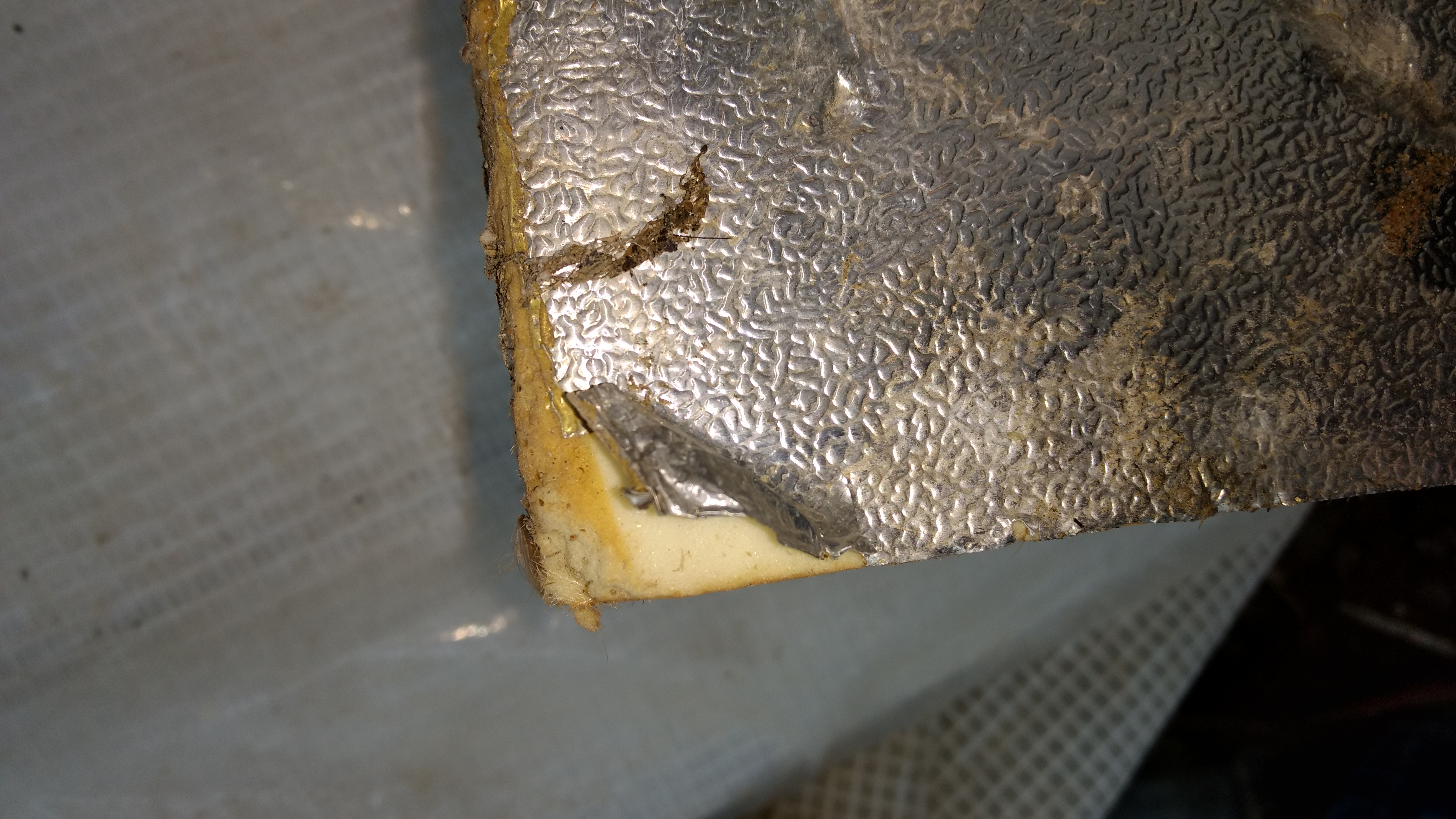

Mr Punter Posted September 20, 2017 Share Posted September 20, 2017 I have some of the Celotex CF5000 and it has proper aluminium facings both sides. It goes grey after contact with cement. Link to comment Share on other sites More sharing options...
Jeremy Harris Posted September 20, 2017 Share Posted September 20, 2017 The foil on that CF5000 looks very different, and much thicker, than the silver stuff on the sheets I have. If nothing else, this illustrates a wide variation in surface treatment between the different types, which is useful to know. Link to comment Share on other sites More sharing options...
najem-icf Posted September 26, 2017 Share Posted September 26, 2017 I had a look at some of the old Ballytherm, Kingspan and Celotex stuff we had laying around and they all seem to have an aluminium coating of sorts. Some are admittedly thinner than others - Celotex especially seems to have a very very thin veil of foil on a backing product - it does look like paper to be fair. @JSHarris have you managed to do some conclusive testing yet? I am now wondering if the reason not to have the concrete come into contact with foil faced insulation is more to do with its reaction with the dummy foil. I still maintain that it is not a good idea to have concrete come into contact with the board at all due to the uncertainties. I prefer to play it safe than to take the risk - a roll of polythene will set you back around £20 for 100m² - hardly breaking the bank and would at least give peace of mind in case the scaremongering is true. The Celotex announcement came as no surprise - people in the industry have been saying it for years. In North America, they refer to PIR/PUR insulation as pure gasoline. Fire crews are told that if a building they are attending an incident at contains PIR/PUR insulation, get everyone out and just wait until it finishes. Almost on a daily basis there is a stick frame building on fire in the US. Also heard that PIR/PUR insulation is going up again in price in October... Link to comment Share on other sites More sharing options...
Jeremy Harris Posted September 26, 2017 Share Posted September 26, 2017 (edited) I have some mortar that's been sitting on one side of a sample of Celotex for a few days now. I'll remove it later and then do a test on the other side of the board, so see what difference there may be between the "silver paper" side and the very thin foil side. I doubt any effect will be significant, as the amount of material available to react, plus the fact that people have put concrete onto foil-faced material without ill effects showing, would seem to indicate that this isn't likely to be a serious real world problem. As to the flammability of PIR, then it's not really very flammable when compared to other foam products, certainly no where near as flammable as EPS or XPS, for example, which has been the fuel for some very nasty facade fires in the past, far worse in many ways than PIR, because of the way EPS/XPS drips burning, molten, polystyrene down walls and over openings. At least PIR just degrades, chars and gives off flammable decomposition products when subjected to continuous heating, yet it remains a solid, albeit a very charred one, on the surface to which it is attached. It also tends to be non-sustaining for small fire (see the "blowtorch test" results, for example), whereas EPS/XPS is very self-sustaining once ignited, the spread of fire through it only really being limited by the availability of oxygen. Edited September 26, 2017 by JSHarris Link to comment Share on other sites More sharing options...
