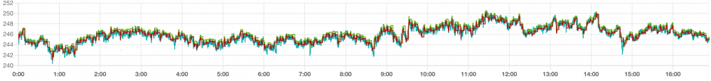

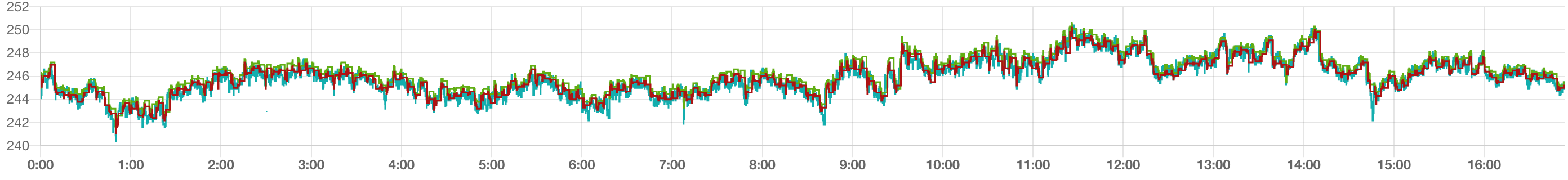

joth Posted February 19, 2020 Posted February 19, 2020 10 hours ago, Jeremy Harris said: 4mm² SWA over that distance would have a voltage drop of about 5.77 V at 16 A, so when the inverter hits the upper cut off voltage of 253 VAC, the voltage at the incoming supply end would be about 247.3 VAC. This is probably a bit tight, TBH, and if it were me I think I'd up the cable size to 6mm², as that reduces the voltage drop to about 3.79 V, so the supply voltage at the incomer can rise as high as 249.2 VAC before the inverter will hit its limiting voltage. At a rough approximation, if the mains supply pre-PV istall regularly hovers around 250V, would this likely be a warning sign for the PV inverter regularly hitting 253V and having to cut out? I only started logging voltage in the house a week ago, but I've not seen it drop to 240V at all, and it's regularly hitting 250V The DNO have approved 8kW G99, but I'm wondering if they saw this area is regularly overvoltage so figure there's no need to reinforce as the inverter will be regularly cutting out anyway.... I guess real question is what happens outside of winter. I see there's a really annoying failure mode here that if the inverter does cut out, it will stop dead any export meaning any dynamic loads (immersion divert or car charing) would also then cut out, which would allow the observed voltage to rise further. Whereas ideally you want to tackle the overvoltage by adding additional loads to pull it down and hence allow the inverter to re-engage.
Jeremy Harris Posted February 19, 2020 Posted February 19, 2020 6 hours ago, joth said: At a rough approximation, if the mains supply pre-PV istall regularly hovers around 250V, would this likely be a warning sign for the PV inverter regularly hitting 253V and having to cut out? I only started logging voltage in the house a week ago, but I've not seen it drop to 240V at all, and it's regularly hitting 250V The DNO have approved 8kW G99, but I'm wondering if they saw this area is regularly overvoltage so figure there's no need to reinforce as the inverter will be regularly cutting out anyway.... I guess real question is what happens outside of winter. I see there's a really annoying failure mode here that if the inverter does cut out, it will stop dead any export meaning any dynamic loads (immersion divert or car charing) would also then cut out, which would allow the observed voltage to rise further. Whereas ideally you want to tackle the overvoltage by adding additional loads to pull it down and hence allow the inverter to re-engage. Yes, the inverter will limit or cut out at 253 VAC. I'm in a similar, but less severe, position, where our voltage never drops below about 243 VAC, even in the coldest, darkest, weather, and often rises to around 250 VAC. Our inverter often limits at 253 VAC on sunny days. I've been trying to get the DNO to reduce the tap on the local transformer, to no avail. They could easily drop a few percent and still be well within the allowable supply tolerance, and we're close to the end of the run from the transformer, so if we're seeing high voltages then those closer will be seeing even higher voltages. In theory, if you report a consistently high supply voltage the DNO will come out, put a voltage logger on the supply and then take action if they record the same. In practice they seem to just ignore requests like this, or have in my case. The UK supply voltage that the DNO must keep supplies within is 230 VAC +10% -6%, so 216.2 VAC to 253 VAC.

joth Posted May 26, 2020 Posted May 26, 2020 (edited) On 19/02/2020 at 07:51, Jeremy Harris said: Yes, the inverter will limit or cut out at 253 VAC. I'm in a similar, but less severe, position, where our voltage never drops below about 243 VAC, even in the coldest, darkest, weather, and often rises to around 250 VAC. Our inverter often limits at 253 VAC on sunny days. I've been trying to get the DNO to reduce the tap on the local transformer, to no avail. They could easily drop a few percent and still be well within the allowable supply tolerance, and we're close to the end of the run from the transformer, so if we're seeing high voltages then those closer will be seeing even higher voltages. In theory, if you report a consistently high supply voltage the DNO will come out, put a voltage logger on the supply and then take action if they record the same. In practice they seem to just ignore requests like this, or have in my case. The UK supply voltage that the DNO must keep supplies within is 230 VAC +10% -6%, so 216.2 VAC to 253 VAC. It's intended for an australian market, but this article is quite interesting. Aside from learning the fact Australia has the exact same 230 VAC +10% -6% requirement as the UK (wonder how that came about...) they have a few more options for recourse- it seem the rules over there are that if the grid is just at 252V but your local observed voltage is rising above it due to the inverter (and a long cable run from the grid), you can seek permission to set the inverter's trip points slightly higher. This is called Volt-VAR mode, perhaps named after California "Rule 21 Volt-VAR requirements" Another option (both there and here) that some people have been sold up to is installing a so-called voltage optimizer (examples: PV+, EdgeIQ) which reduces the local voltage as seen by the inverter. I truly can't understand how this is morally any better than going and fudging the voltage trip-points in the inverter to be +10% higher, but still these things seem widely recommended upsell by PV companies so I presume they're at least legal and maybe even effective. (They're only good for 4kW though so no use for our planned install.) Finally, perhaps the most practical suggestion is to go for a 3 phase supply from the grid to reduce the local voltage increase per phase. Damn- wish I'd thought of that 4 months ago :-( Edited May 26, 2020 by joth
