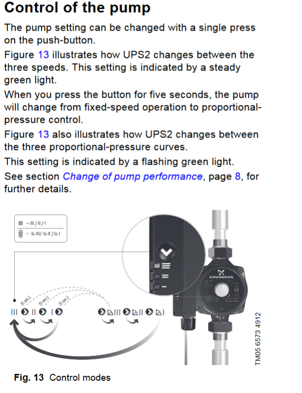

ProDave Posted June 16, 2018 Posted June 16, 2018 I wish I had read these last couple of posts 2 weeks ago. I deliberately bought a Grundfoss pump as I believed they were the best and disappointed to find I can hear it. Strangely it i quietest on it's fastest setting, at slow speed it has a pronounced drone. By comparison the "no name" pumps that came with the UFH manifolds are silent.
Guest Alphonsox Posted June 16, 2018 Posted June 16, 2018 On 16/06/2018 at 09:44, ProDave said: I wish I had read these last couple of posts 2 weeks ago. I deliberately bought a Grundfoss pump as I believed they were the best and disappointed to find I can hear it. Strangely it i quietest on it's fastest setting, at slow speed it has a pronounced drone. By comparison the "no name" pumps that came with the UFH manifolds are silent. Expand Have you got them on the correct curves/settings. I found mine was noisy on the constant speed curves but got a lot quieter on the proportional pressure curves. (also got rid of the water hammer issue I was having).
ProDave Posted June 16, 2018 Posted June 16, 2018 On 16/06/2018 at 09:51, Alphonsox said: Have you got them on the correct curves/settings. I found mine was noisy on the constant speed curves but got a lot quieter on the proportional pressure curves. (also got rid of the water hammer issue I was having). Expand It has 3 selectable speeds, no mention of curves. Oddly the fastest speed is quietest, at the slower speeds it has a very pronounced irrirating hum.
Guest Alphonsox Posted June 16, 2018 Posted June 16, 2018 On 16/06/2018 at 10:13, ProDave said: It has 3 selectable speeds, no mention of curves. Oddly the fastest speed is quietest, at the slower speeds it has a very pronounced irrirating hum. Expand Interesting - Which model number did you end up going for ?
Guest Alphonsox Posted June 16, 2018 Posted June 16, 2018 On 16/06/2018 at 10:55, ProDave said: The standard, tried and trusted UPS2 Expand You have done exactly what I did - failed to RTFM ? You get to the proportional pressure curves as described below.
ProDave Posted June 16, 2018 Posted June 16, 2018 Every day is a learning day on BuildHub. That has certainly made it near silent, but I expect the flow is MUCH lower now. I will have to check on the flow meter if it is enough.
