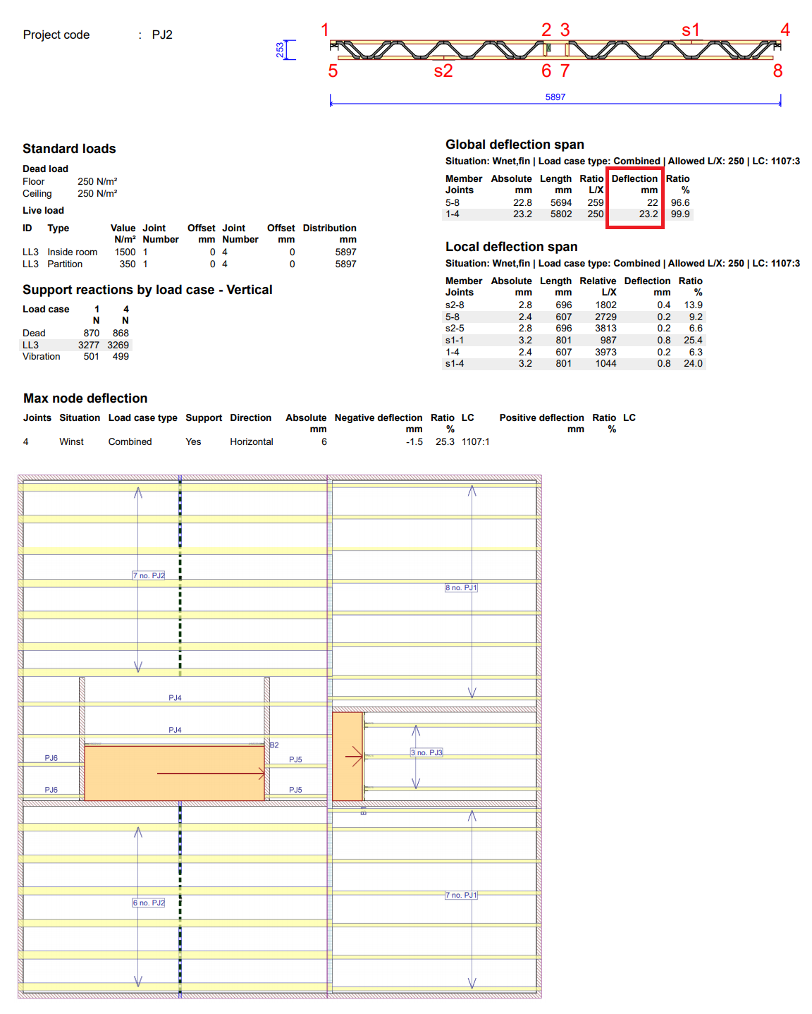

I have got a quote and design for the first floor with metal open web joists (Wolf) and wonder if these deflection criteria equate to a good solid floor with little bounce?
Quote
Floor Load Set = Domestic + Partitions - EC5
Floor dead + imposed load = TC=1500+350+210N, BC=200N
The longest clear span is 5.45 meters.
Without prompting from me the designer spec'ed 400mm centres and 256 deep joists. The wood chord width is 97mm on the longest joists.
The reason for this post is that previously a forum member suggested specifying a design deflection limit more demanding than the industry standard. However in the past few years the UK floor design industry has switch to a European technical standard so I do not know how to specify a better floor when requesting a quote.
The designer of the first quote has responded by saying "We can increase the thickness of the timber on the longest spans where you might feel the most bounce. Although this would increase the cost it would not be significant".

From my limited knowledge what i understand is that deflection limit should be 0.003 times the span, with a maximum deflection of 14mm (with strutting), 12mm (without strutting). http://www.newbuildinspections.com/wp-content/uploads/2016/06/LABC-Warranty-Technical-Manual-V8.1.pdf  page 32
So for that max span of you are into the 14mm/12mm maximum.
There is an interactive span calculator for MiTek metal web joists which may be useful to you, as it calculates deflection for different joist constructions
https://www.mitek.co.uk/span-calculator/
For 5500mm the PS-10 posi at a 253mm depth @ 400 C's (97mm width) its calculating a 12.52mm deflection.

As I have suggested previously, if you specify that you require maximum 8mm or 0.002 x span (whichever is least) deflection there will be no issues with bouncy floors and the cost difference is fairly small.
The standard you will be offered is 12mm or 0.003 x span which is crappy.

The floor designer explained the new European standard is max permanent deflection under load including an extra allowance for material creep over a period of time. My understanding is that reduced bounce, which we householders use to assess how solid a floor is, comes as a by product of reducing static load deflection.

5700 PS-10 253 400 122 11.97
That is a total span inc end bearing of 100mm each plus your span and it’s a 253 at 400 centres with 122mm chords and less than 12mm deflection - make sure you put the strongbacks in, and glue down the egger boards and that is not going to move.

12mm is acceptable for the housebashers but if you are a self builder, get a quote for less than 8mm deflection if you want a really solid feel to the floor.

Presumably deflection numbers are calculated with an industry standard reference load?
1 minute ago, epsilonGreedy said:
Thanks I might stir this into the conversation with the floor designer on Monday.
Yes, and those were the loadings in your first post
