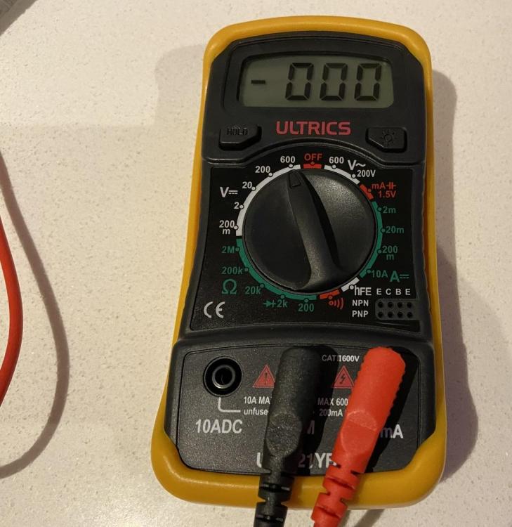

ProDave Posted February 1, 2020 Posted February 1, 2020 I asked earlier if you have a multimeter? If you do, follow the cable coming out of the valve head it will go to a junction box or a wiring centre. Measure with the multimeter set to ac volts between the brown and the blue core. If there is no voltage, it is a control fault. If there is 240V there and the valve is not opening then the motor has gone and you need to replace the valve head. 1
H F Posted February 3, 2020 Author Posted February 3, 2020 Thanks for all the input above. I was going to action stuff today and woke up to all our thermostats and Heatmiser central wiring box dead. I’m guessing this was all interconnected. Some sort of electrical issue. Trying to get an electrician out to help us and test what’s gone wrong. On that note, we have new Neostat thermostats - do we have to go with a Heatmiser central wiring box or will another brand work Ok?
H F Posted February 3, 2020 Author Posted February 3, 2020 On 01/02/2020 at 09:09, ProDave said: I asked earlier if you have a multimeter? If you do, follow the cable coming out of the valve head it will go to a junction box or a wiring centre. Measure with the multimeter set to ac volts between the brown and the blue core. If there is no voltage, it is a control fault. If there is 240V there and the valve is not opening then the motor has gone and you need to replace the valve head. No, I don’t have a multimeter.
joe90 Posted February 3, 2020 Posted February 3, 2020 20 minutes ago, Home Farm said: No, I don’t have a multimeter. £1.99 https://www.screwfix.com/p/roughneck-electrical-mains-tester-screwdriver-100-250v-ac-slotted-3-0mm-x-80mm/9019x
H F Posted February 3, 2020 Author Posted February 3, 2020 31 minutes ago, joe90 said: £1.99 https://www.screwfix.com/p/roughneck-electrical-mains-tester-screwdriver-100-250v-ac-slotted-3-0mm-x-80mm/9019x I need to invest in one... for sure
H F Posted February 3, 2020 Author Posted February 3, 2020 I spoke to the support team at Heatmiser and they suggested that perhaps the motorised valve shorted out the circuit board on the wire control box. Does that sound remotely viable? I’ve ordered my multimeter and will test the motorised valve when it arrives. I will also replace the fuse in the heat miser to see whether that allows it to turn back on

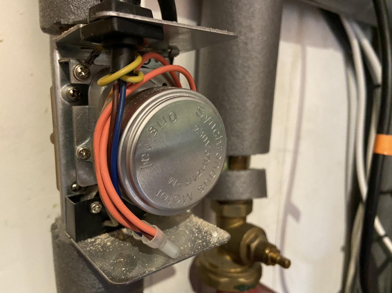

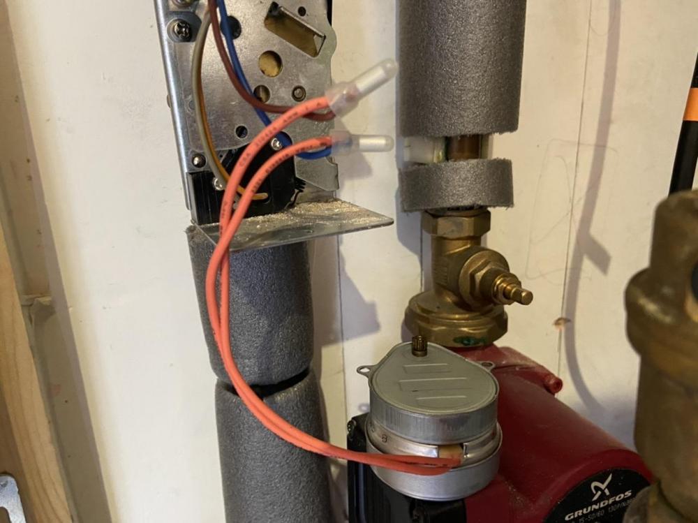

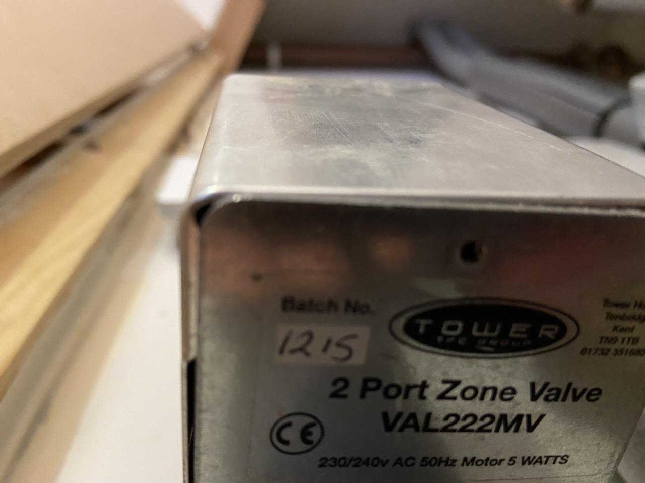

H F Posted February 4, 2020 Author Posted February 4, 2020 On 01/02/2020 at 09:09, ProDave said: I asked earlier if you have a multimeter? If you do, follow the cable coming out of the valve head it will go to a junction box or a wiring centre. Measure with the multimeter set to ac volts between the brown and the blue core. If there is no voltage, it is a control fault. If there is 240V there and the valve is not opening then the motor has gone and you need to replace the valve head. we have 240v between brown and blue core. the pipe underneath the motorised valve, leading to the manifold is cold. The pipe above it is hot. does this indicate having to change the valve motor?

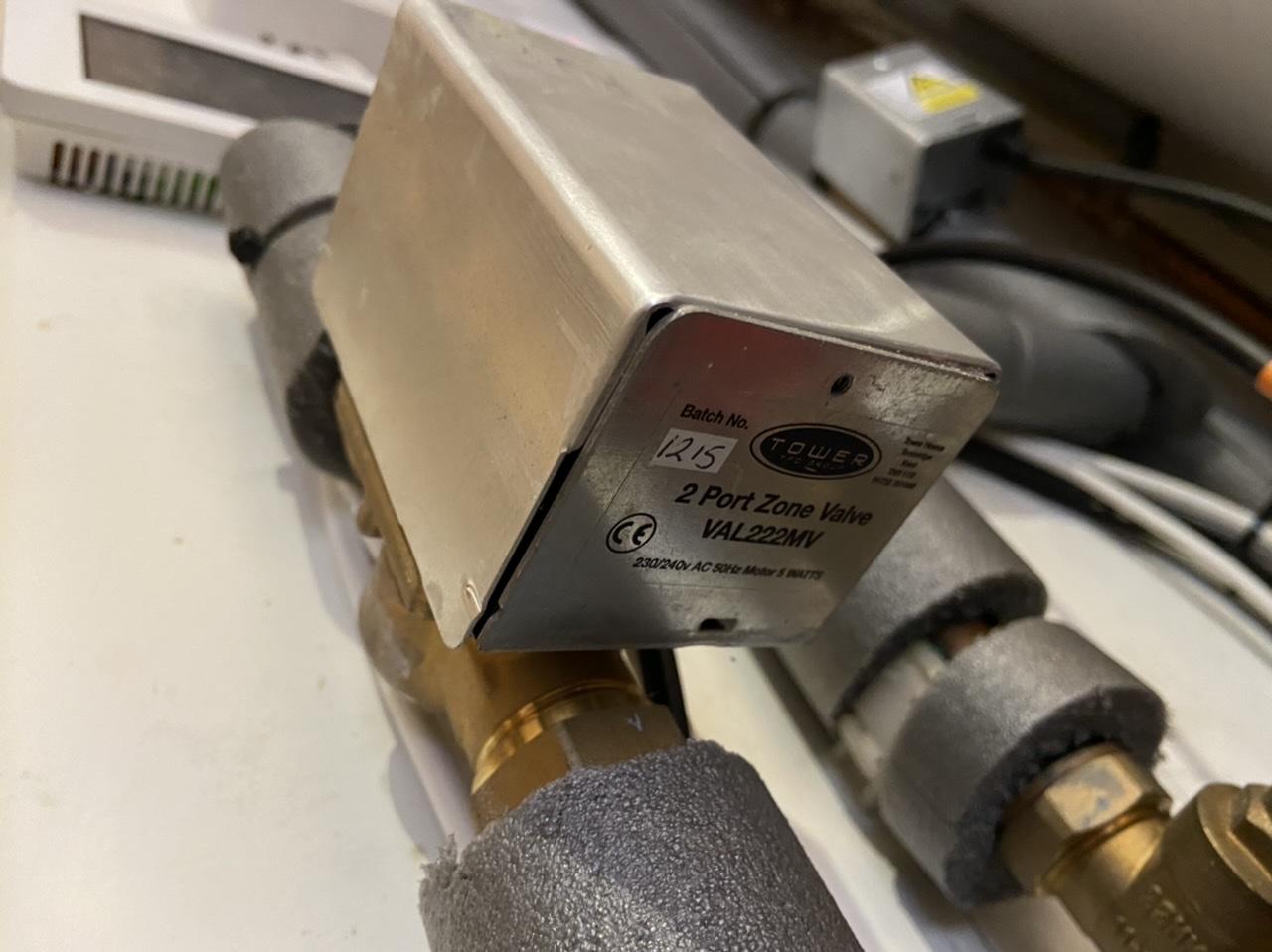

PeterW Posted February 4, 2020 Posted February 4, 2020 Sounds like a dead head - easily changed. Got any photos of the clips holding it on or the manufacturer name on it.?
H F Posted February 4, 2020 Author Posted February 4, 2020 Video of the motorised valve. IMG_1806.MOV
H F Posted February 4, 2020 Author Posted February 4, 2020 This is the unit my local hardware store has.

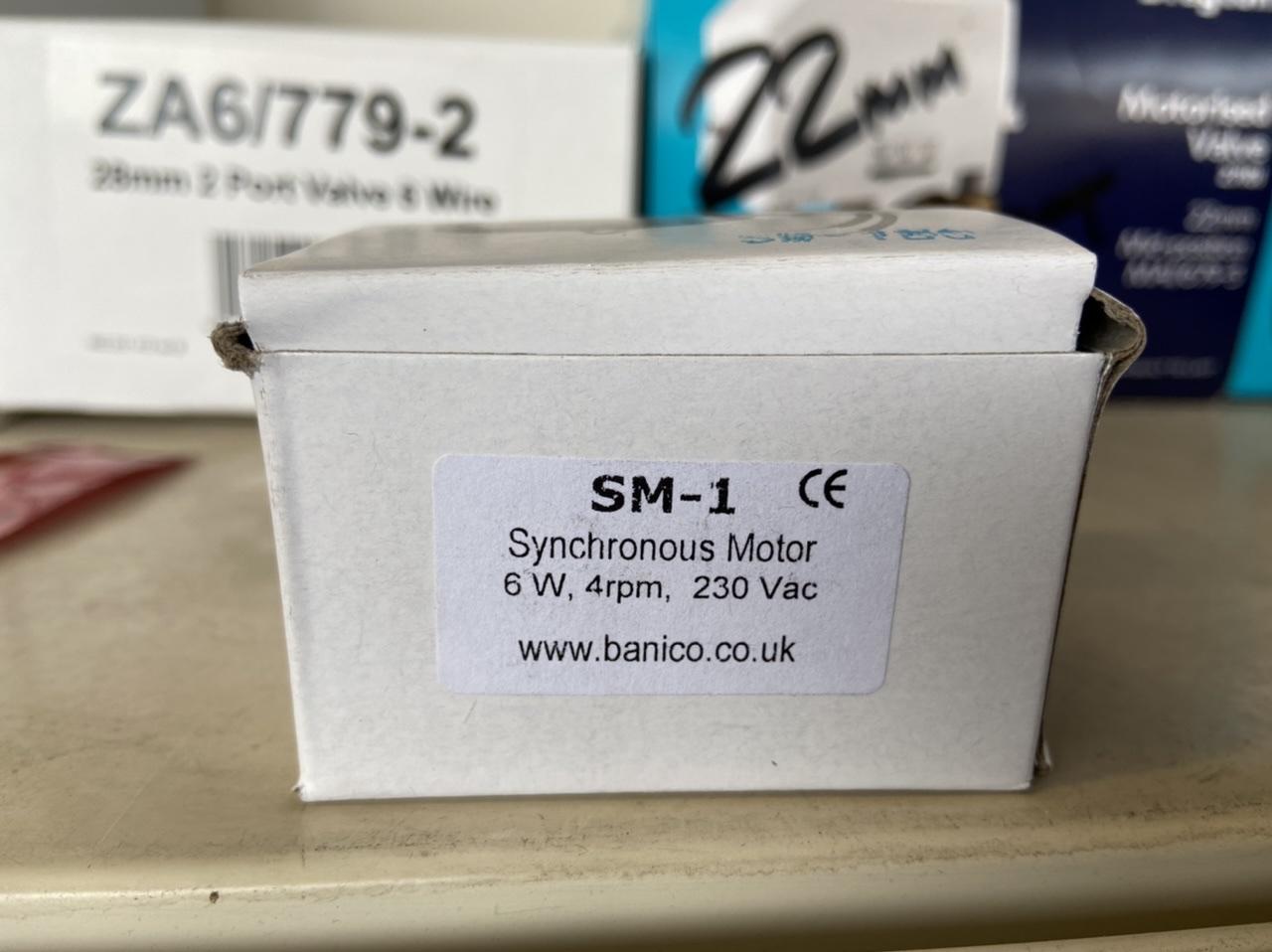

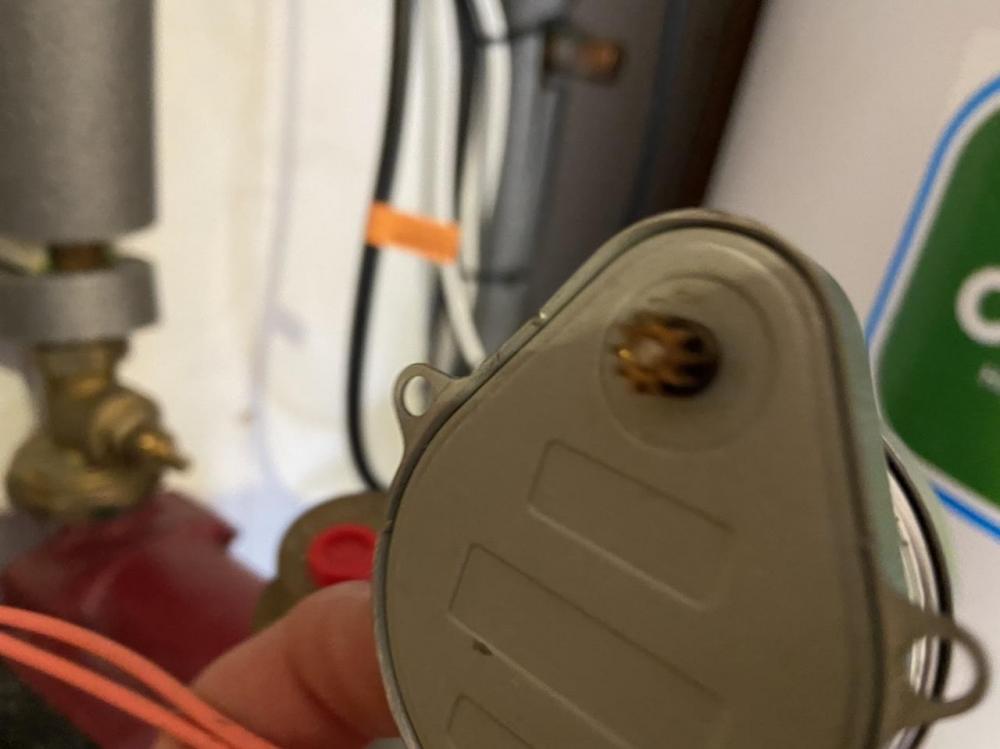

PeterW Posted February 4, 2020 Posted February 4, 2020 Standard synchro unit - how handy are you as you can change the motors but full heads are easier.
ProDave Posted February 4, 2020 Posted February 4, 2020 The Tower units are a cheaper (almost) copy of the Honeywell valves. You have to take the cover off the actuator and there are then 2 screws that hold the actuator to the valve body. You can get the Tower units cheap on ebay. https://www.ebay.co.uk/itm/TOWER-MOTORISED-ZONE-VALVE-ACTUATOR-HEAD-2-PORT-22mm-28mm-CAN-REPLACE-HONEYWELL/392072887213?hash=item5b495d7bad:g:sIAAAOSw37tWAsTx
H F Posted February 4, 2020 Author Posted February 4, 2020 2 hours ago, PeterW said: Standard synchro unit - how handy are you as you can change the motors but full heads are easier. Thanks Peter. Handy skills are improving every day what is the head, and why would that be sufficient to address this issue I’m now facing?
H F Posted February 4, 2020 Author Posted February 4, 2020 Sorry for all the questions, but is the head visible here?
