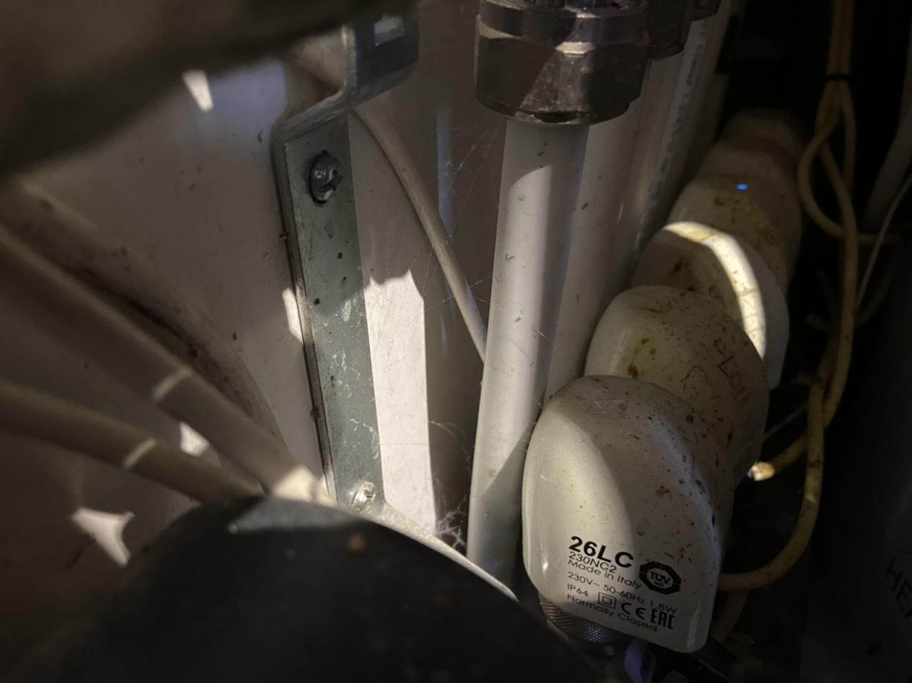

Look at the UFH manifold.  Can you hear the pump running?  Do ANY of the pipes feel warm?  Are there flow meters if so what do they show?  Some types of actuator have a tell tale when open do yours?  Any pressure or temperature gauges? If so what do they read?

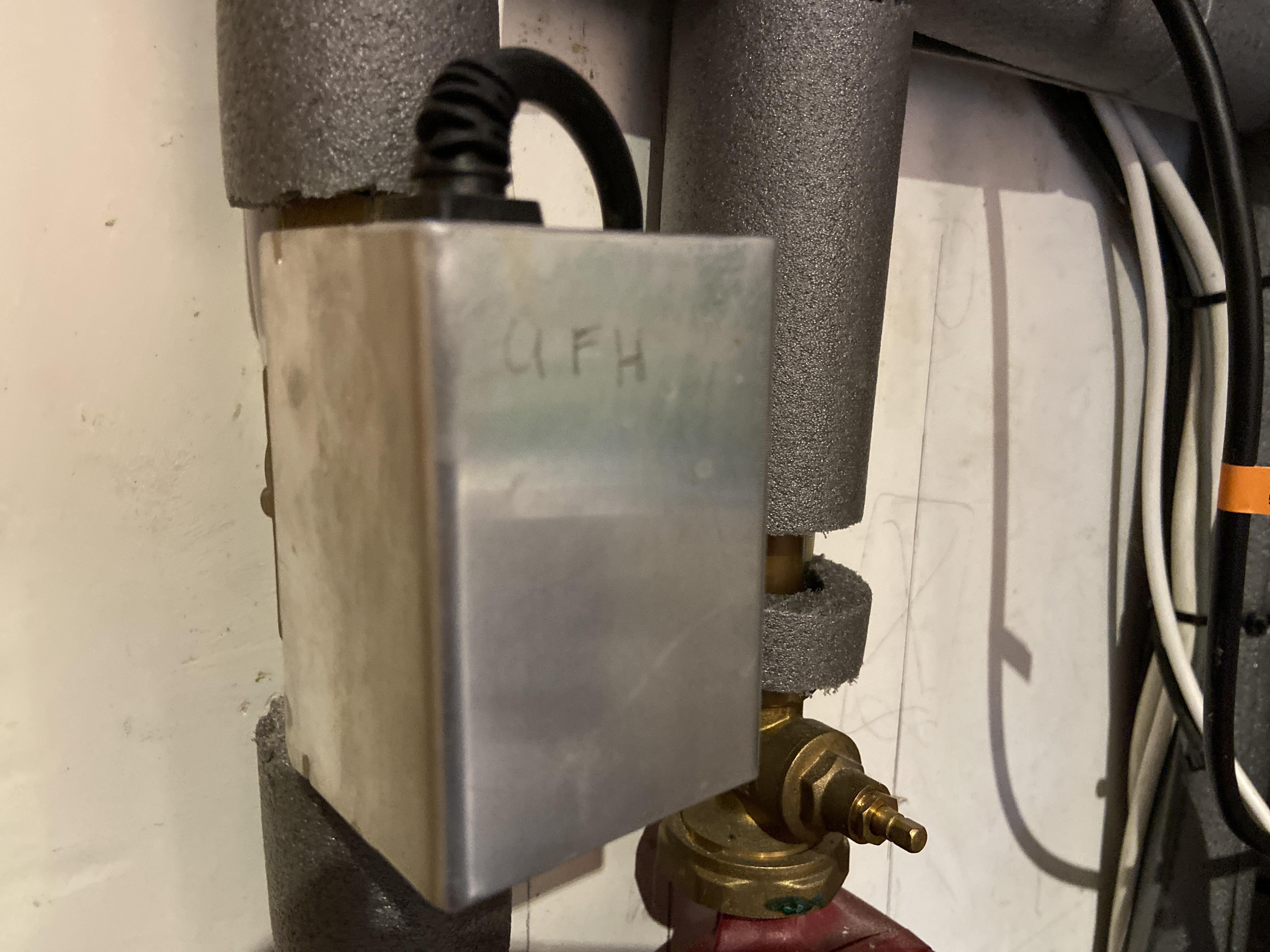

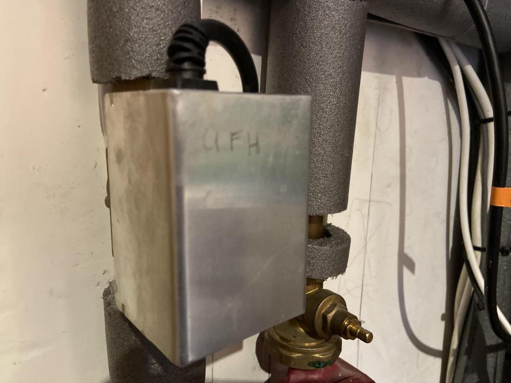

The reason for asking is because the pipe below it, leading the manifold was cool - above it very hot. It was on auto... when I moved it and hold it to open the pipe below hot instantly hot...
can I leave it on open as opposed to auto?
Edited by Home Farm
2 minutes ago, Home Farm said:
What do these things do?
That is a motorised valve.  When you turn on the UFH that should be energised to allow the hot water to flow to the manifold.
It also has a feedback microswitch that may or may not be used to tell other bits of the controls that it is open.
If it is not opening when it should, that can either be because the thing that turns it on is broken, or the motor inside it is broken.
Do you have a multimeter and know how to use it.?
Can I leave it on open as opposed to auto? Do you think this could be the cause?
Try it and see.  If that gets the UFH working then that is progress but is not the problem "fixed"

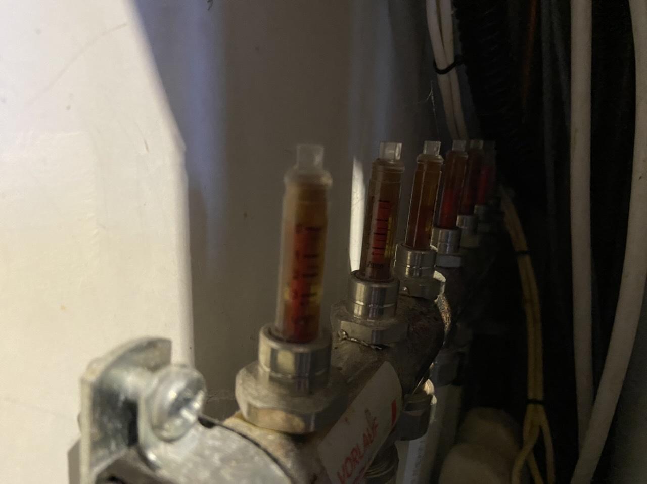

no flow metre... I’ll take a photo of the manifold now...

Those are your flow meters.  If they were full of nice clean water you would see a "float" that rises and falls to show the flow rate.

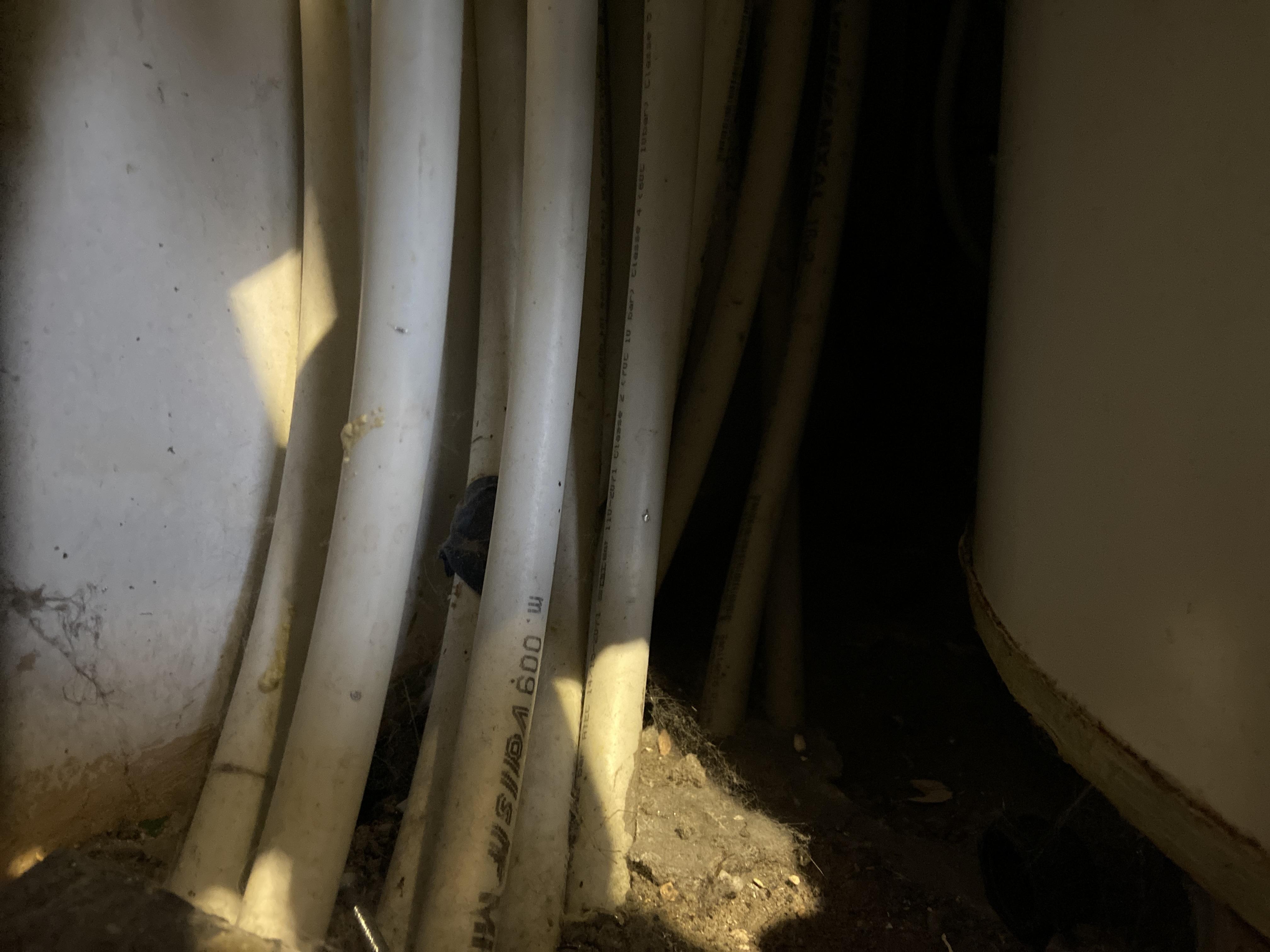

Now you have opened the motorised valve manually, do you feel warmth in the pipes heading off from the manifold down into the floor?
I think it is...
these plastic pipes run out if the manifold and the UFH I’m assuming. None of the are warm... in fact they’re cool. I assume they should be warm.
also noticed only one light on the UFH - it’s really dirty in there.
All the lights are back on and the temperature of the plastic pipes is warming up... underfloor heating in the first zone is warming up.
