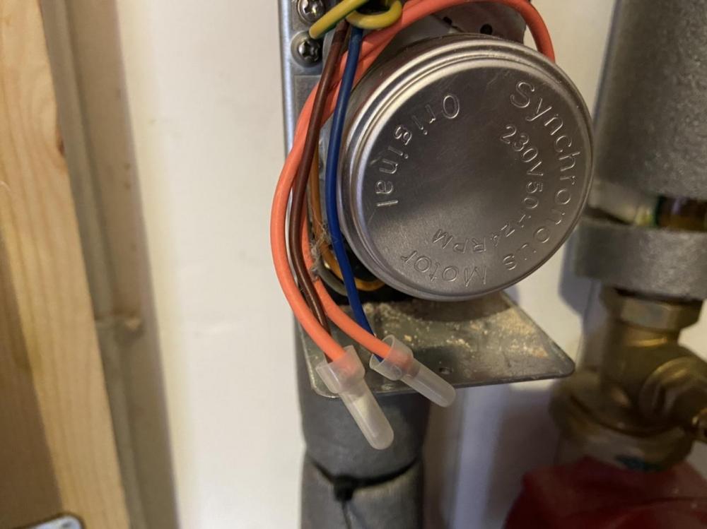

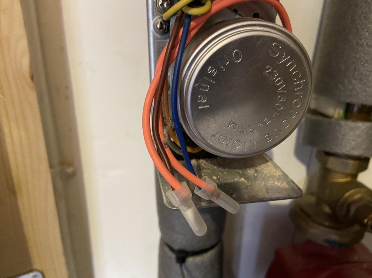

For the test, can I just remove the plastic caps and apply the terminals here.
I just got a decent jolt trying to put one of the caps back on.., a reminder that I’m working with electricity.
just push the multimeter pin inside the plastic from the top where the wires go in and the black one on the casing or the earth connector.
Red terminal on live (brown) cable, black terminal on casing and earth reads zero.
Edited by Home Farm
Just now, PeterW said:
And is that with the heating on ..??
Yes, the central heating (air source heat pump) is on, and all the underfloor heating thermostats are calling for heat.

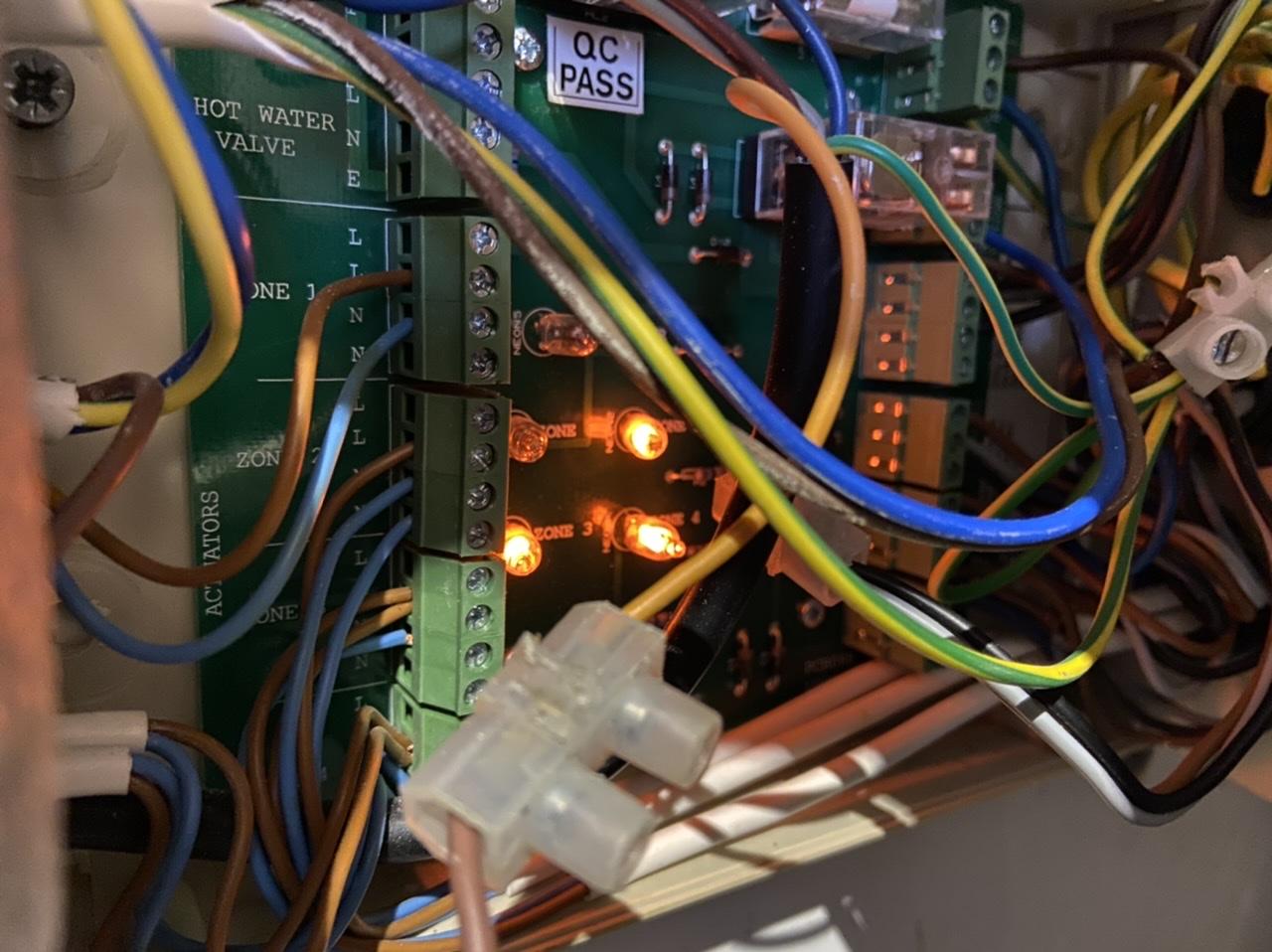

The Heatmiser central wiring box is also on with all the zones marked as on shown via little lit LEDs.
And you’ve definitely got a good connection to the brown wire ..??
Next stop is take off the cover on the wiring Centre ...
Heatmiser board...
The cover is off.
Yes, the connection was good. Can’t touch it because it zapped me earlier, but was a good contact - didn’t realise it would.
Are you sure? You said you got a belt? To get a belt something must exist...
On your PCB I can see marked zones, which zone is this valve on - are you getting 240 across live and neutral on the board and the respective zone terminals? The next thing I would then do is confirm that the other end of that wire, i.e. at the valve is delivering power - which I think it will be given you got a jolt.
Could wire damage be present anywhere? A damaged neutral/earth but an OK live would result in 0V  across the 2 wires yet still very much live!

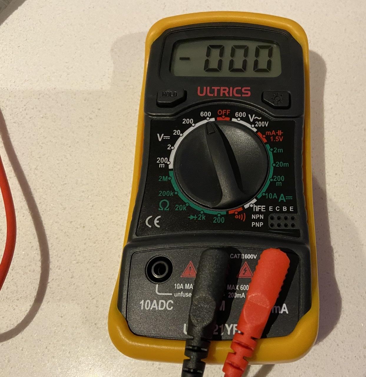

I’ll check the multimeter and try again.
Metre is on V. This is interesting. On 2, 20 and 200 it reads a battery at 1.5V. On 600, it reads zero. Is the meter broken?
Photo of metre settings - just showing how it’s set when I tested it.
Edited by Home Farm
It's V (squiggle) 600 you need, round to the right.
Ahh. I’ll try again.
Success, despite a shot of bourbon and didn’t shock myself again.
Reading was 246.
So when working with home electrics, do I stick to the right? 600 and 200 V (squiggle)?
So why did I have to use the squiggle for this test?
Pertaining to my test, have we now identified that the motor on the valve needs replacing?
Because mains electric is Alternating Current.  The V (dash dash) is Direct current, you'd use that around a car or to test batteries etc.

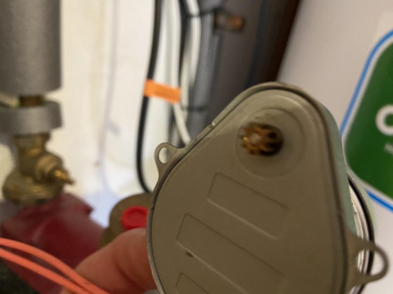

Ok. We’ve determined that power is getting through to the live cable. I took the motor off, and switched off all call for heat from all thermostats.
my wide then turned it on while I watched the motor and the spinny thing on the back of the motor is not turning. I waited for a minute.
Fair assumption that it’s the motor that needs replacing?
