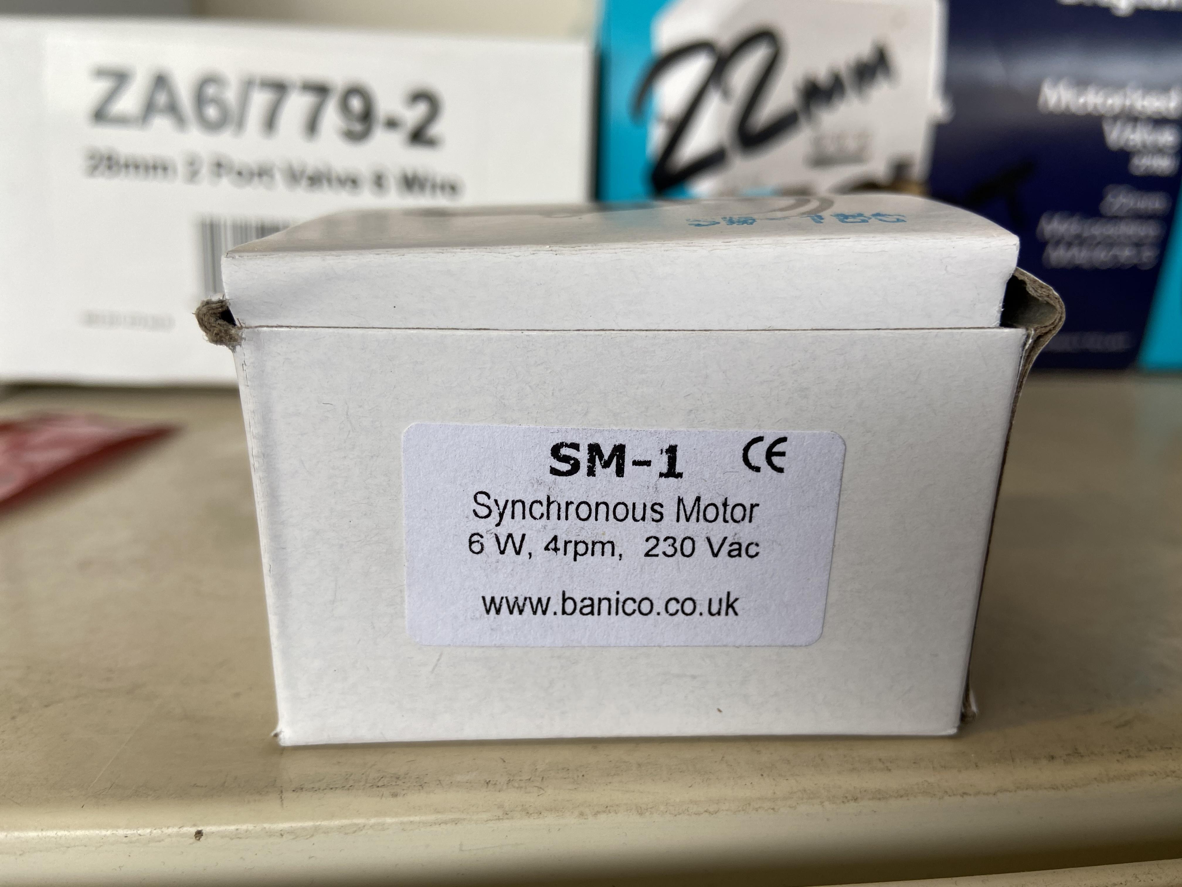

2 minutes ago, Home Farm said:
Sorry for all the questions, but is the head visible here?
All the bit inside the steel box is the head. The motor is part of it, as is the microswitch etc
The brass bit that it is mounted on is the valve.

so this is the head? I know it says motor, but it’s tiny and when I looked at it the shop through the bubble wrap it looked like the head.
Before I comment the actuator lights on the manifold and all thermostats are calling for heat, but no hot water is getting through in auto.
when I open it (manual) hot water gets through as the pipe heats up instantly.
I assume this is all pointing to a head replacement. This is another steep learning curve for me.
thanks to everyone for your patience.
According to the part no. on the side and a quick Google search it appears to be just the motor with an integral gearbox:
https://www.screwfix.com/p/drayton-synchronous-motor/28670?tc=ET5&ds_kid=92700020956158103&ds_rl=1241687&ds_rl=1245250&ds_rl=1249404&ds_rl=1249799&ds_rl=1245250&ds_rl=1249481&gclid=CjwKCAiAyeTxBRBvEiwAuM8dnb3pVx19nwtu5X8NA6JZ5eL4liyTvPdCK_LVKYXDA2ldTHlkdaMLIxoCQQoQAvD_BwE&gclsrc=aw.ds
Note the brass pinion gear as mentioned above.
I would pull the motor off, then have someone call for/cancel the call for heat (wait a bit between as it is not always instant) and see if the motor spins - just leave it hanging safely and watch it.
Then look into the hole where the pinion gear goes and see if you can see mashed teeth - if mashed teeth this motor will not help.
Edited by Carrerahill
No, I think the SM-1 is just the motor. The list price for the SM-1 is £12, a head will be nearly three times the price.

Sorry guys. I’m so incredibly confused. Is the motor inside the head? These parts are all looking the same to me.
Can I use the Drayton inside my existing chassis?
Is the motor visible in the pic I attached previously?
Yes the silver round thing, also look at my link to Screwfix which shows what it looks like in isolation. Look like it will be 2 or 3 small screws that hold it on and 2 wires which you can just leave alone.
On the back of your motor, it says Synchronous Motor - Original - 230V etc... then there is a code, what is the code, I can't quite make it out. However, looking at your motor, and the box you posted a photo of and the cross reference of the part No. I did, I think yes from what I can see.
You could always take your motor to the parts store and ask to compare the new one out the box.
Look at my link and your motor, they certainly look very similar to me... they all tend to use the same motors and parts as few people actually make them, Drayton & Honeywell etc.
However, if in doubt run the part no. physically engraved in the back of your motor through Google and check. What make of valve do you have?
