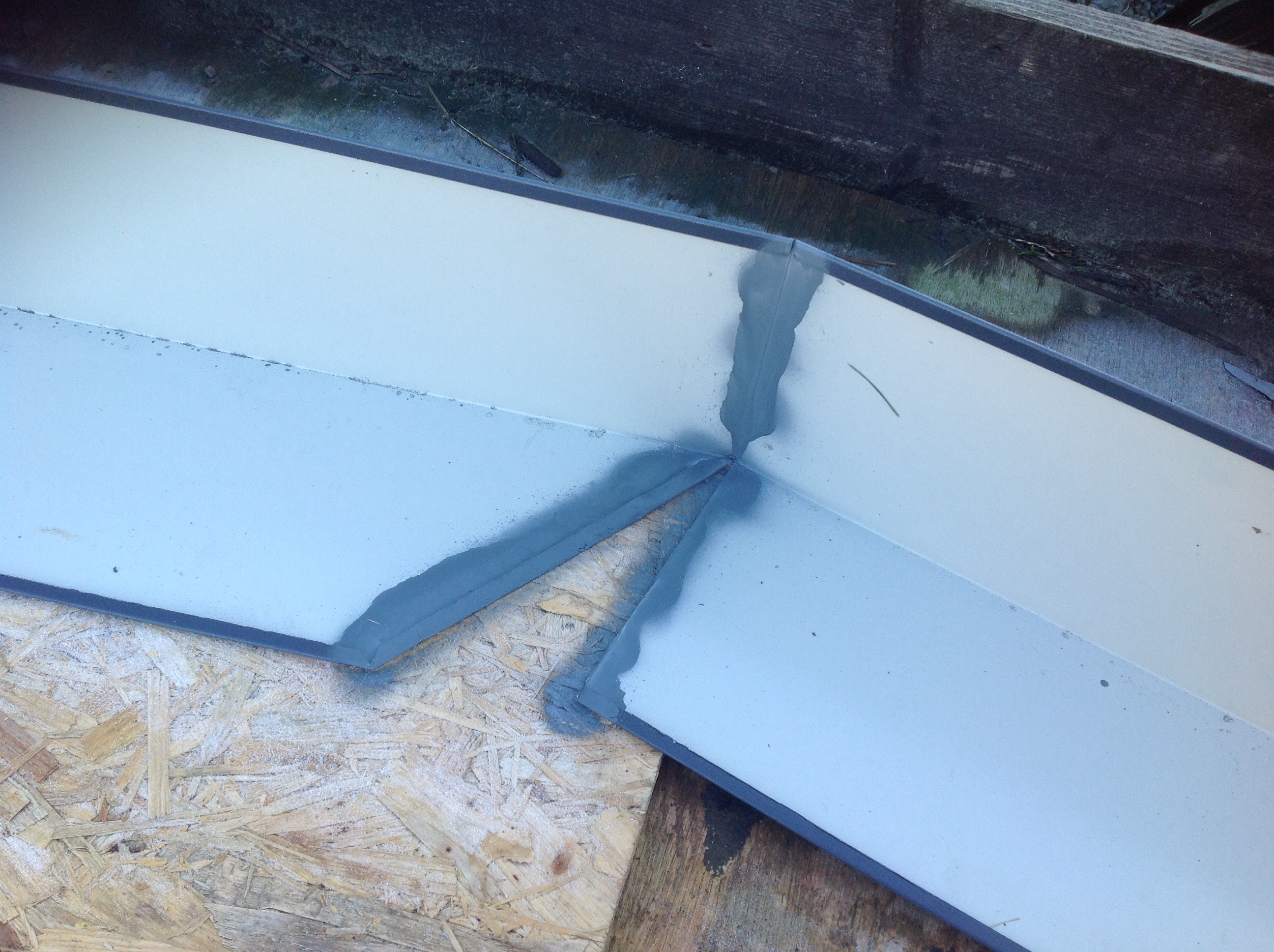

Crofter Posted February 11, 2017 Share Posted February 11, 2017 Fitted the barge boards today. Here's what I ended up doing at the apex- a single board cut and bent in the middle to provide amore weathertight cap. I scored and then folded the cut edge so as to preserve the PVC coating, and gave any bare metal a quick going over with a can of zinc spray. Maybe a bit OTT but it worked out quite well. Pic shows the barge board from the inside, prior to bending it to match the ridge angle. Link to comment Share on other sites More sharing options...

PeterW Posted December 26, 2018 Share Posted December 26, 2018 On 09/12/2018 at 20:30, Oz07 said: Reviving this thread. Anyone have the kahunas to risk a box profile on a garage with 3" of fall over 3m?! Obviously against manufacturers recommendations but I've come across fibre cement roofing at similarly low pitches which hadn't leaked. You’ve got 1:33 or so, that’s not a shallow slope and will shed water quickly. The wall detail will be the main point to get right as it’s there that water may pool if it snows etc. Worth looking at ensuring that is as watertight as possible and the lower end is free flowing. Link to comment Share on other sites More sharing options...
Ferdinand Posted December 26, 2018 Share Posted December 26, 2018 (edited) 1 hour ago, PeterW said: You’ve got 1:33 or so, that’s not a shallow slope and will shed water quickly. The wall detail will be the main point to get right as it’s there that water may pool if it snows etc. Worth looking at ensuring that is as watertight as possible and the lower end is free flowing. I have a conservatory which is approx 100mm over 4.2m, and that has been fine except when the wind blew water back under the point where the flashing attached not quite sufficiently to the roof. if you use a formed piece of roofing at the wall that should be OK .. I used the original Ubiflex, which was problably a bit too much Ubiunflex. THe lighter version of that should be fine, or a formed piece. F Edited December 26, 2018 by Ferdinand Link to comment Share on other sites More sharing options...
Oz07 Posted December 26, 2018 Share Posted December 26, 2018 will be mono pitch spanning two brickwork walls. Will bargeboard be suitable at top end? (with roof sheets slightly proud of wall) then maybe line of silicone on underside at bottom to stop capillary. I'd prefer cement sheets so no condensation but can't seem to get at over 3m Link to comment Share on other sites More sharing options...
PeterW Posted December 26, 2018 Share Posted December 26, 2018 I’d use one of the bonded flashings such as Sika Multiseal and tape it up the wall behind the barge board. Link to comment Share on other sites More sharing options...
