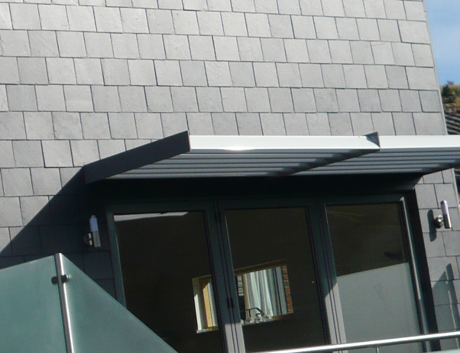

vivienz Posted January 16, 2020 Author Share Posted January 16, 2020 3 minutes ago, SteamyTea said: A good SE needed then. I think that may be overkill for a canopy over the front door. I have a 5m high brise soleil fixed to the front of the building next to the door and glass/steel balustrades around the balconies upstairs all with similar fixings and bracket sizes, and all of which remain firmly in place. Following this, if I have 3 well attached brackets carrying the glass through their middle, with what look like similar sized attachment plates and fixings, I think that will do the job adequately. I'm not sure that an SE could add much more to a canopy apart from cost and over-specifying. I've encountered really good SEs and ones that have added no value to the build but cost a fortune for what they offered, so I'm wary of employing them just for the sake of it. Link to comment Share on other sites More sharing options...

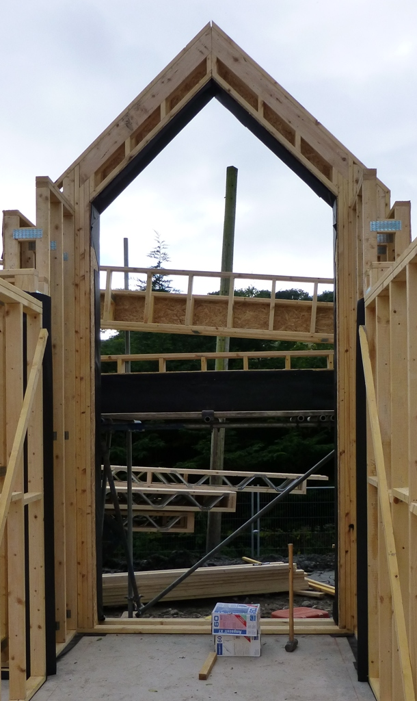

Jeremy Harris Posted January 16, 2020 Share Posted January 16, 2020 11 minutes ago, Carrerahill said: Assuming you have a good substrate to fix to I do not see that being an issue. The substrate should be fine, as either side of our front glazing there are pretty hefty timber posts, made up from multiple studs (this is the inside view, but the structure is the same outside): I can easily fit hefty coach screws back into the frame either side, all I need to do is rout out rebates in the cladding either side, to get a flat area for the brackets to bear against (the outer wall is clad with waney edge larch). There's a batten right next to the glazing on either side, so in total there would be around 130mm depth of timber where the brackets go, with that being stiffened up by being the outer part of the twin stud wall frame. so the timber in the photo above is only spaced around 120mm back from the outer posts, and connected to them both by the OSB lining around the opening as well as the short timber spacers that keep the twin stud frames apart. The problem is finding a fabricator that can make a neat looking canopy, ideally without a cross bar at the front edge. The distance between the inside faces of the timber frame opening is 1900mm, so the gallows brackets needs to be on roughly 2000mm centres (might be slightly less than this, I need to go back out and find the exact edges of the battens either side of the glazing). Link to comment Share on other sites More sharing options...

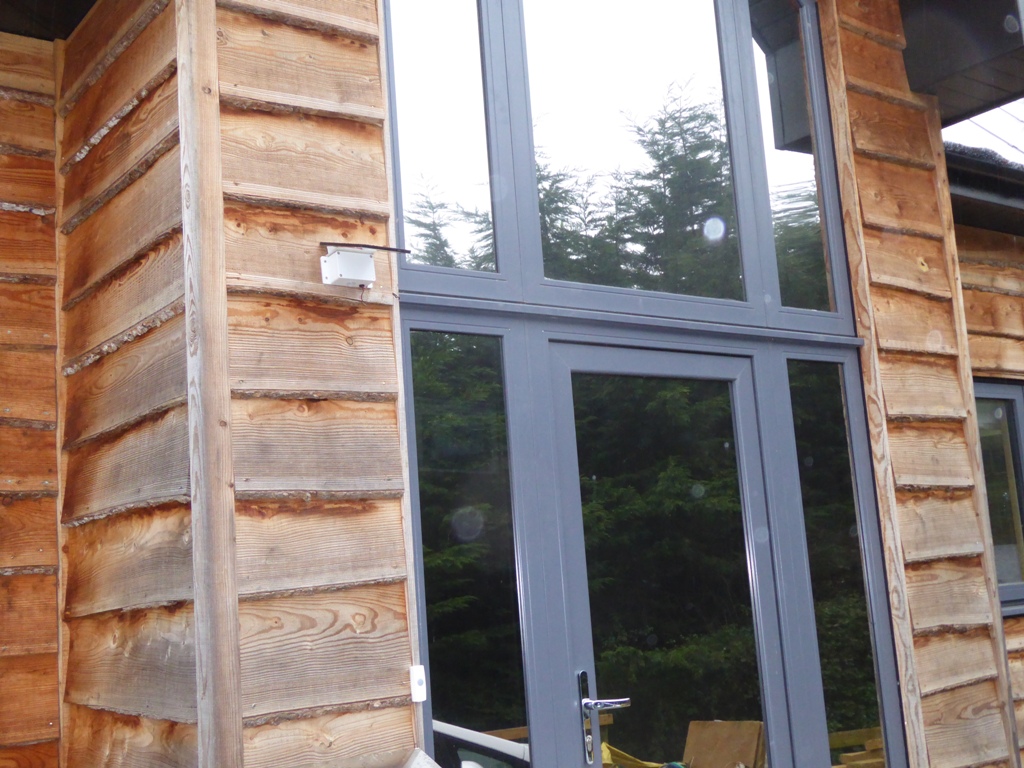

Mr Punter Posted January 16, 2020 Share Posted January 16, 2020 3 minutes ago, Jeremy Harris said: I can rout out flat sections in the cladding either side to give the brackets a flat area to bolt down to easily enough, just need to remove a few nails first. Can you not take off some cladding and screw onto the timber frame, then just cut a neat hold in each bracket and slot the cladding back? 1 Link to comment Share on other sites More sharing options...
Jeremy Harris Posted January 16, 2020 Share Posted January 16, 2020 14 minutes ago, Mr Punter said: Can you not take off some cladding and screw onto the timber frame, then just cut a neat hold in each bracket and slot the cladding back? Yes, could do. Might be a better way to do it, too. It would be easy enough to just add some additional battens around the brackets and then cut the cladding to fit tightly to the brackets. It would probably look neater, too, having the brackets inset into the cladding. Link to comment Share on other sites More sharing options...
Mr Punter Posted January 16, 2020 Share Posted January 16, 2020 We did similar on a place with bris soleil with slate cladding on timber frame. The brackets have welded flat vertical sections either end screwed into the timber frame. 3 Link to comment Share on other sites More sharing options...

Jeremy Harris Posted January 16, 2020 Share Posted January 16, 2020 That looks very neat indeed. Has me wondering whether or not I could completely hide the vertical part of the brackets. If they were fabricated from 25mm deep stainless box (not sure if that would be stiff enough?) then I could strip part of the cladding off, remove the 50mm x 25mm vertical battens that run either side of the glazing, bolt the frames directly to the underlying timber posts and then fit new 50 x 25 battens alongside and refit the cladding over the top of the brackets. I have a few lengths of spare cladding, so if I messed some up it wouldn't be the end of the world. Link to comment Share on other sites More sharing options...
Mr Punter Posted January 16, 2020 Share Posted January 16, 2020 8 minutes ago, Jeremy Harris said: Has me wondering whether or not I could completely hide the vertical part of the brackets. If they were fabricated from 25mm deep stainless box (not sure if that would be stiff enough?) then I could strip part of the cladding off, remove the 50mm x 25mm vertical battens that run either side of the glazing, bolt the frames directly to the underlying timber posts and then fit new 50 x 25 battens alongside and refit the cladding over the top of the brackets. I have a few lengths of spare cladding, so if I messed some up it wouldn't be the end of the world. You could use 10mm thick flat bar for the vertical parts. You may even have enough room for stiffening where it joins the box section. You could have galv powder coated steel if the stainless was expensive to fabricate. Link to comment Share on other sites More sharing options...

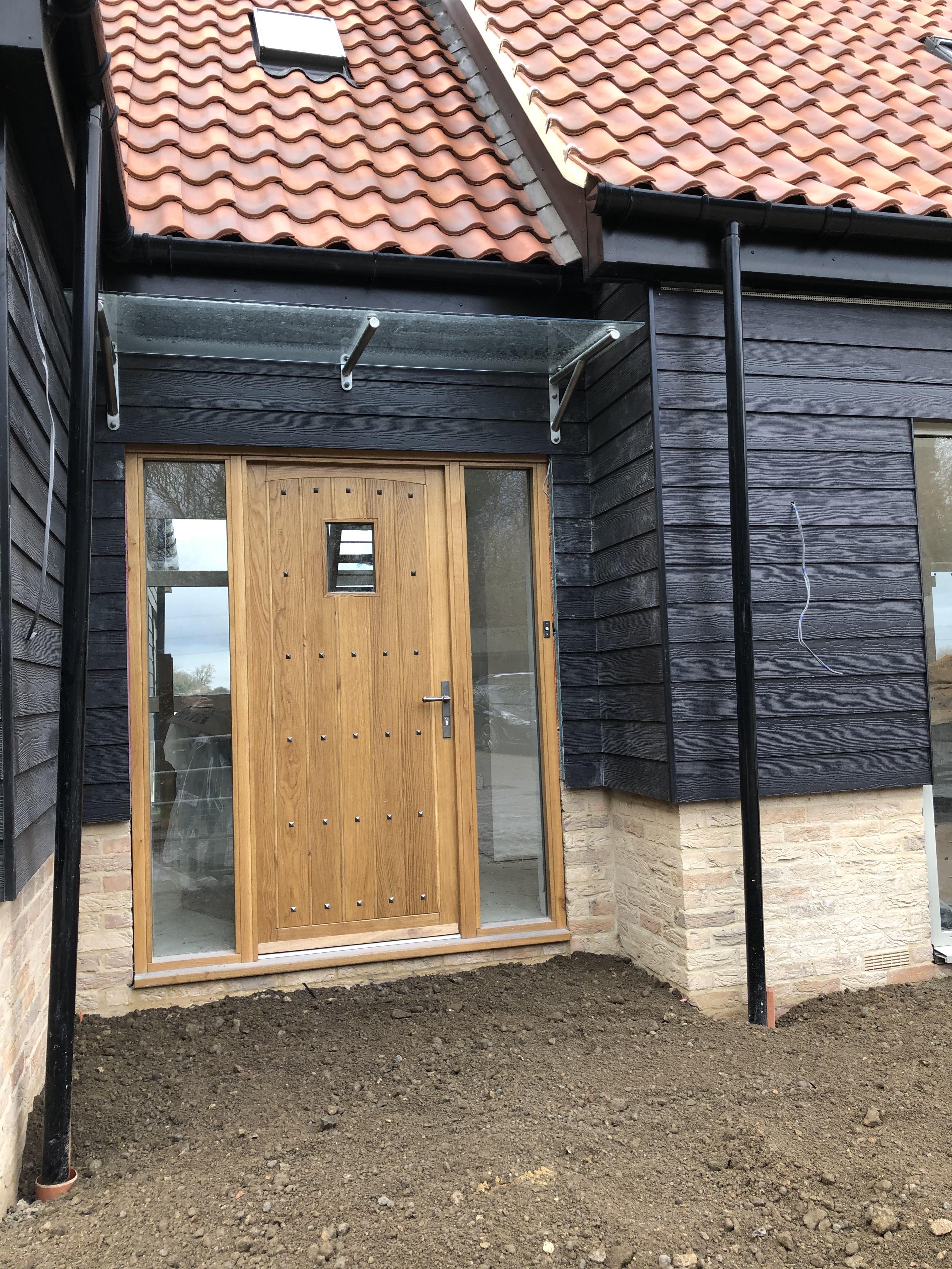

Wagas Posted January 17, 2020 Share Posted January 17, 2020 Recently got this from house of canopies as there isn't much room above the door for a substantial structure. We just wanted something to keep the elements out when entering/leaving the house. Seems ok 2 Link to comment Share on other sites More sharing options...
Jeremy Harris Posted January 17, 2020 Share Posted January 17, 2020 That's similar to the sort of thing we're after, but without the centre support, as we have no where to fix one to. My thoughts are that, as well as provide a bit of added shelter from the rain whilst unlocking the door, it may well also provide a degree of protection from over-heating, especially if we go for a slightly tinted glass panel. At the moment we have solar reflective film on the front glazing, which works well, but is now beginning to suffer from being constantly attacked by this chap (he, or his mates, have been banging away at it every hour or so for days now, same happened last year, and the year before): Link to comment Share on other sites More sharing options...
