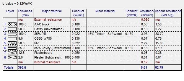

1 hour ago, Moonshine said:
Do you know what a typical U value of that build up would be with 50mm pir on the inside of the timber.
U=0.124
5 minutes ago, A_L said:
U=0.124
Thanks, but the build up I am thinking of has mineral / glass insulation in the timber cavity not pir.

With 150mm of 0.035 mineral wool instead of PIR in timber frame U=0.147. It is software but not currently available.

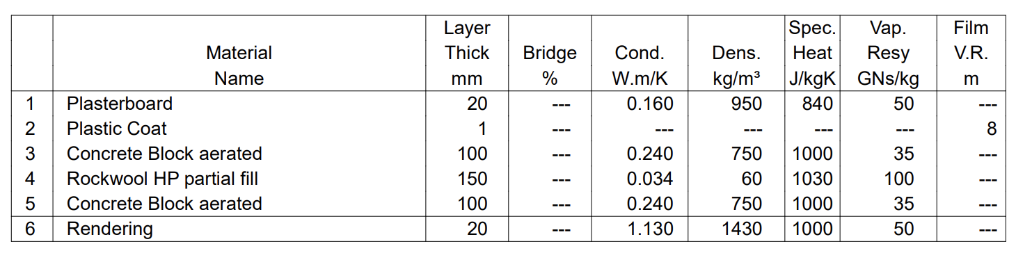

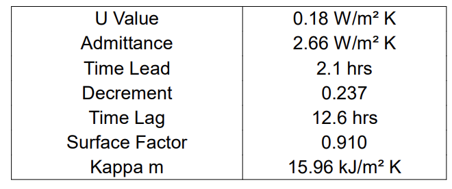

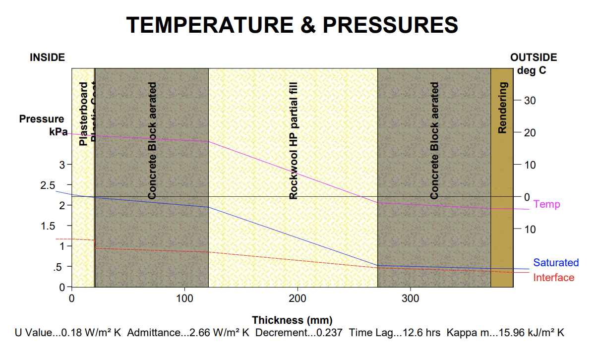

We've decided to go for masonry, and for now our bog standard (and therefore presumably fairly cheap?) 400mm looks like this, but happy to be informed of better buildups
1784966296_Screenshot2021-03-20at17_50_31.thumb.png.97ec4861ef5ece5438594d7a7264095d.png
518741776_Screenshot2021-03-20at17_52_54.thumb.png.5c1ab998199426002e497fe024f709c7.png
Composite material properties:
0.18 is higher than most people have here, but not terrible, I'd say?

You don’t have a partial fill - you can’t partial fill with rockwool, it has to be retained both sides with masonry.
400mm build up seems to be 15mm plasterboard and skim, 100mm block, 170mm cavity, 100mm block and 15mm render ..?
If so, 170mm rockwool and 170mm EPS are pretty much equal, 120mm PIR with 50mm cavity is probably 25% better but more difficult to detail and will cost more.
