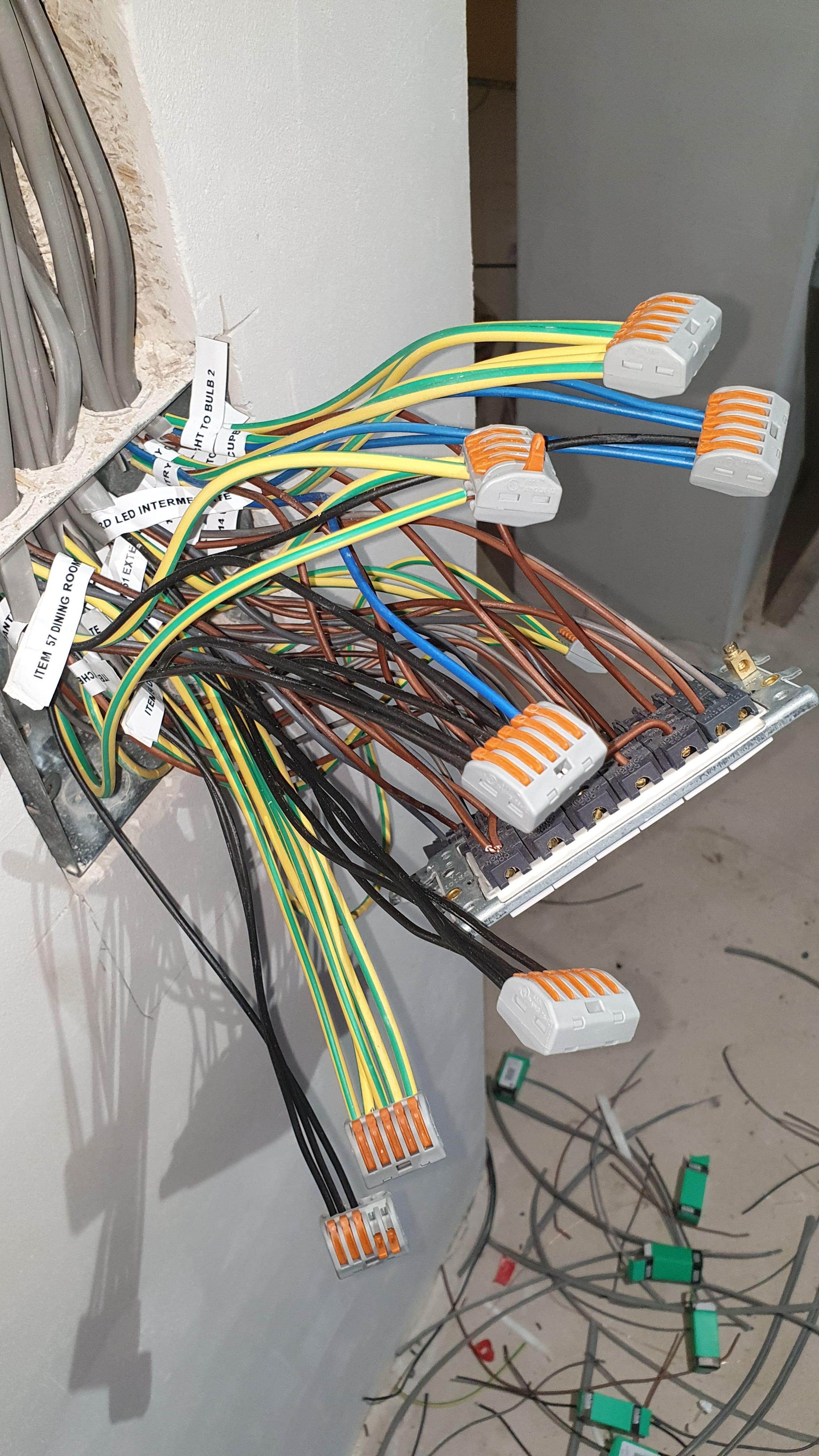

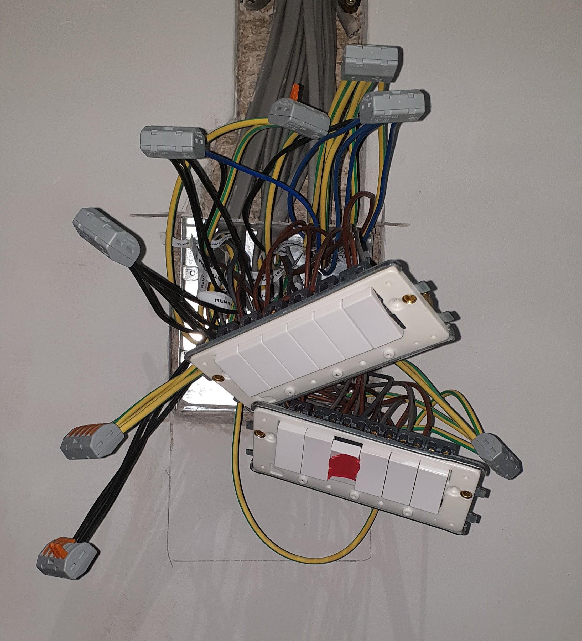

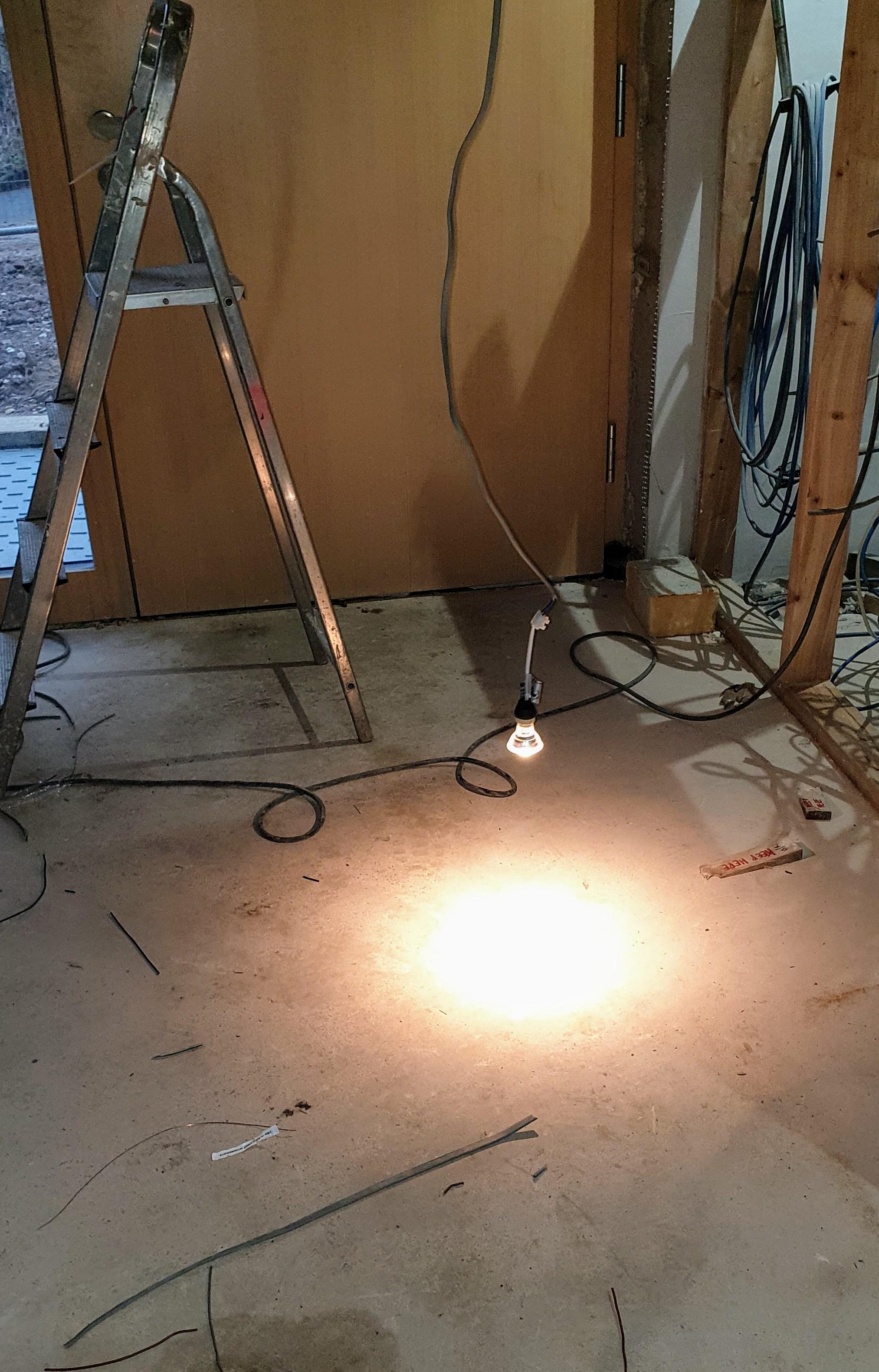

ToughButterCup Posted January 11, 2020 Share Posted January 11, 2020 My brilliant stepson called me over today to show me how he was getting on. Here ya go : it's just a little thing .... but massive to me A humble GU10 working on mains electricity for the very first time in Salamander Cottage. Another milestone. There was this nest of spaghetti which makes it possible to switch the lights from three places and this set of intermediate switches ... Quite how sparkies 'see' it all, I have no idea. I could not be more pleased. So thanks @ProDave for telling me about Scolmore Click Mode and for all the support. Had it been up to me there would have been the mandatory 3 gang switch at the door. And that's about all. A small beer tonight methinks. Just to mark the passing of another milestone. 7 2 Link to comment Share on other sites More sharing options...

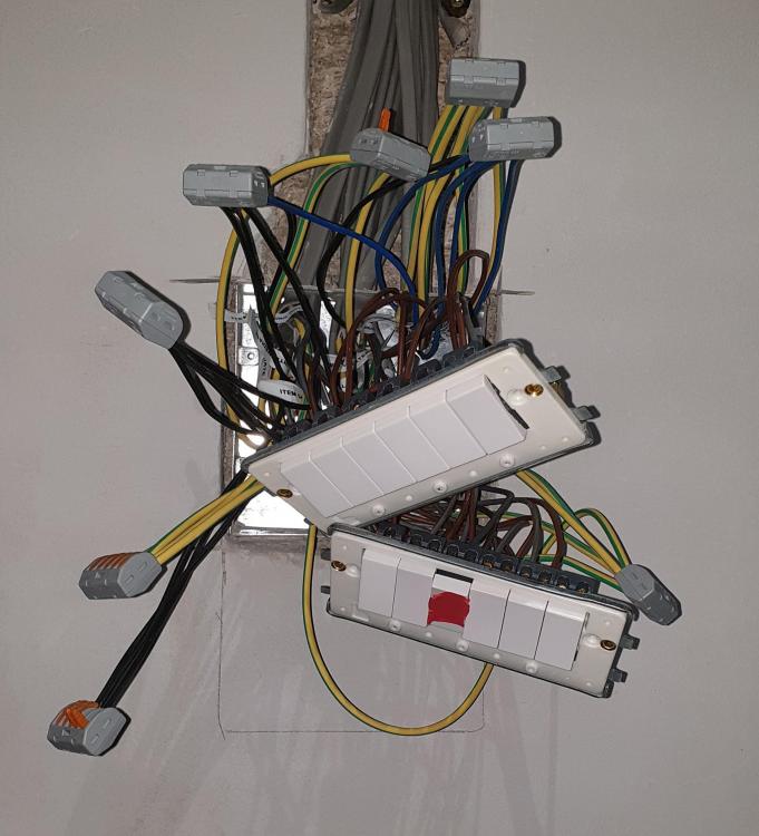

ProDave Posted January 11, 2020 Share Posted January 11, 2020 Best of luck getting all those wires tucked away in the back box !!!! Re step, I use a pair of "combination ladders" that can be a short extension ladder, a pair of regular steps, or a pair of offset steps for use on a staircase. I have had them for probably 30 years, they are sturdy and secure and I have never once doubted their integrity. Plenty of people have told me they are "illegal" and dangerous, but nobody, not anybody is going to stop me using them. I do admit I have seen similar looking things to mine that are rubbish and dangerous so choose carefully and use your own judgement. 1 Link to comment Share on other sites More sharing options...

Tennentslager Posted January 11, 2020 Share Posted January 11, 2020 25 minutes ago, ProDave said: Best of luck getting all those wires tucked away in the back box was wondering the same thing... what’s the answer @ProDave @Onoff Link to comment Share on other sites More sharing options...
Onoff Posted January 11, 2020 Share Posted January 11, 2020 13 minutes ago, Tennentslager said: was wondering the same thing... what’s the answer @ProDave @Onoff 47mm back box for a start. Only have 10mm of sheath poking into the box through the grommets or what looks like grommet strip in this case. It'll look better when the wires are trimmed back. Especially the cpcs, way too long. Sure this is just for testing purposes then it'll get tidied. Just a case of being methodical. Link to comment Share on other sites More sharing options...
ProDave Posted January 11, 2020 Share Posted January 11, 2020 Don't leave them so long. The key is neatness, e.g linking neutrals together and terminating earths, do all that first with them neatly dressed and tucked in the back of the box out of the way. And yes the deepest back box you can fit Link to comment Share on other sites More sharing options...
Onoff Posted January 11, 2020 Share Posted January 11, 2020 I'd be putting as many of those WAGOs tucked right down the bottom at the back, maybe a couple of rows. Cut the wires back to such length that it keeps the WAGOs in place. Link to comment Share on other sites More sharing options...
Mr Punter Posted January 11, 2020 Share Posted January 11, 2020 33 minutes ago, Onoff said: I'd be putting as many of those WAGOs tucked right down the bottom at the back, maybe a couple of rows. Cut the wires back to such length that it keeps the WAGOs in place. Is it OK to use earth terminal strip in a backbox and lose some of the WAGOs? Link to comment Share on other sites More sharing options...

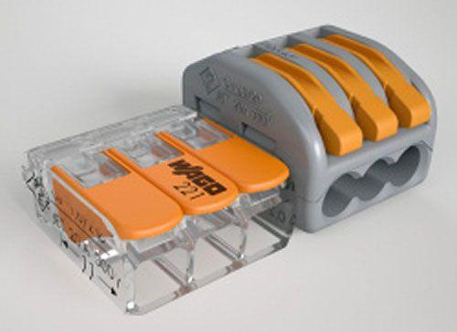

ProDave Posted January 11, 2020 Share Posted January 11, 2020 The Wago's shown are the lever version that can be released. Even smaller are these https://www.screwfix.com/p/wago-3-way-push-wire-connectors-24a-pack-of-100/4322r (as an example) available in different number of ways and different sizes. They are smaller, so possibly better for this application, but once fitted you can't remove a wire, so get it right first time!!! Link to comment Share on other sites More sharing options...
MJNewton Posted January 11, 2020 Share Posted January 11, 2020 (edited) There are smaller lever Wagos available too - the 221 series: Same rating as the 222's, and I prefer the transparent case for reassurance of correct insertion. Incidentally, re the push connectors they are releasable/reusable - you just twist the wire whilst pulling. Edited January 11, 2020 by MJNewton 2 Link to comment Share on other sites More sharing options...
Onoff Posted January 11, 2020 Share Posted January 11, 2020 33 minutes ago, MJNewton said: Incidentally, re the push connectors they are releasable/reusable - you just twist the wire whilst pulling. Not so easy though imo if it's twin and earth and the cores are a bit short to twist them out. Link to comment Share on other sites More sharing options...
ProDave Posted January 11, 2020 Share Posted January 11, 2020 9 minutes ago, Onoff said: Not so easy though imo if it's twin and earth and the cores are a bit short to twist them out. I have had little success removing them myself. But thanks to @MJNewton I did not know about the 221 series, I know what will be padding out my next order to get above the free postage thresheold....... Link to comment Share on other sites More sharing options...
Markblox Posted January 11, 2020 Share Posted January 11, 2020 1 minute ago, ProDave said: I have had little success removing them myself. But thanks to @MJNewton I did not know about the 221 series, I know what will be padding out my next order to get above the free postage thresheold....... They were launched about three or four years ago and make all the difference when space is tight which is almost always! Link to comment Share on other sites More sharing options...
MJNewton Posted January 11, 2020 Share Posted January 11, 2020 The 221s arrived without much fanfare, and it doesn't help that the 222s are still around yet I would've expected them to have replaced them. They're such an improvement; easier levers and they have squared edges so can be 'stacked' a lot easier to reduce space. Link to comment Share on other sites More sharing options...
Onoff Posted January 11, 2020 Share Posted January 11, 2020 4 minutes ago, MJNewton said: The 221s arrived without much fanfare, and it doesn't help that the 222s are still around yet I would've expected them to have replaced them. They're such an improvement; easier levers and they have squared edges so can be 'stacked' a lot easier to reduce space. Do they do a carrier you can screw down for them like the 222s? Mate gave me a box of 221s I haven't even used yet and I've continued buying 222s. Fear of new fangled things! ? Link to comment Share on other sites More sharing options...
MJNewton Posted January 11, 2020 Share Posted January 11, 2020 Yes, they're got their own carriers. 1 Link to comment Share on other sites More sharing options...
Onoff Posted January 11, 2020 Share Posted January 11, 2020 2 hours ago, Mr Punter said: Is it OK to use earth terminal strip in a backbox and lose some of the WAGOs? You could but WAGOs are a constant force connector and deemed maintenance free pretty much. Fit and forget even if inaccessible later on. With a terminal strip you have screws that WILL loosen over time and need periodic checking. 1 Link to comment Share on other sites More sharing options...
