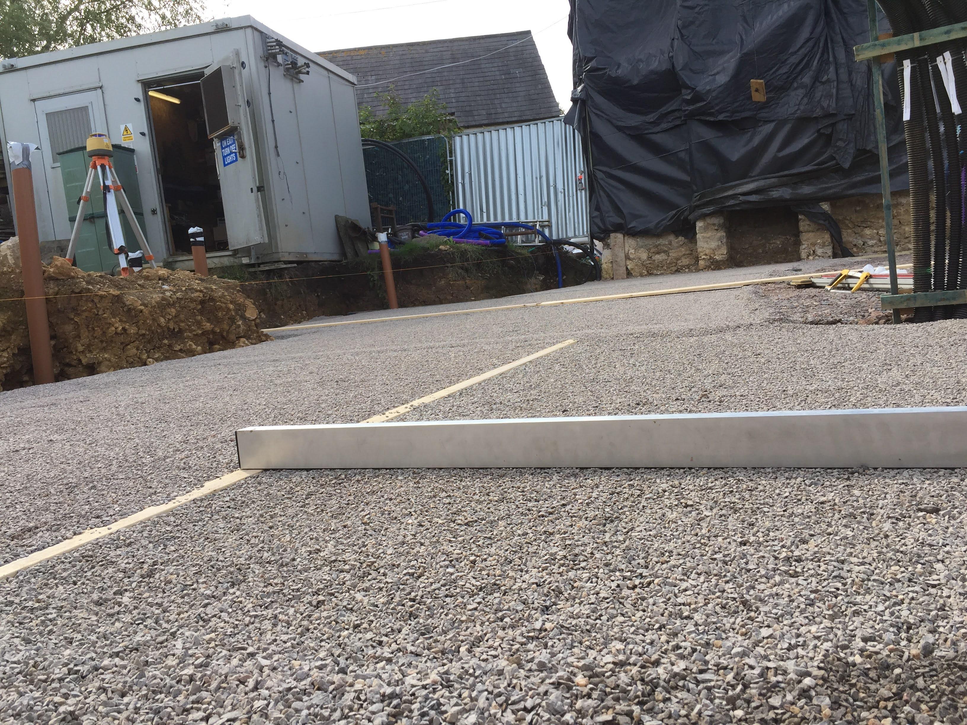

I used 2-5mm limestone chips. And used a 3.0m screed bar to level.

I used limestone chips as it was what had been specified.
Bought a 3.0m aluminium length which has come in handy many times since throughout the build.
Timber set level on type1, worked beautifully
Thanks - seems easier, were these compacted?
