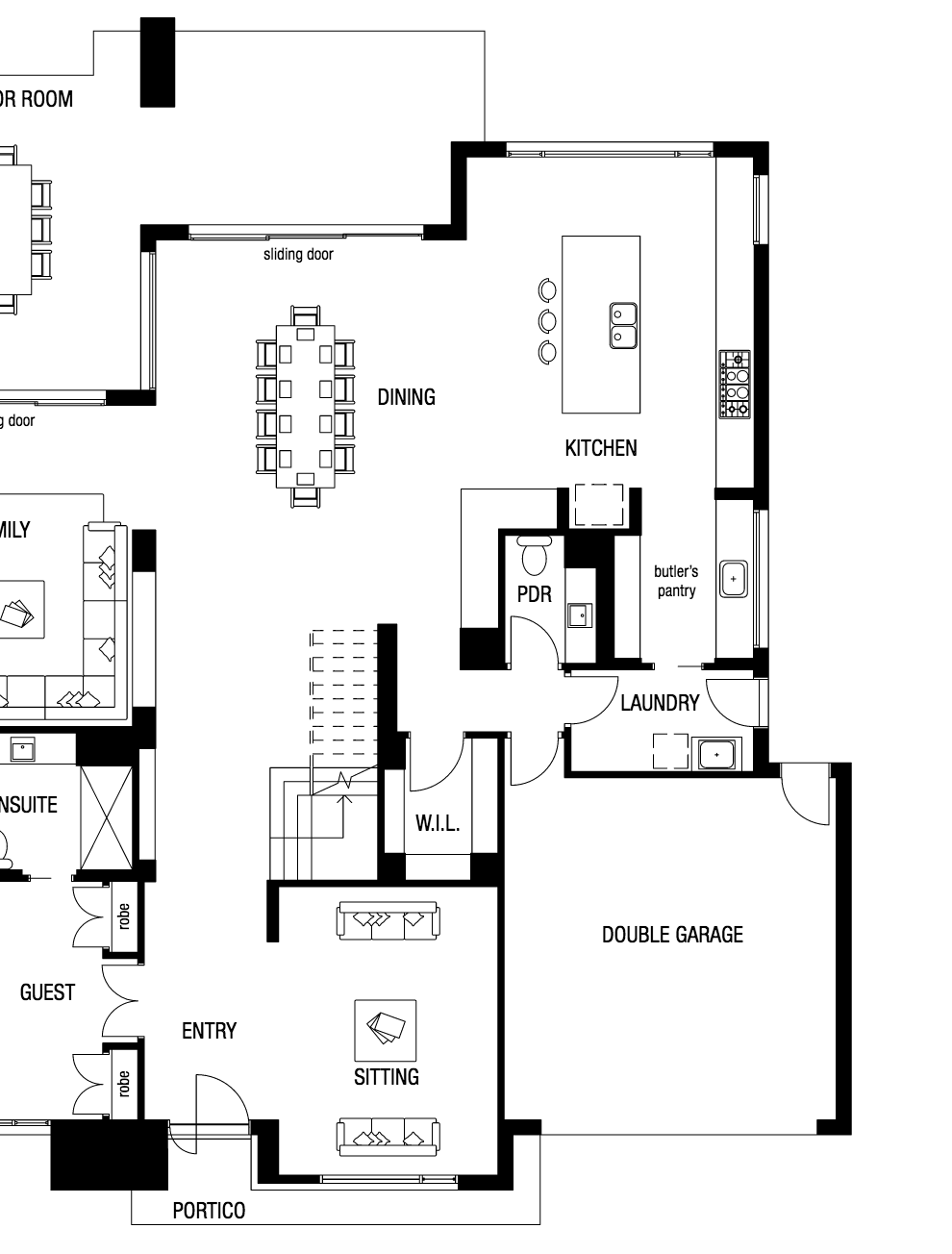

Russell griffiths Posted January 10, 2020 Posted January 10, 2020 Anybody got one, anybody got any views on layout or other stuff. Just trying to get some ideas going at the moment. Cheers russ.

Russell griffiths Posted January 10, 2020 Author Posted January 10, 2020 The name I suppose might mean a few different things. What we are thinking as our house is very open plan, is a little are off the side of the kitchen to chuck dirty pots and pans as you are cooking. If you imagine having a couple of friends over for dinner, the unpleasant bit about open plan kitchens is having to look at dirty pans while you are eating. we have a separate utility room for washing machine and things.
Dreadnaught Posted January 10, 2020 Posted January 10, 2020 (edited) I'm planning one for my forthcoming bungalow. A pantry of storage shelves which will also contain the (inevitably noisy) freezer and so keep it out of the open plan kitchen/living/dining room. In the kitchen proper I will only have an under counter fridge (no freezer and so quieter). The pantry will also have worktops and a (second) sink. Edited January 10, 2020 by Dreadnaught 1

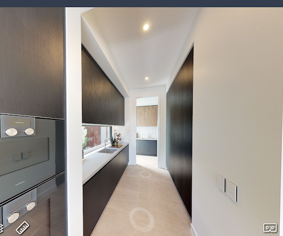

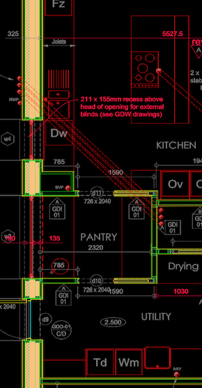

Dan F Posted January 10, 2020 Posted January 10, 2020 (edited) These are popular in Austrailia from plans I've seen online. Rather than being a second kitchen, it's more of a utility sized (or smaller) area with both storage and some worktop, decoupled from the ktichen which is typically open-plan. The addition on a sink means they can be good for food prep too if required, and not just for hiding all the dirty stuff. We saw some Metricon (australian builder) layouts with them in and really like the idea, especially the layouts that have a butlers pantry between the kitchen and utility and stole the idea for our house too. We have slightly less storage cupboards in the kitchen because of this, and like @Dreadnaught we plan to put the freezer in here also, with frezzer and two full height 600mm storage units on one side and a counter-top with storage below on the other side. We've not starting building yet, but this is where we got the idea from: There is a walkthrough VR of this design here: https://www.metricon.com.au/new-home-designs/qld/riviera?category=virtualtours&photo=riviera&floorplan=54 The metricon website also have plenty of other, more modest designs, with this concept too. This is our intereptration of it (clear copy! bit smaller I think though, and with the addition of pocket doors) Edited January 10, 2020 by Dan Feist 2
Nick1c Posted January 11, 2020 Posted January 11, 2020 We will be having a pantry next to our kitchen area in an open plan living room. It will house 2 compact dishwashers, a small sink, freezer and additional storage. Hopefully it will mean that the main room is quieter and less cluttered. 1
Russell griffiths Posted January 11, 2020 Author Posted January 11, 2020 Thanks everyone i think I have opened up a big can of pain for myself, I originally looked at this idea on an Australian tv show, then I looked on that Houzz site and bloody hell my whole kitchen layout is going to change. Im glad I don’t have a builder as he would want to kill us. Cheers russ.
ProDave Posted January 11, 2020 Posted January 11, 2020 To me the pantry looks like just a utility room with the inconvenience of an extra door put before the bit with the washing machine. I also note we have done something "odd" in our kitchen. We have put the hob in the island, and the sink is along the wall under the window. Everyone else seems to put the sink in the island and hob along the wall. I guess you just do what suits your needs and not everyone will like it. But if you do that is all that matters. I do agree about noise, I insisted we have a separate lounge as well as the "familly room" (kitchen / diner in my book) as I don't want to be watching telly with the bloody dishwasher churning away in the same room. But a dishwasher needs to be in the kitchen, I would find it a huge inconvenience to bury that in a separate room.
Dan F Posted January 11, 2020 Posted January 11, 2020 8 minutes ago, ProDave said: I also note we have done something "odd" in our kitchen. We have put the hob in the island, and the sink is along the wall under the window. Everyone else seems to put the sink in the island and hob along the wall. That's not odd! We have the same in our rental property and are doing the same in our design and putting the hob on the island. We are doing something even odder than you though... our sink isn't under a window! For some reason everyone seems to put a sink under a window. Does this come from when everyone used to wash-up by hand, and the view made it less boring I wonder? 8 minutes ago, ProDave said: I do agree about noise, I insisted we have a separate lounge as well as the "familly room" (kitchen / diner in my book) as I don't want to be watching telly with the bloody dishwasher churning away in the same room. But a dishwasher needs to be in the kitchen, I would find it a huge inconvenience to bury that in a separate room. We'll have diswasher in kitchen (near sink), but like you have not gone full open-plan, as it's just not practical. We have kitchen/breakfast as one area, and then more formal dining/lounge as another area, connected by full-height pocket doors.
