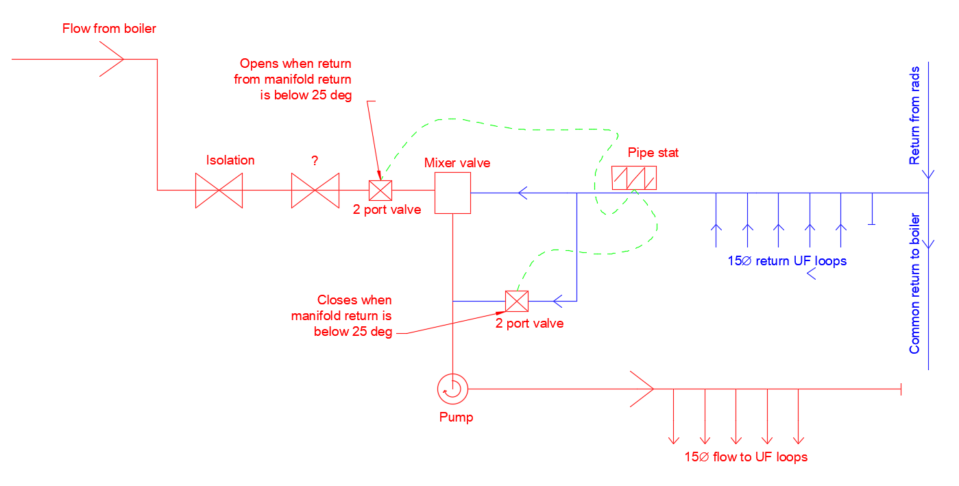

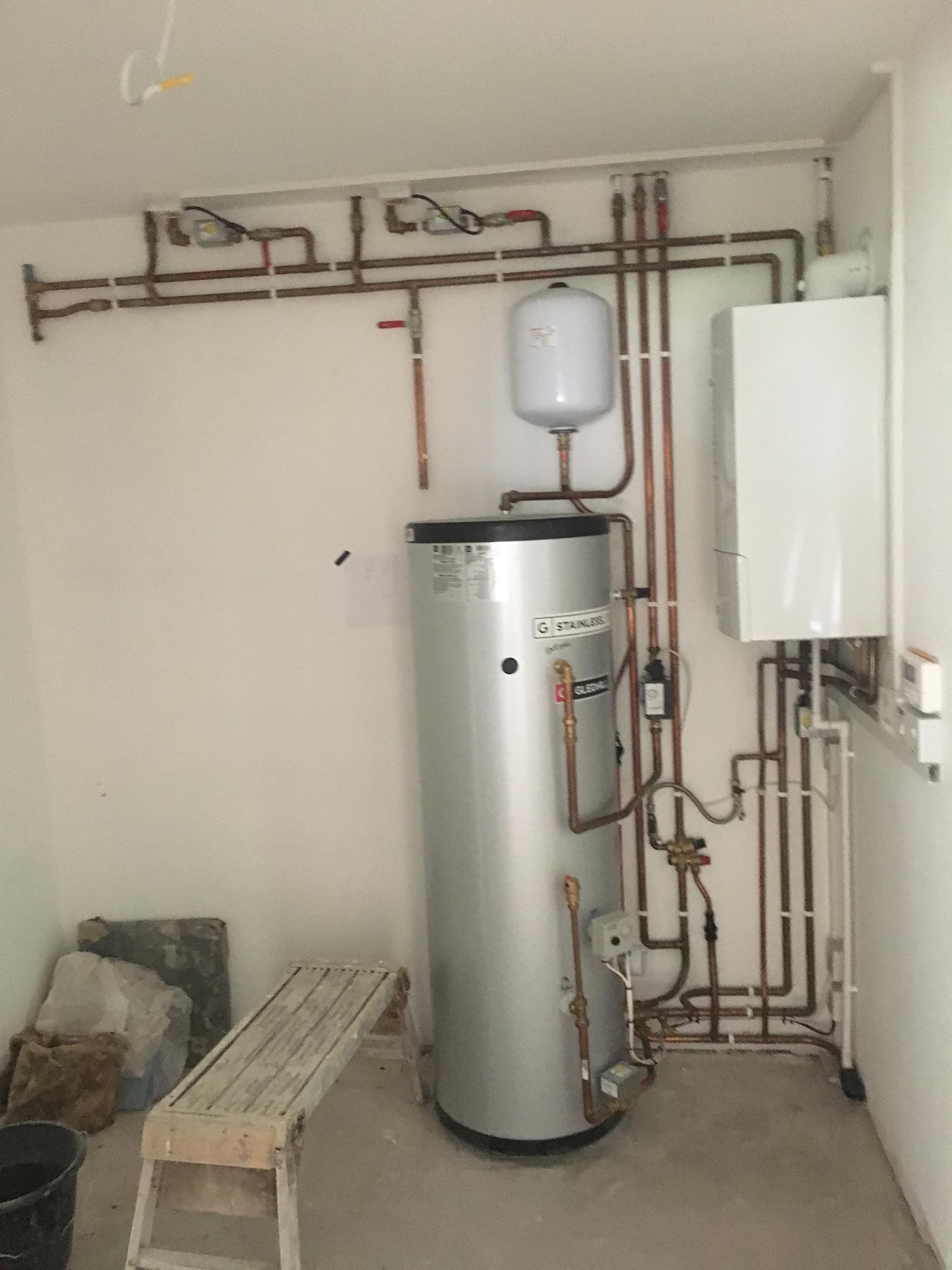

Pipes Posted January 5, 2020 Posted January 5, 2020 (edited) I seem to have what must be a common problem when using underfloor heating with a boiler however I haven’t managed to find a standard solution online. The boiler cycles at a high frequency due to the difference in boiler power compared to what the underfloor heating manifold will accept.Setup (underfloor heating recently added by local plumber) – see image below Worcester Greenstar Highflow 440CDI combi boiler (Central heating power of ~29kW down to ~7.6kW) Radiators upstairs with separate thermostat and actuated valve on the CH flow. Underfloor heating downstairs with separate thermostat and actuated valve on the CH flow. Manifold including recirculation pump and mixer valve to maintain the inlet manifold temperature at ~40C. " class="bbCodeImage LbImage" alt="" data-url="http://<a href="https://ibb.co/0DLwm3M"><img src="https://i.ibb.co/tm6dQ5s/UFH-current.jpg" alt="UFH-current" border="0"></a>" />IssueThe Combi boiler cannot modulate low enough when running the underfloor heating on it’s own therefore it cycles frequently on and off. At a high level, The thermostatic valve on the underfloor heating manifold gets close to the required temperature and throttles flow from the boiler. Boiler flow then bypasses the manifold through the pressure relief circuit and causes the boiler flame to turn off. The flow temperature drops The thermostatic valve on the underfloor heating manifold then starts to open because it’s not getting heat, pulling in cool flow and opening more and more. The boiler restarts when it’s anti cycling timer or temperature limits have been reached and quickly exceeds the underfloor heating thermostatic control valve temperature so the process restarts. If the anti cycle timer is put to it’s minimum of 1 minute, the boiler will run for 1 minute and turn off for one minute (the run time will further reduce when the underfloor heating gets up to temperature). At this frequency the flow temperature remains above the temperature setting of the underfloor heating thermostatic valve so the underfloor is happy.I assume that this boiler operation isn’t efficient and I doubt it’s doing the boiler any favours?When the radiators are operated concurrently with the underfloor heating the CH flow temperature remain stable and the system works nicely.Variables currently available in the system Boiler cycle time or temperature limit, currently 1 minute – If this is increased above 1 minute the underfloor manifold pulls in low temperature water as it cycles and therefore takes a long time to heat up. CH flow temperature, currently 60C – If this is increased it takes a little longer for the boiler to achieve the temperature however an increase of 10C only added 25s to the cycle time (by the time the high temperatures are achieved the boiler is mostly short circuiting around the bypass). Boiler pump speed, currently set to three – Assume a reduction would result in higher temperatures (lower flowrate with the same burner rate?) may also impact on the boiler/radiator operation? Boiler pump operation modes – Don’t know enough Underfloor heating pump speed, currently set to three – Don’t think this will have a significant affect. Underfloor heating thermostatic valve, currently 40C – Increasing this temperature risks overheating the engineered wood flooring. Next steps – help please! Is it a problem to leave the boiler cycling so frequently (1 min on then 1 min off)? Can any of the existing settings be adjusted to help? If current operation is a problem the only significant improvement I can think of is to add thermal mass between the boiler and underfloor heating manifold as follows (see image), any tips on these or is there a better alternative? a. Add pressurised tank (are these referred to as heat banks/or thermal stores?) upstream of the underfloor heating bypass loop. b. Draw the underfloor heating flow through the heat store in the boiler. This is the wild card option and I don’t like it because a connection would need to be made within the boiler (although it is accessible) and there may be an unforeseen impact on the hot water supply. I’ve mentioned it because it wouldn’t require another tank to locate, continually heat or pay for! " class="bbCodeImage LbImage" alt="" data-url="http://<a href="https://ibb.co/bLpkNgq"><img src="https://i.ibb.co/6b6kDRV/UFH-options.jpg" alt="UFH-options" border="0"></a>" /> Edited January 5, 2020 by Pipes
ProDave Posted January 5, 2020 Posted January 5, 2020 What you need is a buffer tank. Someone will come along shortly I am sure to advice what and how to fit. 1
Temp Posted January 5, 2020 Posted January 5, 2020 (edited) What temperature is the manifold mixer set to? If its very low then increasing it _might_ help a bit. Note there is usually a limit/safety stat on the manifold as well as the mixer. The safety stat is usually set to something like 50C or lower for some floor coverings that might be damaged by high temperatures (Karndean?). The mixer must be set lower than the safety stat. Short cycling reduces efficiency, a bit like stop start driving a car. Its worse for an oil boiler than a gas boiler. I was concerned our oil boiler would short cycle and so intended to put a buffer tank between boiler and UFH. In the end we opted for a thermal store which buffers DHW as well as CH. Heat banks are just a variant on the theme. More after Dr Who! Edited January 5, 2020 by Temp
Pipes Posted January 5, 2020 Author Posted January 5, 2020 (edited) @ProDave That's where my head is going at the moment but there seem to be a lot of systems without them working fine. @Temp The mixer in the manifold is set to 40C in order to limit the temperature in the engineered wood flooring. I agree that increasing this will help the cycling and should be able to get away with a slight increase but probably not a lot. Wood suppliers advised a wood surface temperature of <=27C which we get close to if it's run for a while. The UFH manifold is a JK Basic (see link below) with a max temp pump cutout at 55C. FYI they have a clever router that cut the UFH channels in the existing screed without raising the floor height. https://www.jk-gb.com/downloads/jk-quick-start-manual.pdf Edited January 5, 2020 by Pipes
Temp Posted January 5, 2020 Posted January 5, 2020 (edited) It sounds like your diagnosis is correct. Does the UFH appear to be working OK otherwise? I've heard of some builders making silly mistakes such as using airated screed which inadvertently insulates the floor loops a bit. That would cause return temperatures to be too high and shut down the mixer. If you have to fit a buffer tank you can probably get away with a simple buffer tank (eg not one that splits the system). The main issue will be getting the sizing right. Some references suggest 10L per kW of boiler output, but they say that's not the minimum power but the "start up power" which presumably is higher. That would give a tank of perhaps 10*10kW=100L? Too small and it won't lengthen the cycling enough, too large is less an issue but it will leak more heat than necessary. Edited January 5, 2020 by Temp

nod Posted January 5, 2020 Posted January 5, 2020 I’m not a plumber but I’ve the next size down greenstar and used a Gledhill 250L tank We are heating 150 m2 UFH Tsds to five beds 3 baths
Nickfromwales Posted January 5, 2020 Posted January 5, 2020 On 05/01/2020 at 21:32, nod said: I’m not a plumber but I’ve the next size down greenstar and used a Gledhill 250L tank We are heating 150 m2 UFH Tsds to five beds 3 baths Expand The Gledhill provides your DHW though, so it’s a thermal store not a buffer, it just buffers as a by-product

Temp Posted January 6, 2020 Posted January 6, 2020 (edited) Basically the boiler puts hot water into the buffer and UFH takes it out. The boiler ON time depends on how long it takes to fill the buffer tank. The boiler OFF time is determined by how fast the UFH empties the buffer. The two times added together give the cycle time. If I've done my sums right a 29KW boiler would make about 0.35L/S or 20L/min with a 20C uplift. So it would take about 5min to raise a 100L buffer tank by 20C (ignoring any draw by the UFH at the same time). To calculate how long the UFH would take to empty the buffer you need to know the power the UFH draws but we already know its less than the minimum the boiler can deliver (10KW?). 10kW is about 0.12L/S or 7.1L/min with a 20C drop between flow and return. So the UFH should take at least 100/7= 14min to empty the buffer. So the cycle time should be around 5min ON and 14min OFF. However the useable capacity of a 100L store probably isn't 100L. It probably depends on the position of any stats on the tank. I'm sure things aren't quite that simple in practice so you should get the buffer tank sized by someone providing a warranty. Eg Heating Engineer. All I have is O-Level physics and some back of the envelope calculations. Edited January 6, 2020 by Temp

Nickfromwales Posted January 7, 2020 Posted January 7, 2020 As you’re looking to be buffering kWh’s of heat and not looking to add volume per se, then you really would benefit from a sizeable buffer tank, eg minimum 100L but preferably 200L tbh. A super insulated vessel is recommended unless it can be sited to utilise the waste ( latent ) heat loss beneficially eg in an airing cupboard or strategically positioned on the ground floor to contribute to local heat requirements. A low loss header will do very little to improve things as they’re normally utilised to attain hydraulic separation ( vs a dedicated buffer ). Your best bet would be to have the radiator zone valve always open whenever UFH is selected, and have one strategic radiator on manual valves as a bypass / heat loss radiator. You would again need to have that allocated where it would be advantageous / not a nuisance ( airing cupboard or bathroom towel rad(s) for eg ). The boiler will quickly heat up a small buffer, and then you’re back into the flames from the frying pan. 1
Pipes Posted January 7, 2020 Author Posted January 7, 2020 Radiator circuit open option does sound like the easiest option. How would you close all other radiators so that you only get flow through the one? Smart thermostatic valves on all other radiators? My initial thoughts were that it seems a wasteful to dump the extra heat being produced by the boiler into rooms that are unlikely to need it. I'm sure there are significant limitations however I had a shot at initial buffer tank volume calcs using a similar method to @Temp. Underfloor heating buffer tank initial calcs.xlsxFetching info...
Nickfromwales Posted January 7, 2020 Posted January 7, 2020 TRV’s don’t need to be “smart” just £10 a pop and you’re cooking on gas ? There are open source intelligent / smart options available, and IIRC @DamonHD has such a system available. Send him a PM for details. I’d try that option first VS the buffer chop & change and see if the cycling reduces enough to not be problematic. One towel rad could make all the difference as you can include the volume in all the connective pipe work too.
