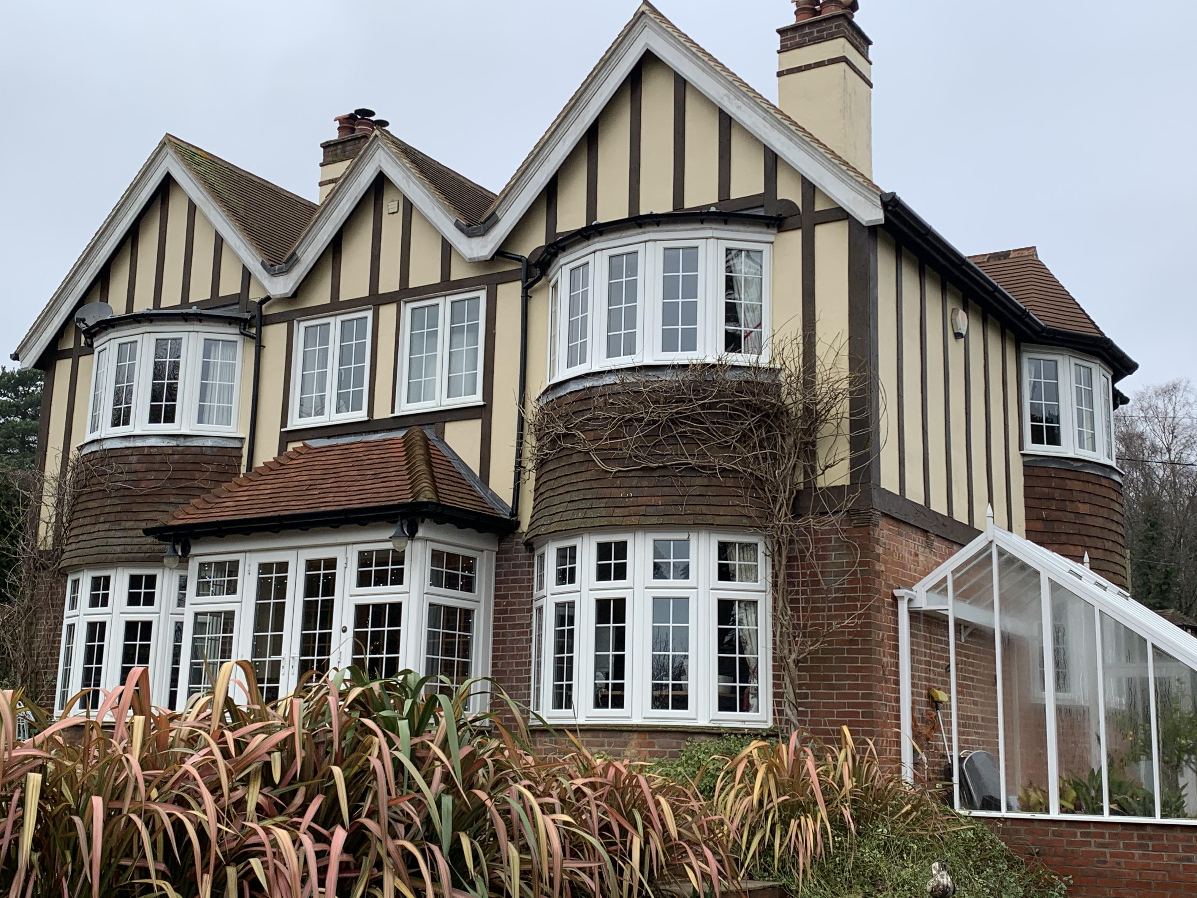

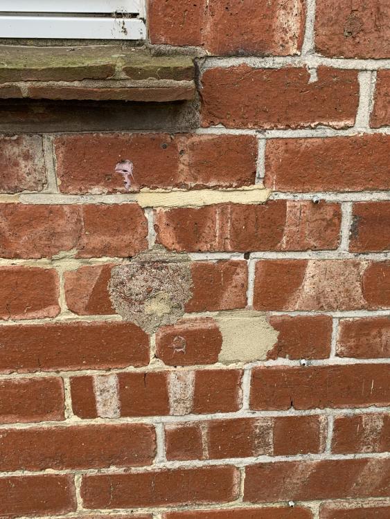

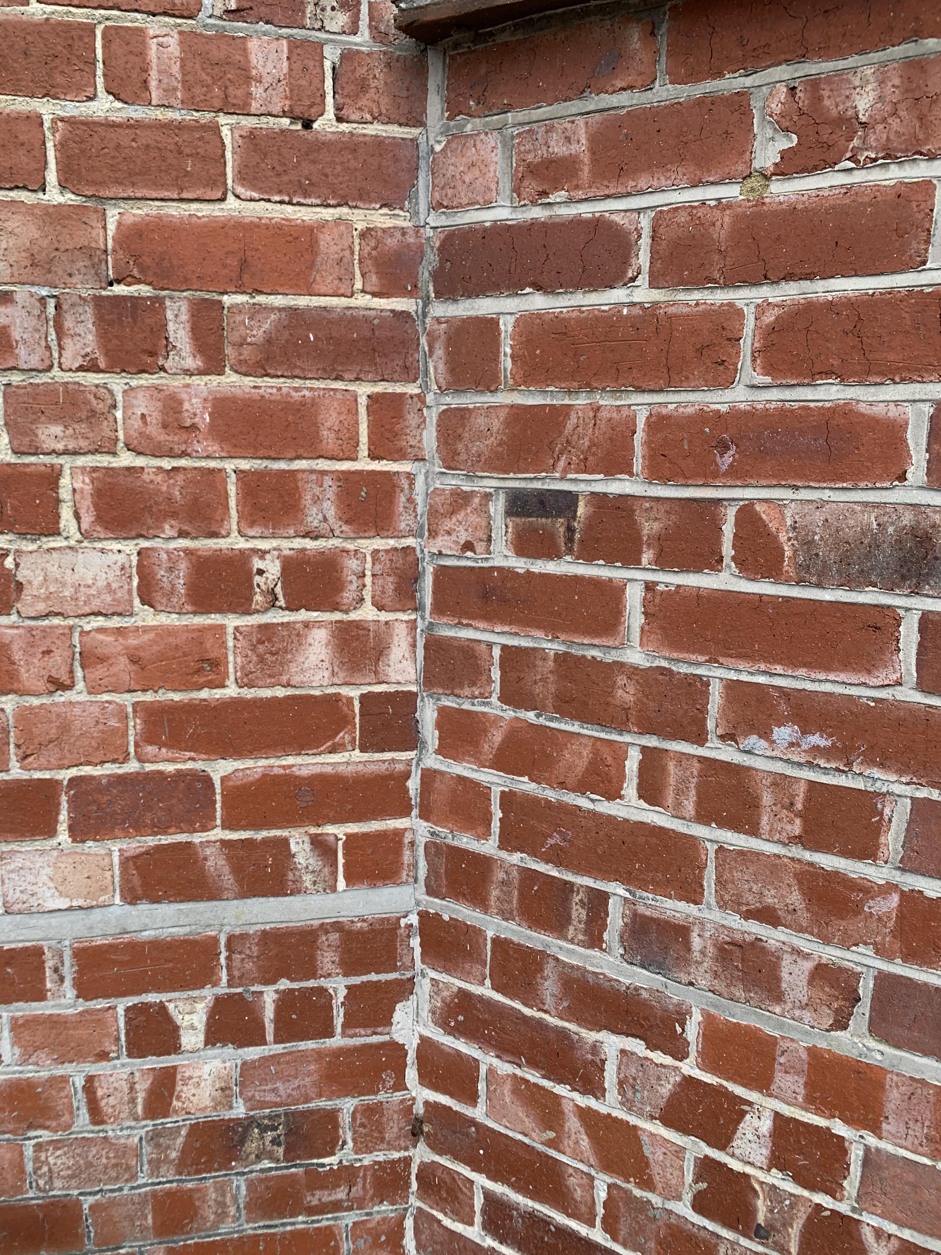

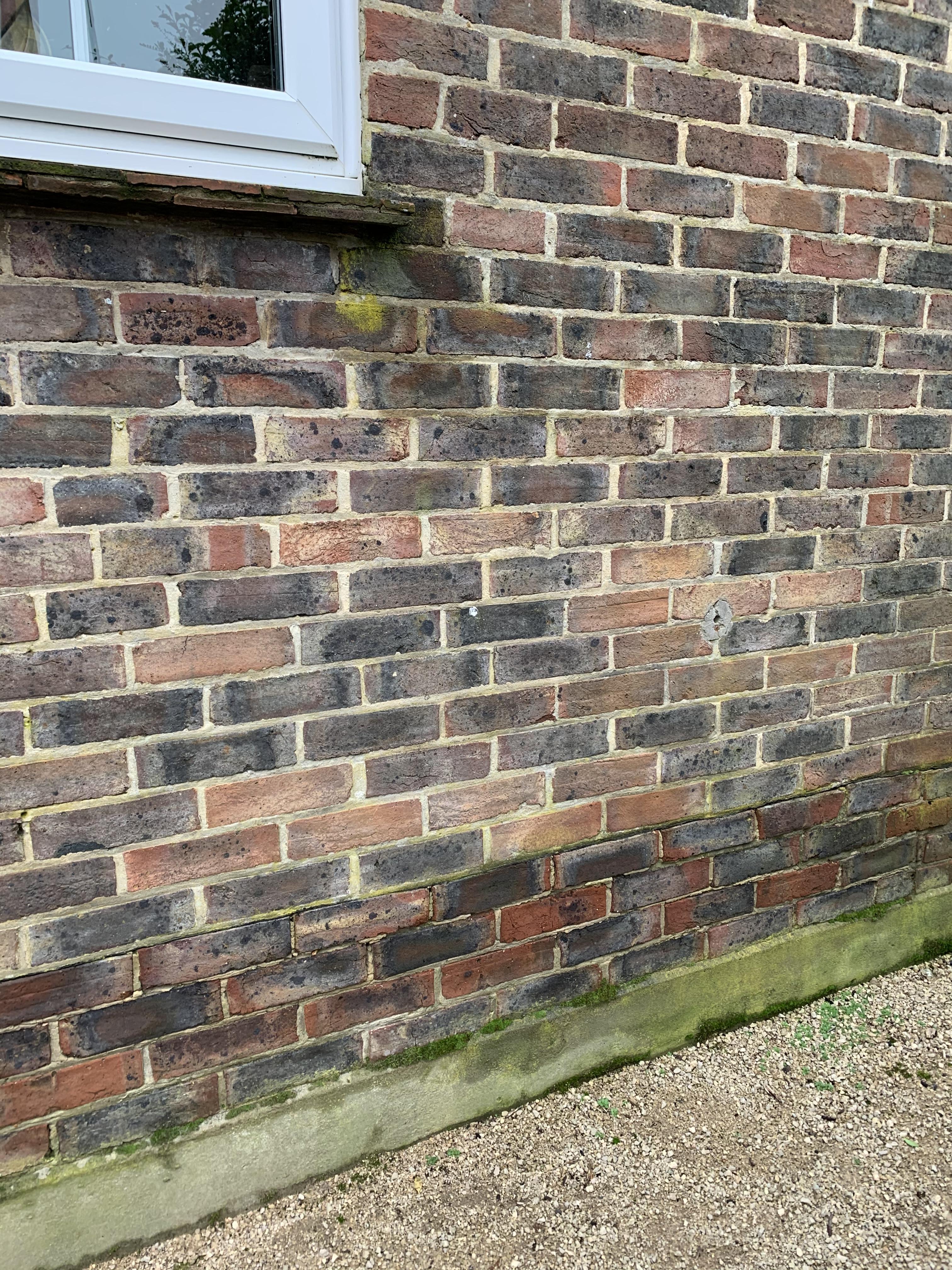

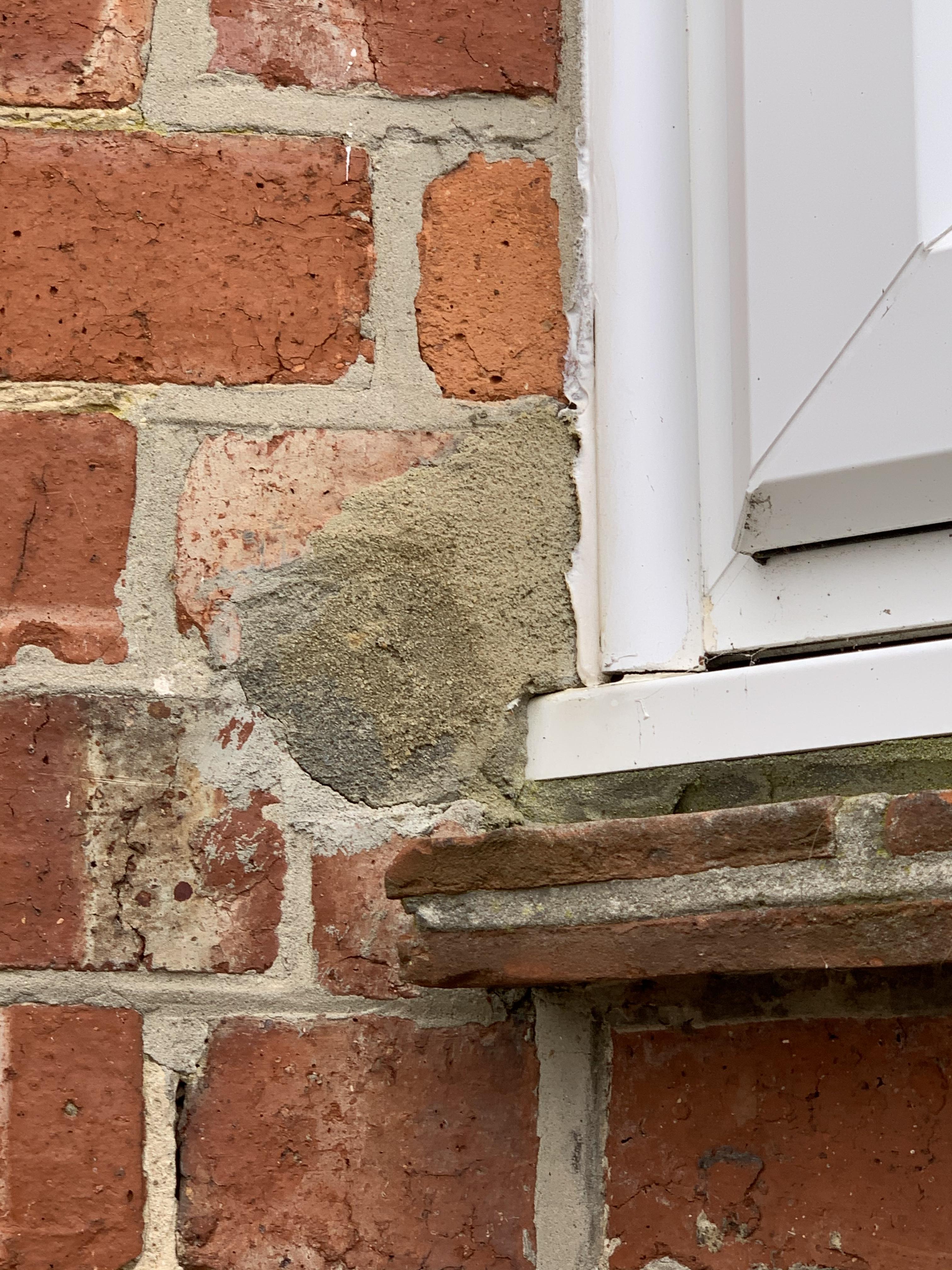

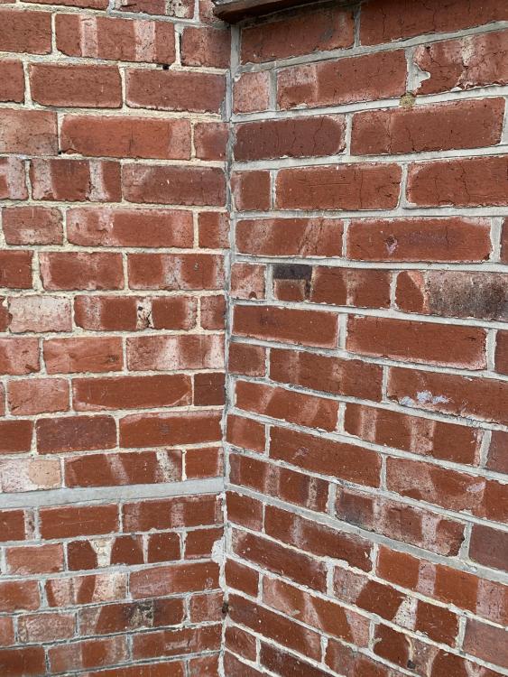

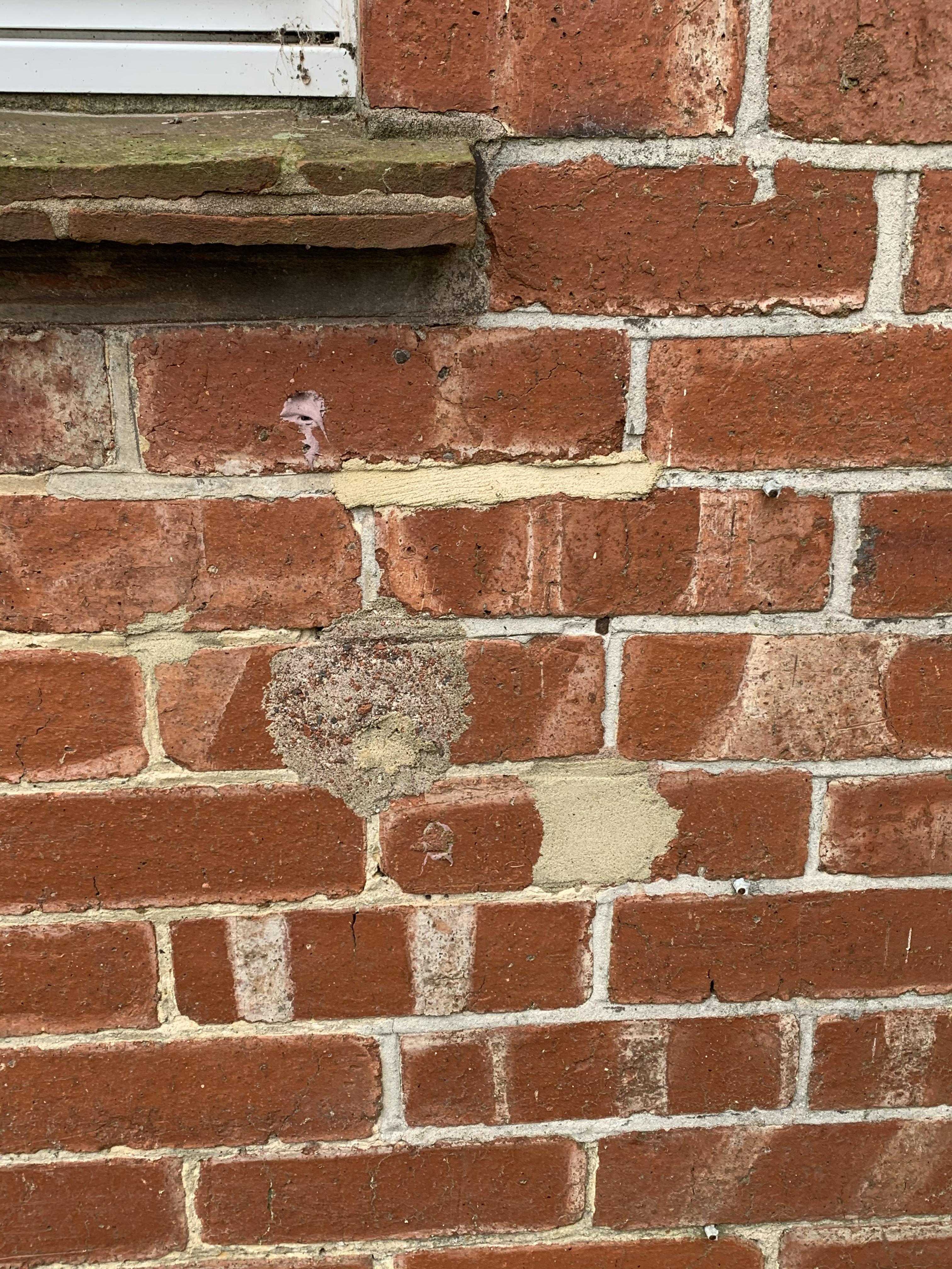

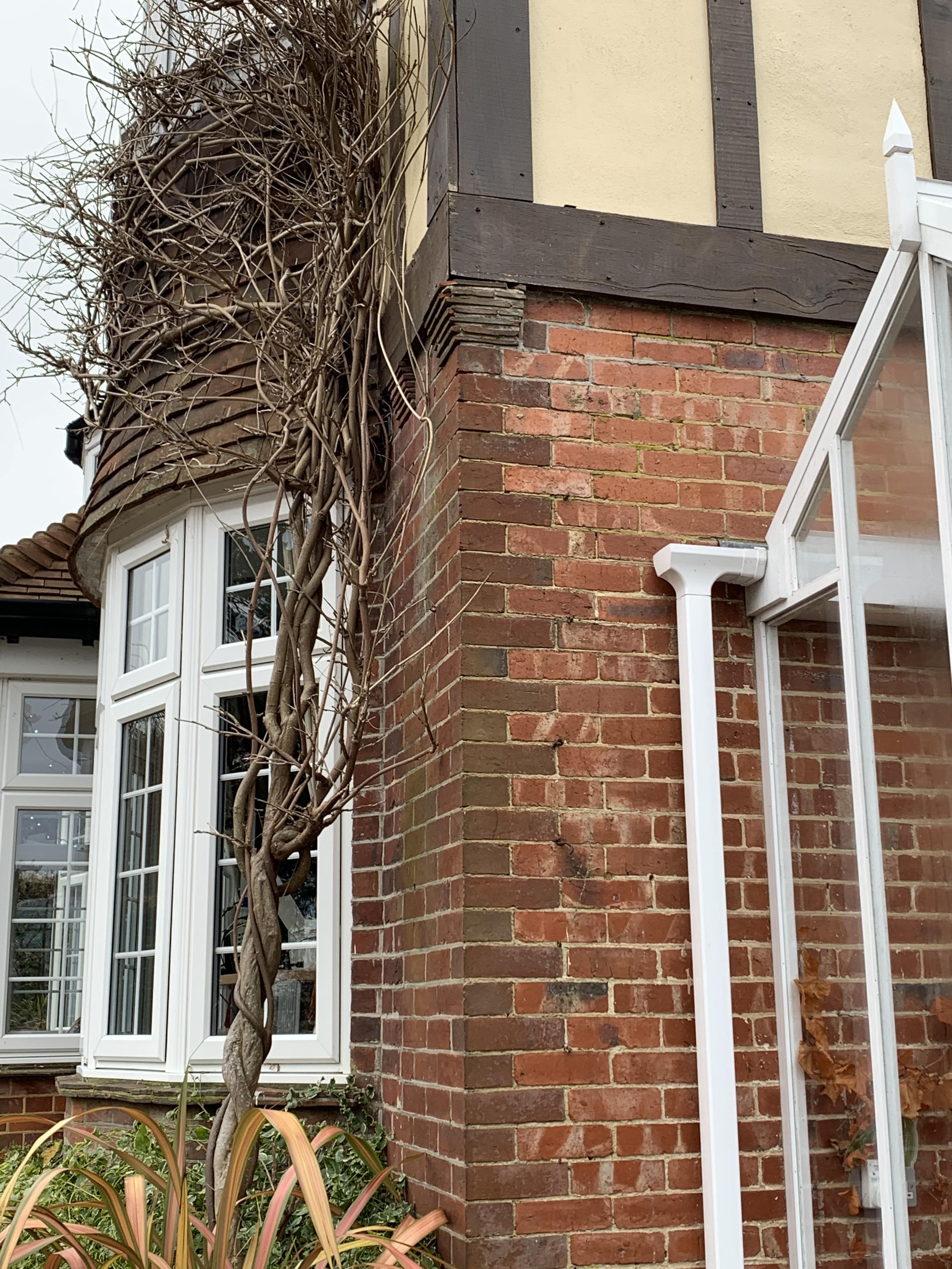

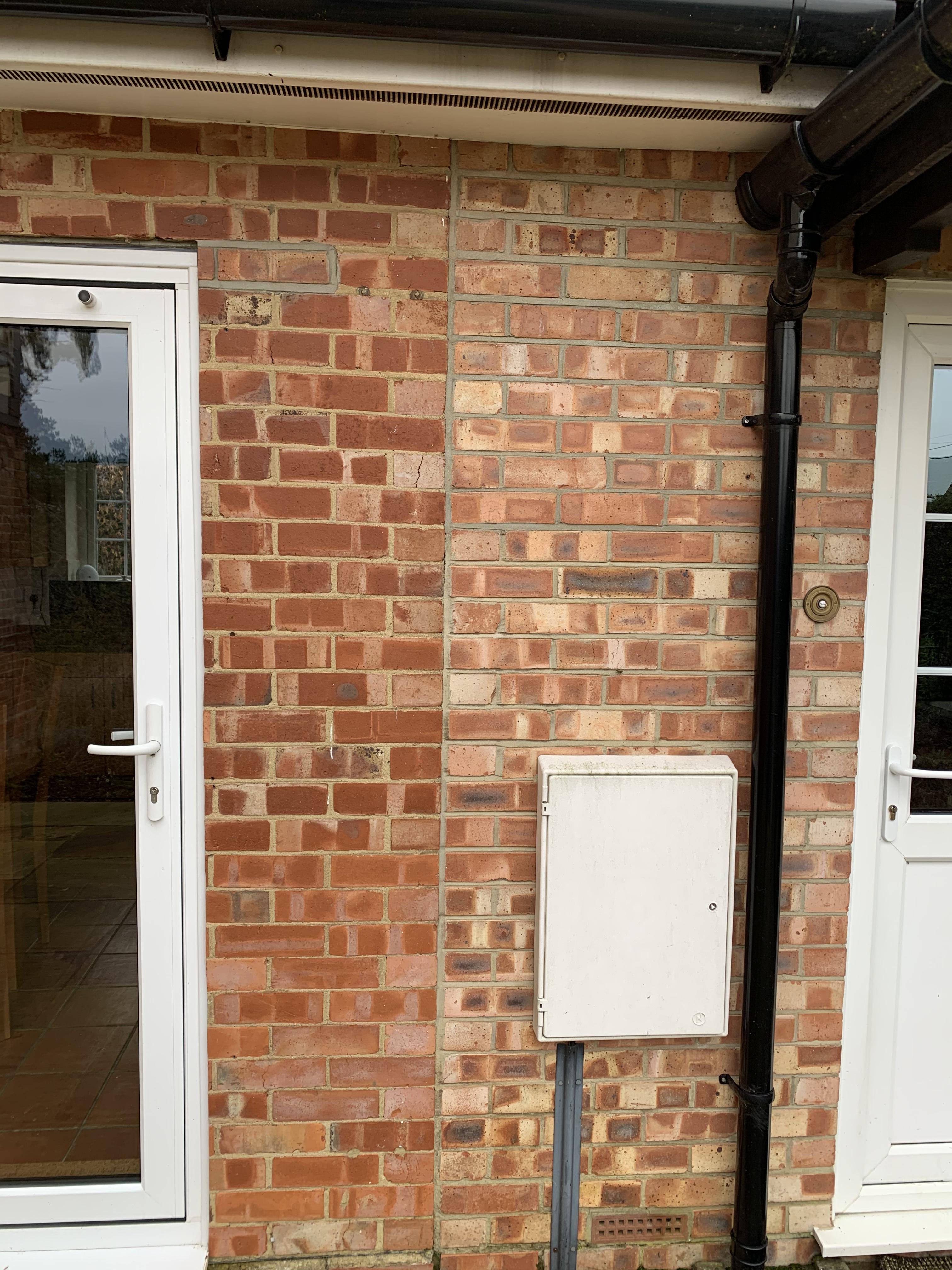

Robert Clark Posted December 29, 2019 Share Posted December 29, 2019 (edited) Have been trying to get planning permission to demolish our 1920’s house and replace with a Passivhaus, but the planners and neighbours are not supporting the scheme. We live in an AONB and they say any scheme must be of the highest quality. They say that our house is ‘beautiful’ , which it is from a distance.... But look a little closer and the mix of brick types and the state of them certainly leaves a lot to be desired by bay windows As well as the dodgy brickwork I really hate the Tudor boarding and the painted render and would prefer something much lower in maintenance. Inside the house has loads of character features including oak beams everywhere so in many respects a refurb would possibly give us much nicer outcome than a new build. Thinking about a single storey extension to create a large kitchen/family room and to knock the current (small) dining room and study into one to create a large lounge. Any ideas for improving the exterior brickwork and Tudor boarding? Also don’t like the UPVC windows as the Georgian bars spoil our view of the garden. Any other comments and suggestions would be appreciated. Thanks Edited December 29, 2019 by Robert Clark Added detail Link to comment Share on other sites More sharing options...
Simplysimon Posted December 29, 2019 Share Posted December 29, 2019 have to ask, if you dislike it that much, why did you buy it? personally, i like it, apart from the pvc windows. Link to comment Share on other sites More sharing options...
Robert Clark Posted December 29, 2019 Author Share Posted December 29, 2019 When we bought the house 15 years ago it was the only one we could find locally that gave us the space we needed in the location we wanted to live in. Love most of the house only certain aspects we would prefer to be different Link to comment Share on other sites More sharing options...
Thedreamer Posted December 29, 2019 Share Posted December 29, 2019 Are you still needing to live in that location, would you not sell up and buy a plot and build? I like the house as well. I don't understand how you won't lose a lot of equity. Link to comment Share on other sites More sharing options...
Robert Clark Posted December 29, 2019 Author Share Posted December 29, 2019 8 minutes ago, Thedreamer said: Are you still needing to live in that location, would you not sell up and buy a plot and build? I like the house as well. I don't understand how you won't lose a lot of equity. buying a building plot was our original plan. However they are like hens teeth and they are not available with views like we have so we decided to either re build here or re develop Link to comment Share on other sites More sharing options...

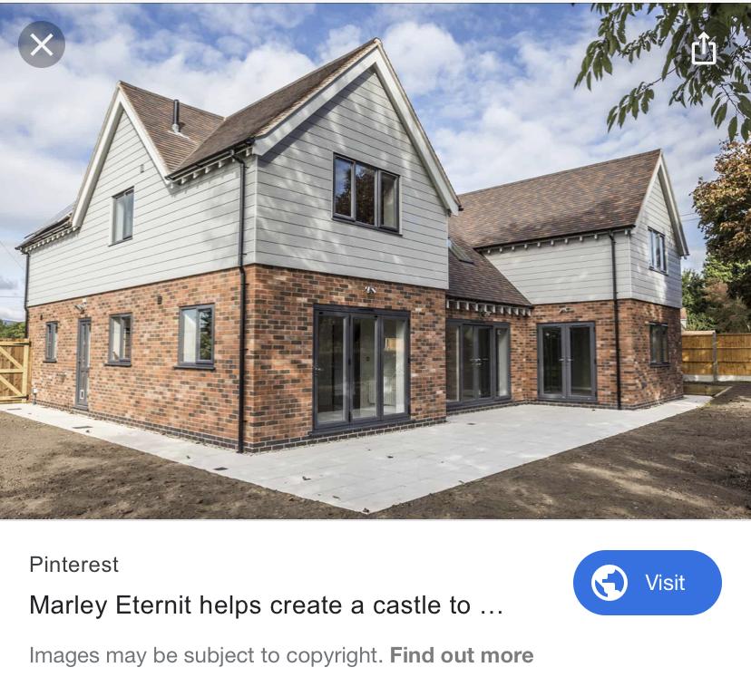

PeterW Posted December 29, 2019 Share Posted December 29, 2019 Could clad it with something like this which is low maintenance Other option is a Weber render. 1 Link to comment Share on other sites More sharing options...
Robert Clark Posted December 29, 2019 Author Share Posted December 29, 2019 3 minutes ago, PeterW said: Could clad it with something like this which is low maintenance Other option is a Weber render. that’s one option I’m thinking about and it’s traditional for this area. As is tile hanging Link to comment Share on other sites More sharing options...
