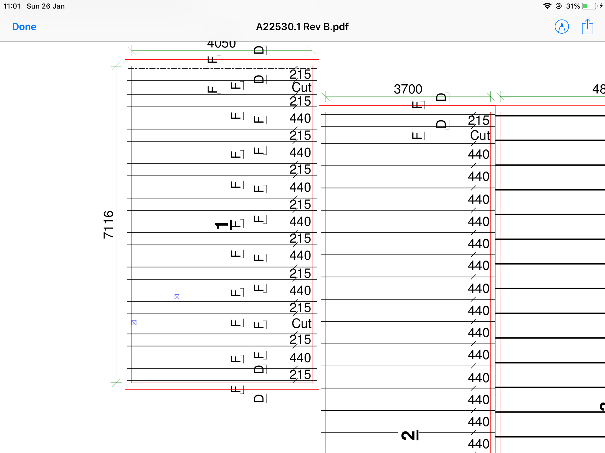

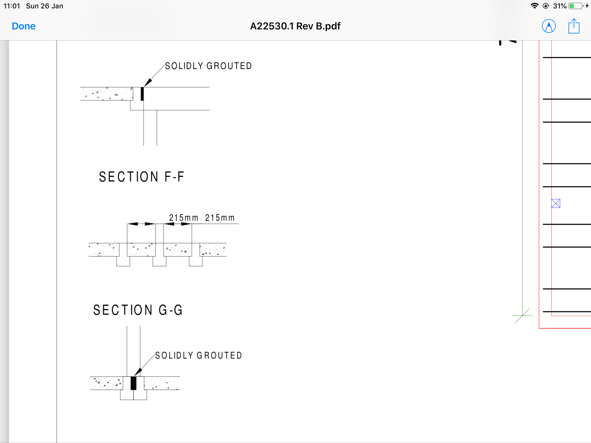

davejura Posted January 26, 2020 Posted January 26, 2020 Hi folks. Hope you don't mind me jumping in here. My engineers drawings are specifying 389mm centres for the beams, using 18kg blocks. He is basically saying we need to cut down standard 440mm blocks, all 1100 or so of them! Not only will this be very time consuming, there will be a lot of waste. Does anyone have any ideas? What size would the blocks need to be at 389mm centres? We have substantial under build, so a slab is not an option. What I thought was a simple, cost effective solution is turning out to be far from it! Thanks. 1
Russell griffiths Posted January 26, 2020 Posted January 26, 2020 (edited) 11 minutes ago, davejura said: Hi folks. Hope you don't mind me jumping in here. My engineers drawings are specifying 389mm centres for the beams, using 18kg blocks. He is basically saying we need to cut down standard 440mm blocks, all 1100 or so of them! Not only will this be very time consuming, there will be a lot of waste. Does anyone have any ideas? What size would the blocks need to be at 389mm centres? We have substantial under build, so a slab is not an option. What I thought was a simple, cost effective solution is turning out to be far from it! Thanks. Your engineer is an fool. have you been to the beam manufacturer to get the calcs done properly. As said earlier they will add in a couple of extra beams and alter the spacing down to 215 or one block at 440 then 215 then 440 Edited January 26, 2020 by Russell griffiths 1
Vijay Posted January 26, 2020 Posted January 26, 2020 (edited) Is it a B&B supplier who's done the drawings or your structural engineer?? Exactly what Russell said is what happened with mine. I had to cut down a row of blocks as obviously you will be left with an un-exact block gap Edited January 26, 2020 by Vijay
davejura Posted January 26, 2020 Posted January 26, 2020 (edited) Makes total sense Russell, thanks for your input! Yes it is the engineer who has come up with the specification, but very vague. I think he is trying to steer me towards Comfloor 51, which i know nothing about. I think I will go back to them and ask if it can be manufacturer designed and that stated on the warrant drawings, same as the roof trusses. If they won't budge, is it easy to make an amendment with building control as long as I can show a satisfactory design from the manufacturer? Edited January 26, 2020 by davejura
Vijay Posted January 26, 2020 Posted January 26, 2020 why not just send your plans to B&B suppliers yourself
Russell griffiths Posted January 26, 2020 Posted January 26, 2020 22 minutes ago, Vijay said: why not just send your plans to B&B suppliers yourself Exactly, how can your engineer spec a floor without knowing which floor supplier you would like to use. I got 3 quotes and each one was different as the beam manufacturers have different sized moulds to make the size of beams they like, we had a 100mm wide beam as span was 5m, other companies only had a 50-75mm wide beam so needed to add more beams for the same span. It is ok using an engineer for this but if he specs a certain type of beam how does he know it fits with your budget, engineers spec to cover their backs not your wallet.
Simplysimon Posted January 26, 2020 Posted January 26, 2020 don't allow the se to stagger the beams, put in a block thick wall to carry the ends of both beams it will save cutting a lot of blocks. for all the extra cost of founds and a block wall, i would also not span any more than 3m without a dwarf wall it's surprising how much bounce there is in them and that was with the beams doubled up. even with the concrete pourd on top if you jump there is slight movement. 1
davejura Posted January 26, 2020 Posted January 26, 2020 "engineers spec to cover their backs not your wallet. " Totally right there Russell, as we are finding out! Founds are double block anyway as we have a lot of under build, with a dwarf wall in the middle giving a span of about 3.8m for the beams. House is upside down, so bedrooms will be downstairs where the beam and block is. Thanks for your advice folks, onto beam and block companies tomorrow. Any recommendations? We are West Coast of Scotland.
