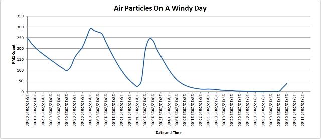

Adrian Walker Posted December 19, 2019 Share Posted December 19, 2019 (edited) 13 hours ago, DavidHughes said: Well, having found this forum a few months ago and benefited greatly from the well-informed posts concerning MVHR I felt I'd like to share my own experiences and give a condensed list of useful practical tips. Unfortunately on reflection I feel compelled to write a different kind of post but still in the spirit of helpful advice. Having just DIY installed a professionally designed and supplied MVHR system in my bungalow, and looking closely at all the time and numbers I conclude that it is largely not worth it in terms of either cost or performance. I have come to the conclusion that a carefully designed system of adjustable wall, window and ceiling vents will fulfil the same needs at a fraction of the price and effort. The primary reason for this conclusion is that building regulations section F requires a continuous ventilation flow rate for an MVHR system of 0.3x the floor area in L/s. For a 100m^2 bungalow = 30 L/s. At this ventilation rate, assuming an average 21C inside and annual average 10C outside, with gas central heating, you will be saving about £200/year on heating with a 90% efficient MVHR. My experience with both this house and a previous one with an MVHR system is that you actually need only a small fraction of 0.3 ACH for any house to ventilate it adequately. Previous other posts on this forum also conclude that the required flow rate which they actually run their houses on is much lower than 0.3 ACH. The 0.3 ACH value is an outlier worst case, most owners of modern houses will find 0.1 ACH completely comfortable, even with cooker hoods and showers taken into consideration. I have personally found that about 0.05 ACH continuous is absolutely fine for a few people in a small house. If you now look at 0.05-0.1 ACH continuous you find that the heat saving per year is £30-£60/year. Out of interest I also do scuba diving occasionally and can confirm that about 0.5 L/s for one person doing moderate exercise adjusted from 10-20m pressure to 1 bar at the surface is normal. Now lets look at cost and effort. For my 100m^2 bungalow I paid BPC ventilation (who, despite what I have said are excellent in every way) about £2000 to design and supply an MVHR system for my 100 m^2 bungalow. I have very conservatively spent 100 hours planning, installing and testing the system. I have had to take paid time off work to allow building control in to inspect. I have had to hire a calibrated flow meter at a cost of about £140 including postage. I have messed about with it for many hours (about 20) to balance the system. I have spent at least 10 hours preparing the relevant documentation for Building Control. I have had to shave the bottom off all of my doors to make a 10mm gap for through house air flow and in some cases re-paint, I don't even want to think about those hours! I could go on but shall we call it £5000 if I paid someone to do all this? That's not unreasonable. So I pay £2000 and do it DIY for a £50/year payback = 40 years Or I pay someone £5000 for a £50/year payback = 100 years The MVHR unit will probably last no more than 25 years but the ducting will hopefully last a lot longer. According to the manufacturers of the MVHR I need to inspect the filters every 3 months and replace them at 2x£20 every 6-12 months. And if you are CO2 conscious lets not forget the cost of manufacturing the kit in the first place - who knows? So why did I do it? Well I got suckered into it. The last house in which I DIY installed a system like this I swapped an old heat exchanger for a crate of beer, put simple ducting and fans in about 20 years ago. I didn't need to consult building control, just did it and ran it for 10 years. It worked really well and cost me about £400 in bits and about 50 hours time. I started this new house recently and suddenly building control and the 0.3 ACH rule comes in. Still determined I pressed on to make sure my house was compliant but I should really have stopped and thought about it before I spent my £2000 on kit and began work. Are there any benefits to MVHR? Not many. I'm confident that in new build in 20 years time it will all be gone and that carefully planned vents incorporated into high quality glazing units and ceilings will be the order of the day. The only things which I can think of are filtration of pollen and pollution and maybe noise reduction (vents let in noise). If I were to do it again? No MVHR. High quality adjustable wall vents low down in the corners of all bedrooms (the rooms which you want to be coolest). Similar ceiling vents in living areas to let the air out. Bathrooms with good, possibly motorised, flap valves on the extractors. A recirculating cooker hood fan or total extract with similar good flap valve. Chase and fix drafts religiously including floors with insulating and low air permeability underlay. Hire a cone flow meter to see what's really happening. https://www.bsria.com/uk provide this service for £80-140 depending on whether you collect or have it delivered. Set the system at about 0.05-0.1 ACH On a two storey house a duct and low power fan to circulate the air top to bottom (my last house had this and it was excellent) If the layout of the house were amenable ( I have solid floors so no chance) I would probably attempt to draw air in over the foundations of the house to either pick up heat in winter or let go of heat in the summer. Follow the building regs guidelines section F which do have some good rules but don't bother telling them unless you absolutely feel the need to - it's just some wall vents in a house... Regards, David Hughes Ex F35 Lift System Stress, Thermal and Dynamics Engineer and home energy efficiency enthusiast. The Wirral. What are your air tightness figures? I'm guessing well over 1 (ACH50). Just re-read your post and it say "...professionally designed and supplied MVHR system...". It couldn't have been professionally designed without any air tightness figures IMHO Edited December 19, 2019 by Adrian Walker Link to comment Share on other sites More sharing options...
