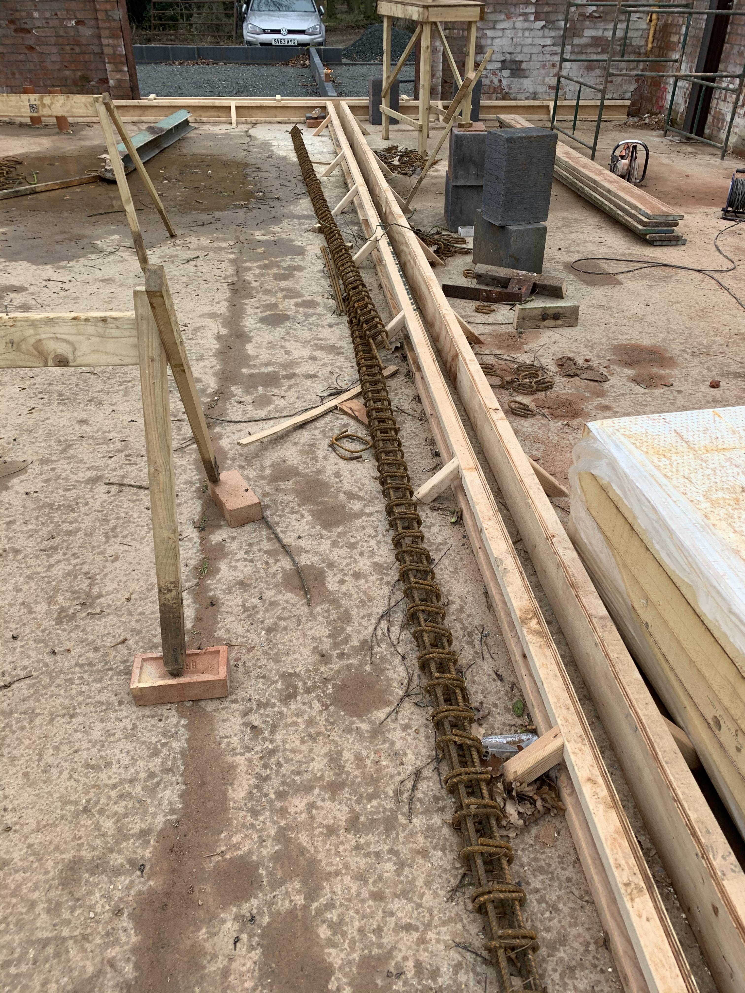

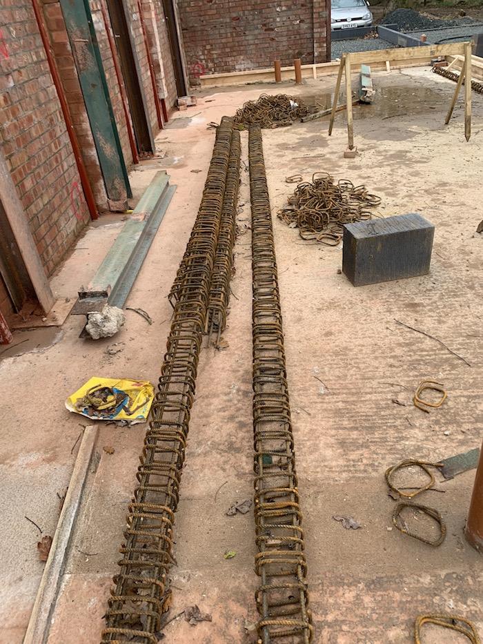

gc100 Posted December 14, 2019 Posted December 14, 2019 Timely topic as I'm doing mine now. I got all my rebar cut and bent for about £580. There is no way in a million years I'd want to bend it myself. There are about 850 rings, then all the long lengths. Whats taking me forever is wiring it up - about 4-5 days so far. Now off to do some more now. 1
Russell griffiths Posted December 14, 2019 Posted December 14, 2019 Wow those links are close together @gc100 whats the spacing?
Adrian Walker Posted December 14, 2019 Posted December 14, 2019 1 hour ago, Russell griffiths said: Wow those links are close together @gc100 whats the spacing? That doesn't look like right to me either...and they don't look evenly spaced.
gc100 Posted December 15, 2019 Posted December 15, 2019 (edited) On 14/12/2019 at 10:16, Adrian Walker said: That doesn't look like right to me either...and they don't look evenly spaced. 80mm . The don’t look right because each ring has 2 bars on one side of it, so depending which was you put it on sometimes you get one sometimes two, plus none are exactly the correct size/bend so once fixed to one side in the other side it’s impossible to get them vertically straight. Total pain. Essentially each ring is actually a spiral , you can see better here Edited December 15, 2019 by gc100
