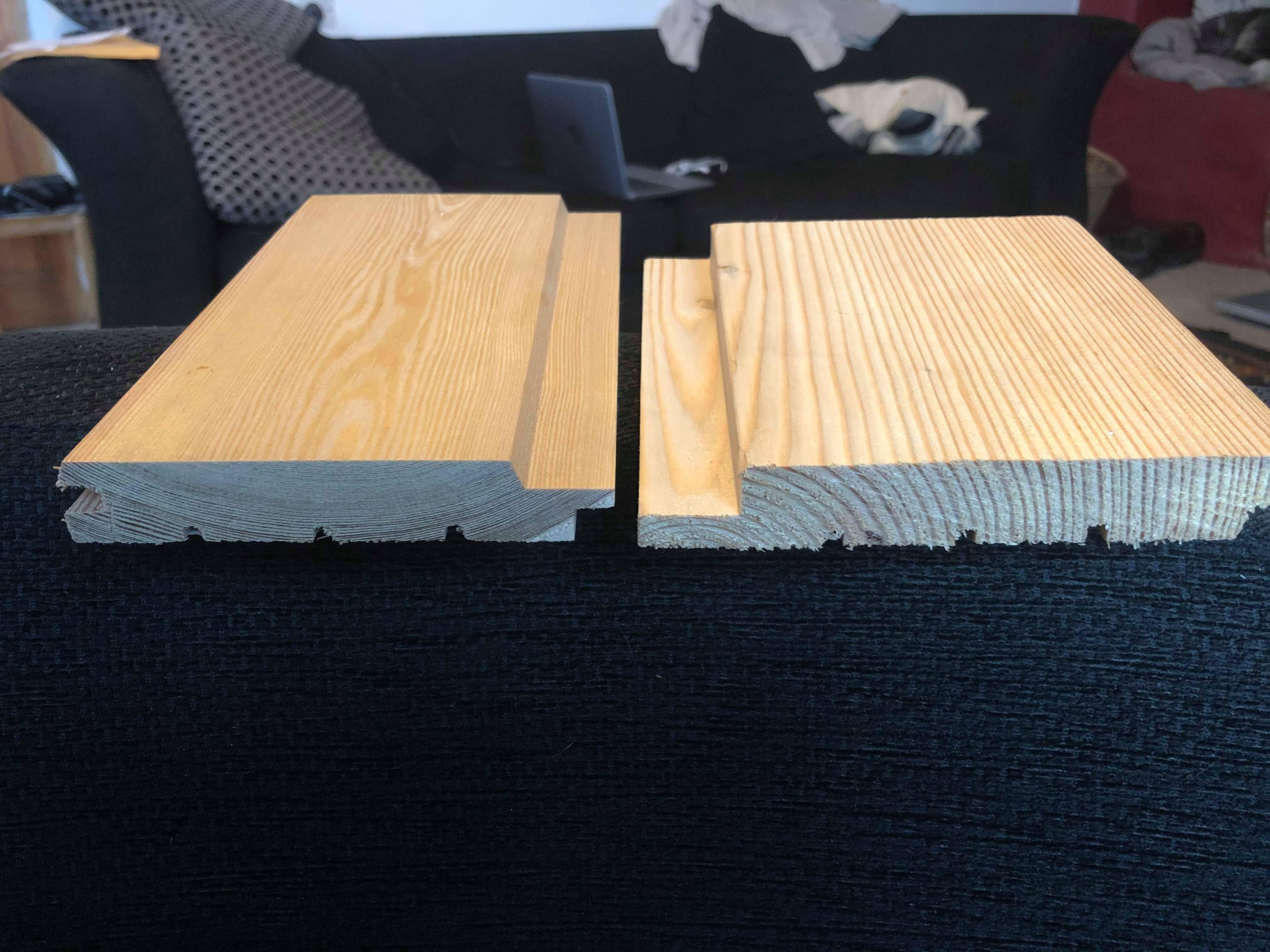

Roz Posted November 13, 2019 Posted November 13, 2019 I don't even know if I want Grade A but the difference between these two samples from different companies seems significant! Larch. The one on the left is so much heavier too. They are both listed as Grade A. The one on the right didn't give me a straight answer when I asked if this was equivalent to Unsorted. I thought the price was too good to be true ?
Gone West Posted November 13, 2019 Posted November 13, 2019 (edited) @Roz The one on the left is much closer grain and should therefore be better. Edited November 13, 2019 by PeterStarck 2
scottishjohn Posted November 13, 2019 Posted November 13, 2019 also look how the grain runs in both bits --second one looks like fast grown pine-- crap 2

Alex C Posted November 13, 2019 Posted November 13, 2019 You cant really compare two 6 inch lengths of timber and expect a truck load of it to be the same as your samples, there is going to be a lot of variation. Buy FSC certified from a reputable supplier and find out where the timber comes from. Scottish Larch is wider grained and more knotty, also cheaper, and it is possible that is what your sample on the right is.
Roz Posted November 13, 2019 Author Posted November 13, 2019 1 minute ago, Alex C said: You cant really compare two 6 inch lengths of timber and expect a truck load of it to be the same as your samples, there is going to be a lot of variation. Buy FSC certified from a reputable supplier and find out where the timber comes from. Scottish Larch is wider grained and more knotty, also cheaper, and it is possible that is what your sample on the right is. Sorry I should have said, they're both siberian. Do you think they would vary this much within a batch from the same company?

Mr Punter Posted November 13, 2019 Posted November 13, 2019 Left hand looks like Siberian larch heartwood. Right hand looks like crap and not genuine. The Siberian larch I have had was all a similar (high) density. It looked fairly ginger in colour. It is slow growing and the growth rings are therefore fairly tight.

Big Jimbo Posted November 13, 2019 Posted November 13, 2019 4 hours ago, PeterStarck said: @Roz The one on the left is much closer grain and should therefore be better. Much slower grown, so as Peter said, should be much stronger, and much better. The one on the right is quick grown, much lighter, and looks by comparison, SH*"E. You get what you pay for. 1
Ferdinand Posted November 14, 2019 Posted November 14, 2019 (edited) There is good advice on this thread - mainly to take time and care yourself, but I do not think we have an expert on the forum. First thought: You need to understand what "Grade A" means. I am also no expert, but the LH sample is a "tangential" cut (ie around the log) and looks to be either heatwood or a smaller tree, and the RHS one is some form of "quarter" or "radial" cut (ie out from the centre. I do not think the RHS one is rubbish - just different, through certainly faster grown. You need to know that your whole batch is the same, or at least understand the variability. They will behave differently on the wall - the LHS one may "cup" one way or the other on the wall, due to the grain - even though it is heavier. And that needs to be taken into account when you install. See: https://www.archtoolbox.com/materials-systems/wood-plastic-composites/woodlumbercuts.html My suggestion is to take advice from someone who has done lots of cladding, and be clear about what you want, to choose someone either reputable or local (Vincent Timber?), and to place quality before price. But you need to be clear on your goal first, and understand the particular boarding you are using and that it will fit your requirement. If that requires a little more care/money or a specialist (eg if your architect or other has done lots of cladding projects) to help you, then imo it is worth doing for such a prominent visual feature. OTOH timber is a fascinating subject to learn about yourself. Ferdinand Edited November 14, 2019 by Ferdinand 1

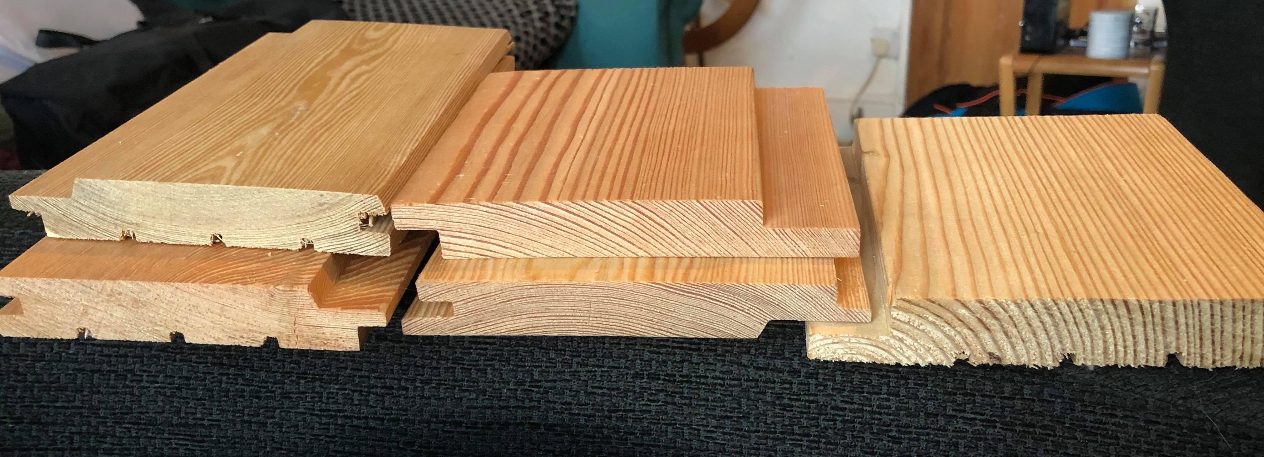

Roz Posted November 15, 2019 Author Posted November 15, 2019 I got another sample today. They do the profile I want but a bit more expensive... does anyone think the quality is significantly lower for the middle ones than the left ones? I don't want to pick profile over quality, but if it's not that significant then... 1
Russell griffiths Posted November 15, 2019 Posted November 15, 2019 Not trying to state the obvious but I take it you are going to fit this vertically.
Roz Posted November 15, 2019 Author Posted November 15, 2019 Just now, Russell griffiths said: Not trying to state the obvious but I take it you are going to fit this vertically. Yes
