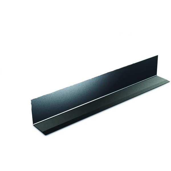

Gone West Posted November 18, 2019 Posted November 18, 2019 13 hours ago, zoothorn said: Good question. All of 2-3mm Peter. [2.5mm]. The whole thing is not only bowing down 3/4" but twisting forward in the middle too, & door one nearby: both have alot of block weight above. Do you think it's a flat steel bar like I was referring to or something like this. Did you see it being fitted. Catnic Lintel ANG 2400mm
zoothorn Posted November 18, 2019 Author Posted November 18, 2019 18 minutes ago, PeterStarck said: Do you think it's a flat steel bar like I was referring to or something like this. Did you see it being fitted. Catnic Lintel ANG 2400mm Good morning Peter- yes its something like this, exactly.. but a grey galv finish (& a 45* slope to the rear not r-angle). Yes I saw it fitted & watched the weight in the middle sag. Its no more than 3mm thick. I'll try do a photo later today. No-one on site it seems today. [Mods- is there an 'ignore' function on the site?] thanks zoot.
PeterW Posted November 18, 2019 Posted November 18, 2019 Probably an IG lintel then if it was galvanized. They are pretty common, look like a sloping “L” and are fairly easy to get
Gone West Posted November 18, 2019 Posted November 18, 2019 2 minutes ago, zoothorn said: yes its something like this, exactly.. but a grey galv finish (& a 45* slope to the rear not r-angle). That type are around 2.5mm thick steel because they are folded so don't need to be thick like a flat bar. They should be supported in the centre until the blockwork has set, especially if a long length, as @Russell griffiths has indicated. If you saw blocks being laid with the lintel unsupported have a word with the builder.
zoothorn Posted November 18, 2019 Author Posted November 18, 2019 41 minutes ago, PeterW said: Probably an IG lintel then if it was galvanized. They are pretty common, look like a sloping “L” and are fairly easy to get They're sort of like this, but do not have the additional back area which lookslike a strengthening bar area.

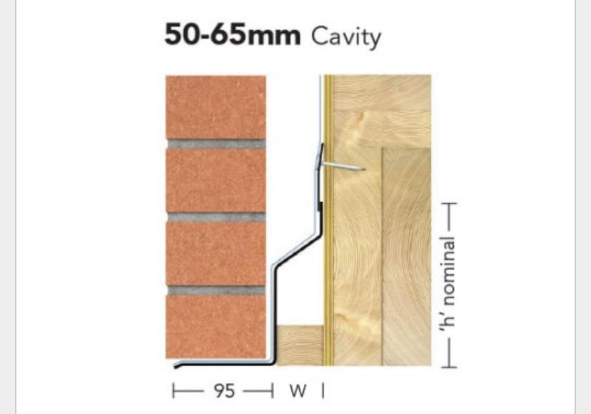

PeterW Posted November 18, 2019 Posted November 18, 2019 Ok so I’ve no idea which sort you’re looking at, but this is an IG Timber Frame lintel - the black line is the lintel
zoothorn Posted November 18, 2019 Author Posted November 18, 2019 Anyway I can't find the type that's been used, Peter's eg above is indeed closest. And as I said I'm happy to be proved wrong on the cost.. it seems maybe a concrete lintel -is- less.. but I can't be certain/ can't find my exact type. So why on earth would one of these have been used instead?? Ive never known anything so barking mad if the concrete type cheaper.
zoothorn Posted November 18, 2019 Author Posted November 18, 2019 @PeterW a 'Timber Frame' lintel.. aha ok. as its solely doing duties to the outer block layer Id never have known this is what it was called. This back angle up/ out, then up 90* again to the 'bed' is morelike to shape I saw. So, these type -had- to be used then, & a concrete type was never an option? But surely it should simply be thicker then.

PeterW Posted November 18, 2019 Posted November 18, 2019 Just to confirm - IG recommend a batten tight behind the bottom edge to stop twisting. If that isn’t there, it’s not installed according to Manufacturers Instructions

zoothorn Posted November 18, 2019 Author Posted November 18, 2019 Just now, PeterW said: Just to confirm - IG recommend a batten tight behind the bottom edge to stop twisting. If that isn’t there, it’s not installed according to Manufacturers Instructions Now this is just the info I need.. & concurrs with my feelings on it. But there is no way on earth I can put it to him to redo this- he will shut up shop, the work will stop, & I have no bargaining room on my floor (his original itemised groundwork quote, which he repated the same £figure for on the final quote but only in terms of 'groundwork' leaving off the itemised details.. it was clear the details already listed before, & no need to repeat.. that was the clear as day implication), & he'll go back on this that & the other, like the contoured render we agreed on.. he'll just not do/ it'll be flat/ just as I don't want. The only thing I can do is phone my BCO about it. This I'll do once I can scrape a photo together. All the power lies with these builders however you play it. They can just stop & not continue until you relent. You have to get it continued; they don't, they just go onto the other job. They can wait for payment for this job.. but you can't wait to get the build finished, especially @ the start of winter.
zoothorn Posted November 18, 2019 Author Posted November 18, 2019 11 minutes ago, PeterW said: Just to confirm - IG recommend a batten tight behind the bottom edge to stop twisting. If that isn’t there, it’s not installed according to Manufacturers Instructions If I knew it was an IG (company?) lintel, I could put this to the BCO -if I put it to the builder, the end of good terms/ he'll pop- but it doesn't look the same. Its a farm gate galvanised-look light grey lintel, but definitely this "Timber Frame type" shape.
zoothorn Posted November 18, 2019 Author Posted November 18, 2019 I cannot find these damn lintels exactly, but have found "https://www.less2build.com/catnic-lintel-ctf5-timber-frame--1200mm-50mm-cavity?language=en¤cy=GBP&gclid=EAIaIQobChMIyrOc5dTz5QIVybHtCh2b1gc0EAQYAiABEgICPfD_BwE which says.. " All timber frame models from any manufacturer must be secured with restraint clips (supplied) and a batten (not supplied) to prevent lateral deflection (twist) during the building stage to achieve the loading figures shown. " So I have this to put to my BCO. Ok if he tells builder to redo: is this feasable/ if so, how big a job would this be?
