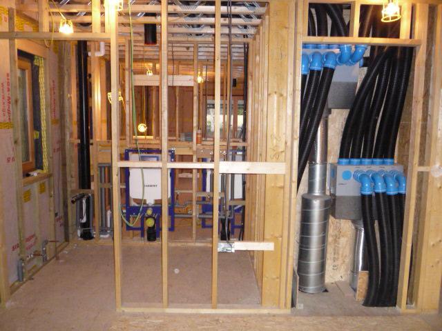

Savage87 Posted November 18, 2019 Author Posted November 18, 2019 As a quick update, I have settled for a Nuaire MRXBOXAB-ECO2 unit which is more or less identical with the Domus HRXE unit that I was looking to buy initially. I'm going for Airflow Airflex PRO 75mm radial ducting. BPC says that this is the best duct to use in a radial system because it's more flexible that other brands and it's anti static and anti bacterial lined. Good idea or just another sales technique? I would like to know how many of you have visual controls for your units? I would like to buy the https://xpress.nuaire.co.uk/mrxbox-vsc-wall-mounted-lcd-touch-screen-controller/ just so I can see what's going on with the unit and have the extra features that come along with it. It's over 200 pounds and don't know if it's worth it. I wouldn't want to buy it and then realise that I could have live without it.
MikeGrahamT21 Posted November 19, 2019 Posted November 19, 2019 I haven't got MVHR yet, but I also plan to get to radial anti-static and anti-bacterial ducting. I have read articles in the past in building magazines about nasty bugs being found in ducting of MVHR due to the temperatures which run through it, so I would say its critical personally, and for the little extra outlay should be worth it. Anti-static should prevent dust from sticking to the inside of ducting in theory, it will still get there, but should be much reduced. I too keep looking at fancy controllers, in fact i've actually made it one of the things on my wish list, but in reality I dont think they are needed, I'm pretty sure a good MVHR unit should be a fit and forget solution, which shouldn't require controlling if its setup correctly, many have sensors built in to handle differing conditions, I suppose the only thing which is useful is the filter change reminder, but you could set a reminder on your phone as its based on operating hours. Perhaps a unit which connects to your phone rather than has a control panel may be a better option, but these are hard to come by at the minute.

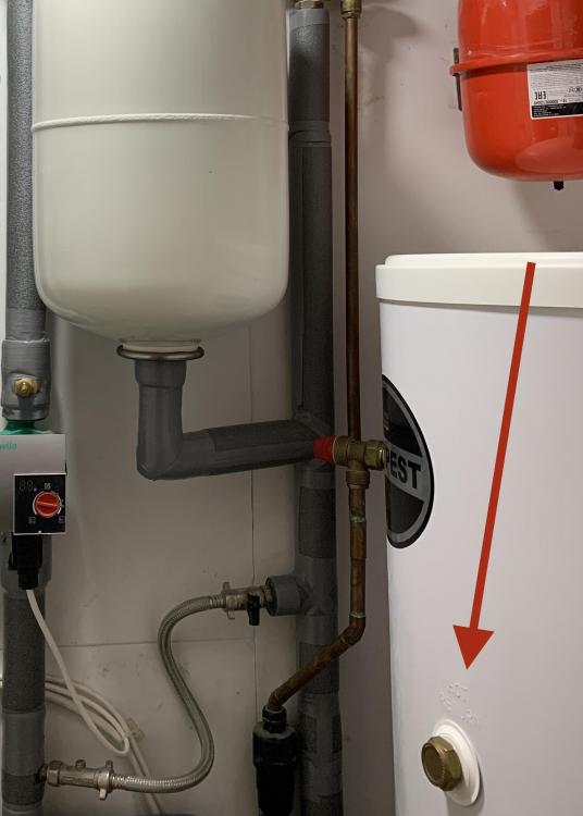

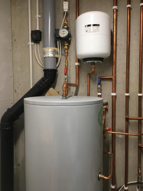

Bitpipe Posted November 19, 2019 Posted November 19, 2019 19 minutes ago, pocster said: Yes I was going to use movement and humidity sensors to trigger the boost . As I’ll have lots of home automation stuff I don’t think it would be too tricky to have the induction hob trigger the mvhr . Will play with that later I.e a year from now ? We use the same circuit to trigger the DHW return loop pump so that when you walk into the room there is hot water near the tap when you need it. 1
Pocster Posted November 19, 2019 Posted November 19, 2019 Just now, Bitpipe said: We use the same circuit to trigger the DHW return loop pump so that when you walk into the room there is hot water near the tap when you need it. Assume I don’t need to do this with a Uvc ?

Bitpipe Posted November 19, 2019 Posted November 19, 2019 16 minutes ago, pocster said: Assume I don’t need to do this with a Uvc ? It's a way of preventing water going cold in the pipework and reducing time to hot water at tap so independent of the storage system I think - basically a return loop to DHW storage with a pump that's either temp/timer driven or occupation etc..
Pocster Posted November 19, 2019 Posted November 19, 2019 2 minutes ago, Bitpipe said: It's a way of preventing water going cold in the pipework and reducing time to hot water at tap so independent of the storage system I think - basically a return loop to DHW storage with a pump that's either temp/timer driven or occupation etc.. I see . Does it make that much difference? I assume it saves a few seconds on making a hot tap hot ??
