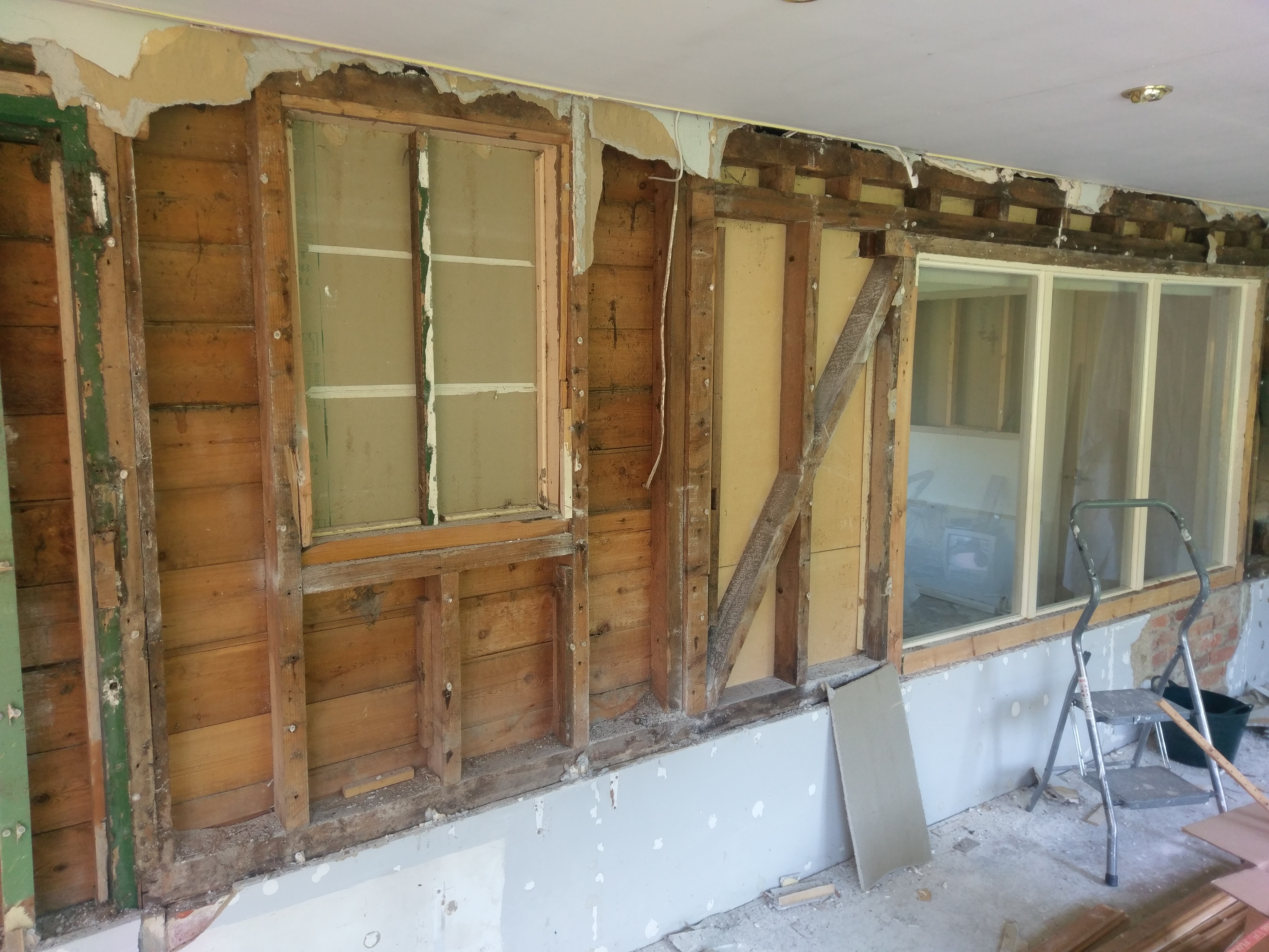

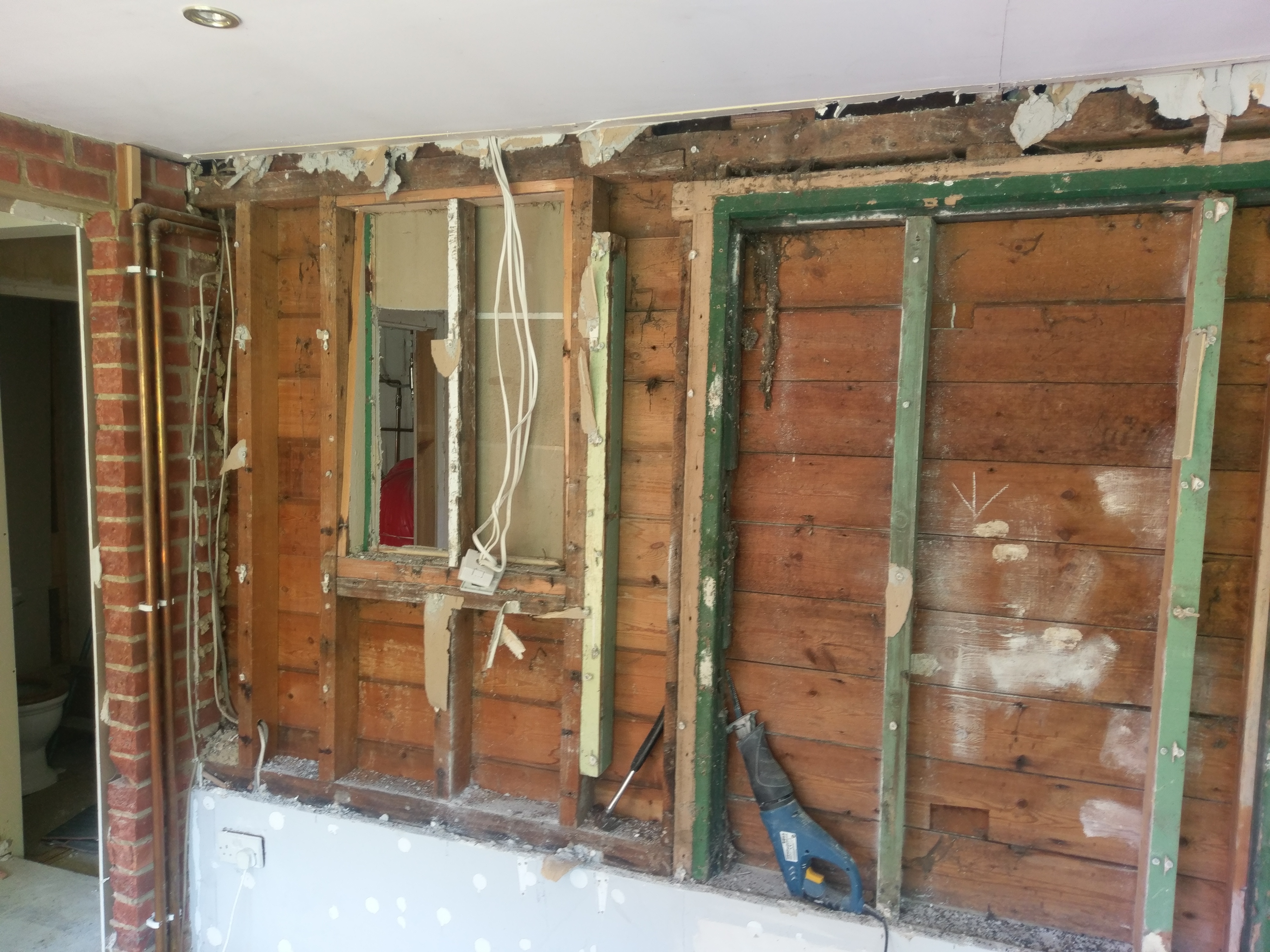

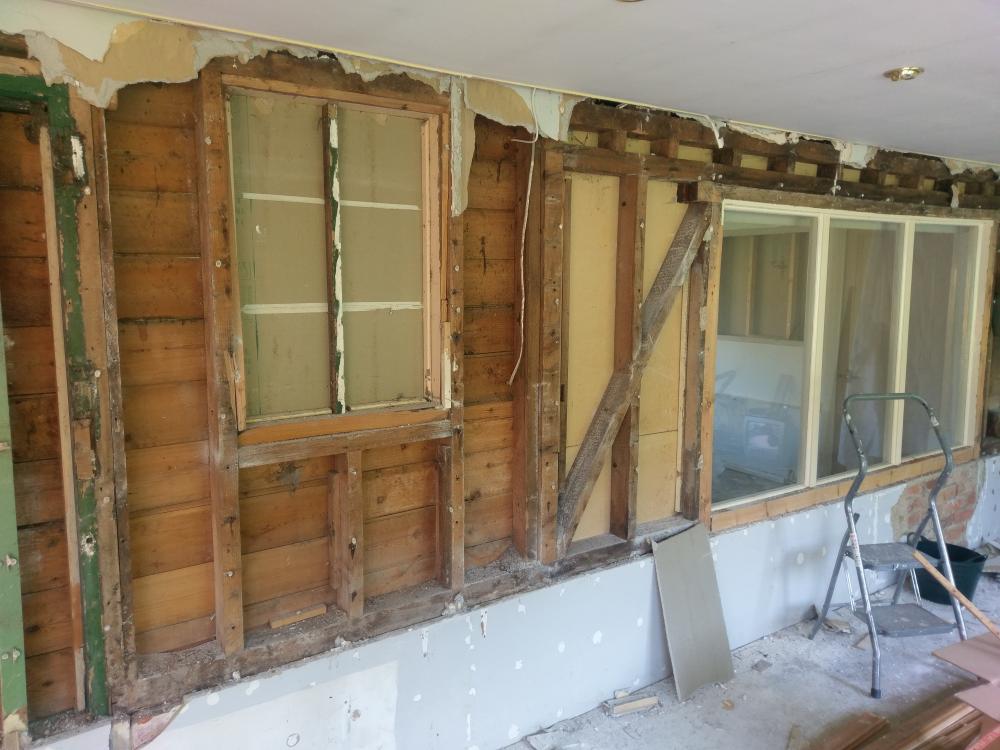

dogman Posted October 11, 2016 Share Posted October 11, 2016 After many months planning and waiting for my retirement we have finally started demolition of our old cottage. We always thought it was an old stable and carriage room. The structure we found buried inside the lounge wall confirms it, have a look at the attached. The glazed window was also inside the wall Link to comment Share on other sites More sharing options...

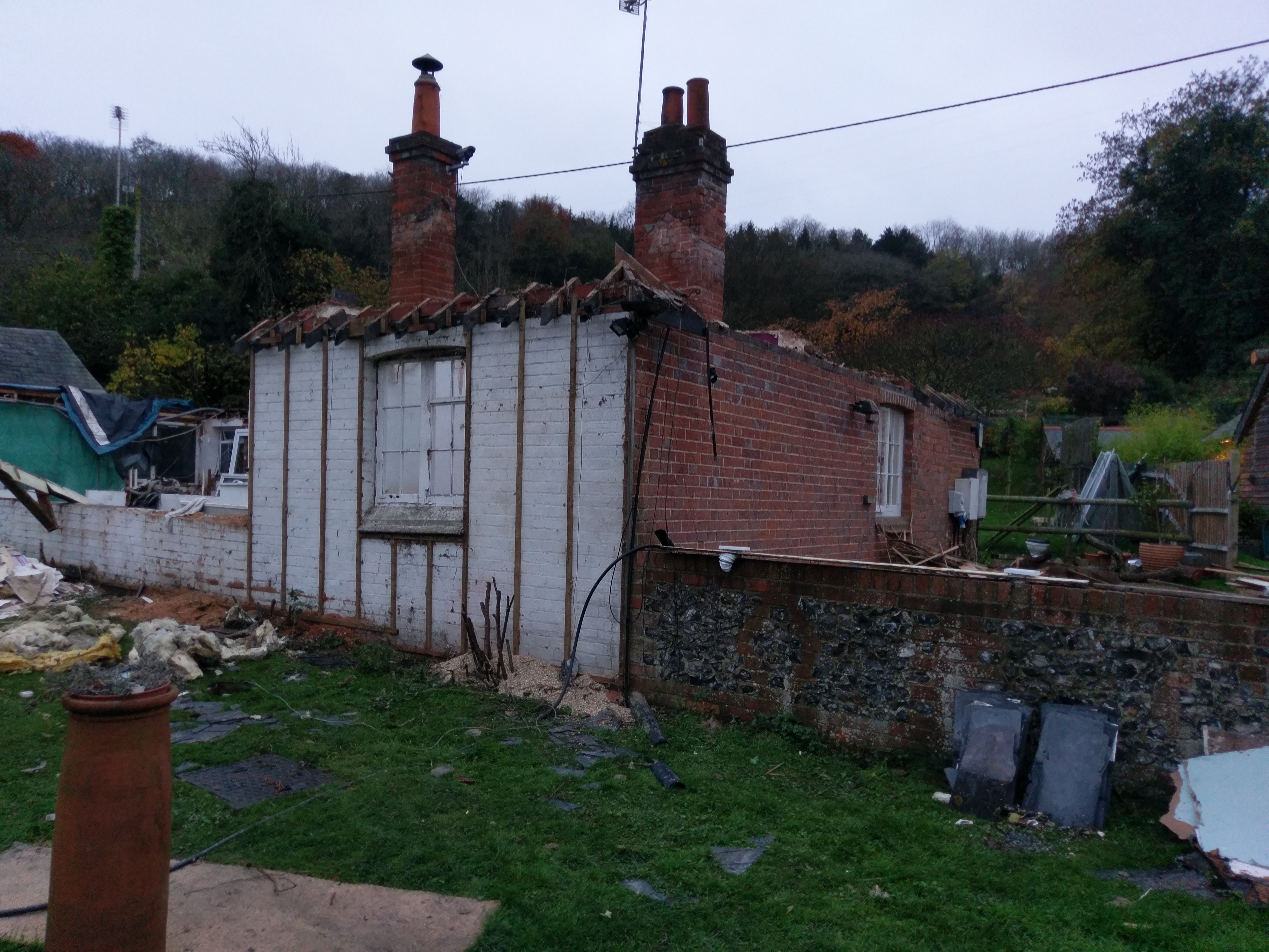

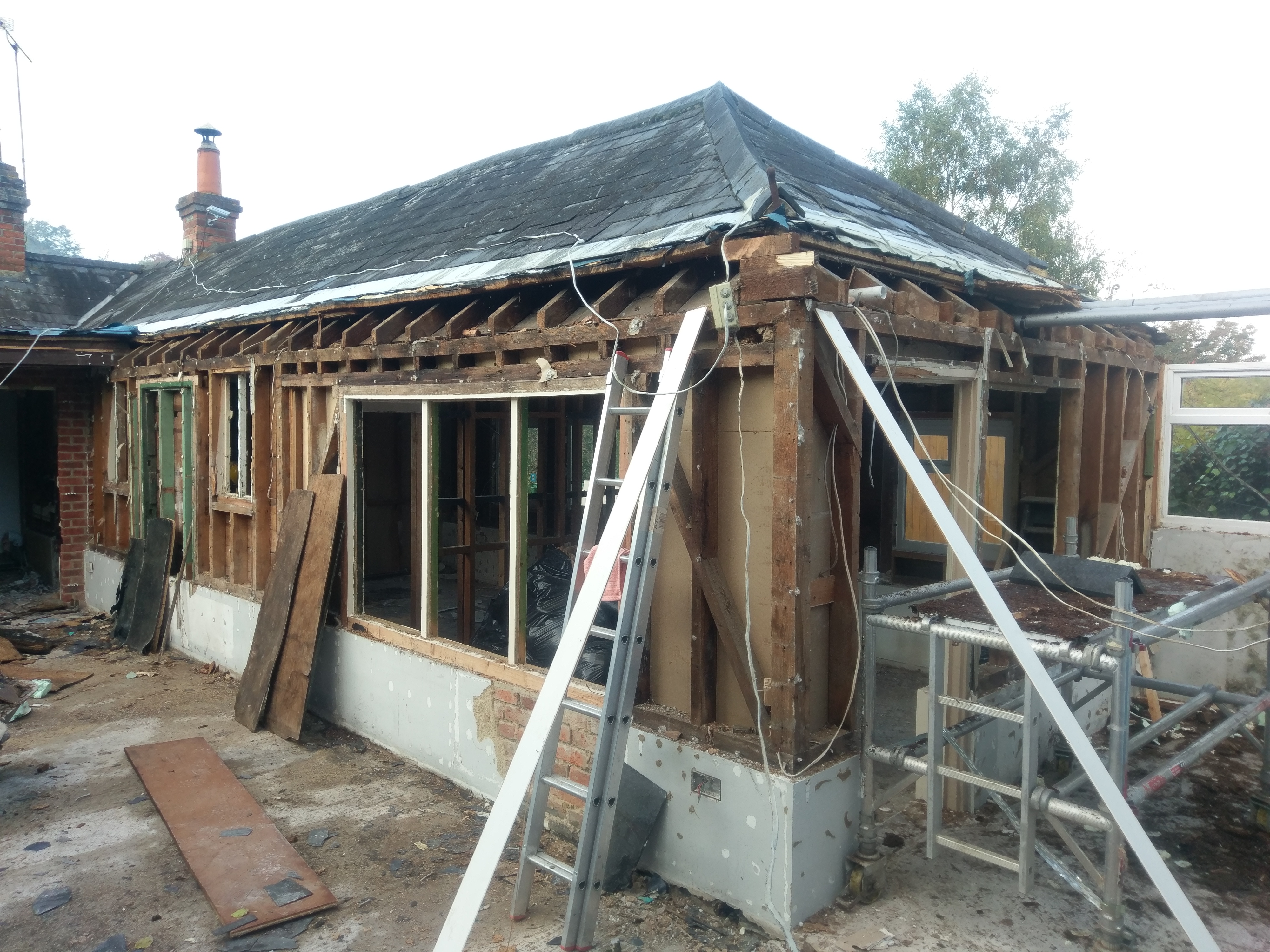

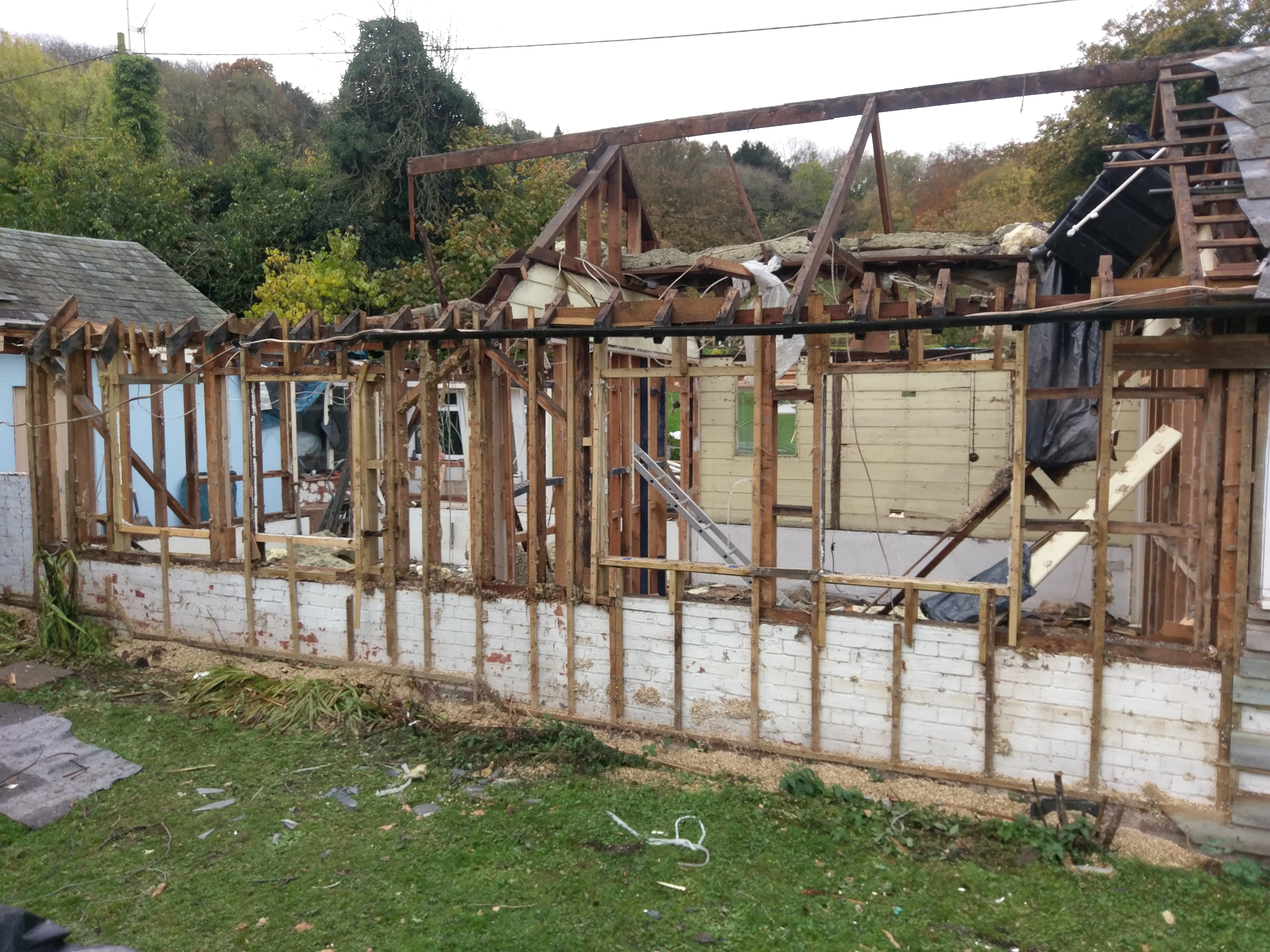

dogman Posted November 10, 2016 Author Share Posted November 10, 2016 Its slow progress taking a house down by hand Link to comment Share on other sites More sharing options...

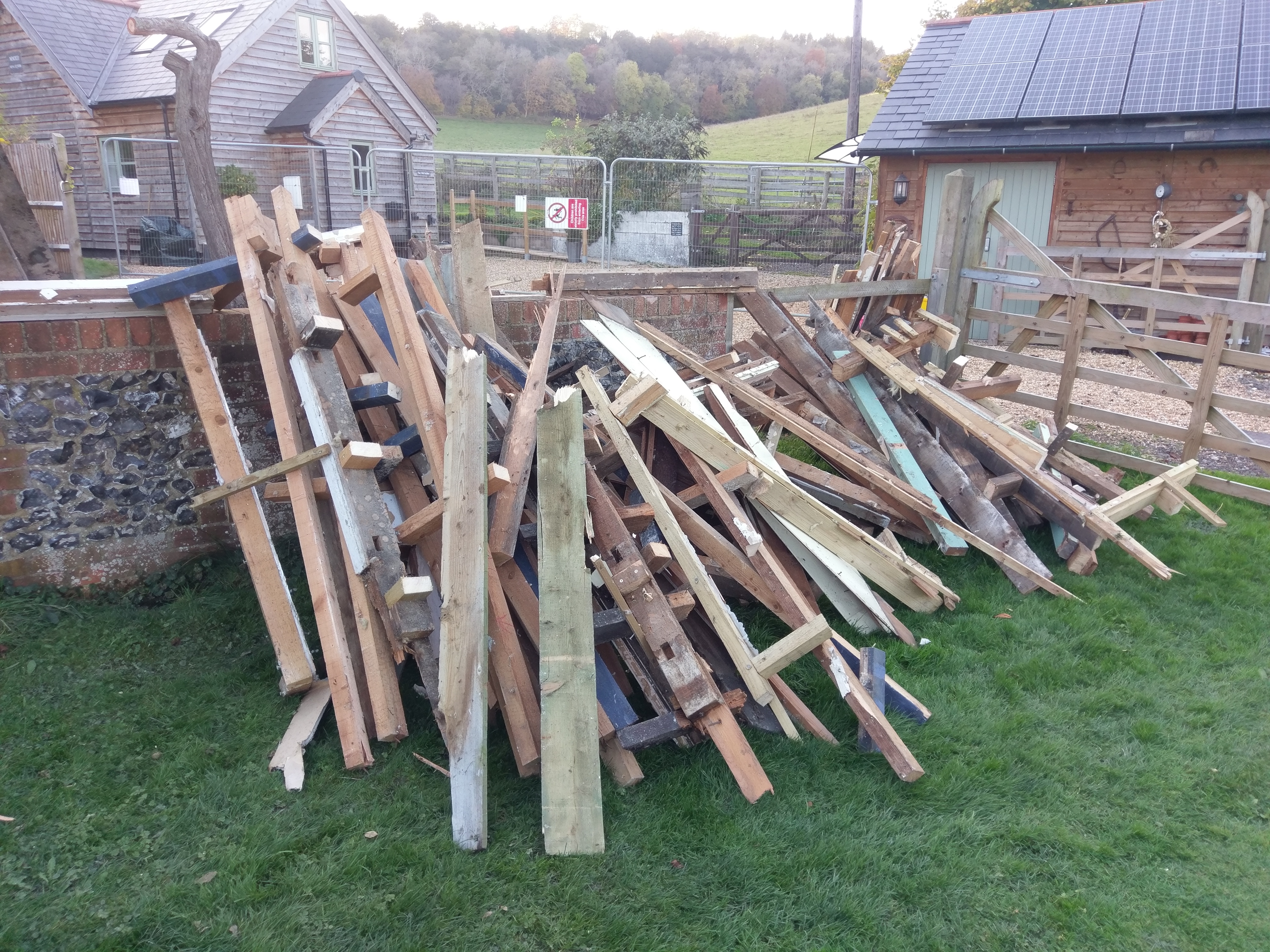

dogman Posted November 10, 2016 Author Share Posted November 10, 2016 Bonfire night went well. I burnt my house 1 Link to comment Share on other sites More sharing options...
ProDave Posted November 10, 2016 Share Posted November 10, 2016 All that timber. I could have made another shed...... Link to comment Share on other sites More sharing options...
Barney12 Posted November 10, 2016 Share Posted November 10, 2016 I had a HUGE amount of construction timber on our site. I sat and looked at it and said "I really cant throw away / burn most of that". It then dawned on me just how much work it would be to de-nail, sort and then stack (somewhere!). In the end I just put an advert on Gumtree "Free Wood", It was ALL gone within a day. One guy turned up with a Luton van and filled it. Many others just filled their cars for fire wood. 1 Link to comment Share on other sites More sharing options...

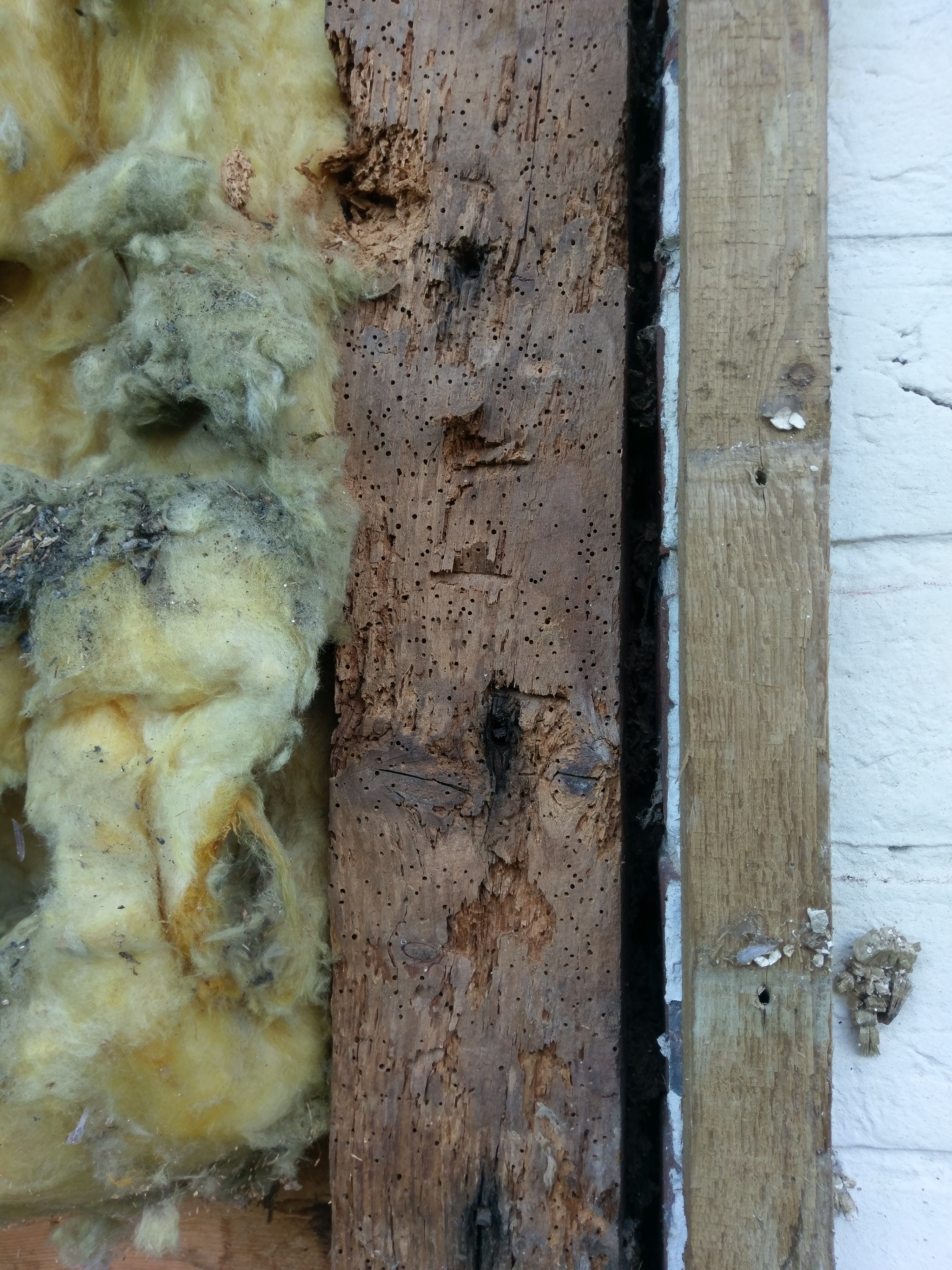

dogman Posted November 10, 2016 Author Share Posted November 10, 2016 The whole lot is infected with wood worm, dry rot and wet rot. There must also be a rot i don't know about. We did try and give it away for bonfire night but they all wanted me to drop it off It is best to burn it all as soon as removed especially as we are going timber frame for new house Link to comment Share on other sites More sharing options...
Barney12 Posted November 10, 2016 Share Posted November 10, 2016 Yup. Napalm it Link to comment Share on other sites More sharing options...
dogman Posted November 10, 2016 Author Share Posted November 10, 2016 Bit of larch cladding and it will melt steel, Was going for larch again but seeing the old stuff burn looking at fake fibre board type Link to comment Share on other sites More sharing options...

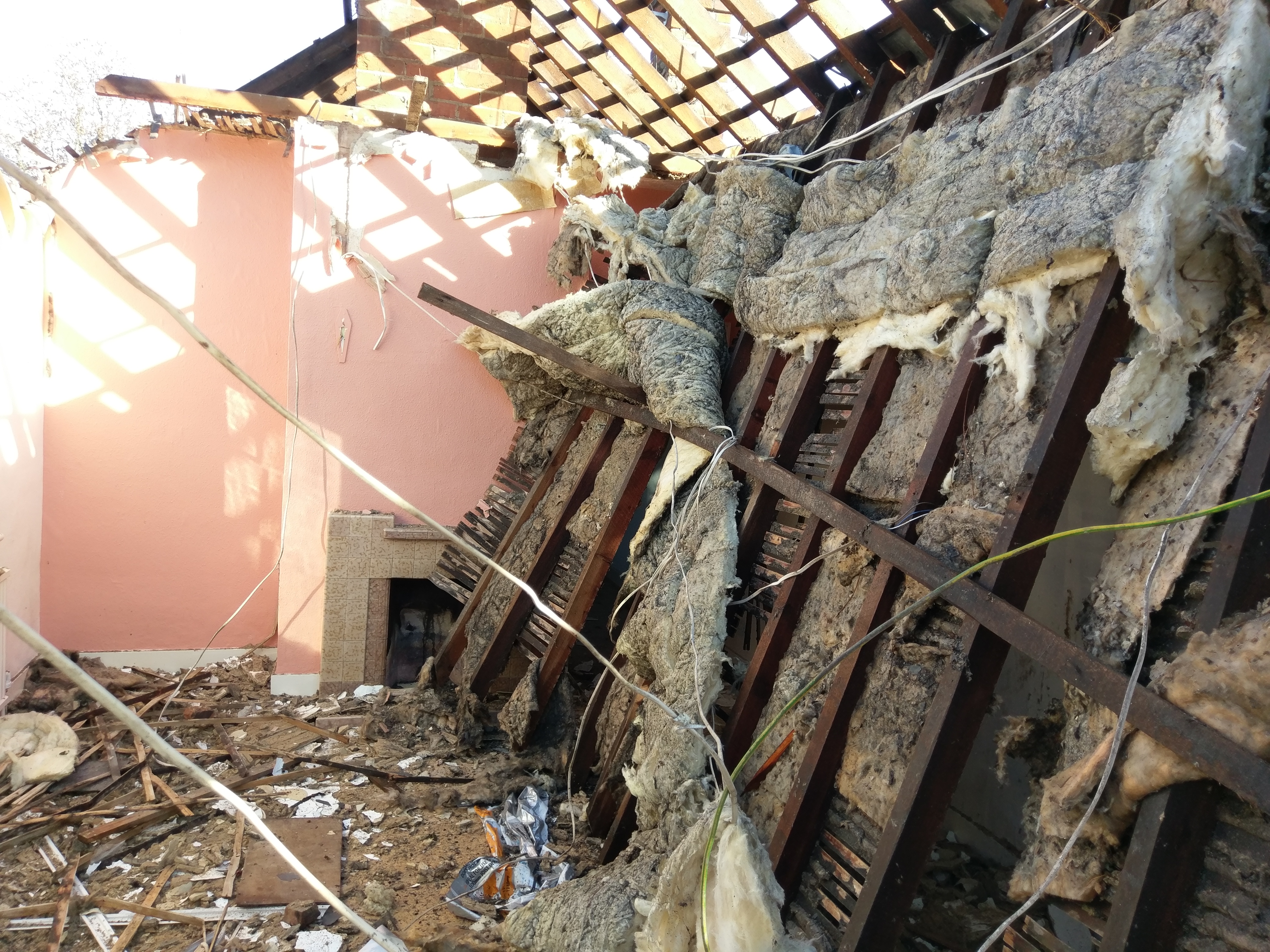

dogman Posted November 14, 2016 Author Share Posted November 14, 2016 Oops, the ceiling fell in Link to comment Share on other sites More sharing options...

dogman Posted November 14, 2016 Author Share Posted November 14, 2016 Trusty demolition saw works just as well nearly down Link to comment Share on other sites More sharing options...

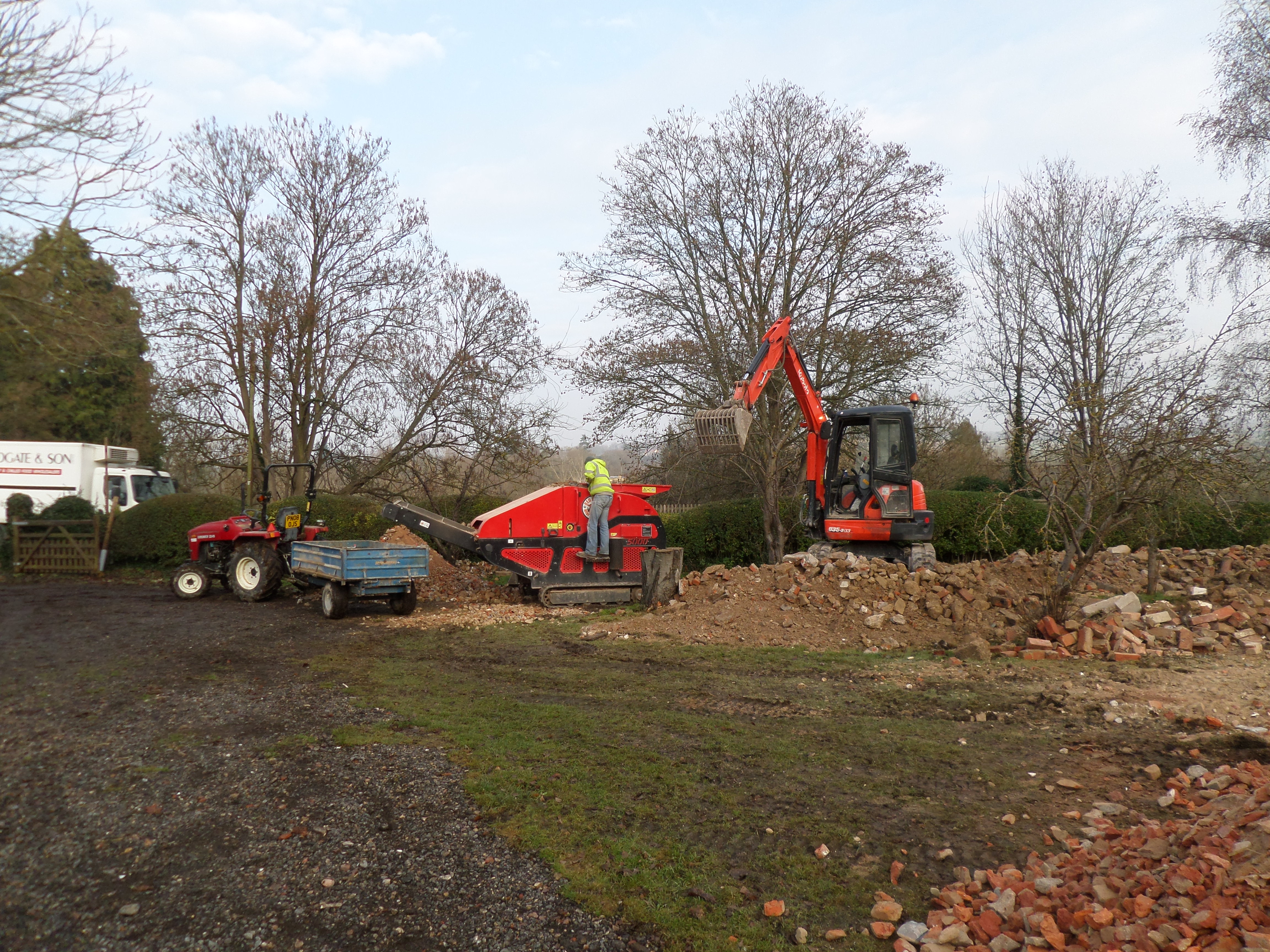

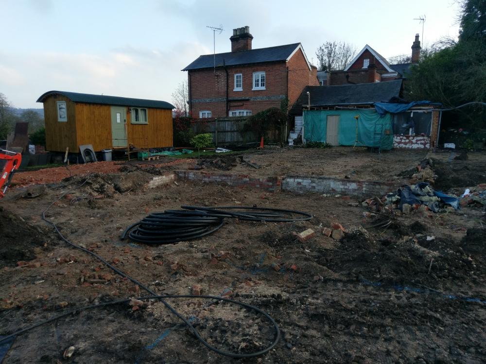

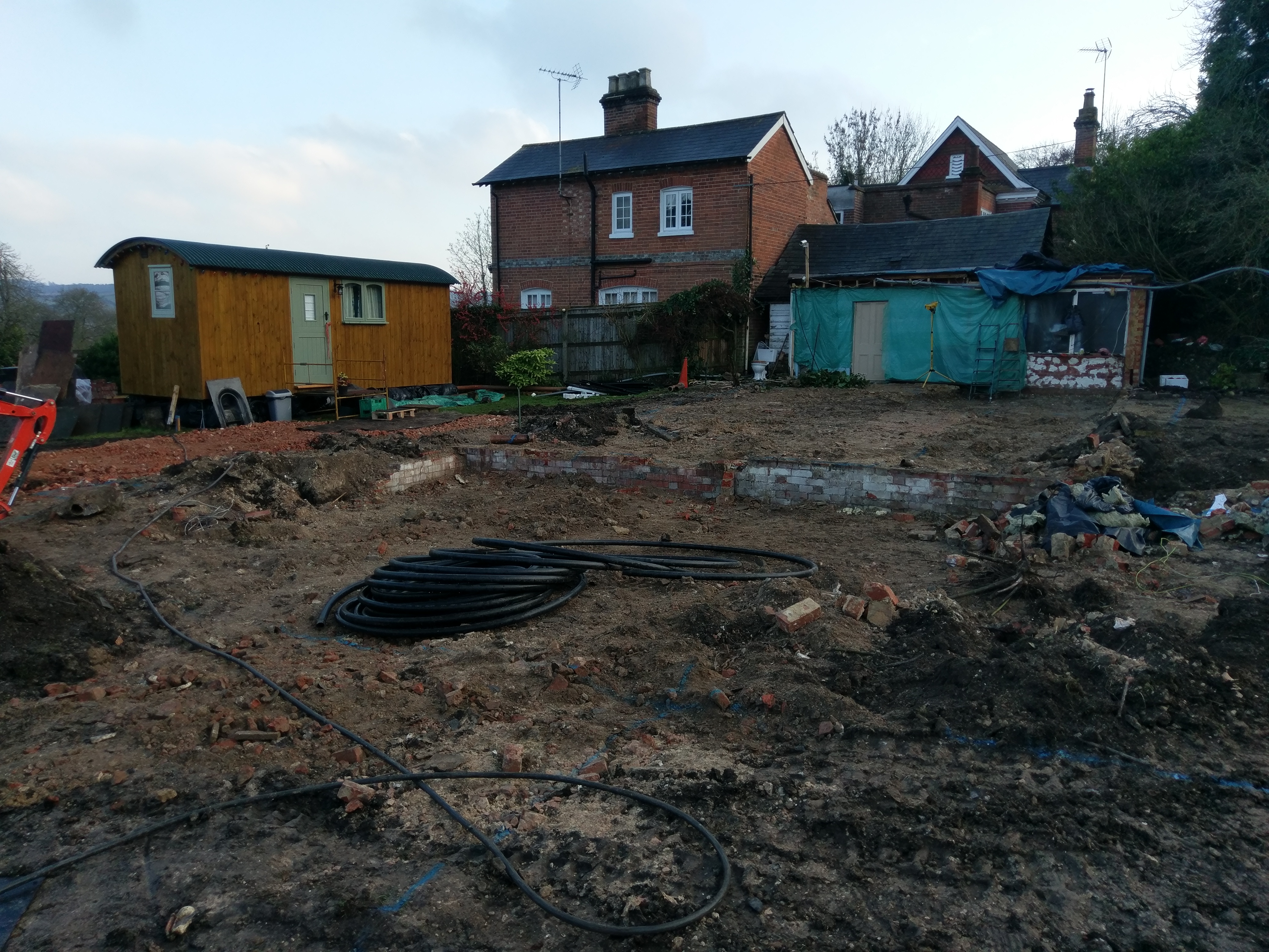

dogman Posted December 20, 2016 Author Share Posted December 20, 2016 its down, crushed and removed at long last. Link to comment Share on other sites More sharing options...
dogman Posted December 20, 2016 Author Share Posted December 20, 2016 contractor will be digging out old footings and levelling site as small digger couldn't cope Link to comment Share on other sites More sharing options...
Gone West Posted December 21, 2016 Share Posted December 21, 2016 14 hours ago, dogman said: its down, crushed and removed at long last. So did you hire and crush the bricks/blocks with a mobile concrete crusher? If so what one did you use? Link to comment Share on other sites More sharing options...
dogman Posted December 21, 2016 Author Share Posted December 21, 2016 It was the red rhino 5000. Took all day and coped with most of the materials. They do block now and again usually when a bit of wood gets in. You can specify different size output. however smaller takes twice as long. Our operator put it through twice as for the fine material as it was quicker. Link to comment Share on other sites More sharing options...
Onoff Posted December 21, 2016 Share Posted December 21, 2016 I would love a few hours playing with a crusher. Did you crush it and then remove it all off site or are the piles of crushed material left for future use? I can see if it's crushed you would have fewer removal trucks. When I did the bathroom floor I graded mixed hardcore (the old floor, old roof and bathroom tiles, clay soil pipes, bits of Celcon etc) through a 40mm mesh to make my own Type 1. It was very Labour intensive breaking the big lumps up by hand. It compacted down alright but the proper stuff is better. Link to comment Share on other sites More sharing options...
dogman Posted December 21, 2016 Author Share Posted December 21, 2016 (edited) Nothing has been removed, it reduces by about 50% volume. We have dug out top soil and replaced it with the crushed hardcore as the new drive way is quite large. Kept a large pile on site in case we need to lay around house if it becomes muddy and to back fill once completed. Based on a delivery of recycled road plannings we had about 60 t of hardcore. after crushing. it cost us about £10 a tonne to crush. As we did not need to muck it away probably saved about the same ( muck away is £220-260 a load) Edited December 21, 2016 by dogman 1 Link to comment Share on other sites More sharing options...
