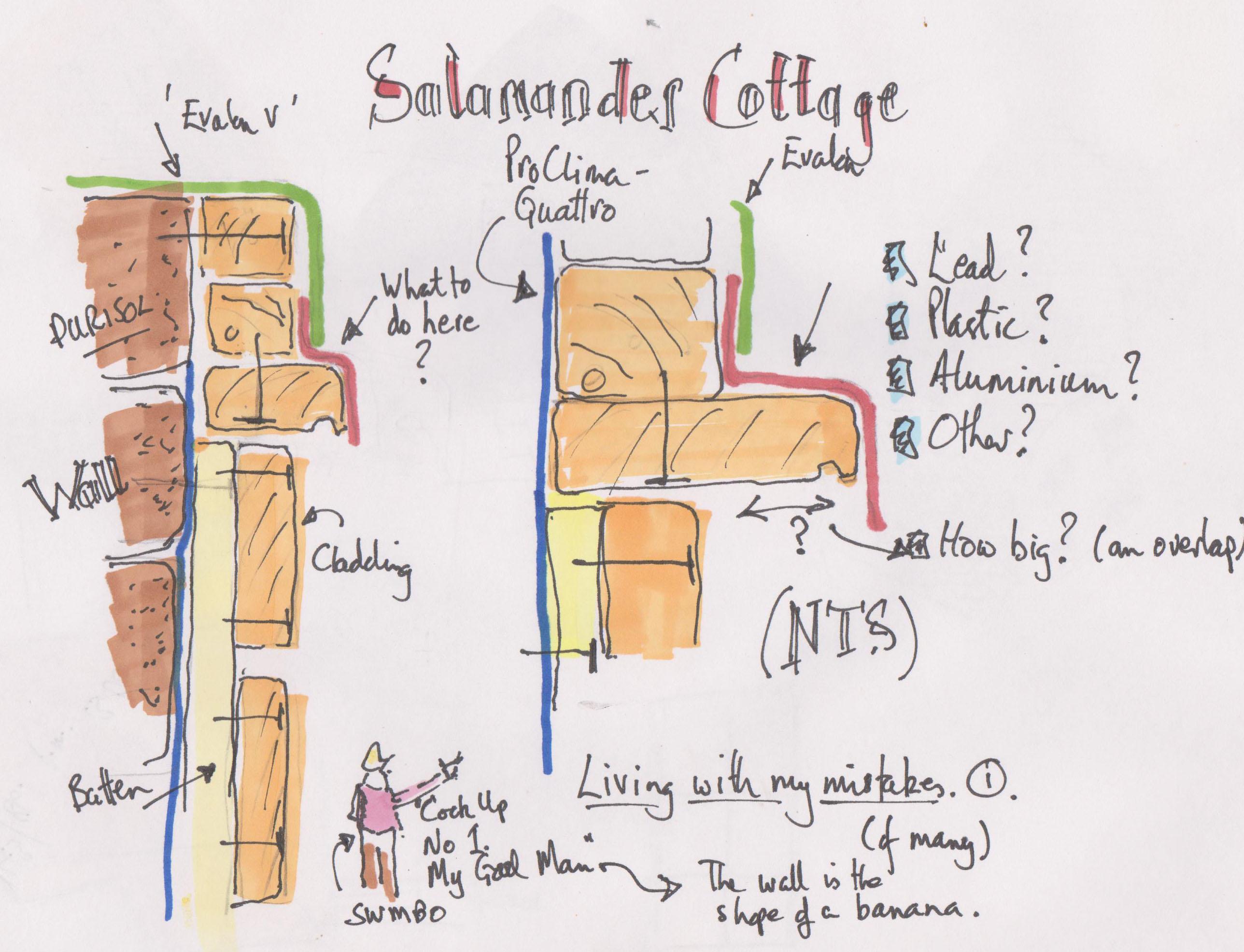

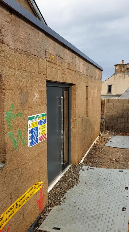

ToughButterCup Posted October 1, 2019 Posted October 1, 2019 Early in the build, before I became a nasty, snarling cynical bastard of a self-builder, I allowed the people who worked for us to get away with very unprofessional work. This episode (the first of a good few, I suspect) is about how to cope with a wall whose vertical and lateral profiles bear more than a passing resemblance to a banana. Everyone winces when I point it out. Everyone. Even that polite Mr @Stones when he dropped in (for a laugh) Can't take a joke? Shouldn'a started then should I. Here's the picture: Its our front wall; capped off with some Evalon V and a capping strip. Here's a diagram - a vertical profile. As you see from the picture, we have yet to clad our front wall. The drawing is a first stab at what to do. The problem is simple. The wall is so 'bent' that any cladding fitted closely to the wall at the bottom would end up 'overshooting' the capping strip at the top of the wall. So I propose to fit a window cill (- like) piece of wood at the top of the wall but under the bottom of the capping, and to protect that 'cill' with some form of metal or plastic profile. The end in mind is to create some wriggle room in which to compensate for the sloppy wall construction. The red line in the drawing is the intended metal or plastic profile. Is my design proposal sensible? If so, what type of profile should I use?
scottishjohn Posted October 1, 2019 Posted October 1, 2019 could you strap it out with batons to get it all back to vertical --using packers etc and only start cladding when you have a vertical and straight frame work to attach cladding to . or maybe you hard render it all instead . a good guy should be able to make it straight with cement render base then finish of your choice
ToughButterCup Posted October 1, 2019 Author Posted October 1, 2019 35 minutes ago, scottishjohn said: could you strap it out with batons to get it all back to vertical --using packers etc and only start cladding when you have a vertical and straight frame work to attach cladding to . [...] Yes. The intention is to create about some 'reference' batons (4): perfectly vertical and level across the front of the wall (over about 10 m) The questions are What should the 'profile' (that protects the top of the cladding) be made of? (plastic / metal / lead?) and how far in front of the cladding should the cill / profile project? (10mm / 20mm / doesn't matter ?) Ian

jamieled Posted October 1, 2019 Posted October 1, 2019 I am in the process of sorting something similar for our cladding, albeit for slightly different reason. As we have 1.5 storeys, we need a firestop at half height, and I have selected to insert a profiled cill/flashing on top of the firestop, to drain anything behind the 1st floor cladding. I'm getting some manufactured by planwell. They will stick out in front of the cladding by about 35mm. This is sort of arbitrary, because the cills/flashings are manufactured in fixed dimensions but I figured it should be enough. 1
Declan52 Posted October 1, 2019 Posted October 1, 2019 What about something as simple as a length of guttering. You can attach the gutter to a batten at whatever thickness suits so the gutter sits under the lip of your roof material. Then batten out to near enough plumb and put your cladding on as normal. You could chamfer the top length of cladding so it appears to slide behind the gutter to still look nice. Would be a simple relatively cheap solution and it doesn't really matter if it collects any water or not. 1
joe90 Posted October 1, 2019 Posted October 1, 2019 @AnonymousBosch what version of CAD is that your using?, I really like it. ?. How far out is your wall vertically?, would you notice 10mm out of vertical? I like the idea of packing battens out to be “level”. How long is the green stuff on your roof overhanging the wall? If it’s long enough just run cladding up under it (we need more accurate measurements).

ToughButterCup Posted October 1, 2019 Author Posted October 1, 2019 11 minutes ago, jamieled said: [...] I'm getting some manufactured by planwell. [...] Thanks for the link (here). Exactly what I was looking for. 4 minutes ago, joe90 said: @AnonymousBosch what version of CAD is that your using?, I really like it. ?. How far out is your wall vertically?, would you notice 10mm out of vertical? I like the idea of packing battens out to be “level”. How long is the green stuff on your roof overhanging the wall? If it’s long enough just run cladding up under it (we need more accurate measurements). CAD package: Mark 1 eyeball and remaining fingers. Vertical cockup : 35mm (at least) - an error of merely 10mm would be wonderful - we could manage that. The green stuff - (Evalon V) rests on an overhang of about 47mm or so. Since the battens are 25mm, and the cladding is 18mm (43mm) and the error is 35mm we are looking at a 75mm difference at the top. Oh dear, never mind what a shame. Know what? I'm learning reeeeally fast, like reallly reeeaaallyy fast.

ToughButterCup Posted October 1, 2019 Author Posted October 1, 2019 Do you mean block out the battens to (say) 50mm anyway? So, with an 18mm cladding board, that would mean 68mm from the front of (some of) the wall.....

Sue B Posted October 1, 2019 Posted October 1, 2019 (edited) Can you not extend the roofie bit out to cope with the additional width of the battening / cladding? Edited to say - is that what the second picture is suggesting? Edited October 1, 2019 by Sue B
scottishjohn Posted October 1, 2019 Posted October 1, 2019 1 hour ago, AnonymousBosch said: Do you mean block out the battens to (say) 50mm anyway? So, with an 18mm cladding board, that would mean 68mm from the front of (some of) the wall..... I was presuming you were using that thickness -- 35mm ones then -but wouldn,t want to go too thin
ToughButterCup Posted October 1, 2019 Author Posted October 1, 2019 1 hour ago, Sue B said: Can you not extend the roofie bit out to cope with the additional width of the battening / cladding? [...] If only, @Sue B. That would be have been so much easier.
Construction Channel Posted October 1, 2019 Posted October 1, 2019 4 hours ago, AnonymousBosch said: Yes. The intention is to create about some 'reference' batons (4): perfectly vertical and level across the front of the wall (over about 10 m) The questions are What should the 'profile' (that protects the top of the cladding) be made of? (plastic / metal / lead?) and how far in front of the cladding should the cill / profile project? (10mm / 20mm / doesn't matter ?) Ian - lead - 20mm
nod Posted October 1, 2019 Posted October 1, 2019 2 hours ago, Oz07 said: This must happen all the time on commercial sites. I bet theres a metal system like then use internal for dry lining? @nod? That jumbo stud they run up the walls can get over any problems You could use Gypliner System It won’t rust or rot Set out Vertically at 300 centres It would save a lot of time and effort packing timber batons out

joe90 Posted October 1, 2019 Posted October 1, 2019 (edited) 12 minutes ago, Stones said: The downside is that any packing is going to show itself at the door reveal and perhaps the window reveals as well. I don’t think so, you can see the taper of the door reveal in the photo, so the door looks vertical and the wall NOT. @AnonymousBosch You mention Evalon V and a capping strip, can you not get another capping strip, same colour, to come out over your timber cladding. You don’t want too many different materials as it will make it scrappy. Your diagram does not show membrane and capping strip (just being picky?). Edited October 1, 2019 by joe90
Stones Posted October 1, 2019 Posted October 1, 2019 2 minutes ago, joe90 said: I don’t think so, you can see the taper of the door reveal in the photo, so the door looks vertical and the wall NOT. @AnonymousBosch You mention Evalon V and a capping strip, can you not get another capping strip, same colour, to come out over your timber cladding. You don’t want too many different materials as it will make it scrappy. Should have been clearer, apologies, I meant in terms of deeper reveals. 1
ToughButterCup Posted October 2, 2019 Author Posted October 2, 2019 8 hours ago, Stones said: Only laughed after I'd left! Youngest still talks about his digger driving experience though, so if nothing else your build has inspired the next generation! In answer to the question, battening out using packers to get it plumb before cladding sounds like the best option assuming you don't want to explore the option of a render finish. You should be able to take string lines at intervals from one end to the other to assess how far out of true it is and therefore if packing out is viable. The downside is that any packing is going to show itself at the door reveal and perhaps the window reveals as well. I can't remember what other external finishes you have planned. If packing out for a continuous run of cladding isn't going to work, and it has to be timber, is there scope to vary the style - switch from vertical to horizontal half way down the wall, using the break to step out the lower half slightly? If you were prepared to accept that kind of visual break, how about stone cladding , dry stone walling up to halfway, timber above? Yes you would need another rain cap but might work and allow you to disguise things more easily. I had aluminium cills folded and painted by https://www.mspcladding.co.uk/ and had them quote for a complete bespoke rainwater system which was half the price I could get anywhere else. I'm sure they could fold something and paint to whatever your specifications are for the rain cap. I found them very helpful and more than willing to cater for small orders. Thanks for your post .Extremely helpful, lots to think about.
