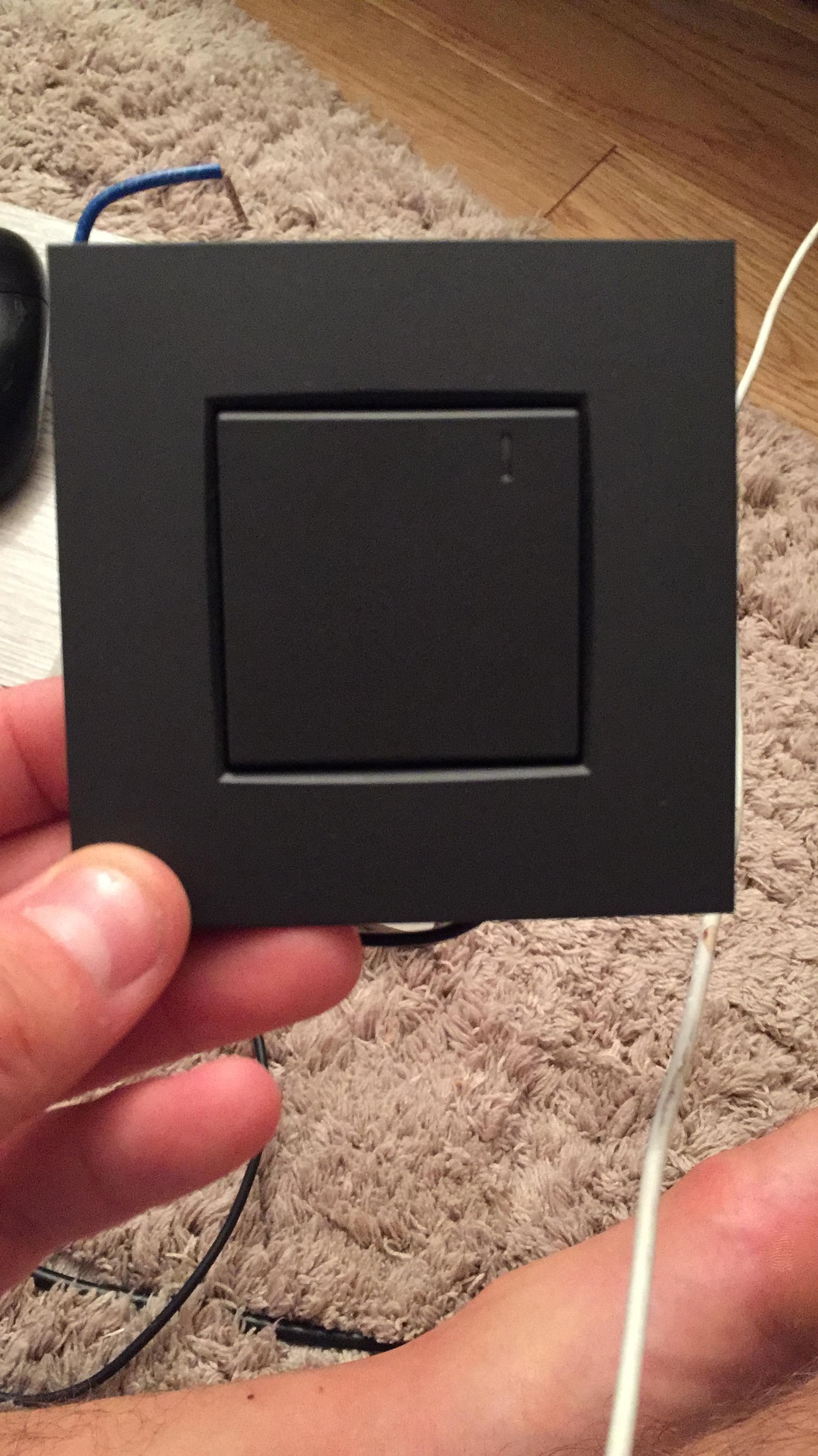

The question arose because I will be putting six double sockets at high level in a colured glass spashback above a kitchen worktop, to which the eye will naturally be drawn ... and I really dont want the eye to focus on white plastic switched sockets when we will be spending thousands on splashbacks, worktops and kitchen units!
So it seems from the above I can lose the switches. Next is colour and style. Suppliers mentioned above do a wide range of styles (brass, gold, wood effect, stainless steel etc etc.). But I want to go for minimalist, so plan to use an anthracite colour (Gira make a very expensive one which looks like this). Everywhere else in the house I will use bog standard white ones (for example these Hager which are one sixth the price of the anthracite ones!)
Niko also do an anthracite which is what I am using as I wanted switches and sockets to match..
