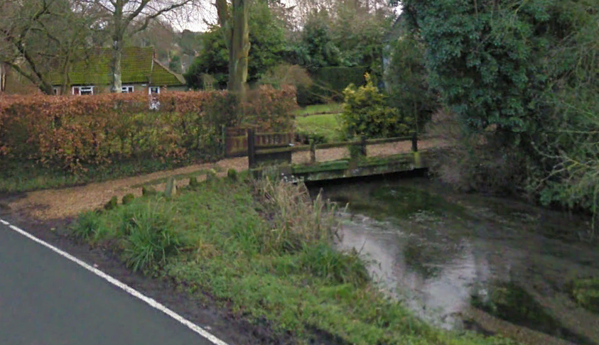

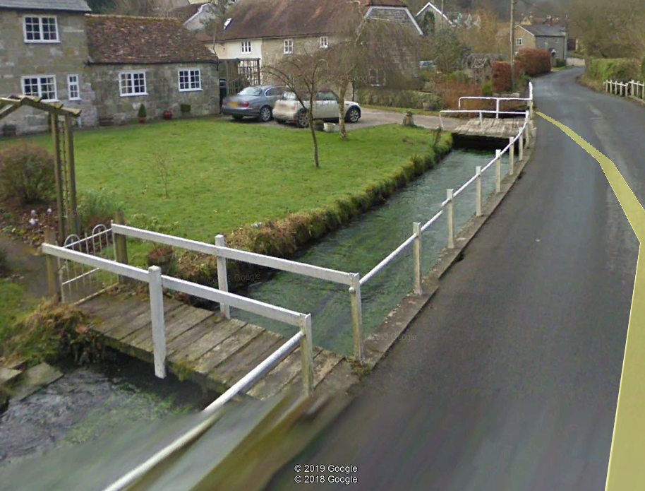

Jeremy Harris Posted August 20, 2019 Share Posted August 20, 2019 We have lots of drive bridges over the village stream here. All are built the same way, a couple of steel UBs covered over with railway sleepers. I'll try and wander around and take some photos of them later. None are more than about a foot above the stream normal water level at their lowest point. At a guess I'd say the UBs might be around 8 inches deep, then there's the thickness of the sleepers on top. I'll try and get some measurements when I'm out taking photos later. Several of these bridges look as if they've been there a few decades, so they seem to last OK. These bridges are also pretty strong. My neighbour over the road has had a few dozen 18 wheel tipper trucks in and out over the last month or two, and his bridge doesn't seem to be any the worse for it. Link to comment Share on other sites More sharing options...

Ferdinand Posted August 20, 2019 Share Posted August 20, 2019 (edited) 1 hour ago, JSHarris said: We have lots of drive bridges over the village stream here. All are built the same way, a couple of steel UBs covered over with railway sleepers. I'll try and wander around and take some photos of them later. None are more than about a foot above the stream normal water level at their lowest point. At a guess I'd say the UBs might be around 8 inches deep, then there's the thickness of the sleepers on top. I'll try and get some measurements when I'm out taking photos later. Several of these bridges look as if they've been there a few decades, so they seem to last OK. These bridges are also pretty strong. My neighbour over the road has had a few dozen 18 wheel tipper trucks in and out over the last month or two, and his bridge doesn't seem to be any the worse for it. Google street view should do that well enough. Also look at the A6011 in Linby, Notts. The river Lean goes under a number of drives over a Good distance. Edited August 20, 2019 by Ferdinand Link to comment Share on other sites More sharing options...

Jeremy Harris Posted August 20, 2019 Share Posted August 20, 2019 24 minutes ago, Ferdinand said: Google street view should do that well enough. Good idea! Here goes: 1 Link to comment Share on other sites More sharing options...

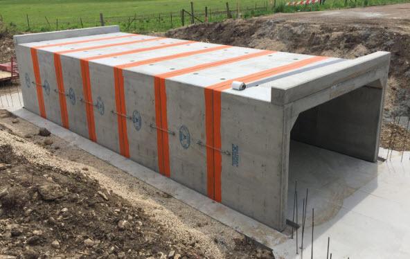

PeterW Posted August 20, 2019 Share Posted August 20, 2019 I’d build a diversion channel for the leat and then build a proper concrete culvert with a decent base and sides (and front apron) and then close your diversion channel when it’s set. You can do this in as little as 72 hours, and also allows you to then cap it with concrete using shuttering and rebar. At 1200mm wide, it will only need to be 180mm thick with rebar to hold a car. Link to comment Share on other sites More sharing options...

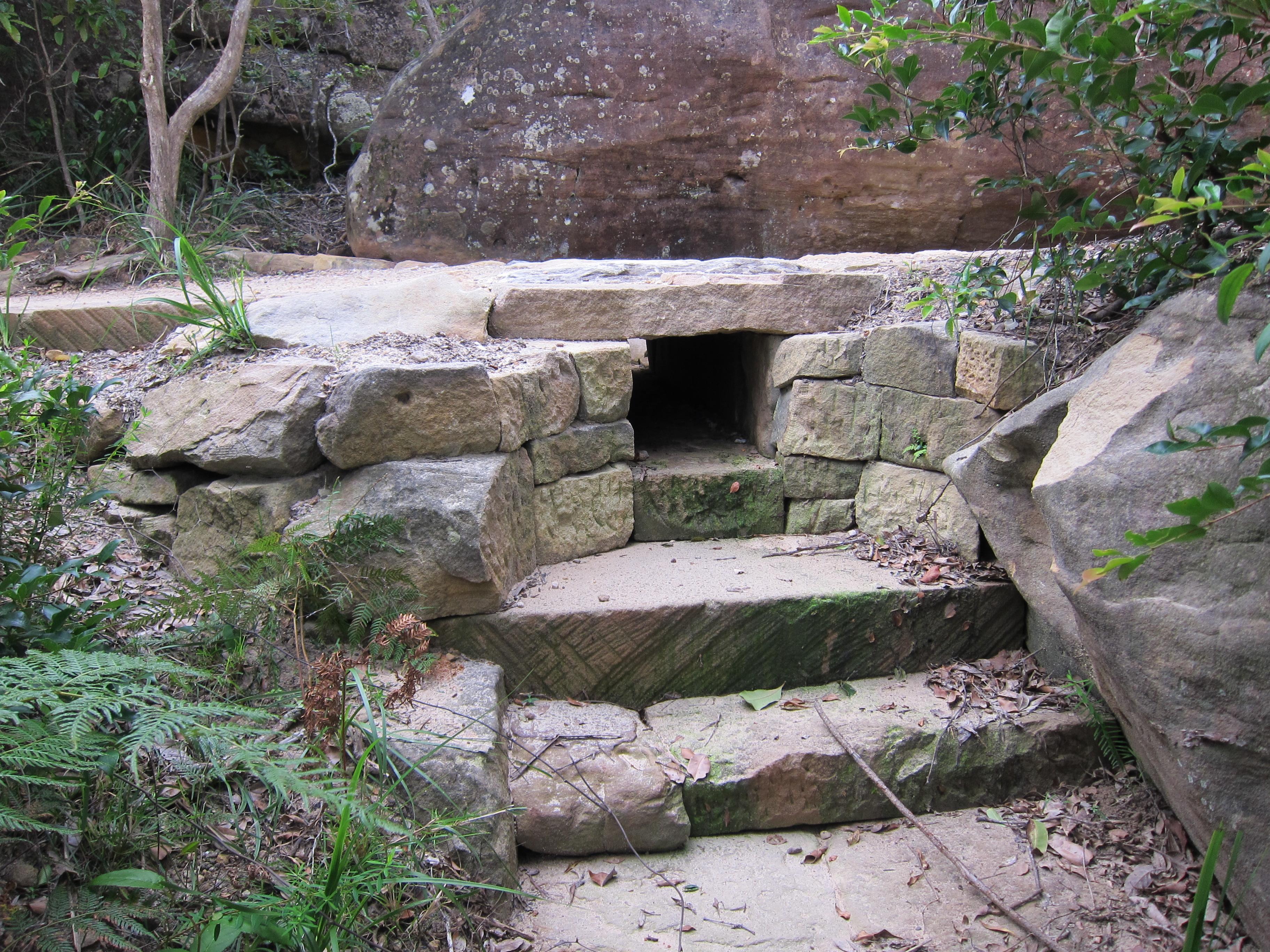

Cpd Posted August 20, 2019 Share Posted August 20, 2019 Have you got loads of stone, time to waste and want it to look great ! Here’s one I built in Australia, must have put about 10 of these in this road each one custom built to fit into its surroundings, if the ground slopes away at the end then consider some sort of retailer / spillway to prevent erosion. 2 Link to comment Share on other sites More sharing options...

Jeremy Harris Posted August 20, 2019 Share Posted August 20, 2019 1 hour ago, mafaldina said: Jeremy, I'm trying to remember where that is, I 'm sure it's somewhere around Ebbersbourne Wake/Alverdiston. Remember it from when I used to live at Donhead. Fovant, about 3 miles North of Ebbesbourne Wake, maybe 6 miles North East of Donhead. Our place is a couple of hundred metres downstream from those bridges (the brook runs along the front of our place, on the opposite side of the lane). Link to comment Share on other sites More sharing options...

Barney12 Posted August 20, 2019 Author Share Posted August 20, 2019 3 hours ago, Cpd said: Have you got loads of stone, time to waste and want it to look great ! Here’s one I built in Australia, must have put about 10 of these in this road each one custom built to fit into its surroundings, if the ground slopes away at the end then consider some sort of retailer / spillway to prevent erosion. Crikey that looks lovely! Link to comment Share on other sites More sharing options...

Barney12 Posted August 20, 2019 Author Share Posted August 20, 2019 5 hours ago, PeterW said: I’d build a diversion channel for the leat and then build a proper concrete culvert with a decent base and sides (and front apron) and then close your diversion channel when it’s set. You can do this in as little as 72 hours, and also allows you to then cap it with concrete using shuttering and rebar. At 1200mm wide, it will only need to be 180mm thick with rebar to hold a car. Chatting to my stone mason on site today this was his advice. Link to comment Share on other sites More sharing options...
