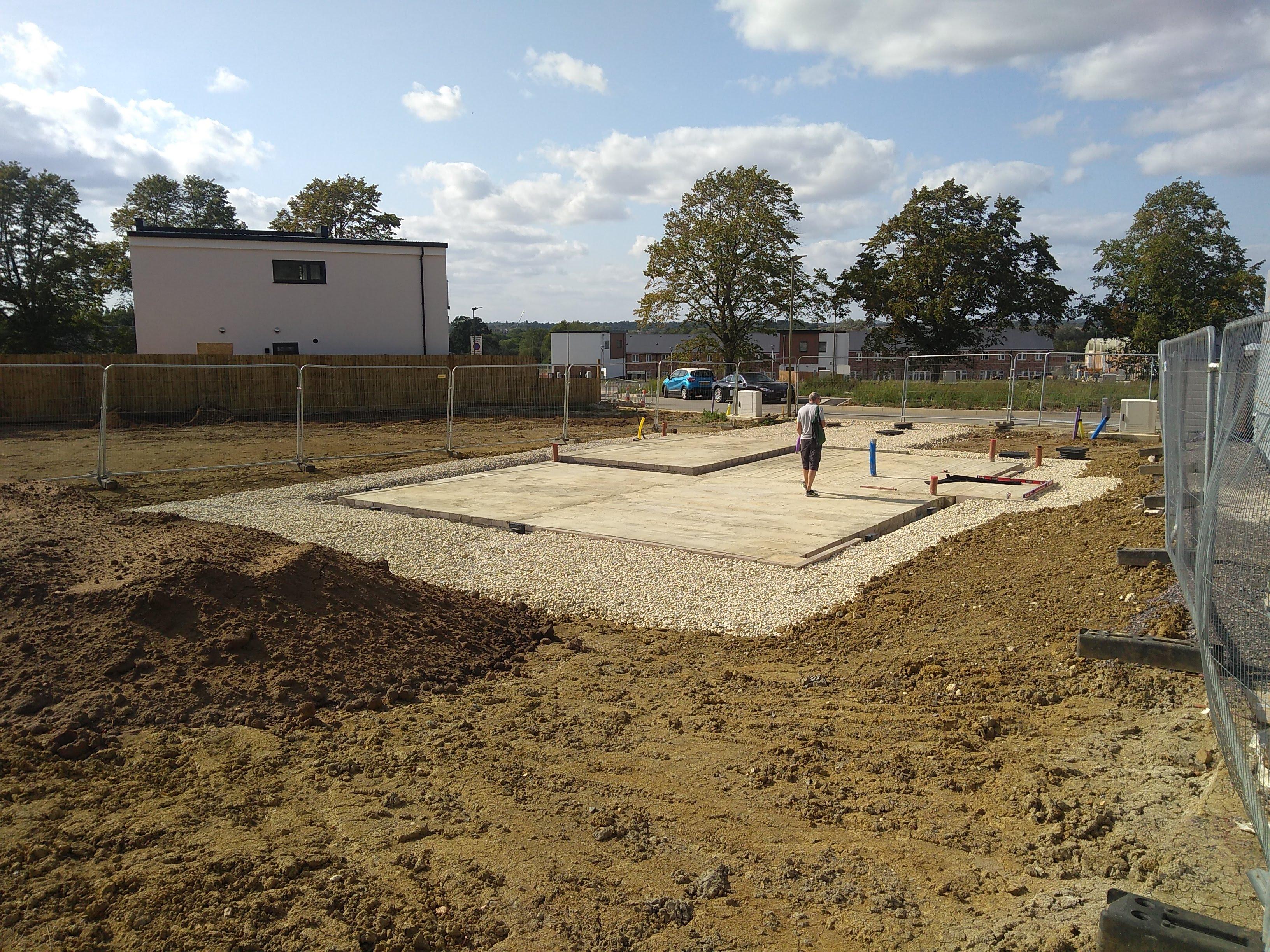

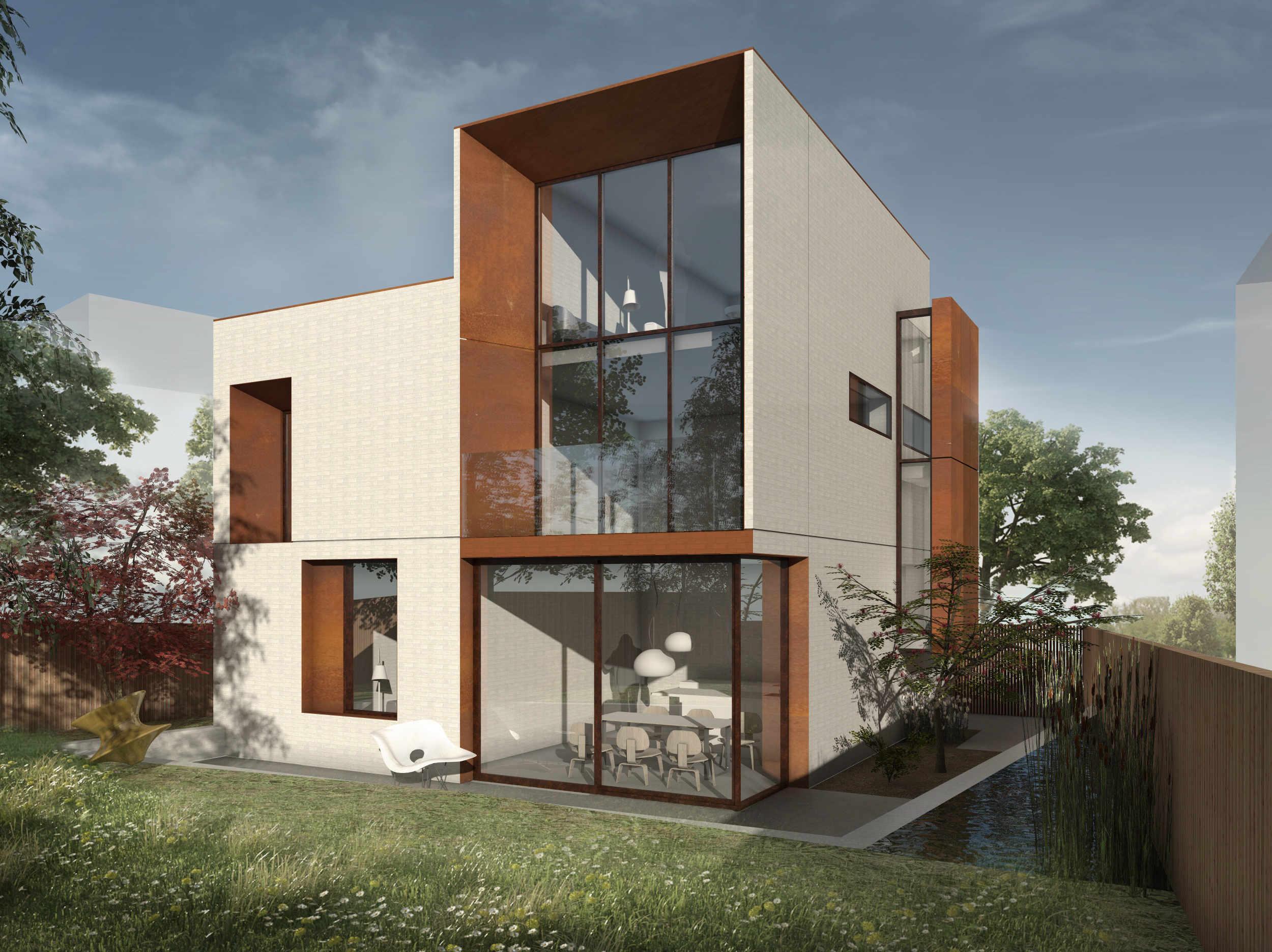

DarrenA Posted August 20, 2019 Share Posted August 20, 2019 I joined the forum a while ago and had a general look around. But today we completed on our plot at Graven Hill so would like to do the introductions ? We're Darren and Christine and in our 50s. We've moved house over 20 times (we don't have kids), renovating each time so are reasonably experienced with interior projects but this is our first self build. We live in Nottingham but are moving to Bicester because we liked the look of the Graven Hill project (a new build site with roughly 700 self builders working on individual plots over 10 years if you didn't see it on Grand Designs.) We're building a 4 bedroom, partly 3 storey, detached, flat roofed modern white box out of brick and block with a 200mm cavity (that's causing lots of issues already - who'd have thought wall ties could be so expensive!). We aren't allowed to live in a caravan on site sadly, although the plot is so tiny there wouldn't be space anyway. So we are staying with friends who have already completed their Graven Hill build initially while we find somewhere cheap to rent for the next year or so. I'm very happy to answer any questions about the Graven Hill process and costs or anything else about the build. And I'm very likely to be back with very many questions over the next few months... Here's the architects rendering of the house although it is slightly inaccurate as parts of the design are too complicated or expensive to build (we're hoping to build 185m2 for £200k so on the tight side of things). And the floor plans. Darren 3534 WD03D GA Proposed Plans.pdf Link to comment Share on other sites More sharing options...

Ferdinand Posted August 20, 2019 Share Posted August 20, 2019 (edited) I am not sure if you want feedback, and what type, but the architect seems to have done a generally well-rounded job on room sizes etc. It is interesting that the plan is relatively conventional within a modern-style shell. I am interested in the office at the top. Lots of visitors will keep you very fit going up and down ! Dad had that - used to drop the keys out of the window for them. Are there solar panels on top of the office ? if I have it right a ta glance the others will be shaded until lunchtime. F Edited August 21, 2019 by Ferdinand Link to comment Share on other sites More sharing options...

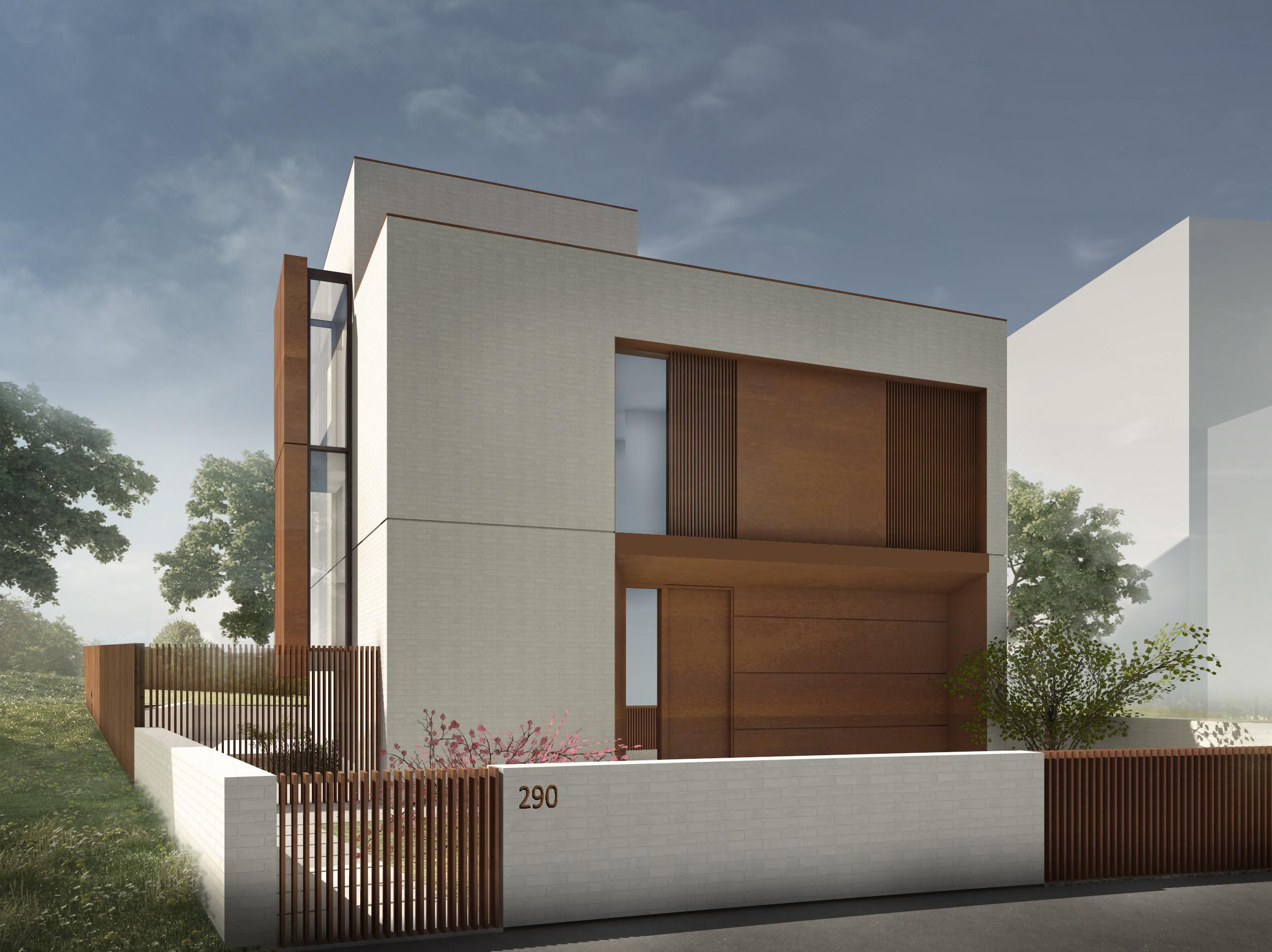

PeterW Posted August 20, 2019 Share Posted August 20, 2019 So... welcome ..! I know your architect, and I know why you’re going to be challenged to build that for the budget ..!! I would have a serious look at those wall specs as some are wrong (Party wall and internal stud wall) and some are just overkill. Why use sound block plasterboard on blockwork walls for example ..?? Firstly, seriously consider a straight render on block scheme, and lose some of the CaSil board on render detail as you don’t need it. There is a lot of cost for no benefit. Next, you do not need a party wall build up into a garage - it’s just classed as an external wall with insulation Thirdly, the differing insulation types and detail will give you a headache - switching from cavity fibre to external PIR on batten is pretty pointless and will just create cold bridges on transitions. You could do some serious value engineering on that and save a lot of money and make it much easier to build and still get the same effect. Out of interest, what are the sections through the floors and roof, and what’s the roof finish ..?? 2 Link to comment Share on other sites More sharing options...

Mr Punter Posted August 20, 2019 Share Posted August 20, 2019 Greetings @DarrenA. @Visti is our man in Gravenhill. He was last spotted looking for a temporary staircase so I guess he has the structure up and roof on. Is that white brickwork with white mortar? I like the look. The design has some very expensive elements, but it does show. Can you go with a 150mm cavity? If so, you could use a full fill product like CavityTherm, with much cheaper wall ties. Using separate lintels for each leaf will cut down bridging and make the insulation boards fit more easily. I would need over double your budget to produce your house. 1 Link to comment Share on other sites More sharing options...
DarrenA Posted August 20, 2019 Author Share Posted August 20, 2019 Thank you all for the welcome. I'm very happy to hear feedback and ideas, however our foundations are finished so we are committed to a lot of the details so please go easy on us! I think a bit more information might be useful. We paid £230k for our 400m2 plot (expensive, I know). Part of the Graven Hill experience is that they build your foundations as part of the purchase. These cost an extra £45k. I realise this is outrageous and won't be surprised if Graven Hill change the process for the Phase 2 plots that haven't been released yet. However, we went into this with our eyes open and the architect made an effort to keep the build simple and minimise foundation details to get these "Golden Brick" costs as low as possible. We have £200k left over to build the house but we are already out of the ground and have all services. Also the professional fees come from a different pot. We are self project managing and intend to do a lot of work ourselves (including roofs and floors, carpentry, kitchens, bathrooms, tiling and decorating). So although the budget is tight, it isn't as bad as it might be. I'm very interested in the comments about simplifying and cutting costs. I'll reply to them another time though as its late and been a long day ? Here is a picture of the plot from today with the finished foundations. I've also attached the sections and rest of the plans as the feedback is very interesting and useful. Darren PS. We are living in Sherwood in Nottingham but have lived all over during the years. 3534 WD07F External Services and internal Penetrations, Roof Plan.pdf 3534 WD06F Proposed SEction BB.pdf 3534 WD04G Proposed Site Plan and Elevations.pdf 3534 WD05E Proposed SEction AA.pdf Link to comment Share on other sites More sharing options...

DarrenA Posted August 21, 2019 Author Share Posted August 21, 2019 On 20/08/2019 at 08:49, Ferdinand said: Are there solar panels on top of the office ? if I have it right a ta glance the others will be shaded until lunchtime. The solar panels are pencilled in on the second floor terrace. Hadn't thought about shadows but I think moving them up to the very top of the house would solve this and free up more roof terrace. But to be honest, I can't see the solar panels making the cut financially so these will probably be left for another time. Link to comment Share on other sites More sharing options...
DarrenA Posted August 21, 2019 Author Share Posted August 21, 2019 On 20/08/2019 at 09:00, PeterW said: So... welcome ..! I know your architect, and I know why you’re going to be challenged to build that for the budget ..!! I would have a serious look at those wall specs as some are wrong (Party wall and internal stud wall) and some are just overkill. Why use sound block plasterboard on blockwork walls for example ..?? Firstly, seriously consider a straight render on block scheme, and lose some of the CaSil board on render detail as you don’t need it. There is a lot of cost for no benefit. Next, you do not need a party wall build up into a garage - it’s just classed as an external wall with insulation Thirdly, the differing insulation types and detail will give you a headache - switching from cavity fibre to external PIR on batten is pretty pointless and will just create cold bridges on transitions. You could do some serious value engineering on that and save a lot of money and make it much easier to build and still get the same effect. Out of interest, what are the sections through the floors and roof, and what’s the roof finish ..?? Thank you, loads of useful tips here. Could you please explain the party wall comment about the garage, not sure what you mean. Link to comment Share on other sites More sharing options...
DarrenA Posted August 21, 2019 Author Share Posted August 21, 2019 On 20/08/2019 at 16:34, Mr Punter said: Greetings @DarrenA. @Visti is our man in Gravenhill. He was last spotted looking for a temporary staircase so I guess he has the structure up and roof on. Is that white brickwork with white mortar? I like the look. The design has some very expensive elements, but it does show. Can you go with a 150mm cavity? If so, you could use a full fill product like CavityTherm, with much cheaper wall ties. Using separate lintels for each leaf will cut down bridging and make the insulation boards fit more easily. I would need over double your budget to produce your house. Yes, it is white bricks and mortar. We have samples and the bricks are very bright. Have 13000 arriving soon so I hope we like them! The white mortar is proving a headache to source and store. So we are thinking about using very light building sand instead and accepting a light grey mortar instead. This will also save a few thousand pounds. Unfortunately it is too late to change the cavity size but I did cost PIR insulation against Drytherm slabs and we shouldn't be out of pocket our way. We are going with separate lintels per leaf though and using cavity closers to help with bridging and airtightness. Link to comment Share on other sites More sharing options...
PeterW Posted August 21, 2019 Share Posted August 21, 2019 If you look at his plans, there is a letter in a circle next to each wall, which refers to the wall construction in the notes below. For some reason he has used a party wall build up for the garage ...?? That should just be a straight external wall build up. Those cladding details seem well over the top - you could build the whole thing in double skin block with a 175mm cavity and use blown beads and get a really good uValue on the walls. A bit of clever detailing and you will have a simple structure that can either be rendered or clad accordingly - @the_r_sole may have better numbers but from the last time I checked, 4mm CorTen steel would be about half the price of the aluminum “fake” CorTen panels he has specified. If you use it where there is no run off below, you won’t get staining. What was the architects estimated budget out of interest for the build ..?? Link to comment Share on other sites More sharing options...

Mr Punter Posted August 21, 2019 Share Posted August 21, 2019 48 minutes ago, DarrenA said: The white mortar is proving a headache to source and store. So we are thinking about using very light building sand instead and accepting a light grey mortar instead. If you buy white sand, white cement and lime and mix the mortar on site so no storage issues. I think you should be able to produce an acceptable colour without any grey and if you shop around the cost should not kill you. I think it is important as it is so focal. Beware idiot labourer using it for blockwork! Are you doing anything fancy with the brickwork - like stack bond or flush or raked horizontal joints? Spend a bit of time and make up a panel or two. What bricks have you gone for? 1 Link to comment Share on other sites More sharing options...
