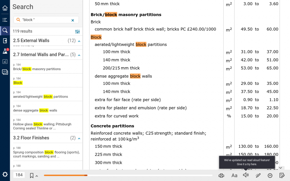

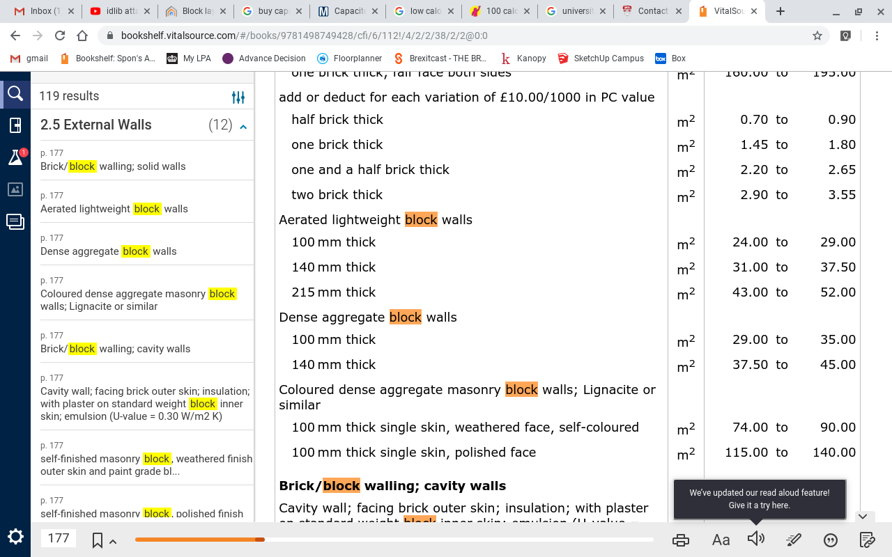

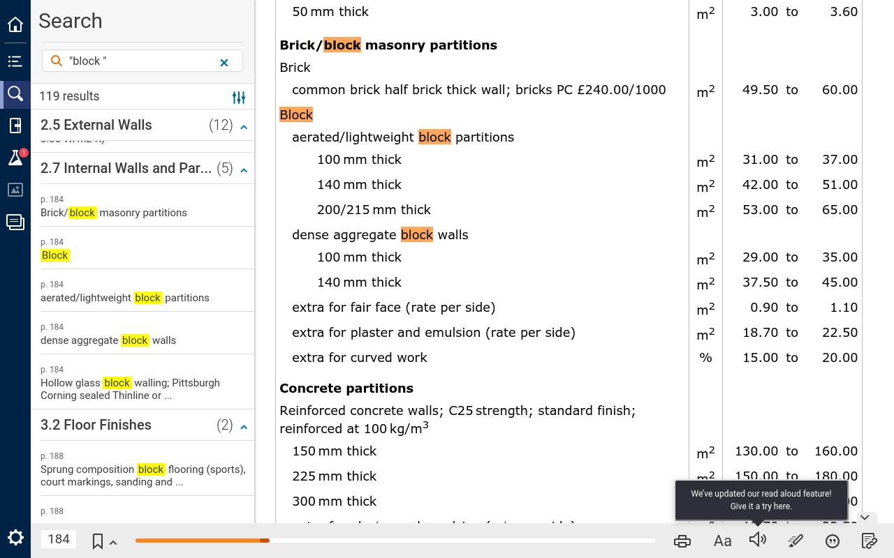

ToughButterCup Posted August 20, 2019 Share Posted August 20, 2019 Morning @K78 Here you are .... this is based on SPONS 2016 prices - I'm not sure how to convert 100mm blocks to square meters - guess 10(?) If I'm right, that would be (24*0.96) / sq meter - say £23 per sq meter / by 10 = £2.30 per block. This screenshot is for EXTERNAL walls - Just in case you meant INTERNAL walls .... The numbers above are for Outer London, so multiply by 0.96 for Lancashire. (SPONS 2016, online downloaded 2019 ) Ian 1 Link to comment Share on other sites More sharing options...
bassanclan Posted August 20, 2019 Share Posted August 20, 2019 £2.30 per block from Spons is surely the price of the wall as built i.e. including cost of the block, mortar, ties etc? 2 Link to comment Share on other sites More sharing options...

K78 Posted August 20, 2019 Author Share Posted August 20, 2019 4 hours ago, bassanclan said: £2.30 per block from Spons is surely the price of the wall as built i.e. including cost of the block, mortar, ties etc? Probably not being London prices. Blocks are over £1 each. Link to comment Share on other sites More sharing options...
ToughButterCup Posted August 20, 2019 Share Posted August 20, 2019 5 hours ago, bassanclan said: £2.30 per block from Spons is surely the price of the wall as built i.e. including cost of the block, mortar, ties etc? I dont care what anyone says, buying my own copy of SPONS together with the online access repaid the cost of the book many times over. Link to comment Share on other sites More sharing options...
