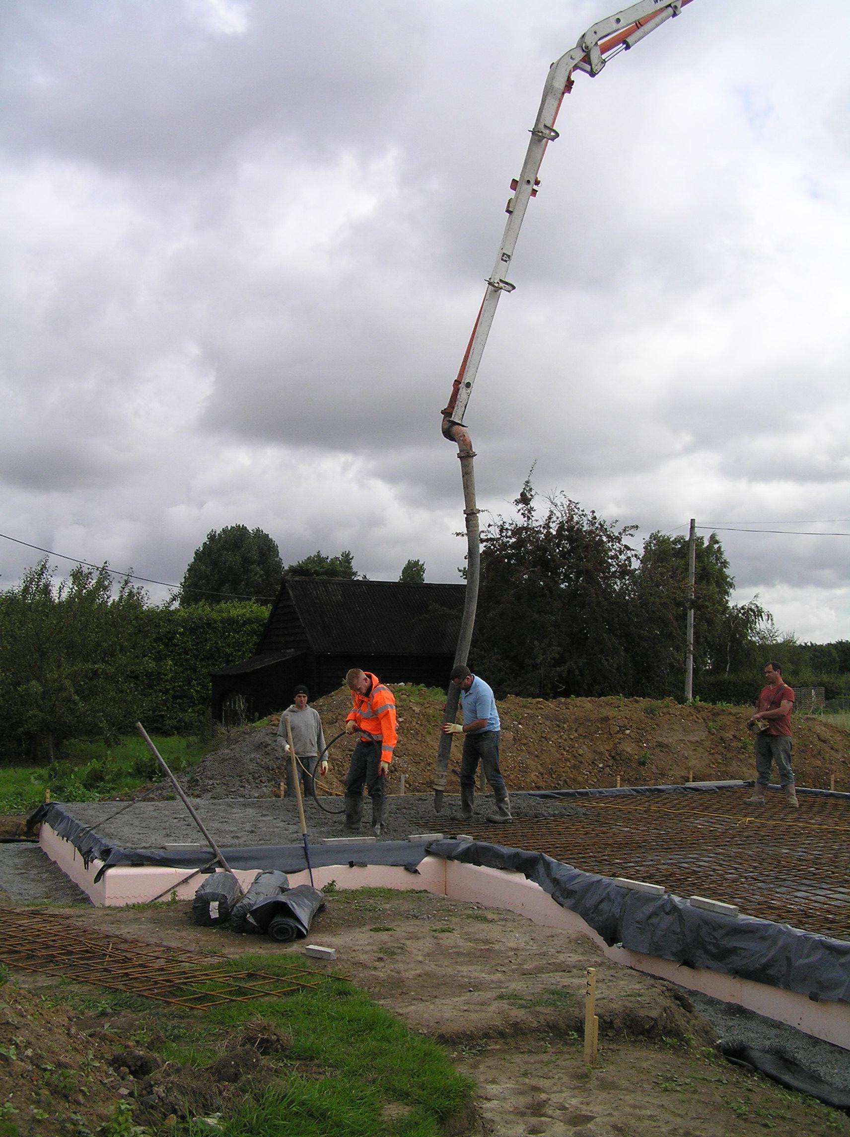

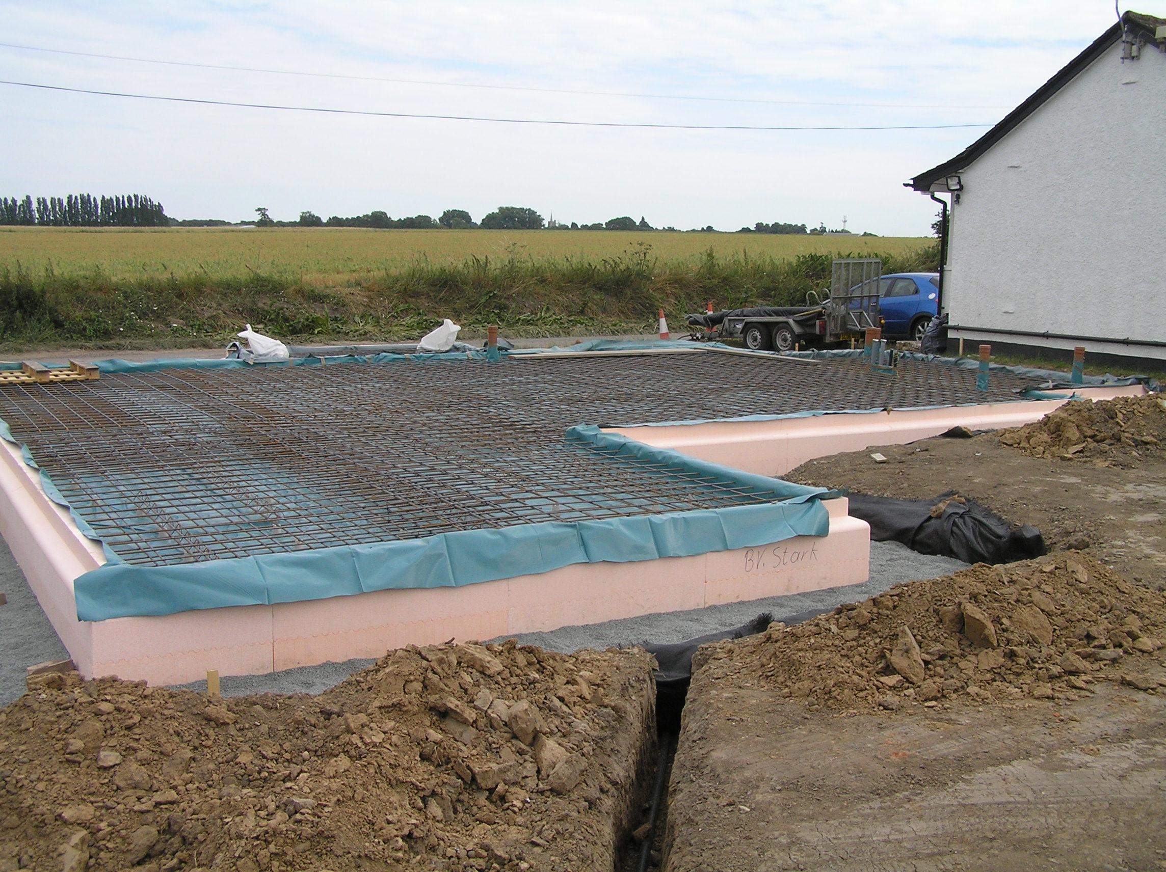

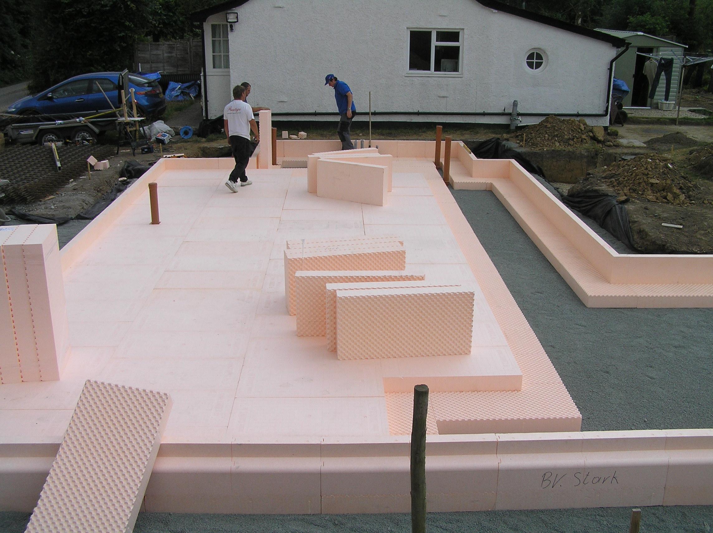

patp Posted September 6, 2019 Author Posted September 6, 2019 The senior BCO seems to think that a slab will be fine if that is the way we want to go. What is an insulated slab please?
Jeremy Harris Posted September 6, 2019 Posted September 6, 2019 10 minutes ago, patp said: The senior BCO seems to think that a slab will be fine if that is the way we want to go. What is an insulated slab please? There's some photos of our passive insulated slab going down here (they are all much of a muchness in the way they are laid): http://www.mayfly.eu/2013/10/part-sixteen-fun-and-games-in-the-mud/ 1
Gone West Posted September 6, 2019 Posted September 6, 2019 1 hour ago, patp said: What is an insulated slab please? More insulated slab laying. 2
