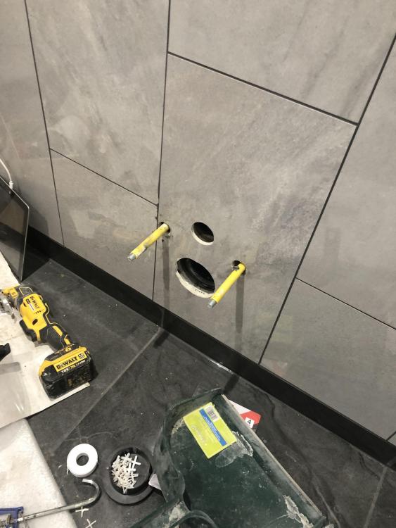

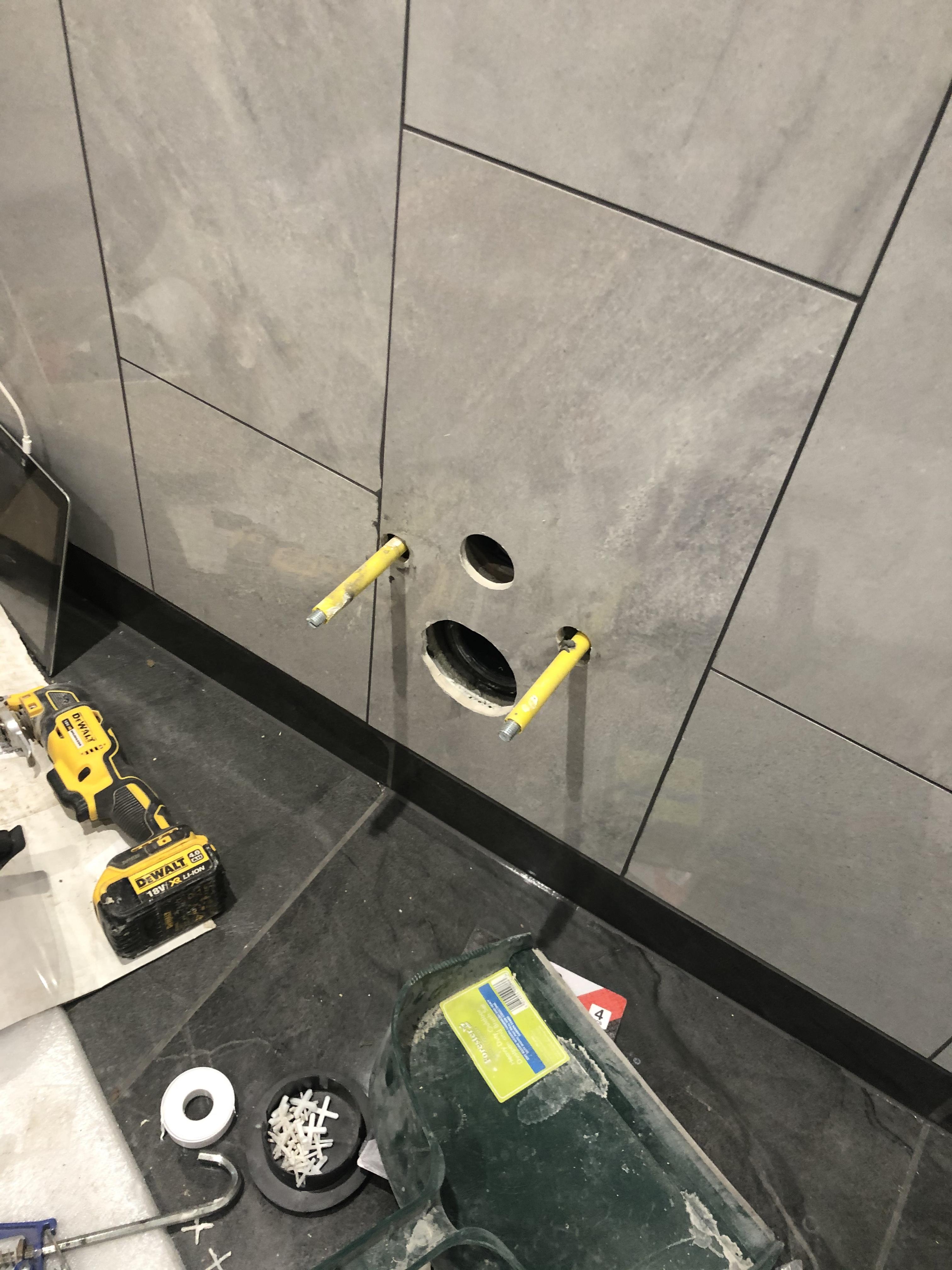

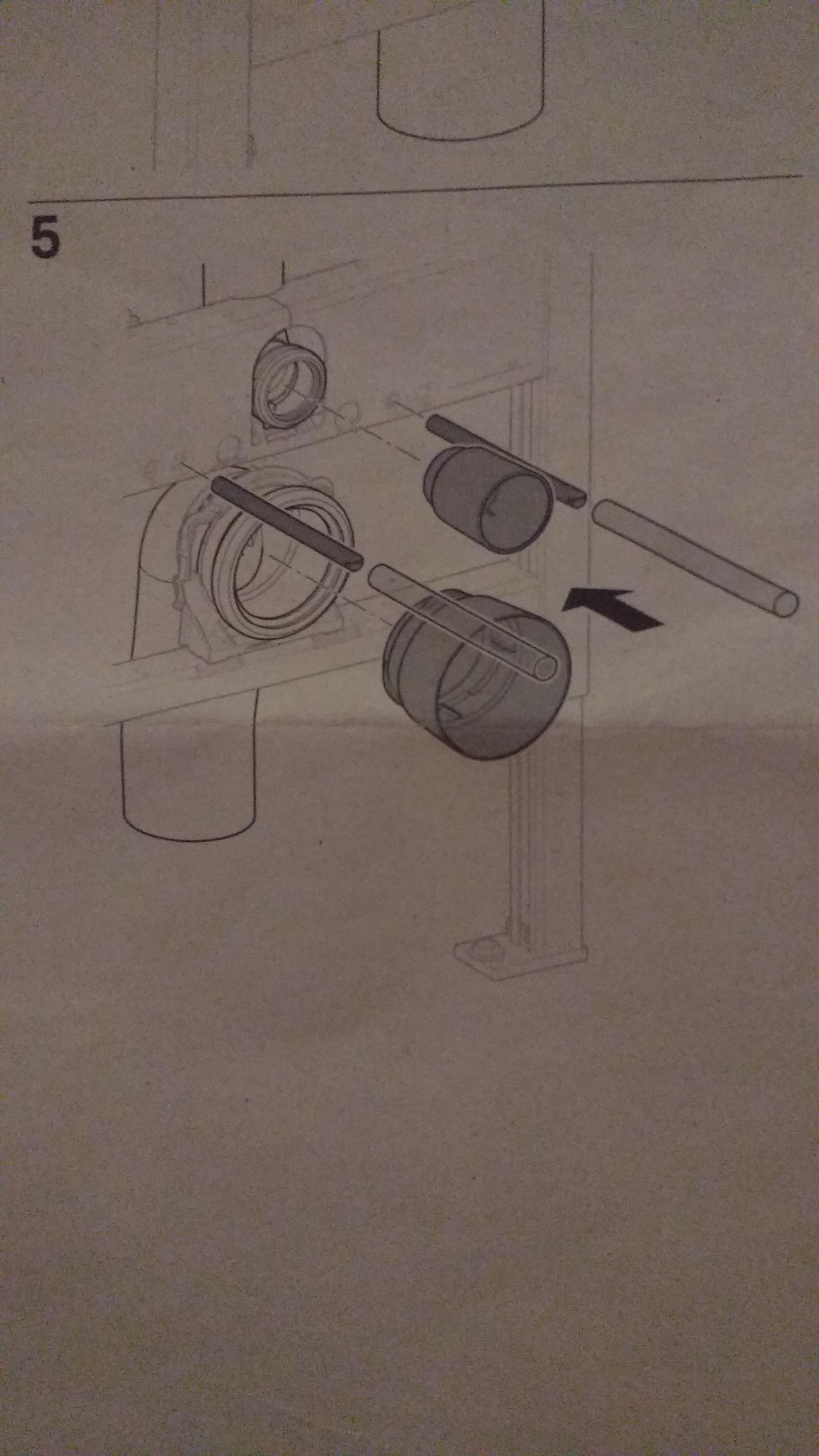

Pocster Posted January 21, 2021 Author Share Posted January 21, 2021 1 minute ago, Onoff said: As my pan was non Geberit I had to go off piste with the fixing detail. I was paranoid about the pan material sitting on the metal bolt threads. I used the clear sleeves and a length of plastic conduit: Geberit one is just a threaded rod - that’s it . Part of the reason the pan can wobble because they can wobble a bit . Currently in geberit phone queue . “ Your position is 2 “ - relevant for a wc supplier I guess . Link to comment Share on other sites More sharing options...
Pocster Posted January 21, 2021 Author Share Posted January 21, 2021 Geberit confirm they wobble !!! ?? 1 Link to comment Share on other sites More sharing options...

Pocster Posted January 21, 2021 Author Share Posted January 21, 2021 It is done ! I still reckon it will move a bit . But once the ct1 has gone off I guess it will be fine . I’m going to blame the textured tiles causing the issue . 2mm packer in plastic wedged in the back underneath When I remove it though I reckon the pan might drop ... Remove it when ct1 cured ; then put back in ? Link to comment Share on other sites More sharing options...
PeterW Posted January 21, 2021 Share Posted January 21, 2021 CT1 won’t compress unless you’re an 18 stone Jessie and you are standing on the rim of the pan .. 1 Link to comment Share on other sites More sharing options...

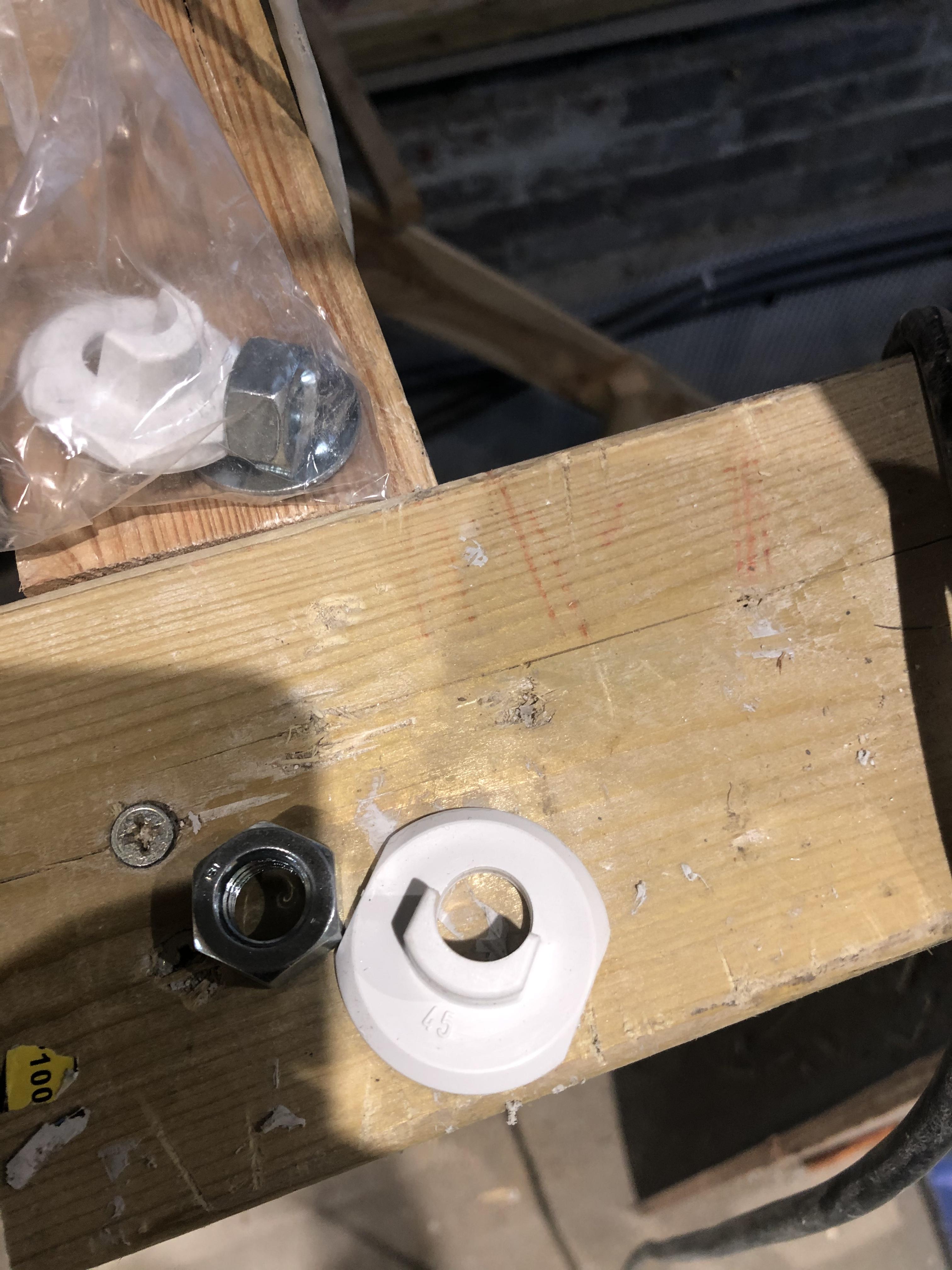

Russell griffiths Posted January 21, 2021 Share Posted January 21, 2021 After you have screwed in the studs did you wind the lock nut down tight to the frame, there should be a nut you wind down to lock the stud to the frame. Link to comment Share on other sites More sharing options...
Pocster Posted January 21, 2021 Author Share Posted January 21, 2021 Just now, Russell griffiths said: After you have screwed in the studs did you wind the lock nut down tight to the frame, there should be a nut you wind down to lock the stud to the frame. Not sure exactly what you mean ? Those thread bars just screw in - no lock nut or nothing . Geberit confirmed they wobble a few mm .... Link to comment Share on other sites More sharing options...
Russell griffiths Posted January 21, 2021 Share Posted January 21, 2021 1 minute ago, pocster said: Not sure exactly what you mean ? Those thread bars just screw in - no lock nut or nothing . Geberit confirmed they wobble a few mm .... There should be an m10 nut that screws all the way down that thread and locks the stud against the blue frame. Link to comment Share on other sites More sharing options...
Pocster Posted January 21, 2021 Author Share Posted January 21, 2021 Just now, Russell griffiths said: There should be an m10 nut that screws all the way down that thread and locks the stud against the blue frame. You sure ??? The instructions don’t show this and I don’t remember seeing it with all the parts . But will double check tomorrow!!! Link to comment Share on other sites More sharing options...
Onoff Posted January 21, 2021 Share Posted January 21, 2021 10 minutes ago, Russell griffiths said: There should be an m10 nut that screws all the way down that thread and locks the stud against the blue frame. Not on my Geberit Kappa UP200 frame: Link to comment Share on other sites More sharing options...
Pocster Posted January 21, 2021 Author Share Posted January 21, 2021 2 minutes ago, Onoff said: Not on my Geberit Kappa UP200 frame: Pretty sure mines the same . I am correct the plastic sleeves are just protection yes ? They don’t stay on for install ? ( though they do make the bolt more rigid ) Link to comment Share on other sites More sharing options...
Russell griffiths Posted January 21, 2021 Share Posted January 21, 2021 Just passing on info I was told. 1 1 Link to comment Share on other sites More sharing options...

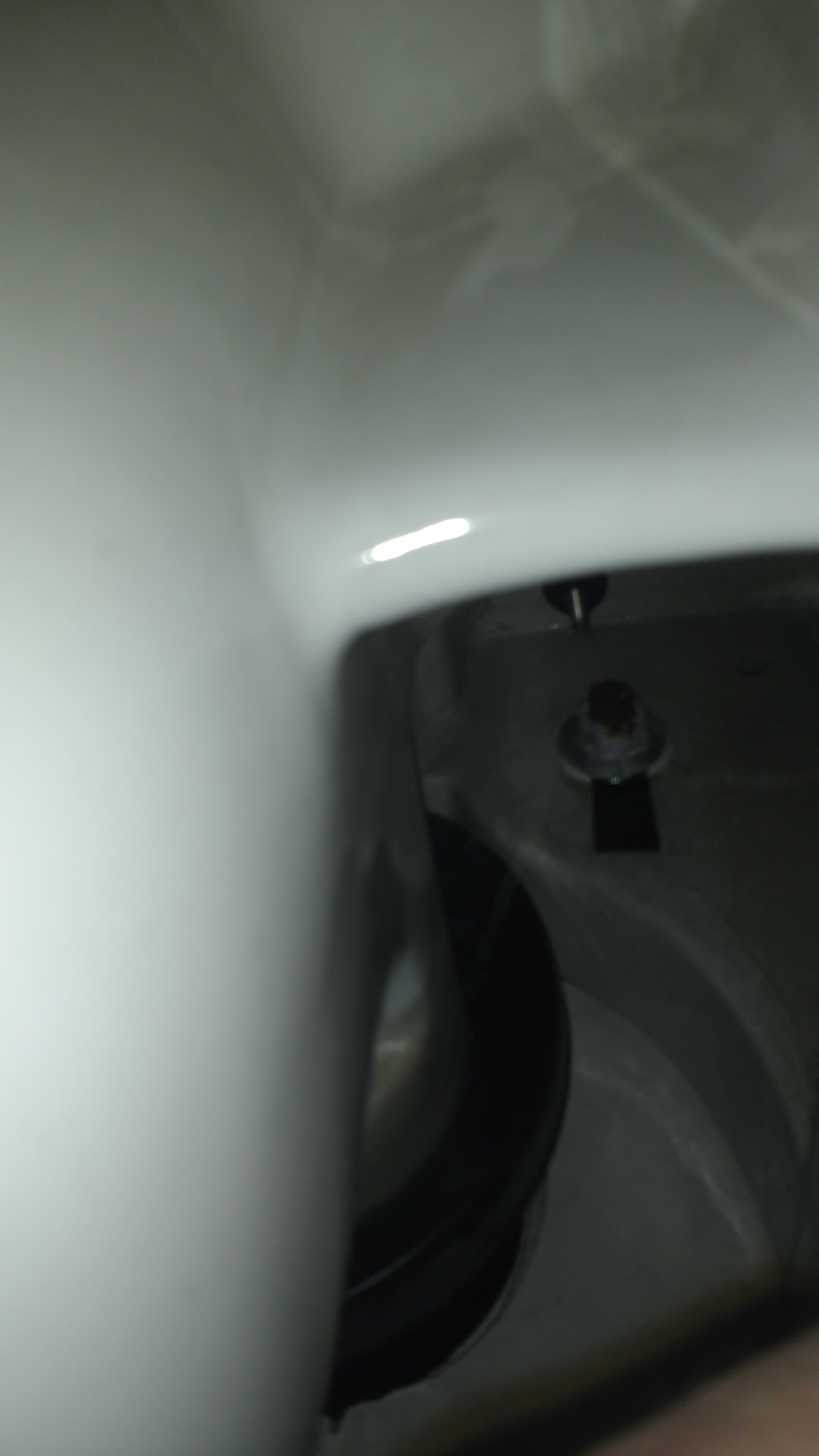

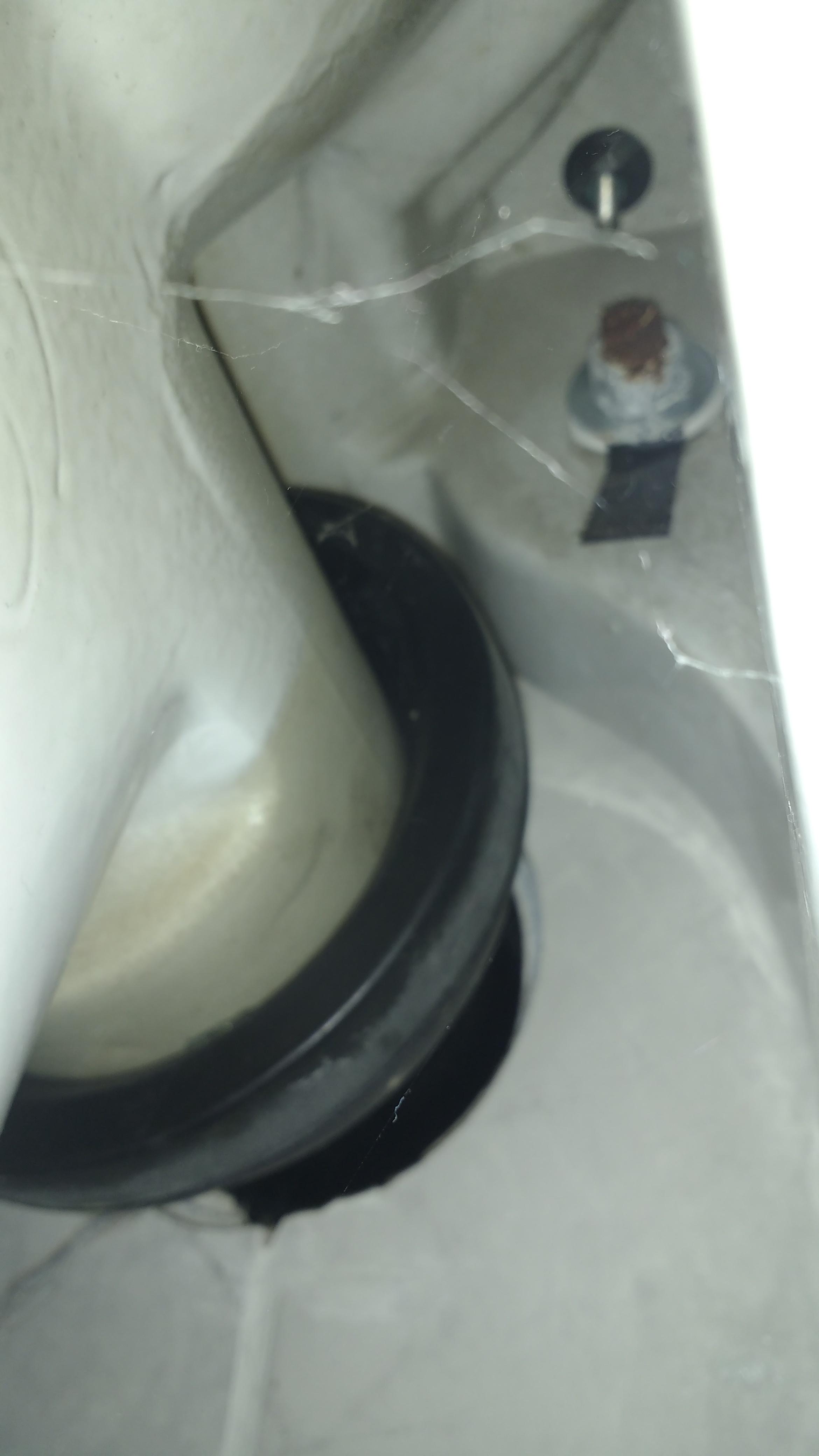

Onoff Posted January 21, 2021 Share Posted January 21, 2021 As aforementioned and repeated below I left mine on and slipped PVC conduit over my studs. The thickness of the sleeve plus the conduit brings it up level to the bfo plastic retaining washer that came with the Geberit kit. Mind I had big holes in my pan to "fill": Interesting to see under the pan how the end of the zinc plated studs have rusted (couldn't get it to focus): 1 Link to comment Share on other sites More sharing options...
Pocster Posted January 21, 2021 Author Share Posted January 21, 2021 1 minute ago, Onoff said: As aforementioned and repeated below I left mine on and slipped PVC conduit over my studs. The thickness of the sleeve plus the conduit brings it up level to the bfo plastic retaining washer that came with the Geberit kit. Mind I had big holes in my pan to "fill": Interesting to see under the pan how the end of the zinc plated studs have rusted (couldn't get it to focus): Yeah I get you improvised - I was just following the destructions . Will double double check tomorrow... Link to comment Share on other sites More sharing options...
Onoff Posted January 21, 2021 Share Posted January 21, 2021 1 minute ago, pocster said: Yeah I get you improvised - I was just following the destructions . Will double double check tomorrow... Tbh you could likely ditch the studs once the CT1 has set! 1 1 Link to comment Share on other sites More sharing options...
Pocster Posted January 21, 2021 Author Share Posted January 21, 2021 2 minutes ago, Onoff said: Tbh you could likely ditch the studs once the CT1 has set! Makes you wonder doesn’t it . I’ll leave that experiment to someone else though Link to comment Share on other sites More sharing options...
Pete Posted January 22, 2021 Share Posted January 22, 2021 12 hours ago, Russell griffiths said: There should be an m10 nut that screws all the way down that thread and locks the stud against the blue frame. Not on mine either Link to comment Share on other sites More sharing options...
Onoff Posted January 22, 2021 Share Posted January 22, 2021 Those studs on mine are M12 not M10 btw. Link to comment Share on other sites More sharing options...

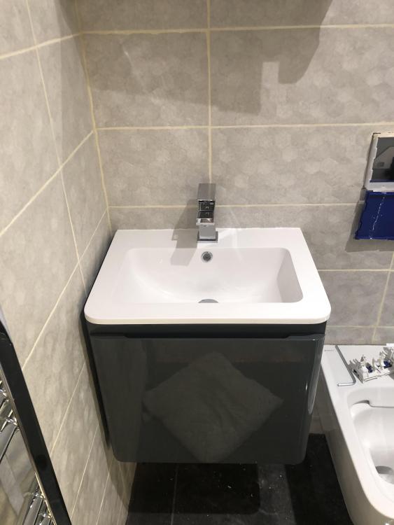

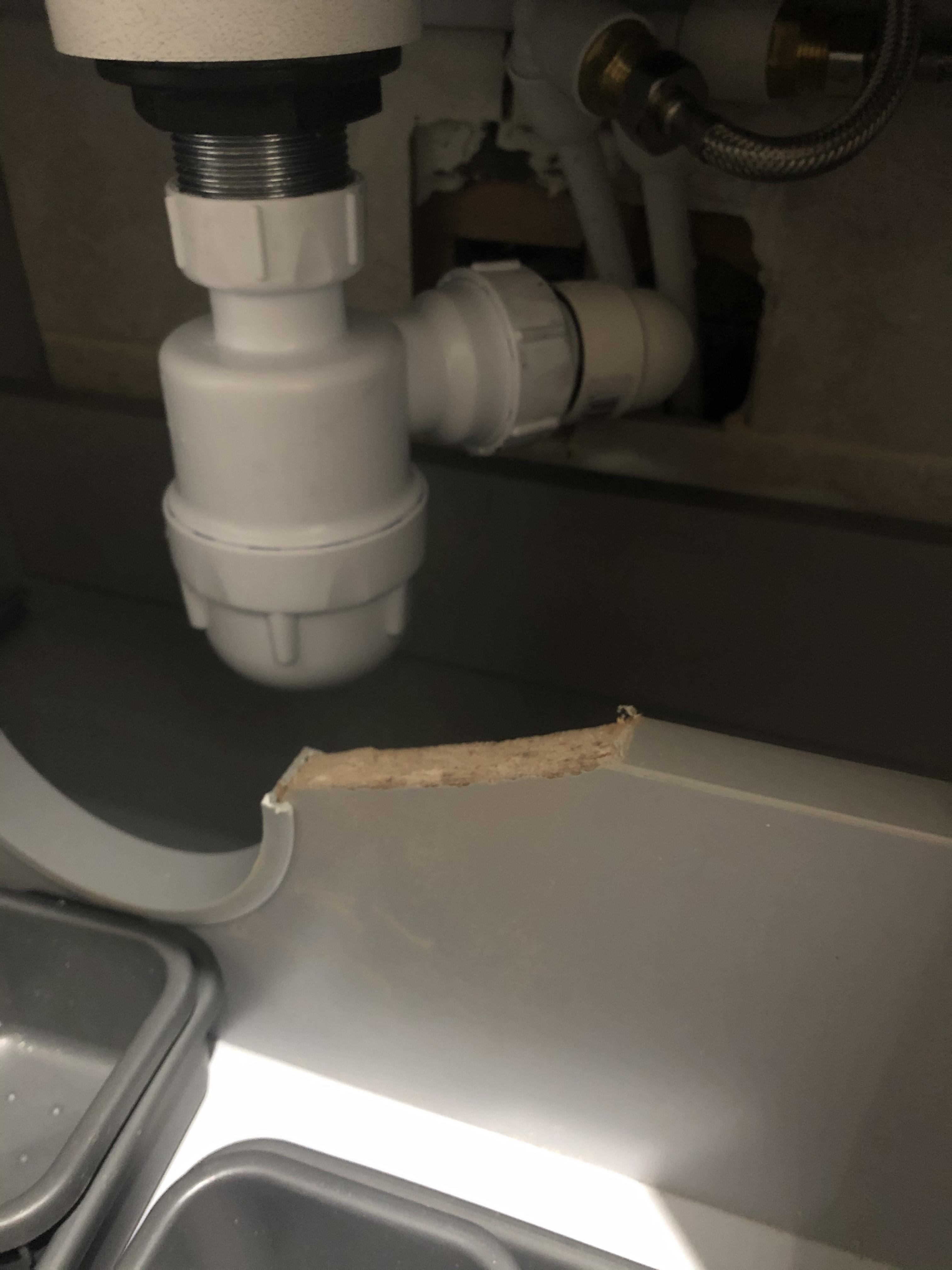

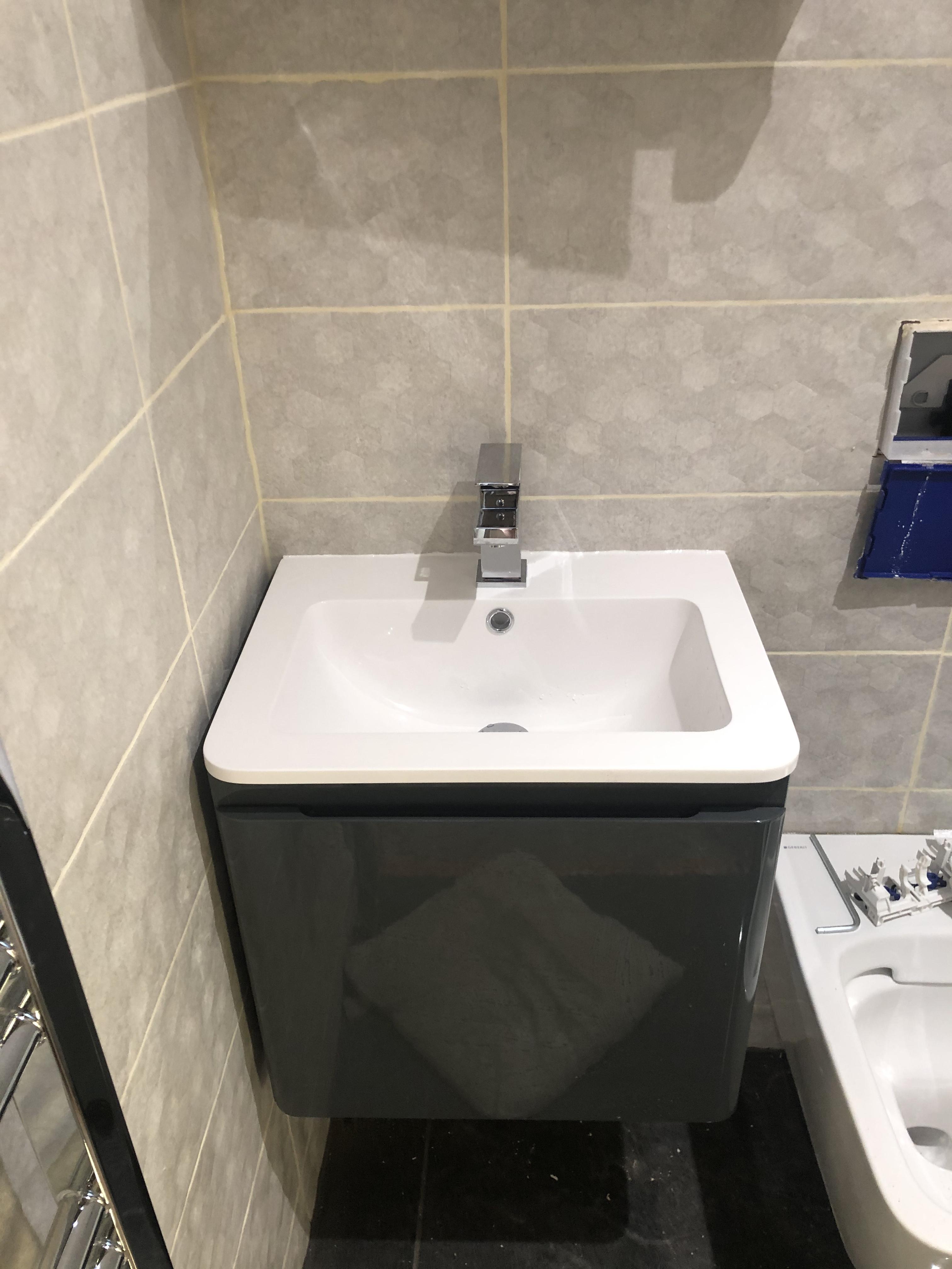

Pocster Posted January 22, 2021 Author Share Posted January 22, 2021 Ensuite sink done . Tight pipework and a slight hack on the cabinet Link to comment Share on other sites More sharing options...

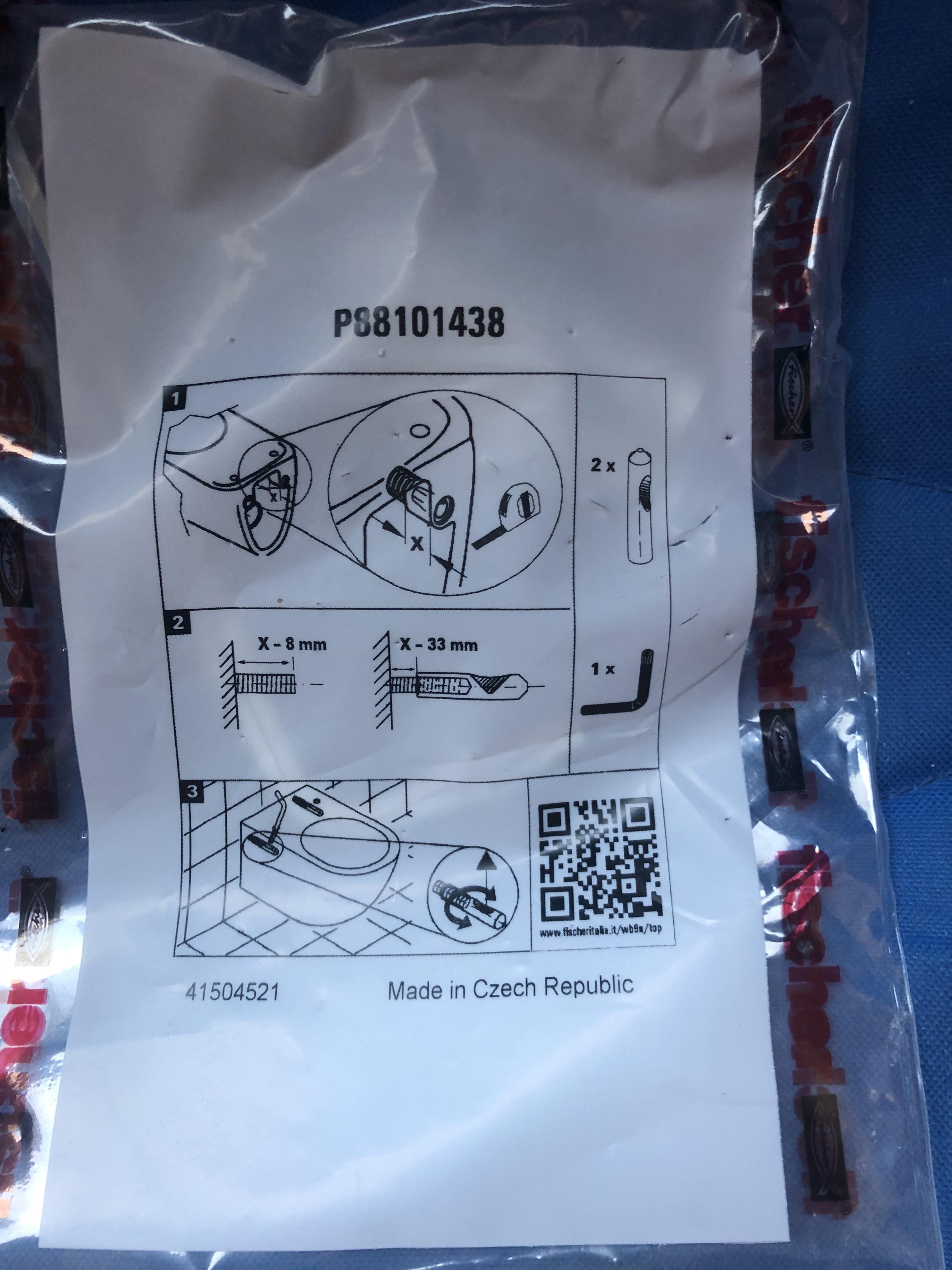

Pocster Posted January 22, 2021 Author Share Posted January 22, 2021 Regarding geberit wobble fixings . The instructions that come with the pan suggest nothing . Some ‘bits’ left over from the frame do fit that bolt thread . Currently trying to find the other frame bits and instructions- which I’ve put somewhere ‘safe’ I.e I can’t find them !! Link to comment Share on other sites More sharing options...
Pocster Posted January 22, 2021 Author Share Posted January 22, 2021 Give up ! . Lost the 2 pipes for the bathroom wc and therefore frame instructions and bits ? Link to comment Share on other sites More sharing options...
ToughButterCup Posted January 22, 2021 Share Posted January 22, 2021 12 minutes ago, pocster said: Regarding geberit wobble fixings . The instructions that come with the pan suggest nothing . Some ‘bits’ left over from the frame do fit that bolt thread . Currently trying to find the other frame bits and instructions- which I’ve put somewhere ‘safe’ I.e I can’t find them !! Bet my next month's salary, you can download them ... Link to comment Share on other sites More sharing options...
Pocster Posted January 22, 2021 Author Share Posted January 22, 2021 20 minutes ago, ToughButterCup said: Bet my next month's salary, you can download them ... Sure thing ! That was my next step Link to comment Share on other sites More sharing options...
Onoff Posted January 22, 2021 Share Posted January 22, 2021 32 minutes ago, pocster said: Same bits I had with my Geberit frame. You still got the box the frame came in? There'll be a long number on there like: 111.799.00.1 Link to comment Share on other sites More sharing options...
Pocster Posted January 22, 2021 Author Share Posted January 22, 2021 3 minutes ago, Onoff said: Same bits I had with my Geberit frame. You still got the box the frame came in? There'll be a long number on there like: 111.799.00.1 Nah that’s long gone . I’ll find the invoice then I should be able to contact geberit ( or the frame supplier ) for the bits . So annoyed ! Wouldn’t throw them out !! Grrrrrr Link to comment Share on other sites More sharing options...
