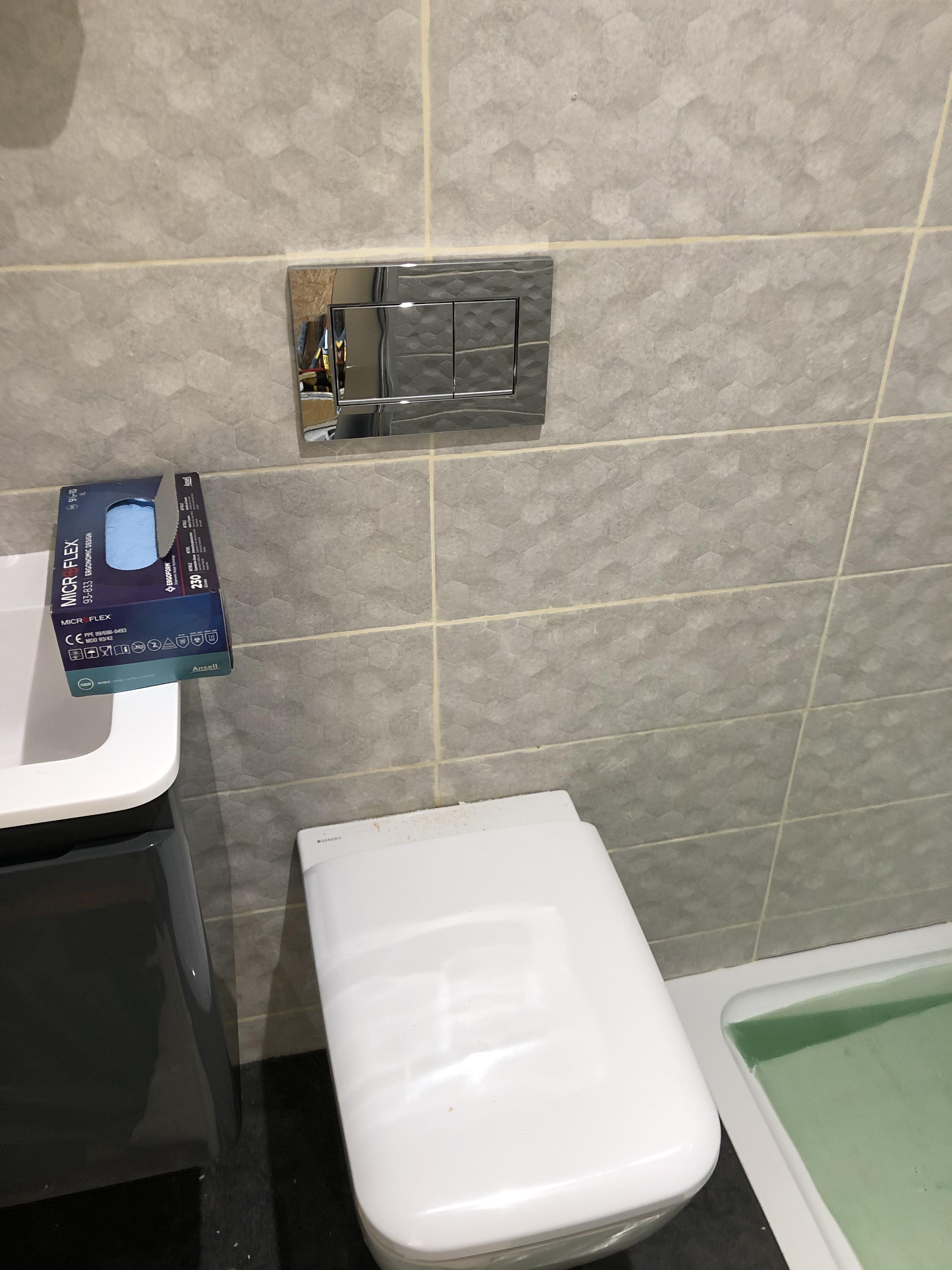

Toilet done !
I like the geberit thought that goes into the design ( apart from wobbly bolts )
Shower doors to look at now . Will fix the whole lot dry so I understand what I’m doing !!

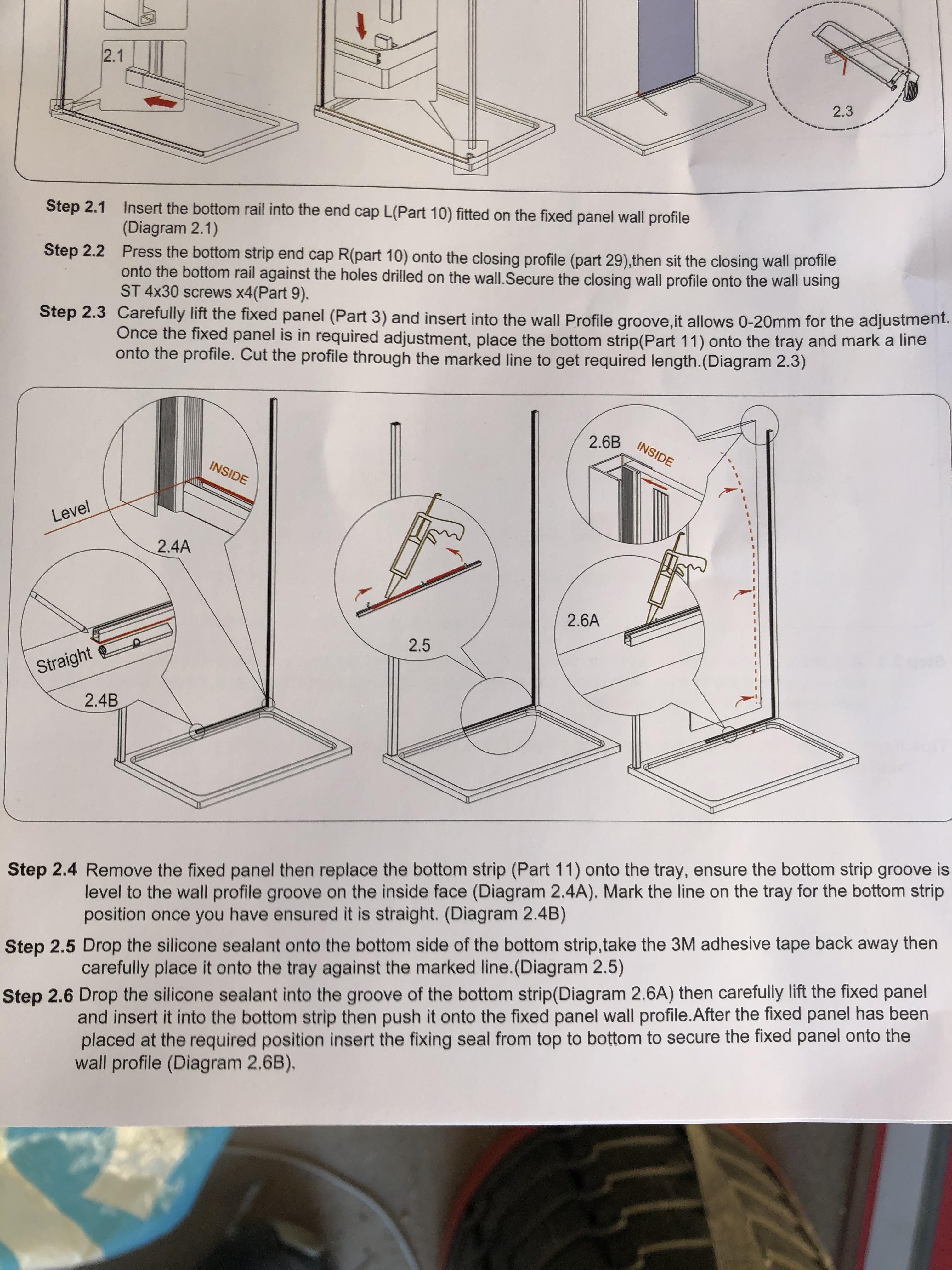

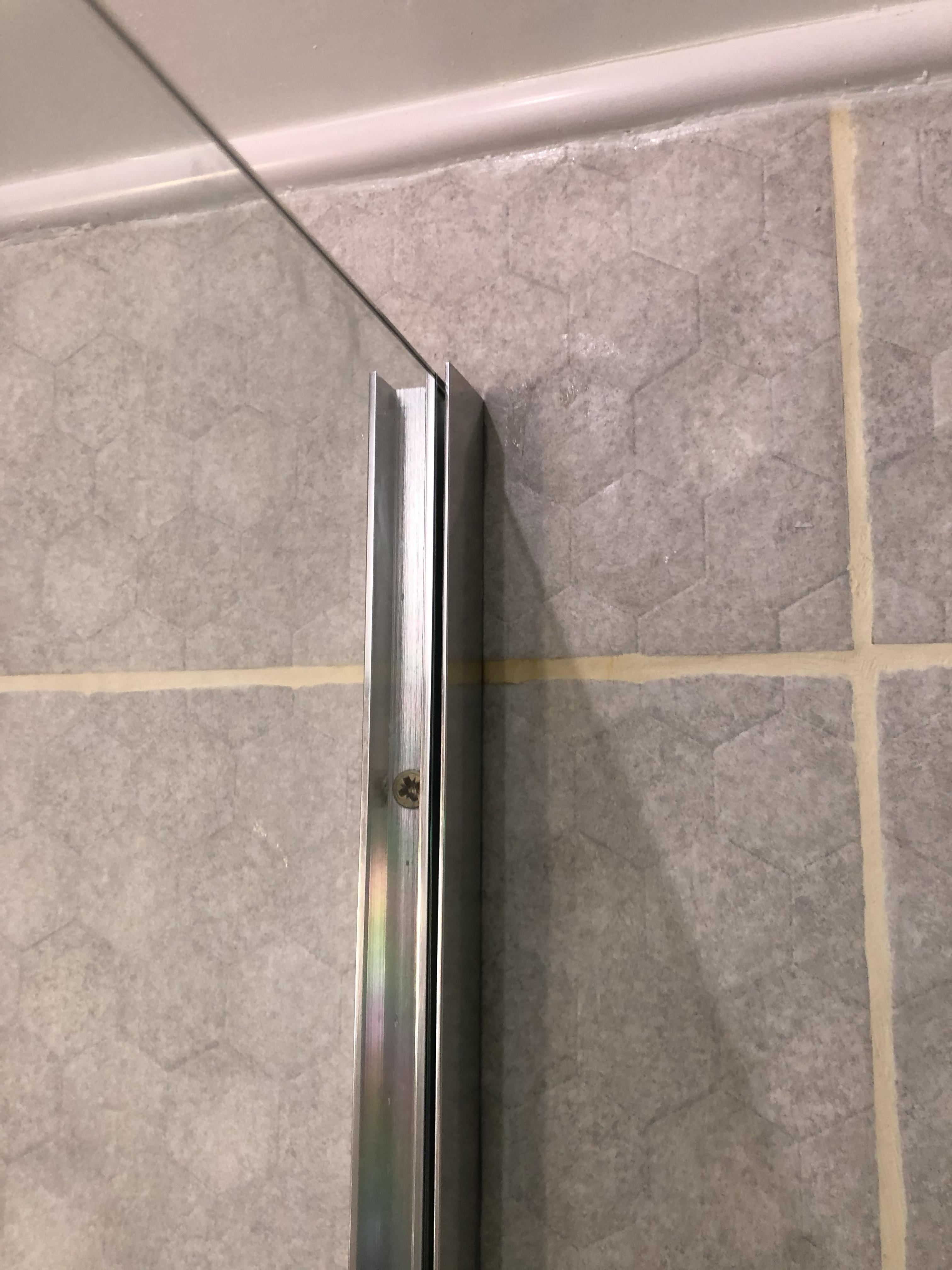

Attempting ensuite shower doors .
Everything ok after some head scratching but this bits got me .

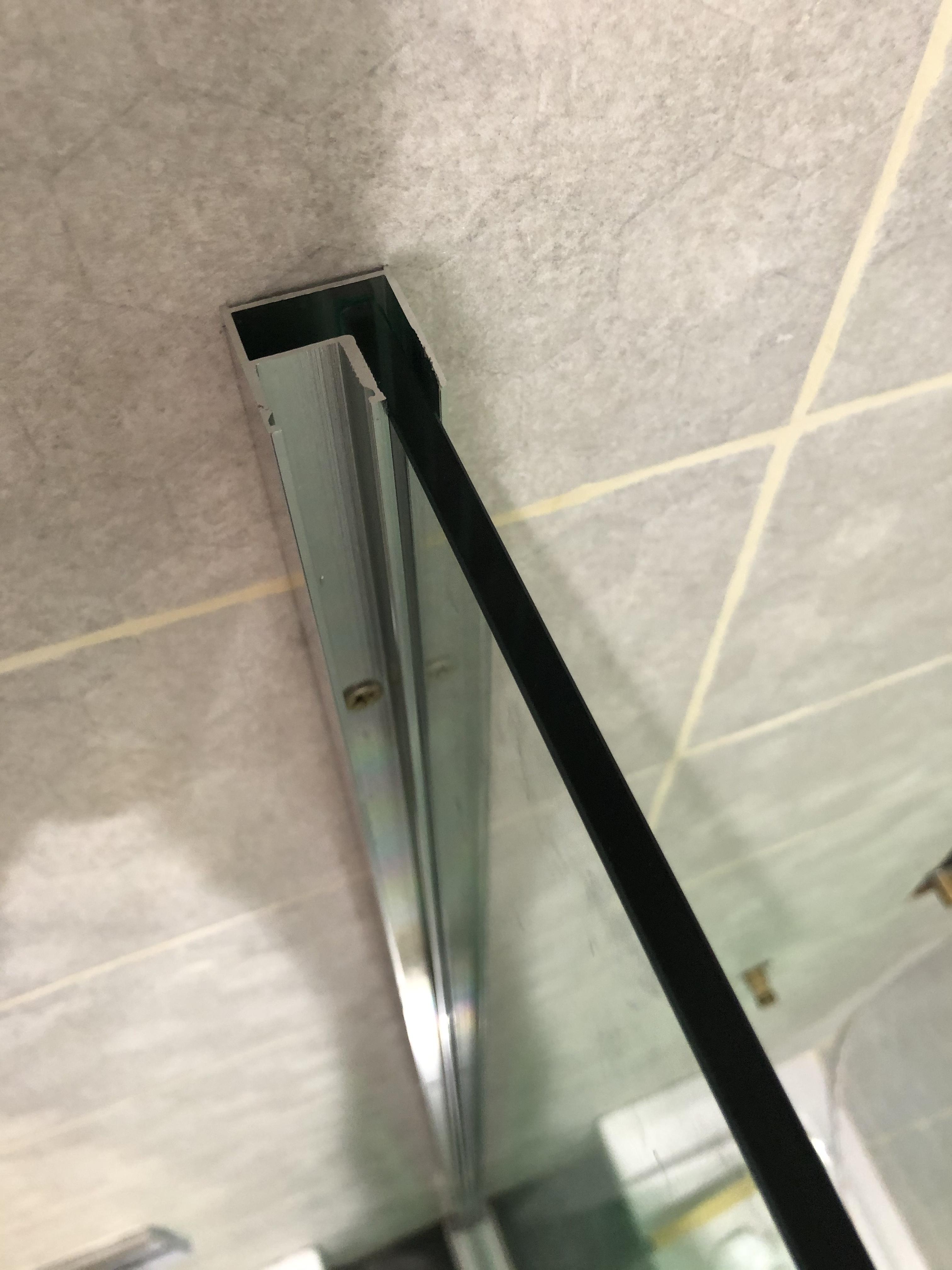

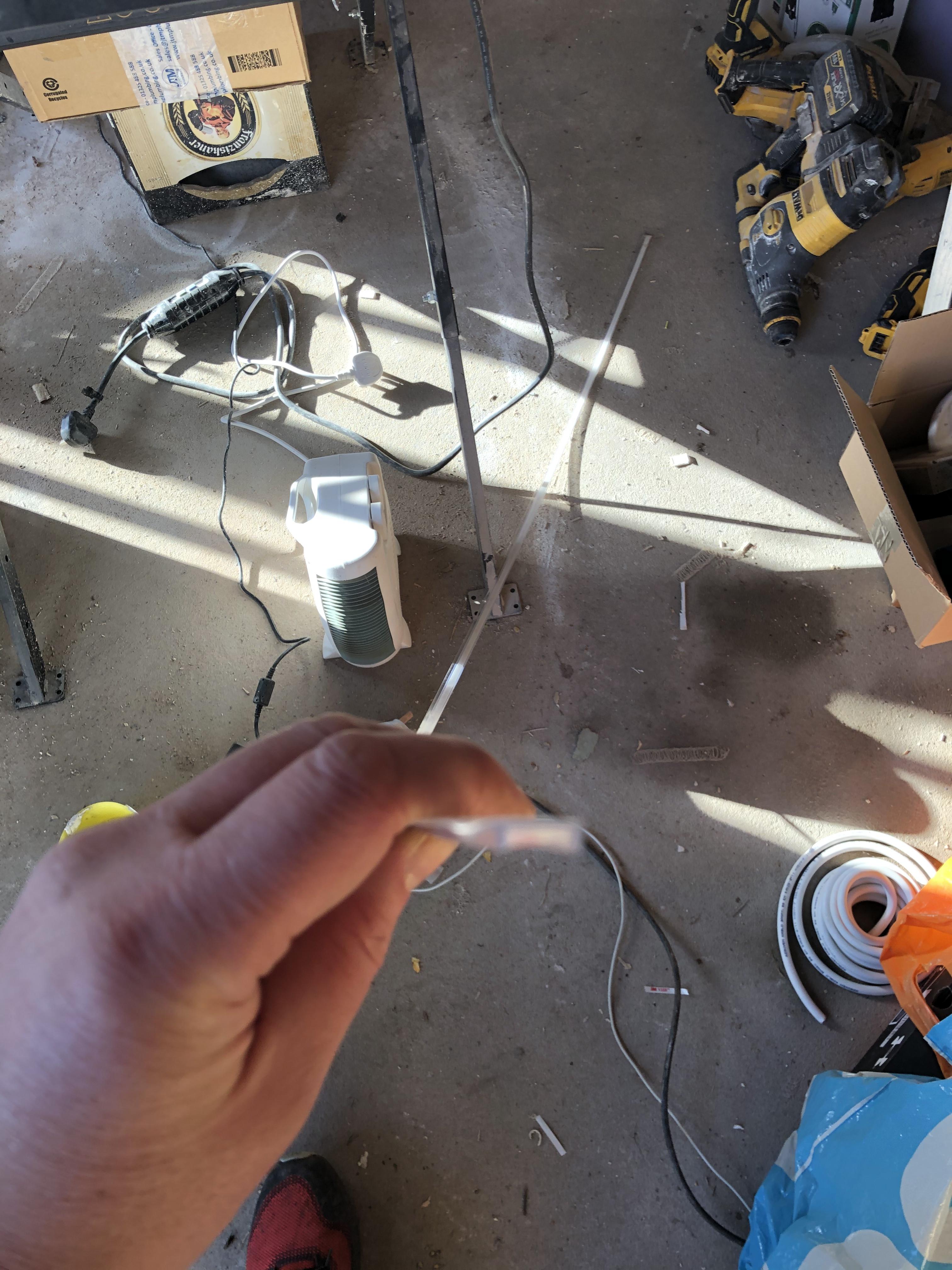

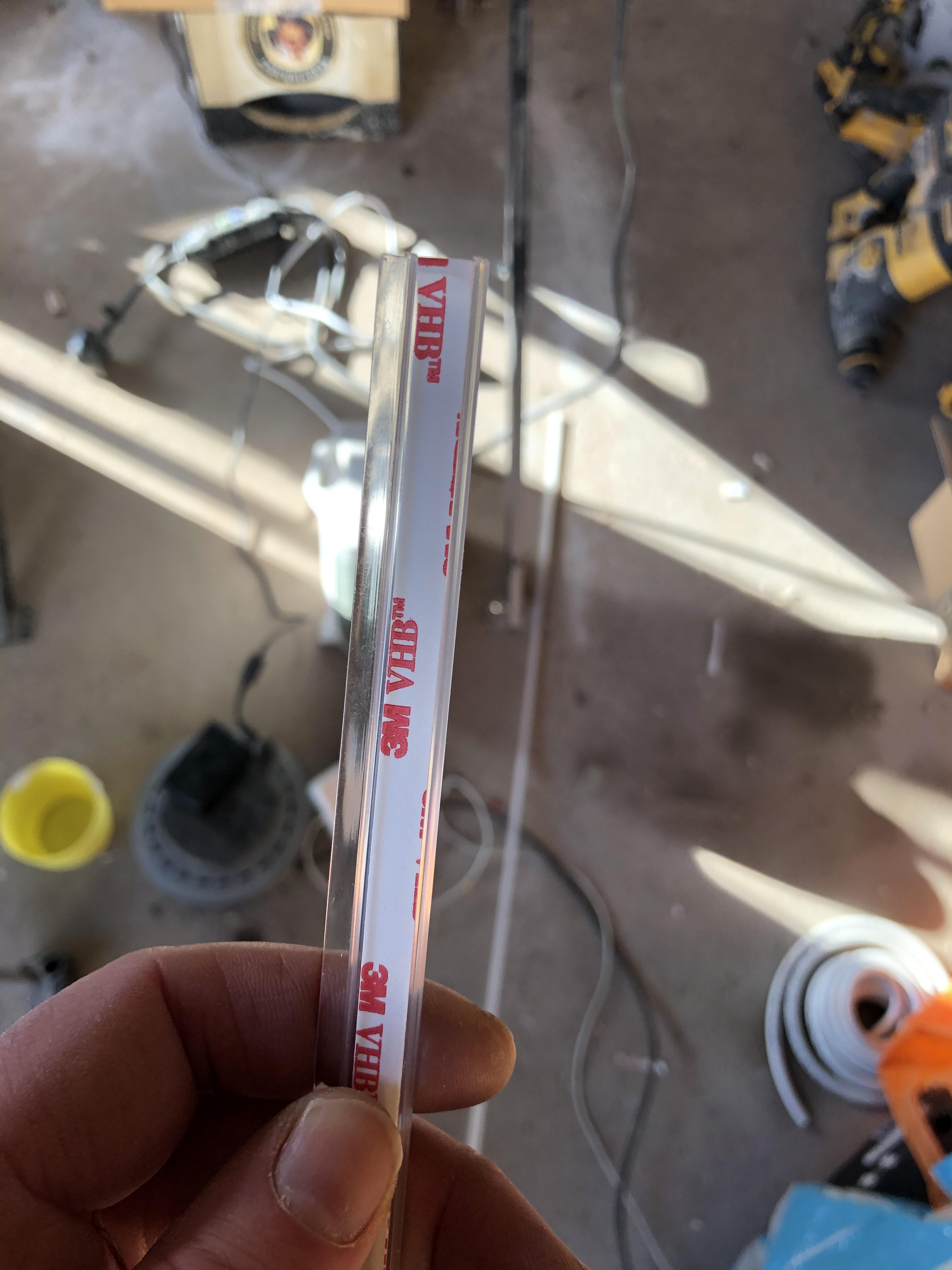

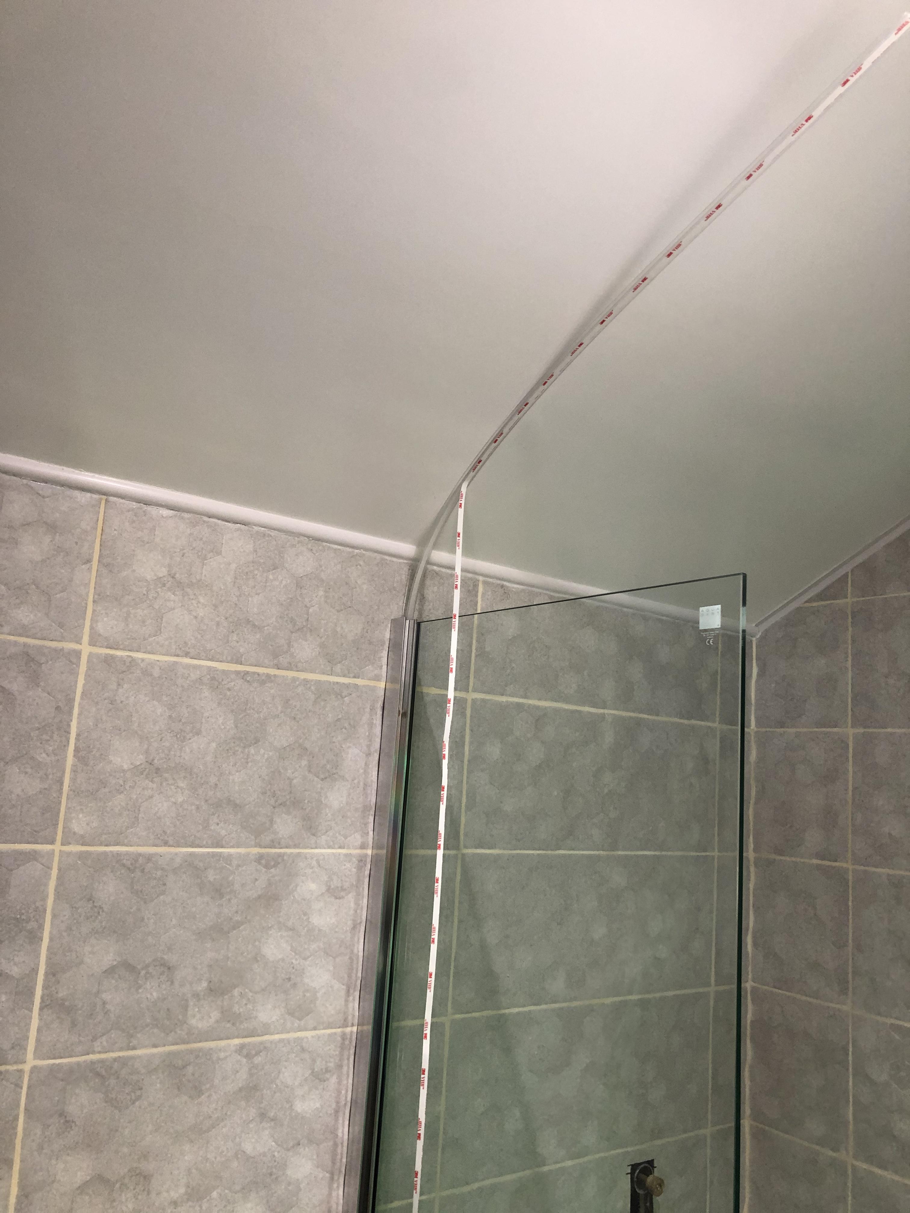

Step 2.6 - don’t get how this strip fixes in . The sticky part suggests it goes on the end of the glass . But it then won’t fit in the wall channel . Also the instructions seem to suggest sliding it in somehow - but then the sticky bit doesn’t make sense ...
Probably not critical . At the moment the glass is sat in ct1 in the base bit which in turn is ct1’d to the tray . I could just run a thin bead down the inside of the glass .... ??
Top of wall profile . Plastic strip won’t fit in there !!
Before anyone asks , yes , there is an arm support to hold the glass

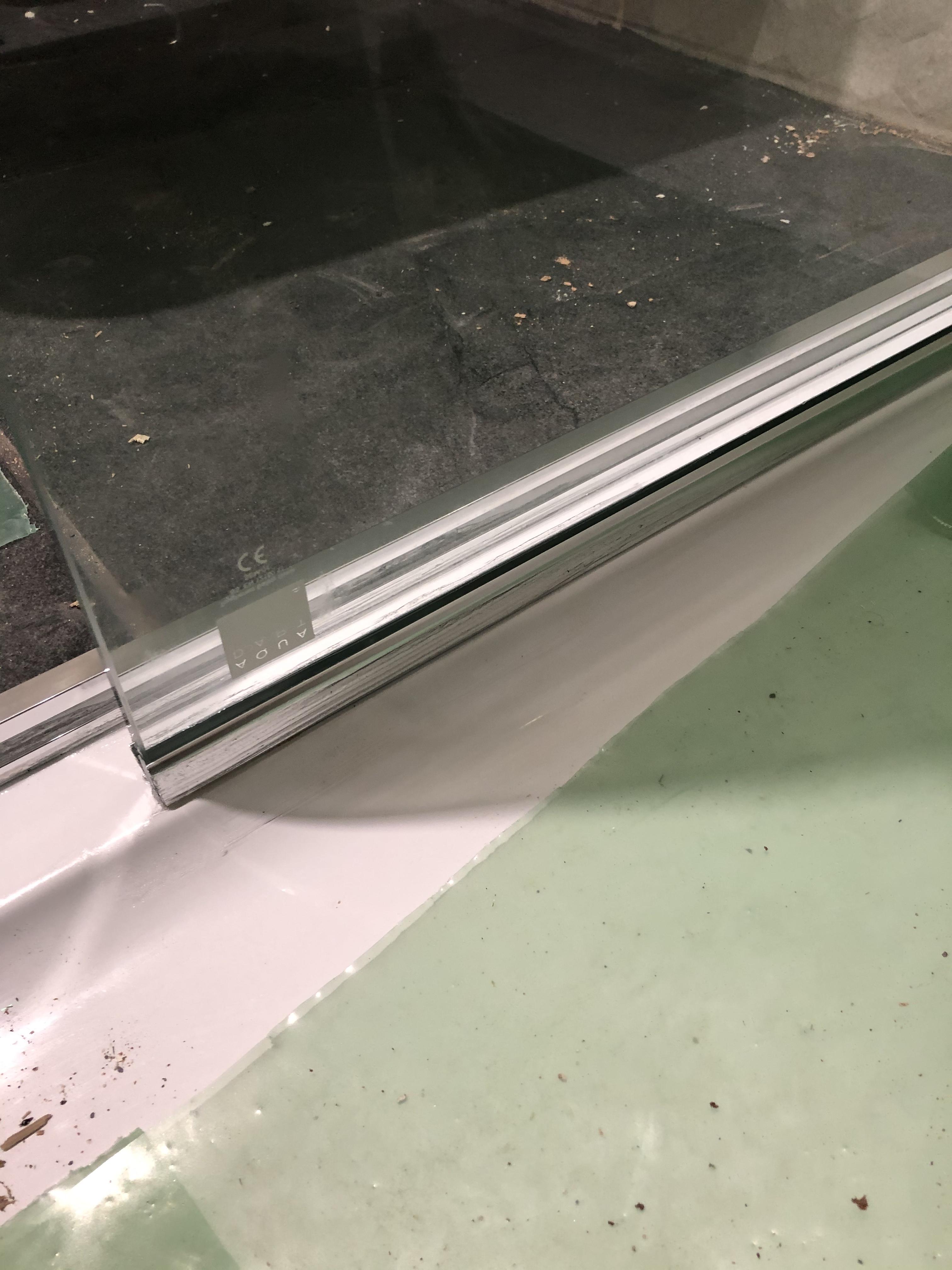

Wasn’t happy about that bottom horizontal bit that the glass sits in . It’s just sticky tape on the back to stick it to the tray - wtf ! Crap ! . So I ct1 ‘d it
Oh hang on ! I’ve got to some how slide it down behind the glass ?!?!?!?
Well ! That’s where it’s going now .
Why they can’t simply show the wall profile having it slid in before the glass who knows !

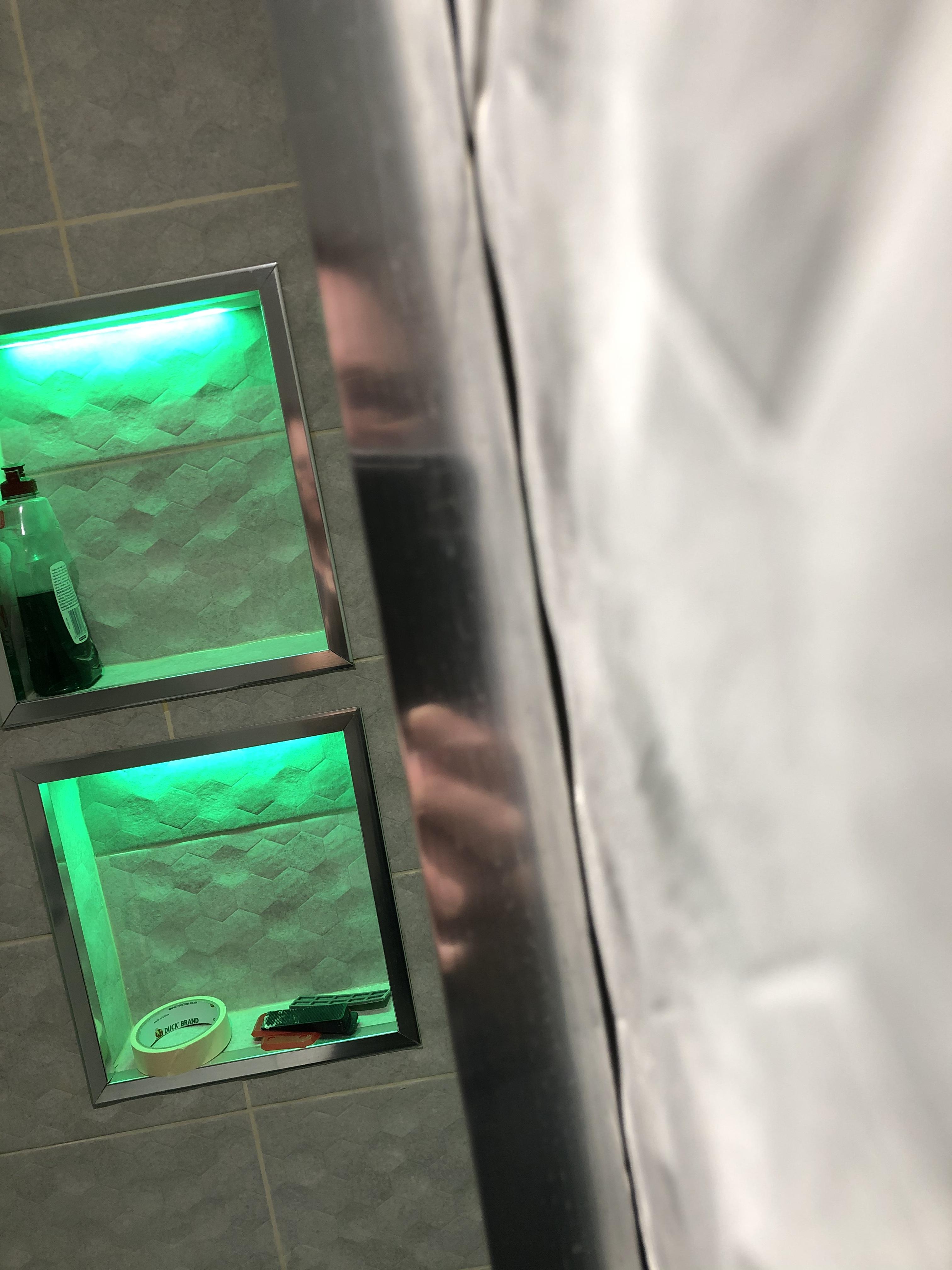

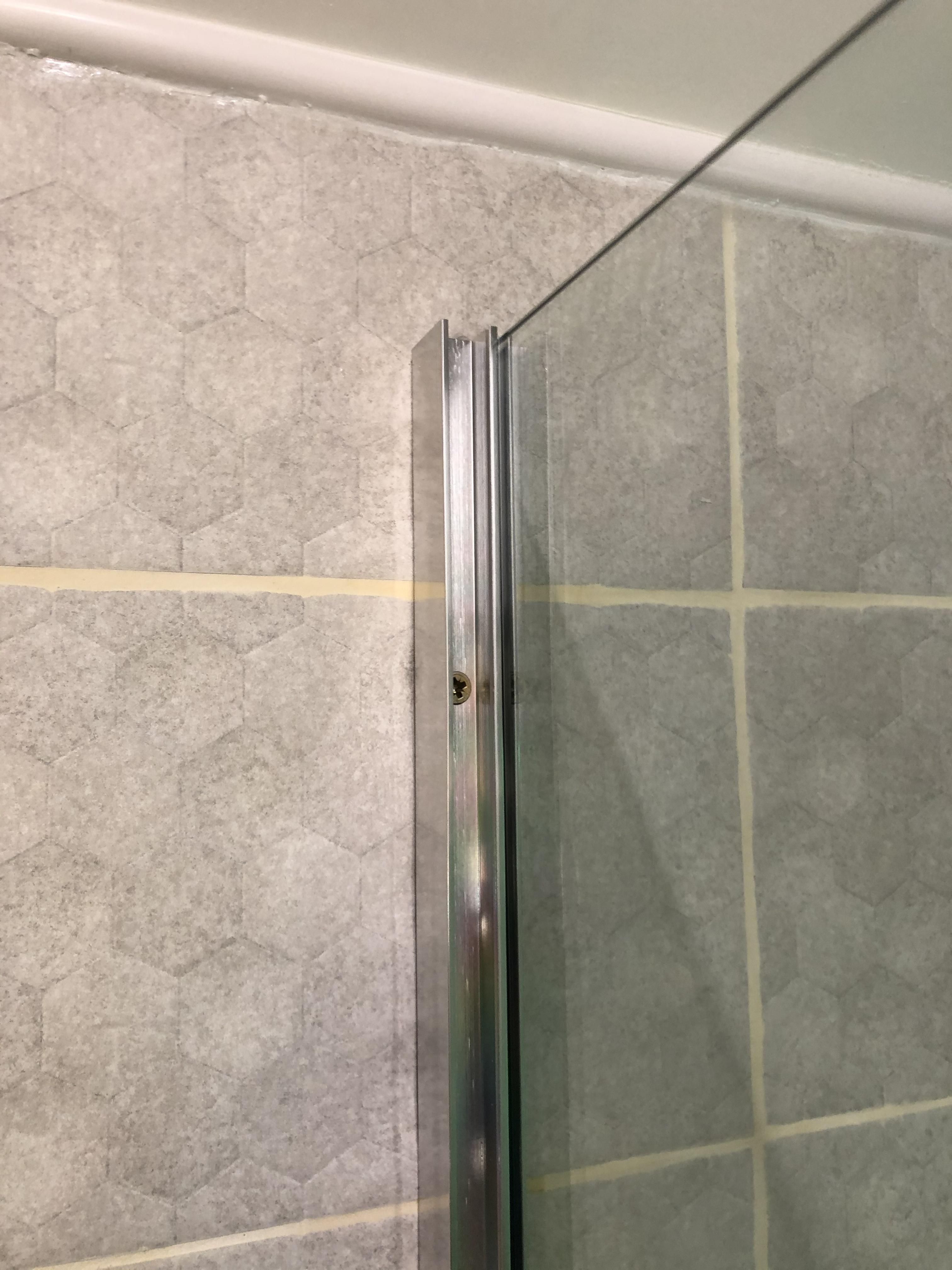

Because of those b stard textured tiles still have gaps between profile and wall . I did ct1 the nuts on it ( used an entire tube for 2 profiles ) . So will have to go inside the cubicle and ct1 those gaps again .
Hate textured tiles - cause so many problems!!ED7398C4-44CA-430F-8FB4-97D48FD05C63.thumb.jpeg.3bbb2fc357eb6b6f8158ae0a579a72f9.jpeg
