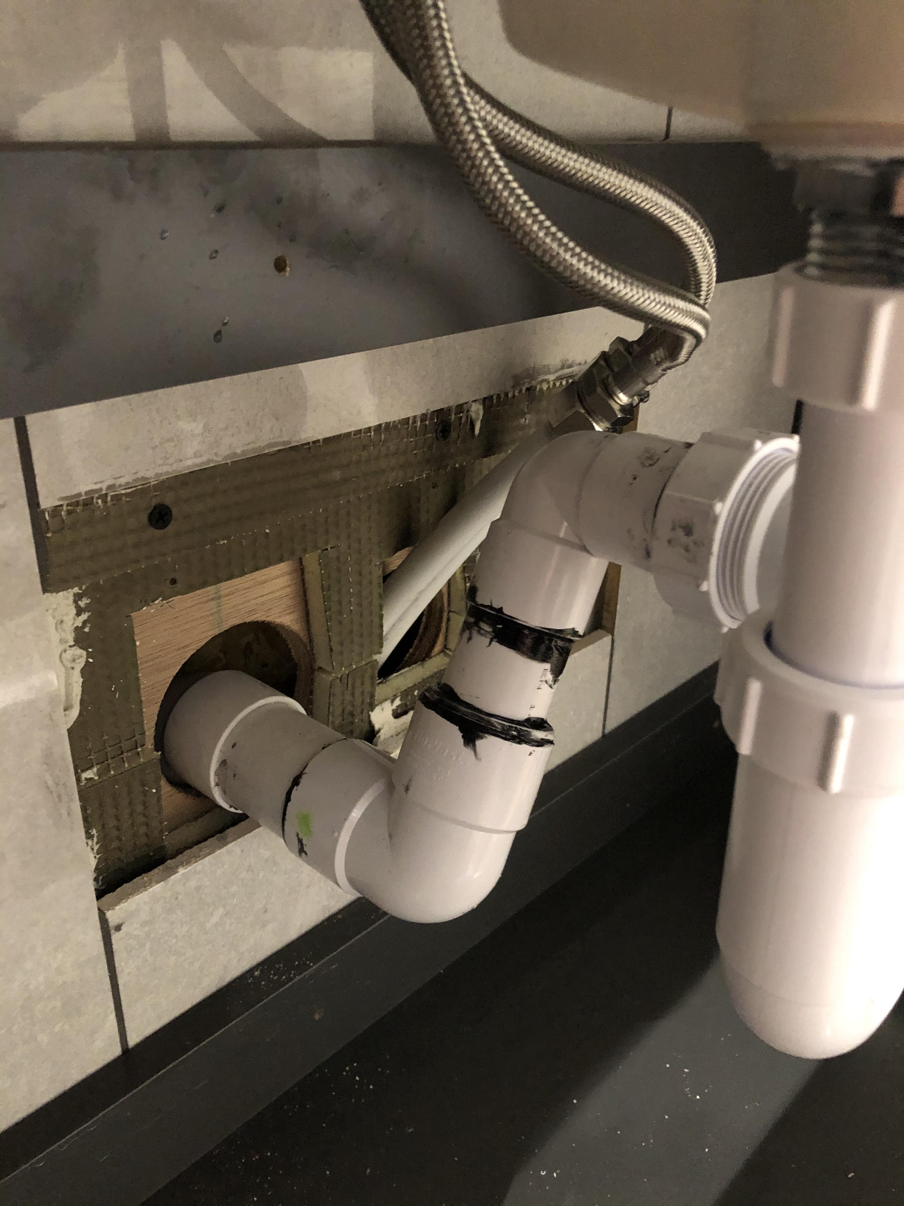

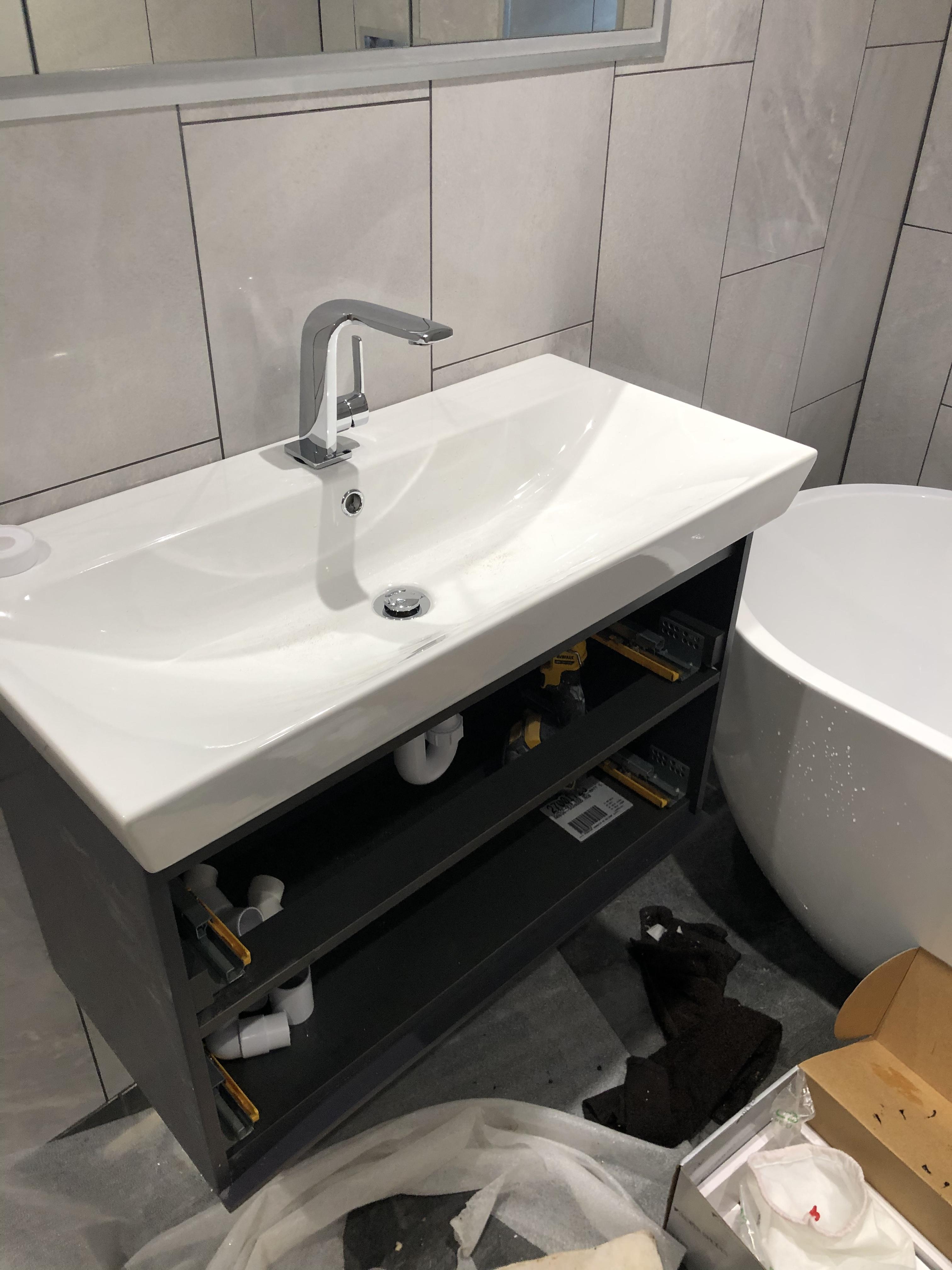

Sink on . Water feed to taps leak . Olive fittings against Hep2o . I’ll take then off tomorrow and ptfe the threads . Waste in . Tiger seal ( hence the lovely black mess ) to compression fittings . I prefer it this way .
Looking good ?

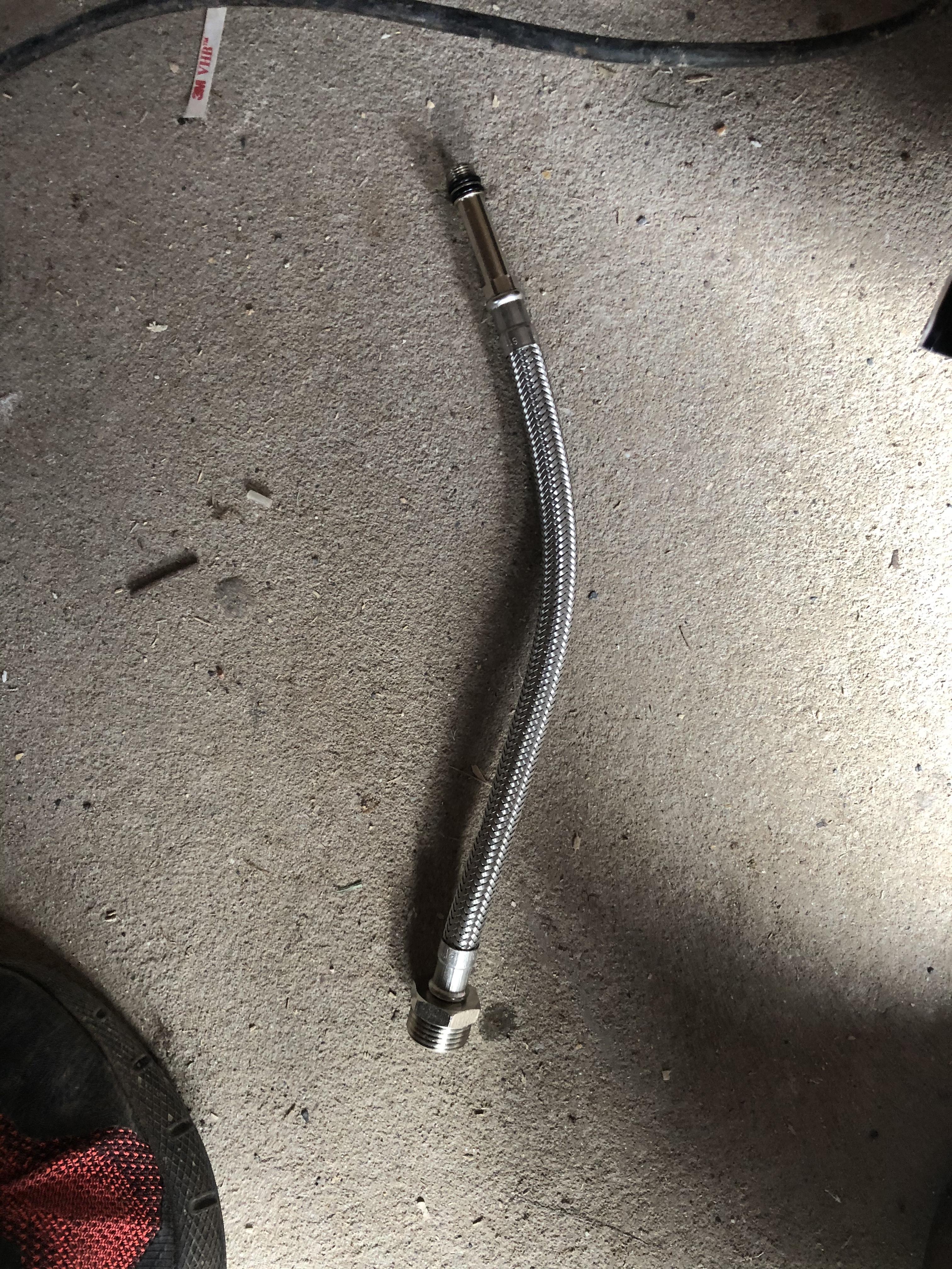

Is that braided hose kinked or is it just the camera angle? If it is, you want to sort that out, otherwise it will spring a leak in the future.
6 minutes ago, Gav_P said:
Looking good ?
Kinky, need you ask?
20 minutes ago, Gav_P said:
Looking good ?
A slight kink I think . Surely it’s not an issue ??? ( I’ll get better photos tomorrow)

Also getting those braids out without removing the entire would be impossible....
Making me worry now !!
Flexis are pretty sensitive in my experience. When I’ve lived elsewhere in Europe, every fitting is connected via a flexi and they fail fairly frequently. Probably affected more by hardwater too.
Hopefully a proper plumber will be along soon to tell you it’ll be fine.

Tempted to remove them and replace them with something

Is the drawer going to close?
Should do . Much more space for waste than the other unit
Talk about what lies beneath, you ain't fussy are you?
Give as a shout if you want my plumber to come and tidy it up!

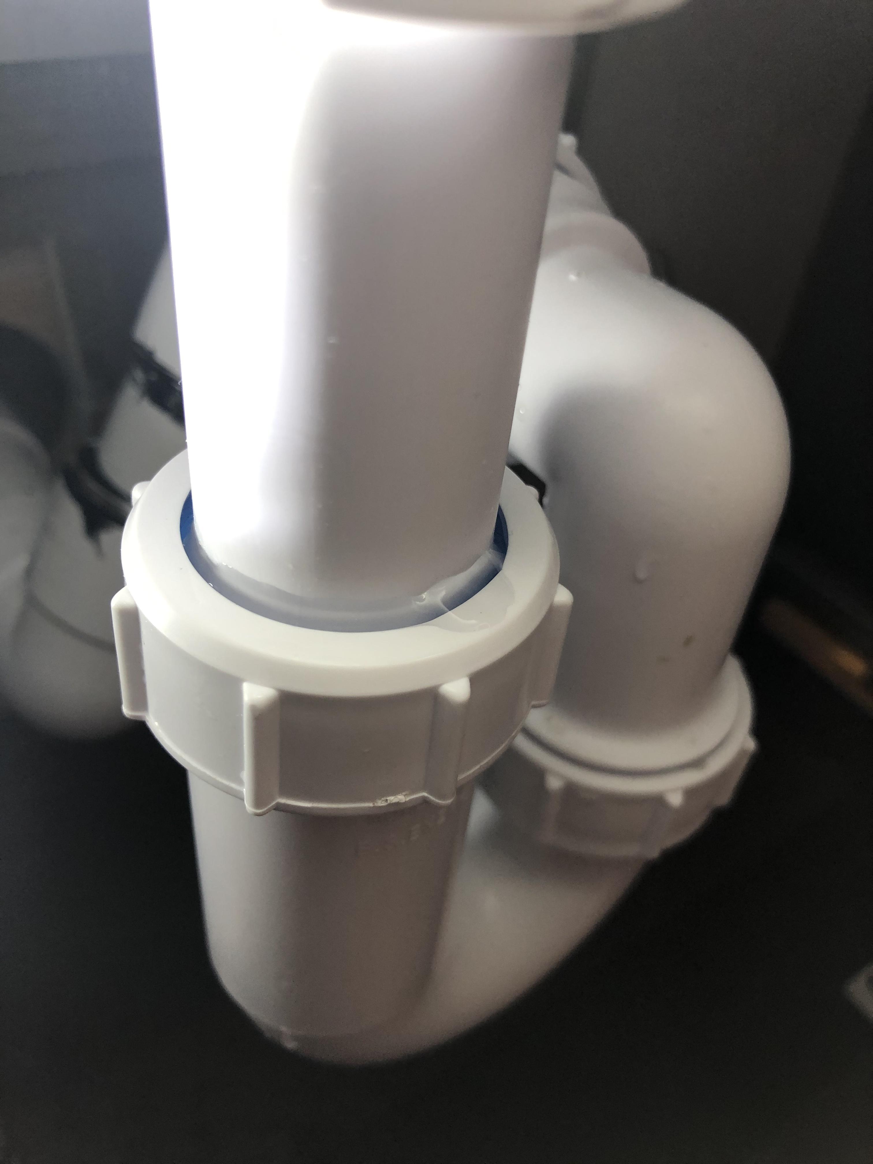

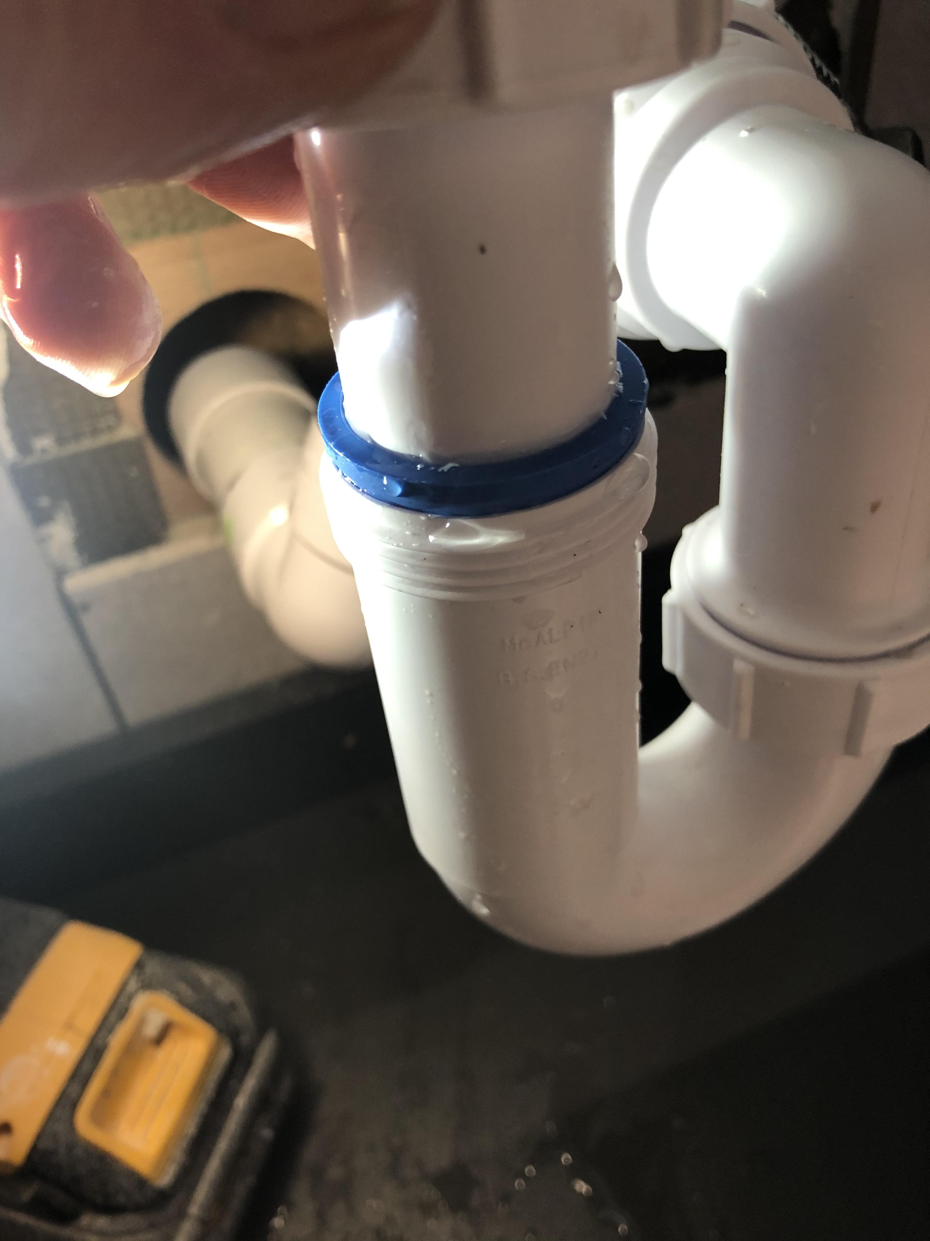

Base of telescopic trap seems to leak - I can’t hand tighten it anymore . Reluctant to stick grips on it ...
Are you sure it’s not running down from above?, that joint is above the water level In the trap (try a smear of Vaseline on the blue bit).
Could be - so hard to tell . Could just ct1 the nuts off the fitting to the sink like I did on the other one . Probably best to do that anyway

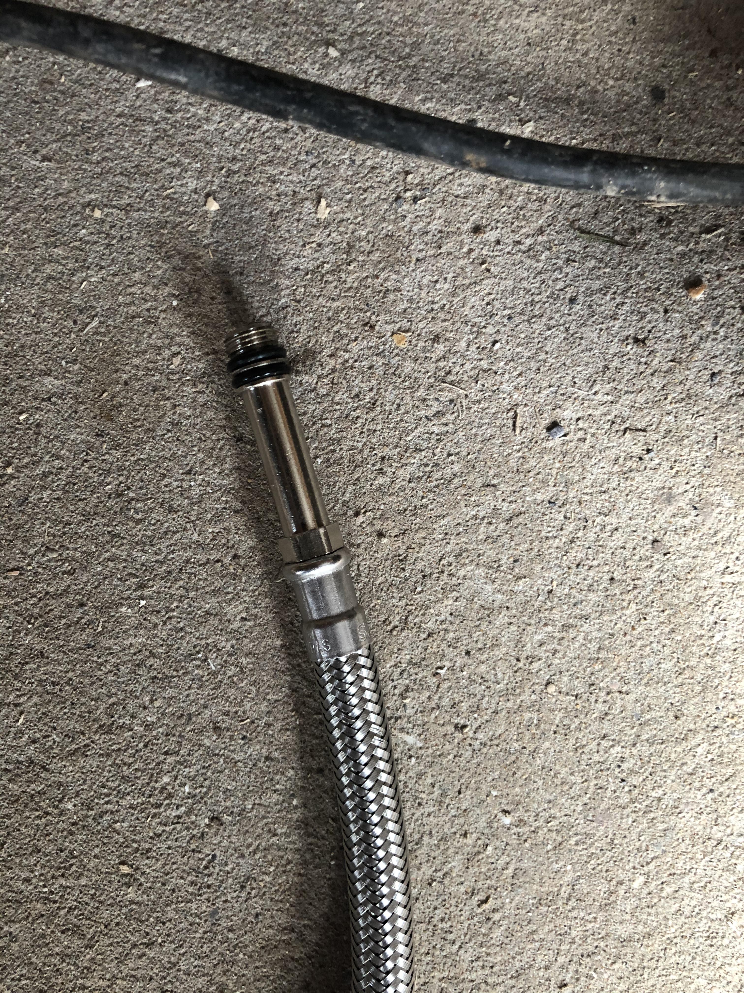

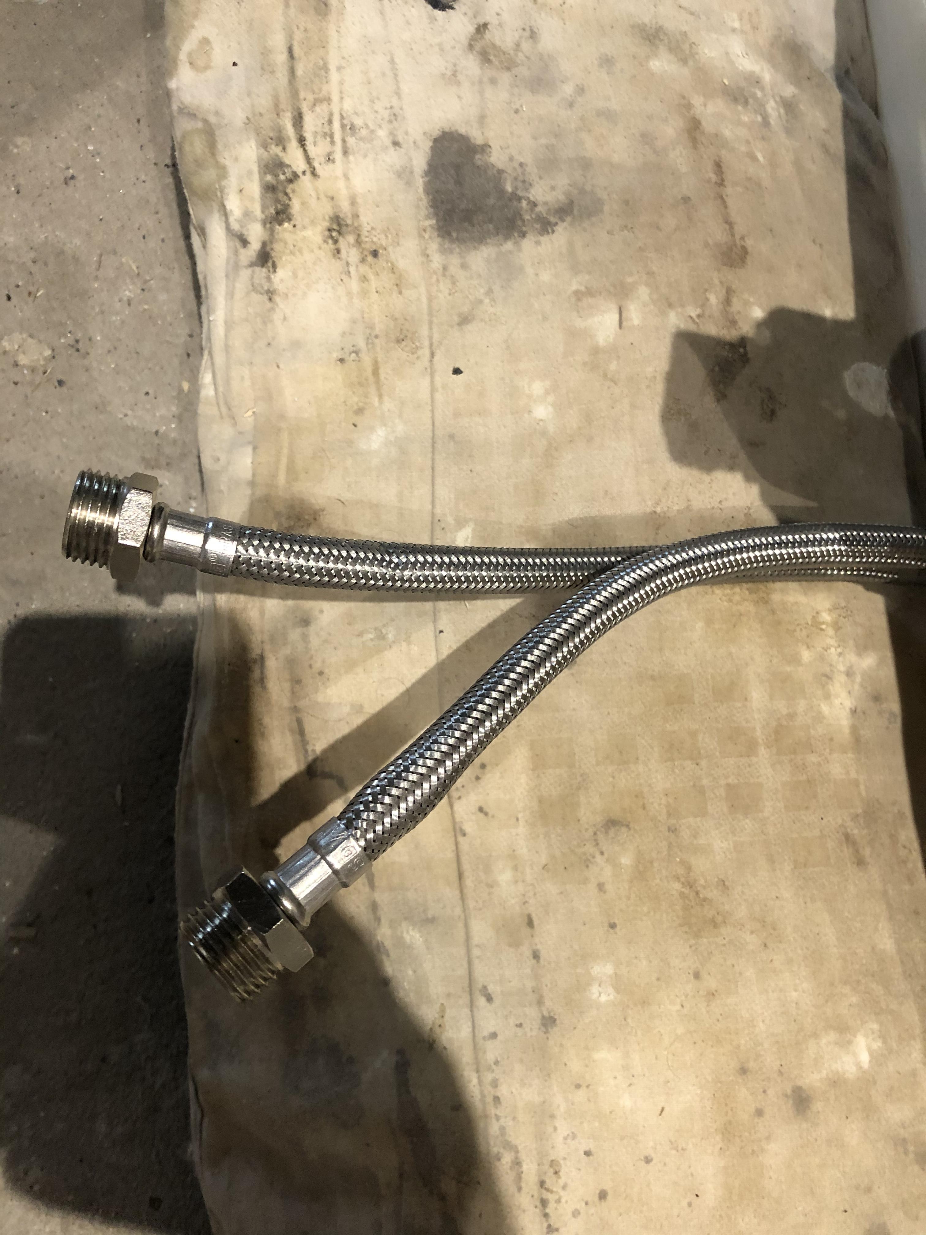

Struggled to get the olives off the Hep2o - bent them a bit - assume that’s not critical ? They will compress ok when I put them back on ?
Flexi has a slight kink - does it really matter ??
Always use new olives (ask me how I know ?).
Decided I don’t like these supplied flex’s . Too short - And I don’t like the olive end
Yeah . Decided I don’t like olives ?.
Will find a longer olive free flexi ....

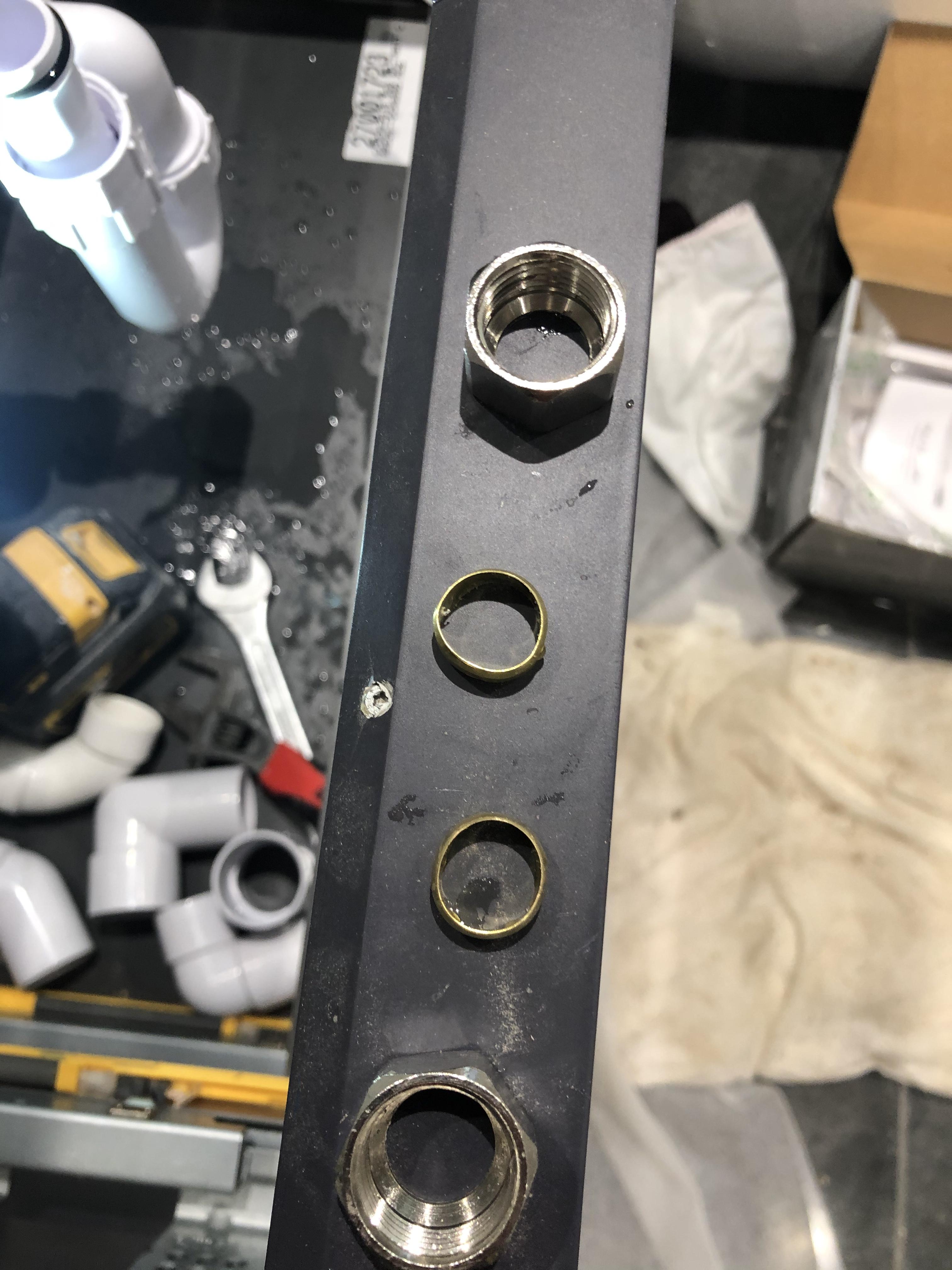

Looks like the compression ring is missing. Should be a thin plastic ring that sits on top of the rubber seal below the nut to stop the nut tearing the ring.
What brand are these ...?
Came with the taps - Roper Rhodes
My vote is with Peter. You have lost the compression ring you tart.
Found those missing geberit bits ! Knew I kept them ! Strategically hidden in the letterbox box ffs !!
Maybe ! But to loose both ? - possibly !
