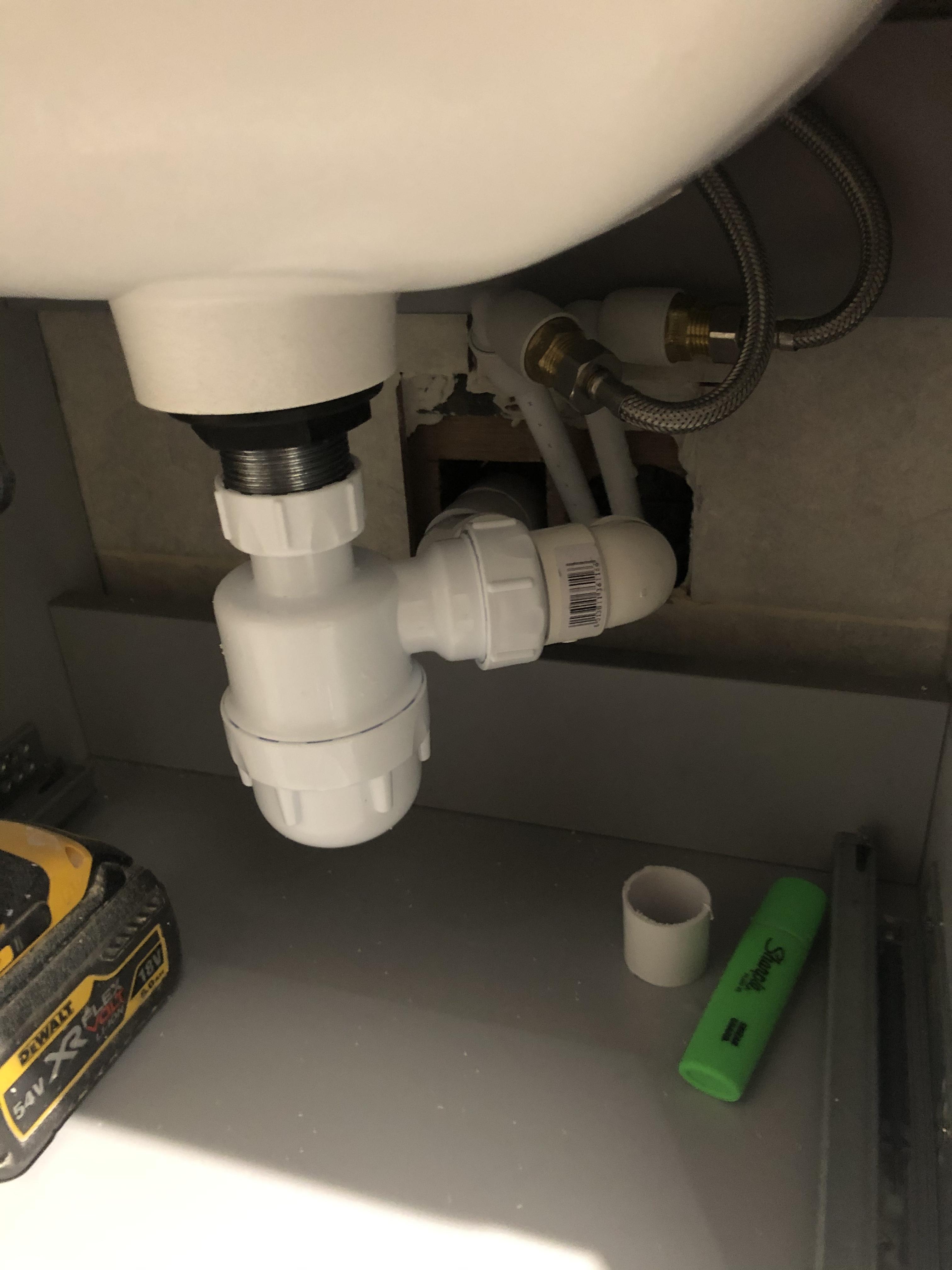

Gone West Posted January 19, 2021 Posted January 19, 2021 3 minutes ago, pocster said: Don’t know ! How shallow are they . I did like the telescopic one - makes life easier Don't know if they do telescopic shallow bottle traps, don't see why not. They are better than a P trap. https://www.screwfix.com/p/floplast-shallow-bottle-trap-white-32mm/14737 1
Pocster Posted January 19, 2021 Author Posted January 19, 2021 10 minutes ago, PeterStarck said: Don't know if they do telescopic shallow bottle traps, don't see why not. They are better than a P trap. https://www.screwfix.com/p/floplast-shallow-bottle-trap-white-32mm/14737 That’s certainly worth a look !! ?
Pocster Posted January 19, 2021 Author Posted January 19, 2021 16 minutes ago, PeterStarck said: Don't know if they do telescopic shallow bottle traps, don't see why not. They are better than a P trap. https://www.screwfix.com/p/floplast-shallow-bottle-trap-white-32mm/14737 https://www.toolstation.com/wirquin-neo-air-telescopic-bottle-trap/p58875?store=L9&utm_source=googleshopping&utm_medium=feed&utm_campaign=googleshoppingfeed&gclid=CjwKCAiAo5qABhBdEiwAOtGmbgITKW8J_wSpU3BtAf0diKIgYBN19dpALUSSAsIXNr37f315w2ZcXRoCWU0QAvD_BwE
Russell griffiths Posted January 19, 2021 Posted January 19, 2021 I’m not sure if I’m looking at this funny, but what is that long telescopic bit between the waste and trap. (expletive deleted) that off in the bin fit the trap up tight chuck that nasty compression fitting that is in the wall in the same place you threw the trap join the new trap to the wall with a couple of solvent weld bends. Baboom job done.
Pocster Posted January 19, 2021 Author Posted January 19, 2021 1 minute ago, Russell griffiths said: I’m not sure if I’m looking at this funny, but what is that long telescopic bit between the waste and trap. (expletive deleted) that off in the bin fit the trap up tight chuck that nasty compression fitting that is in the wall in the same place you threw the trap join the new trap to the wall with a couple of solvent weld bends. Baboom job done. I did a poo poo . The waste outlet on the wall is 40mm so I need a compression reducer to get it to 32mm . Prefer compression at this point as it’s all accessible . Once i solvent weld anything off the 40mm I’m committed
Gav_P Posted January 19, 2021 Posted January 19, 2021 3 minutes ago, pocster said: I did a poo poo . The waste outlet on the wall is 40mm so I need a compression reducer to get it to 32mm . Prefer compression at this point as it’s all accessible . Once i solvent weld anything off the 40mm I’m committed https://www.screwfix.com/p/floplast-reducers-40-x-32mm-white-5-pack/63577
Pocster Posted January 19, 2021 Author Posted January 19, 2021 1 minute ago, Gav_P said: https://www.screwfix.com/p/floplast-reducers-40-x-32mm-white-5-pack/63577 Sure thing . I could stick that in the wall outlet .But I’ve still got limited space to get that higher so the trap is higher ( so not hitting the drawer ) .
Pocster Posted January 19, 2021 Author Posted January 19, 2021 Thinking ( not on site ) If I put a solvent weld reducer in then a 90 degree tee . Length of vertical pipe - another 90 degree tee welded on the top . Would allow the trap to be higher and avoid the drawer . It might fit ....
Russell griffiths Posted January 19, 2021 Posted January 19, 2021 4 minutes ago, pocster said: Thinking ( not on site ) If I put a solvent weld reducer in then a 90 degree tee . Length of vertical pipe - another 90 degree tee welded on the top . Would allow the trap to be higher and avoid the drawer . It might fit .... Told ya. 1
Pocster Posted January 19, 2021 Author Posted January 19, 2021 2 minutes ago, Russell griffiths said: Told ya. Yeah - don’t count your chickens yet ! I was trying to do it all compression so it’s easy to change / fix later ... Will get parts tomorrow and we will see . Got to laugh at the amateurs - rip the wall apart / hack the cabinet - (expletive deleted)ing bodgers ! ? www.forum.buildbodge.org.uk
joe90 Posted January 19, 2021 Posted January 19, 2021 2 hours ago, pocster said: . I did like the telescopic one - makes life easier Yes, I like them as well but it looks like yours is fully extended because of the height of the pipe coming out of the wall ?

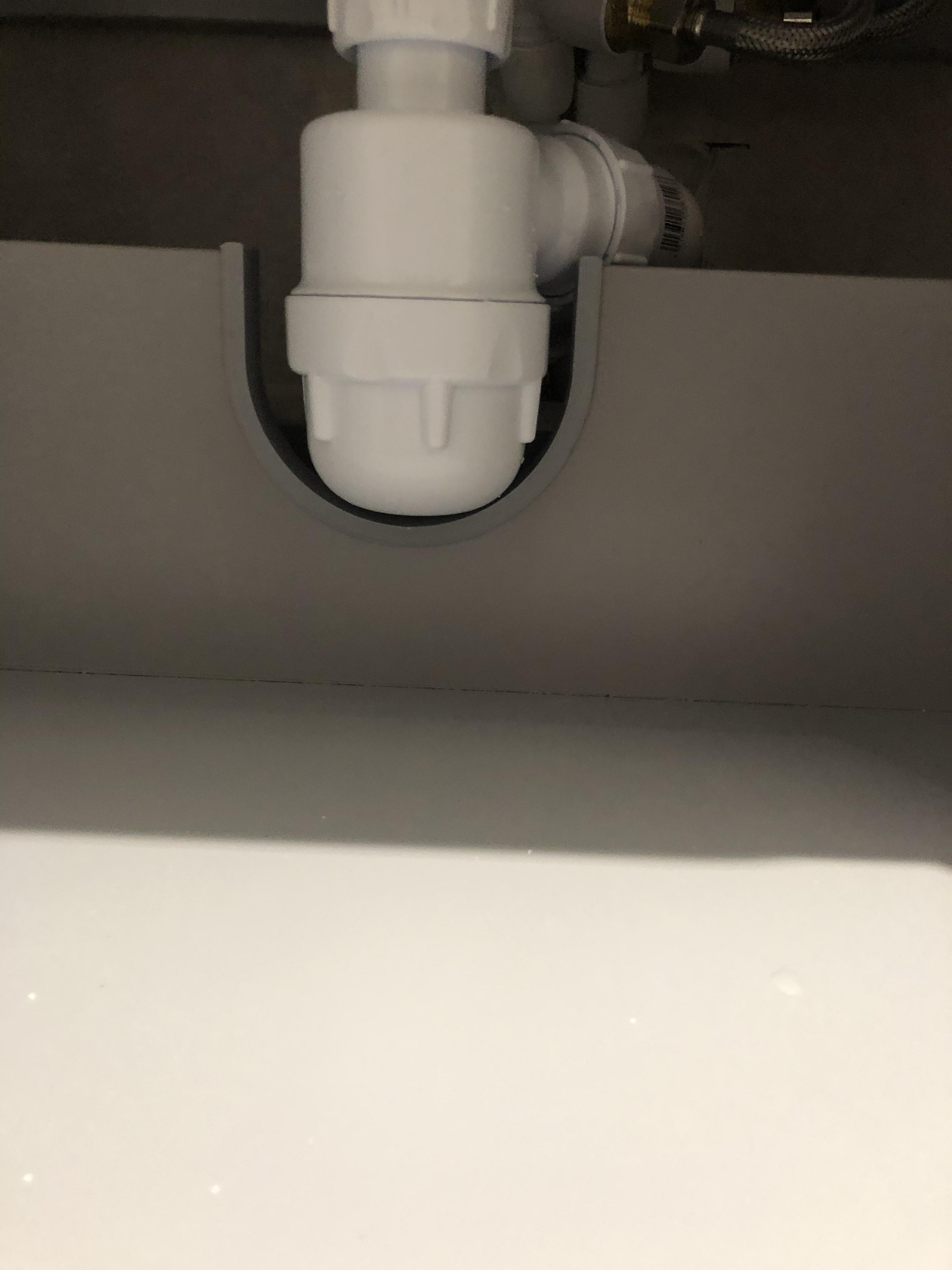

Pocster Posted January 20, 2021 Author Posted January 20, 2021 Think I’ve solved it . Was far fiddler than I thought . Nothing glued yet !! Compact bottle trap - and some very tight fittings ....
ProDave Posted January 20, 2021 Posted January 20, 2021 Does the drawer close? If so that should do nicely. 1

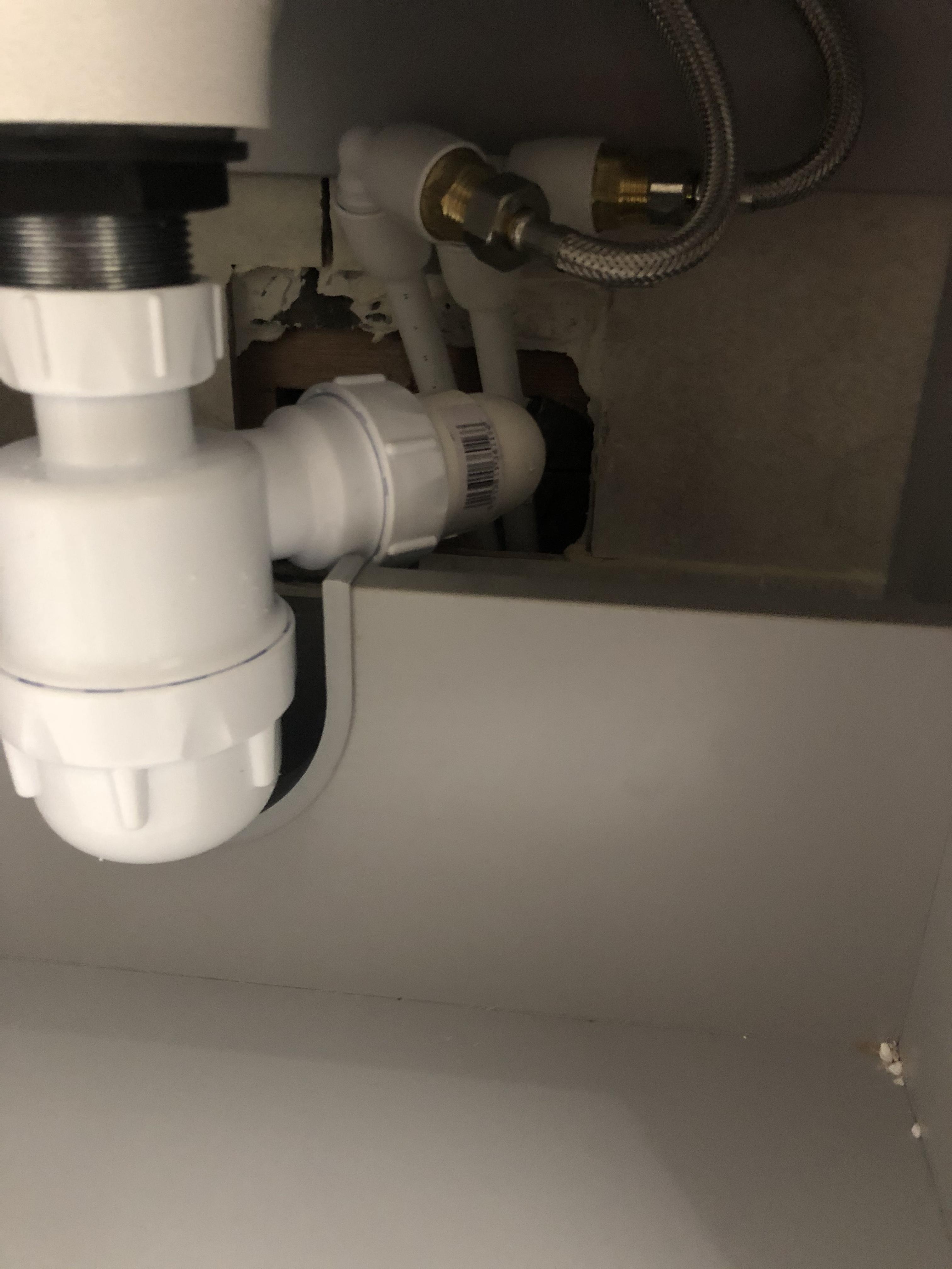

Pocster Posted January 20, 2021 Author Posted January 20, 2021 You b a s t a r d !! Fitting just catches the drawer - can’t angle it any further . Bottle trip clears by 1 mm ?
Pocster Posted January 20, 2021 Author Posted January 20, 2021 Tempted to cut the corner off the cabinet

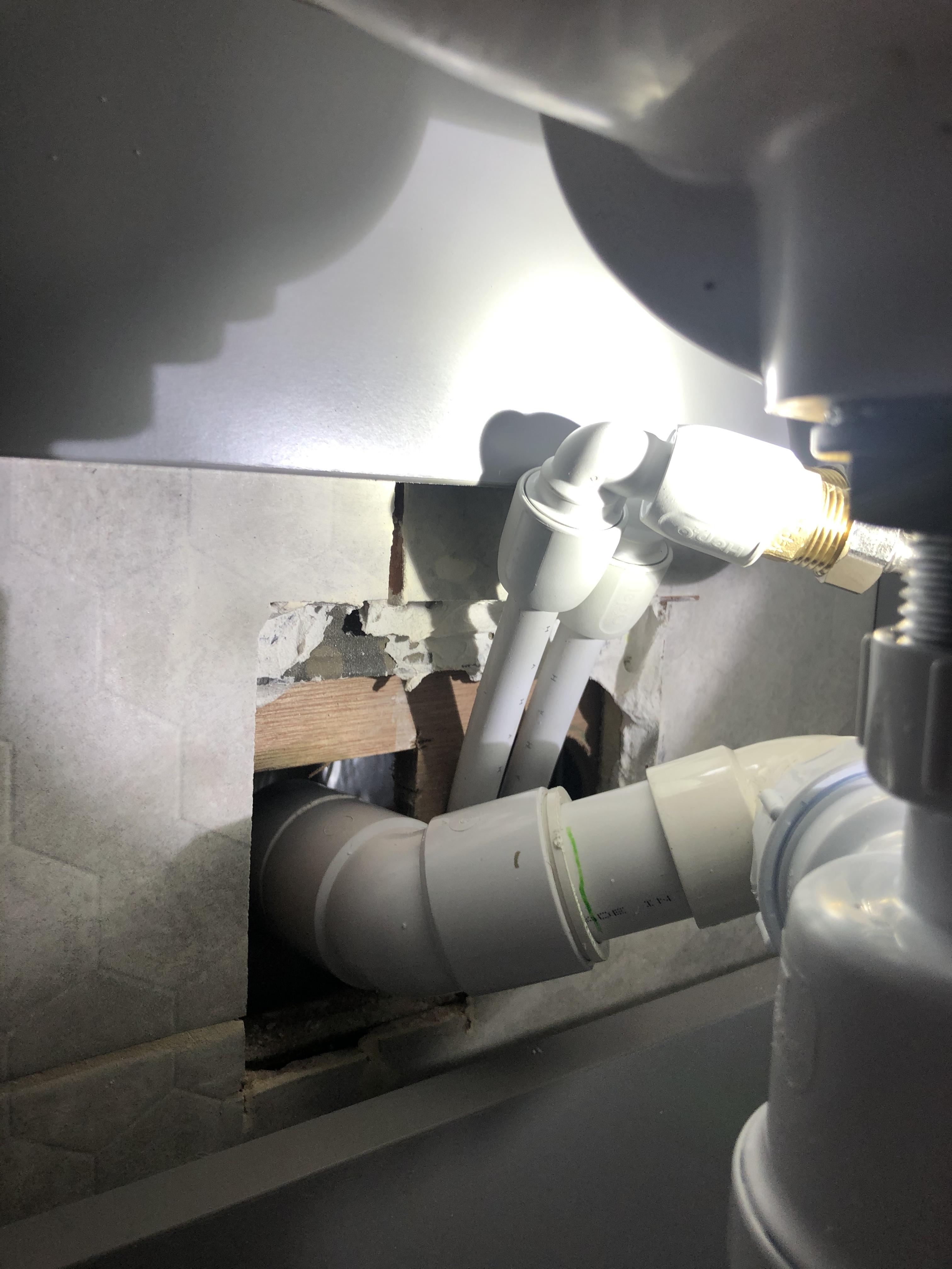

joe90 Posted January 20, 2021 Posted January 20, 2021 Can you not get another 135’ bend on instead of that 90’ bend?, all in line then???.
Pocster Posted January 20, 2021 Author Posted January 20, 2021 (edited) 29 minutes ago, joe90 said: Can you not get another 135’ bend on instead of that 90’ bend?, all in line then???. Nah . Another 135 and they are too far out of alignment. I’m ‘bending’ the 40mm outlet pipe to the max as it is . Edited January 20, 2021 by pocster
Onoff Posted January 20, 2021 Posted January 20, 2021 I'd remove the plastic U trim and get a bit of iron on grey trim. Heat it up and apply with a wallpaper seam roller. Actually.....I'd remove the plastic U trim. Clamp a sacrificial board to the drawer back. Drill a tad deeper with the appropriate sized Starrett. Refit the trim. ?
Pocster Posted January 20, 2021 Author Posted January 20, 2021 1 hour ago, Onoff said: I'd remove the plastic U trim and get a bit of iron on grey trim. Heat it up and apply with a wallpaper seam roller. Actually.....I'd remove the plastic U trim. Clamp a sacrificial board to the drawer back. Drill a tad deeper with the appropriate sized Starrett. Refit the trim. ? Trim peeled off before I left for the day . Just a few mm ffs !!! When they design these cabinets I guess they really don’t think about getting the trap and pipework in - bloody idiots !!
