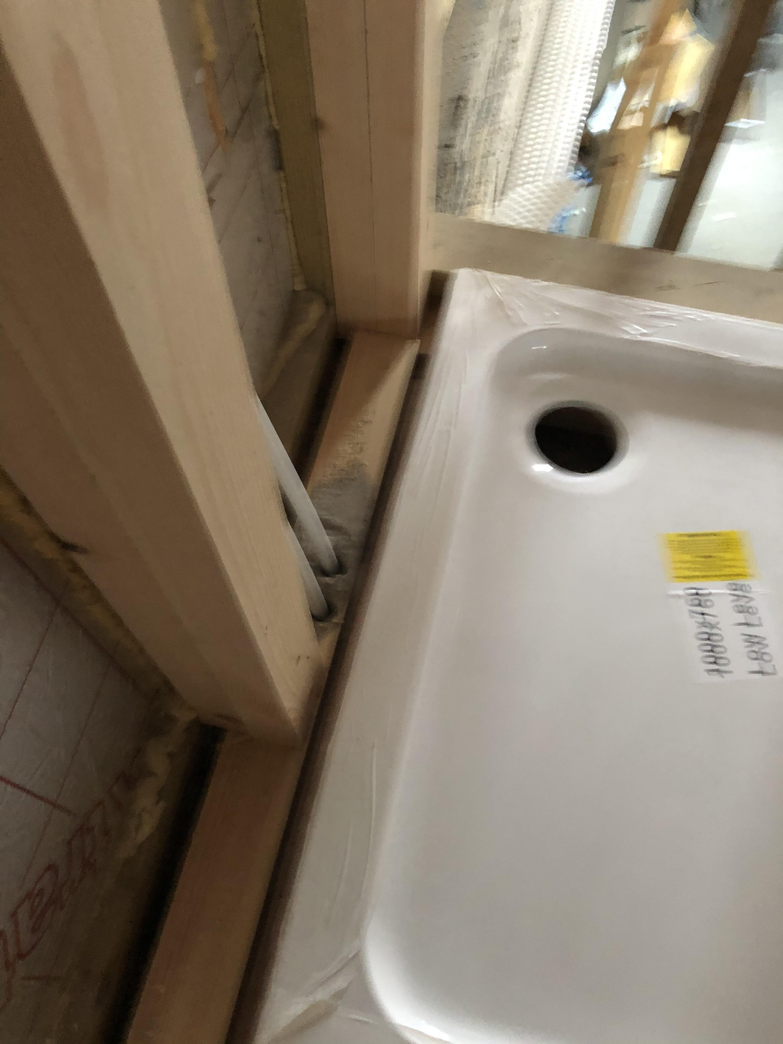

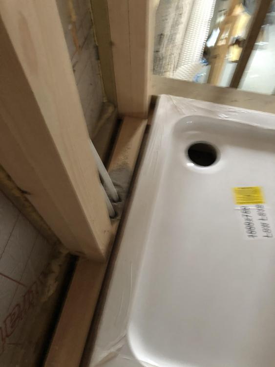

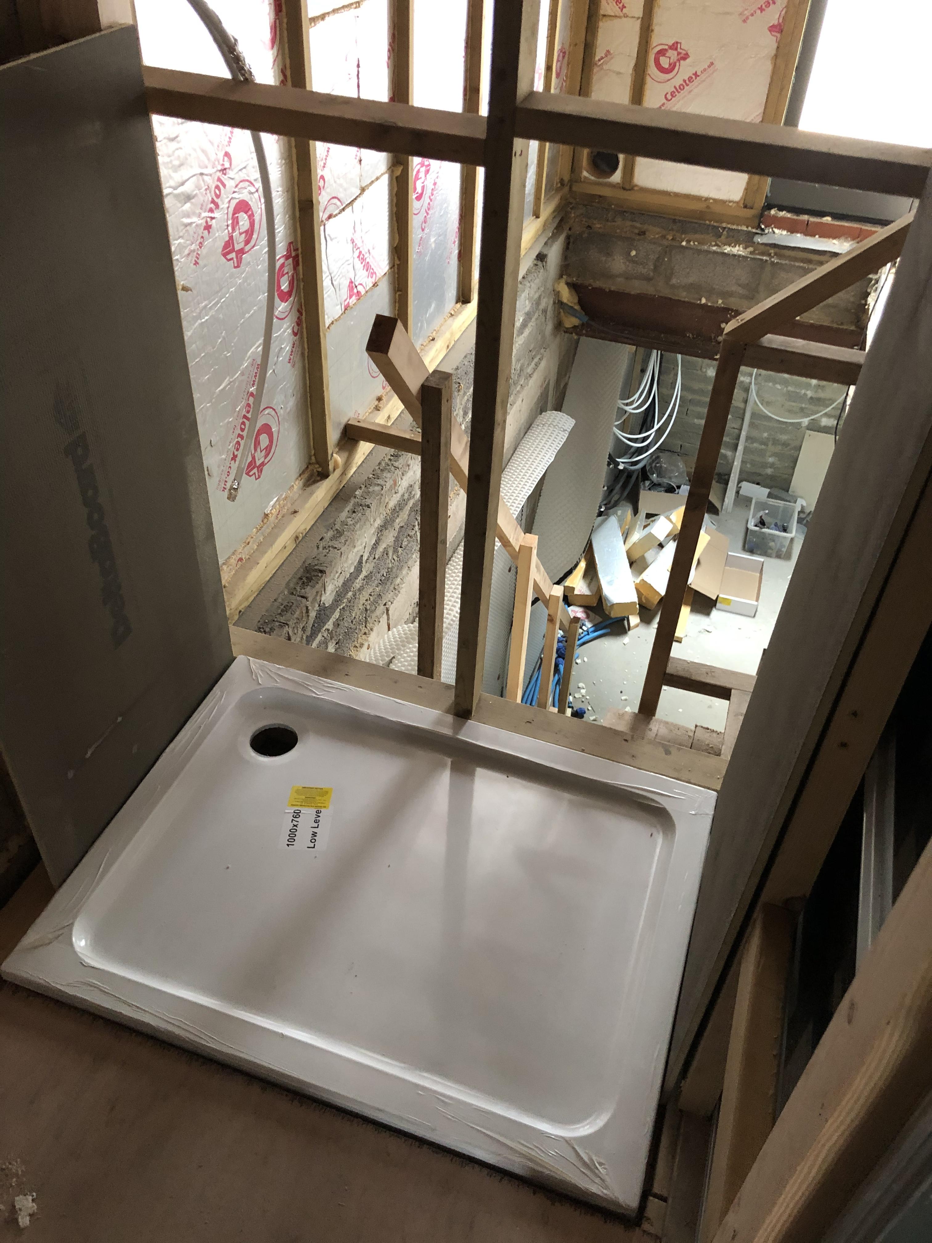

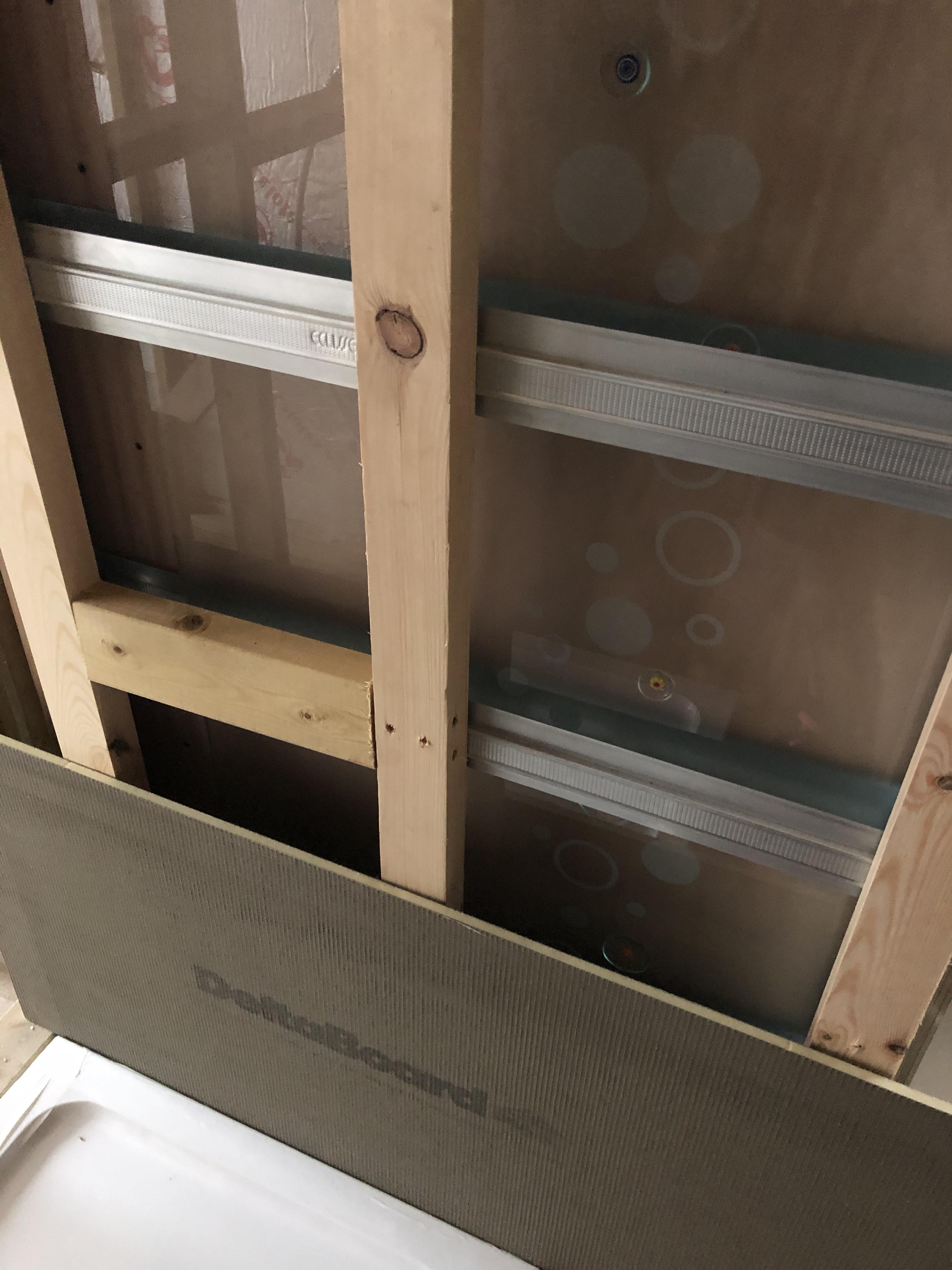

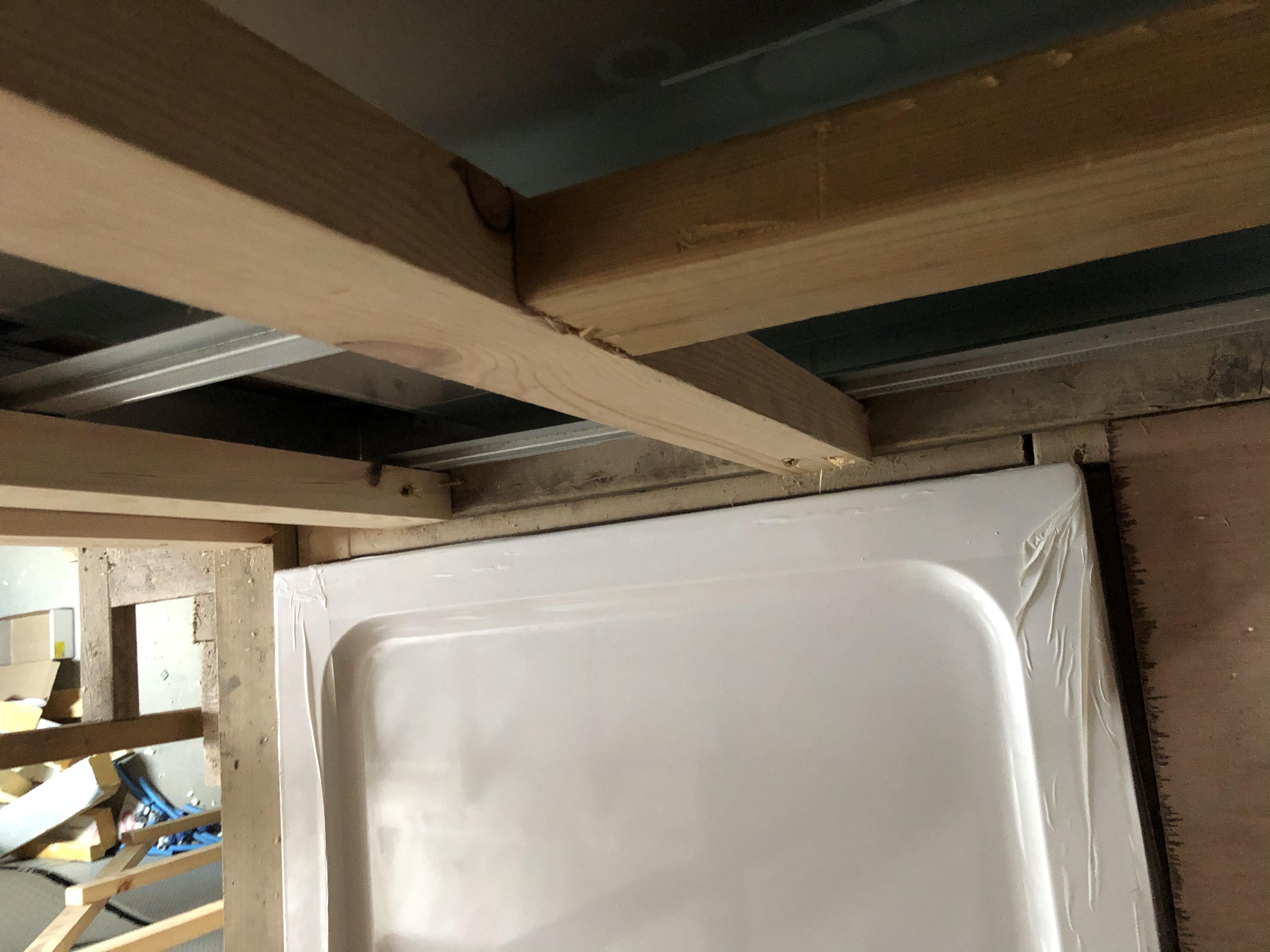

Pocster Posted April 2, 2020 Author Posted April 2, 2020 Timbered around the f ing sliding door . Put the tray in dry to test . Going to be a bit too tight . Marine ply ontop Walls (12mm) then delta tile backer board . Trays not going to fit ( see space left and right of tray ) . What can I do ? Can I cheat a bit and have tile backer board just down to the tray edge ? I.e not down the sides to the floor ? - that allowed ?? (Saves 8mm per side )
Pocster Posted April 2, 2020 Author Posted April 2, 2020 I think @nod said forget the marine ply and just screw delta board direct to studs . I like marine ply because it’s strong and makes fixing anything else easy . Could just delta board it , staggered , taped joints .

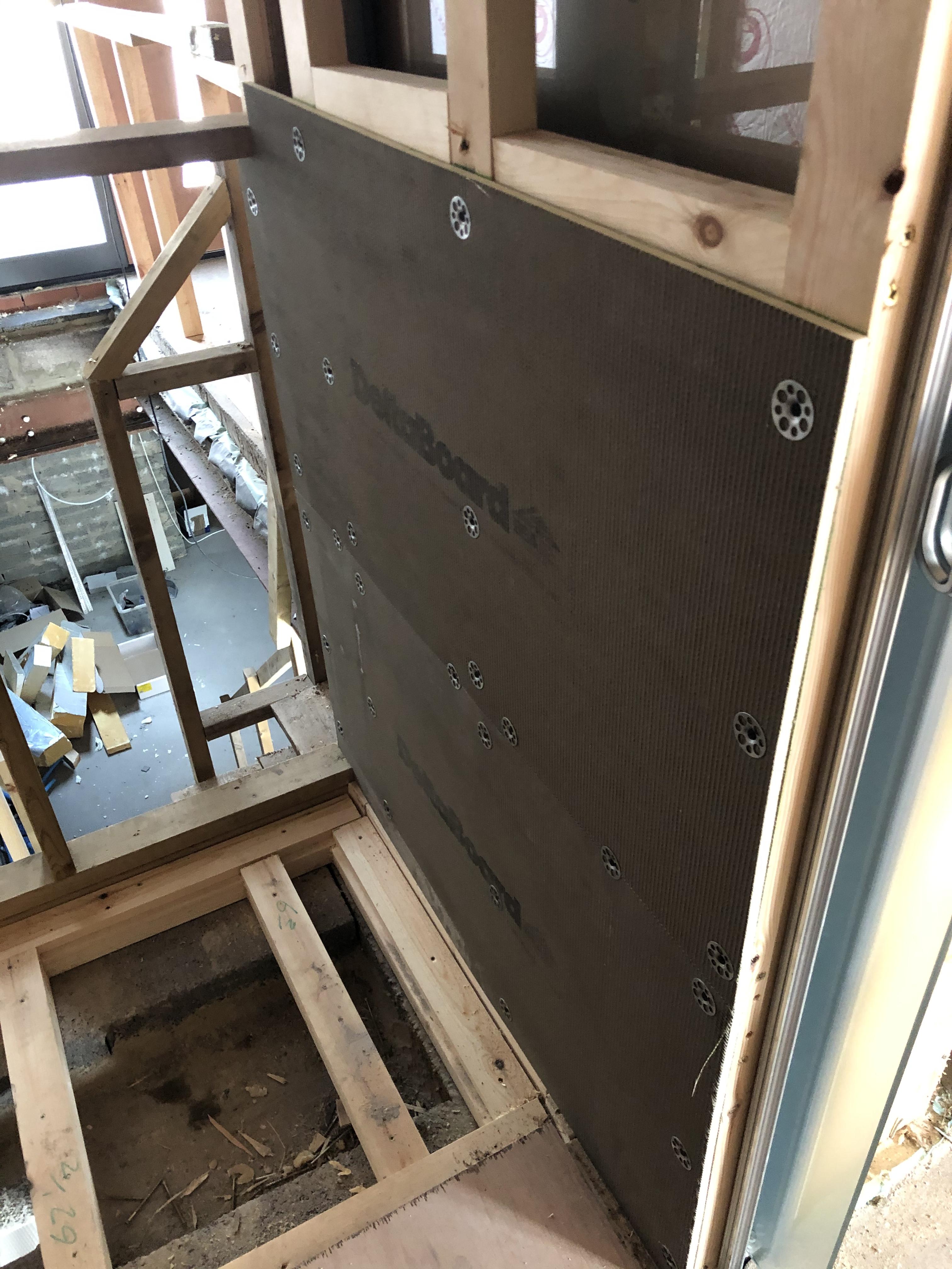

Pocster Posted April 2, 2020 Author Posted April 2, 2020 This thread So to save space and marine ply - will go with delta board . Will add noggins at joints

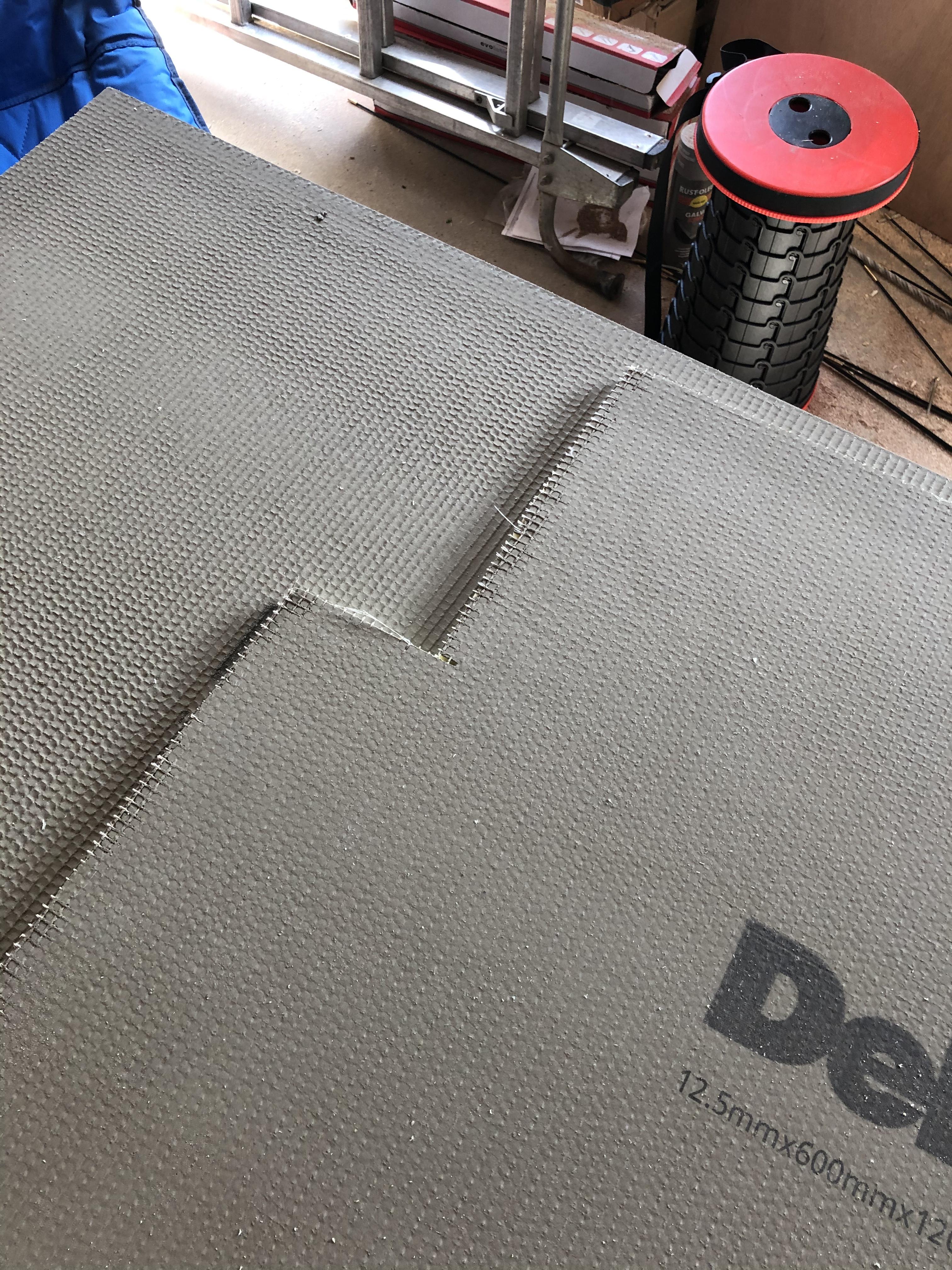

Pocster Posted April 2, 2020 Author Posted April 2, 2020 A horizontal delta board covers this wall . Assume no need to deliberately cut and stagger ? Or should I ? Right - flipped a coin , will cut and stagger .
nod Posted April 2, 2020 Posted April 2, 2020 11 minutes ago, pocster said: I think @nod said forget the marine ply and just screw delta board direct to studs . I like marine ply because it’s strong and makes fixing anything else easy . Could just delta board it , staggered , taped joints . When I’m adding strength to MF Bathrooms or otherwise I just have a pack of 12.5 delivered to site direct from the saw mil Usually works out around £8 a sheet If the water was to get as far as the ply You are stuffed even if it is marine ply Once over most our jobs involved MP Wouldn’t like to think what price it is now 1
nod Posted April 2, 2020 Posted April 2, 2020 5 minutes ago, pocster said: A horizontal delta board covers this wall . Assume no need to deliberately cut and stagger ? Or should I ? Right - flipped a coin , will cut and stagger . If your boards span edge to edge you don’t need to stagger for the sake of it But if they don’t Then stagger You will be surprised how solid the walls feel once they have tiles on 1
Pocster Posted April 2, 2020 Author Posted April 2, 2020 2 minutes ago, nod said: When I’m adding strength to MF Bathrooms or otherwise I just have a pack of 12.5 delivered to site direct from the saw mil Usually works out around £8 a sheet If the water was to get as far as the ply You are stuffed even if it is marine ply Once over most our jobs involved MP Wouldn’t like to think what price it is now So just delta then . I did think that . Marine ply or plaster board underneath- if the waters there it’s a problem anyway .

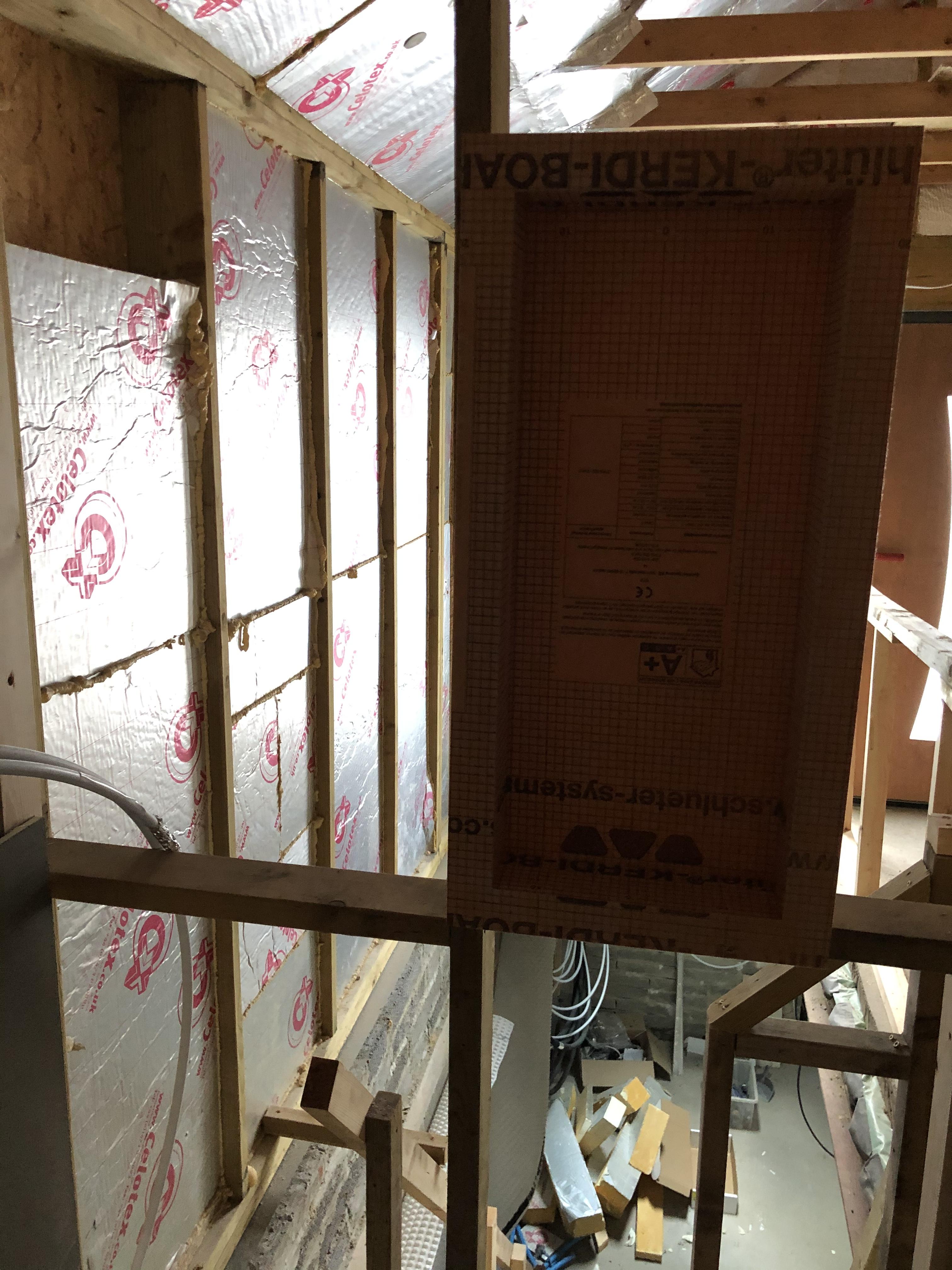

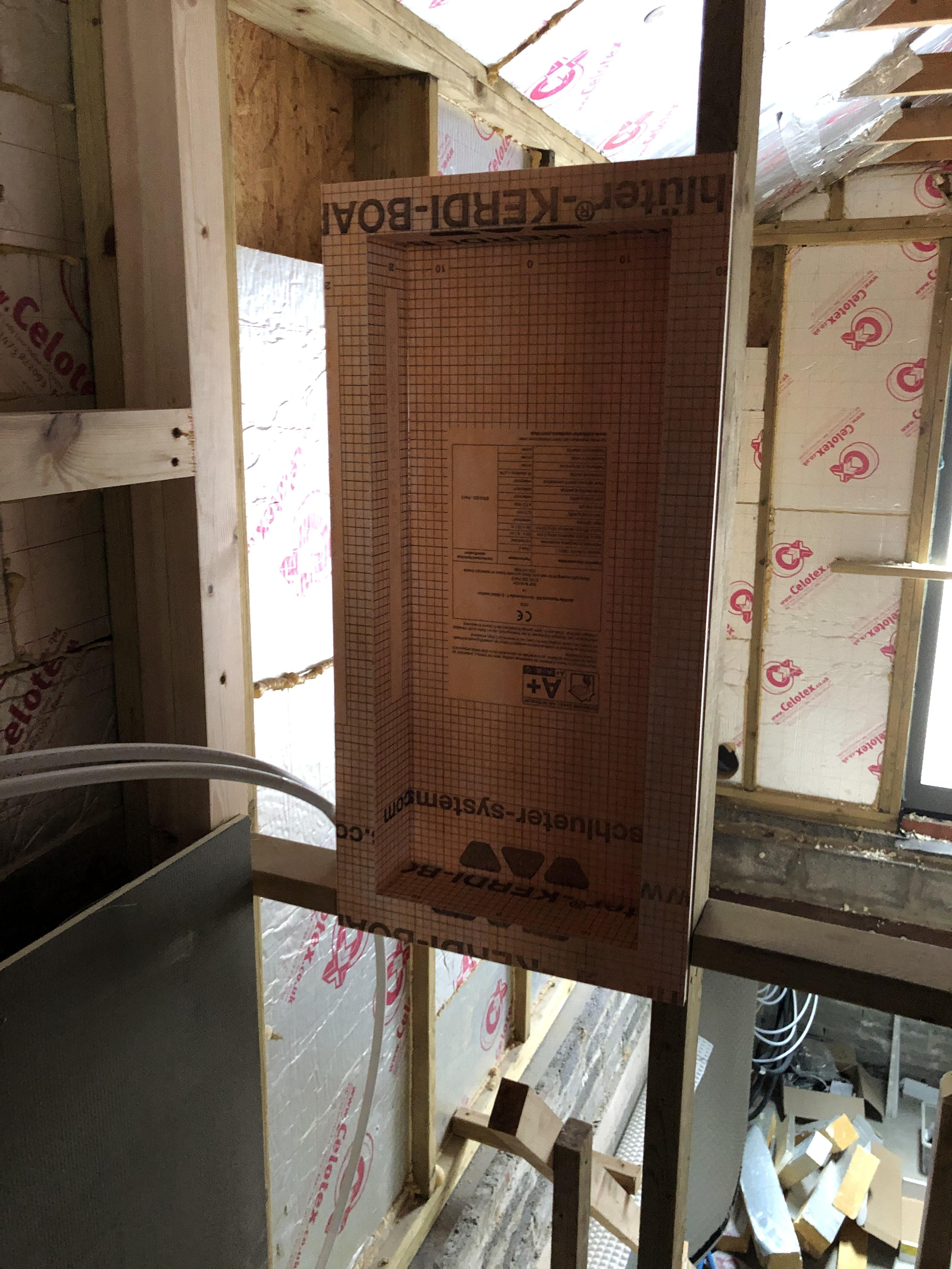

Pocster Posted April 2, 2020 Author Posted April 2, 2020 So ! Showers going to the left . Recess left or right ? I.e in shower wet zone or not ? ; can’t decide . Or lay this horizontal and have it half in and half out !!
BotusBuild Posted April 2, 2020 Posted April 2, 2020 In? Out? Shake it all about! Do the hokey cokey, and turn it round? That's what this building lark is all about In for me - somewhere to put the shampoo ? 1

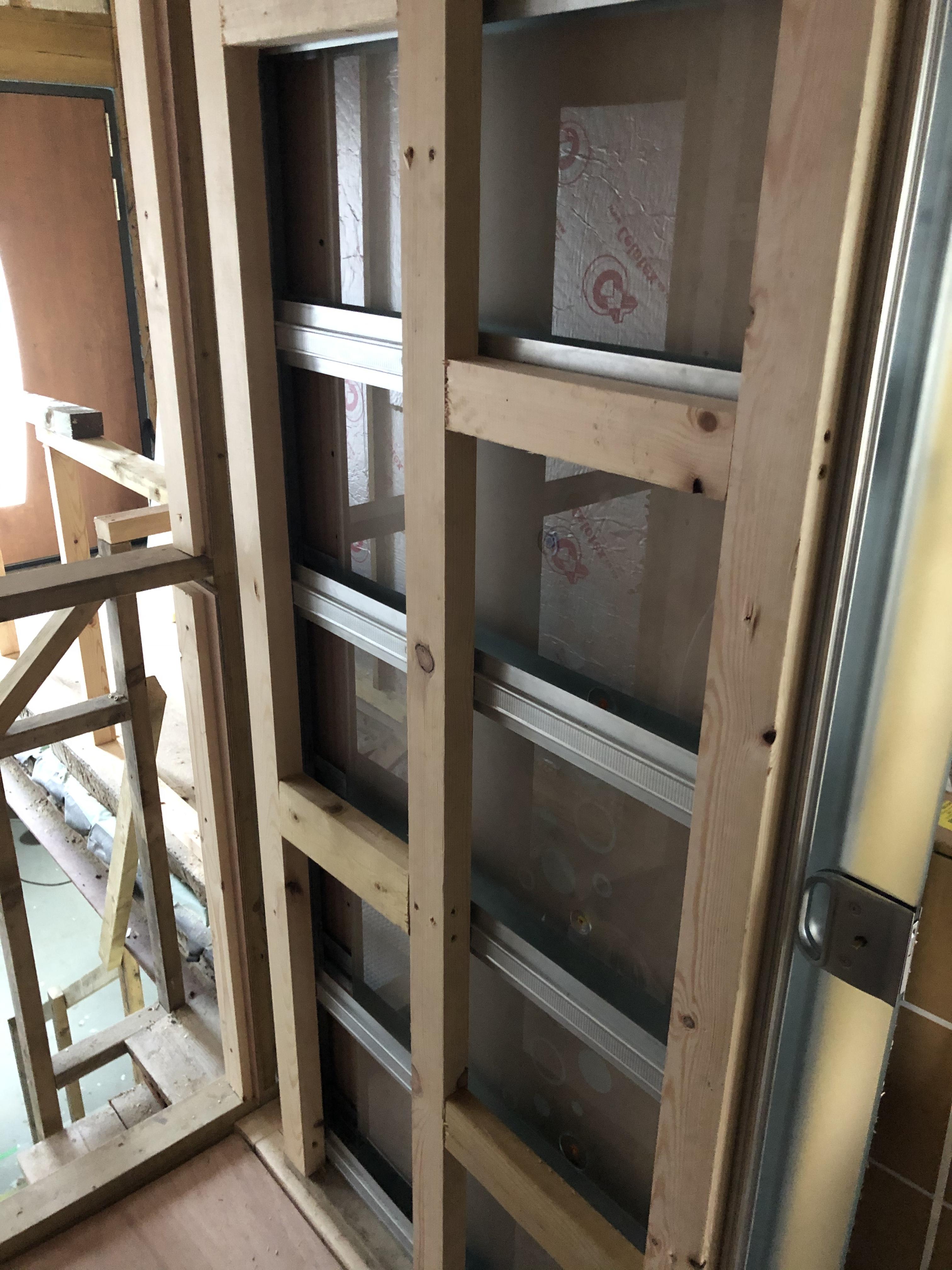

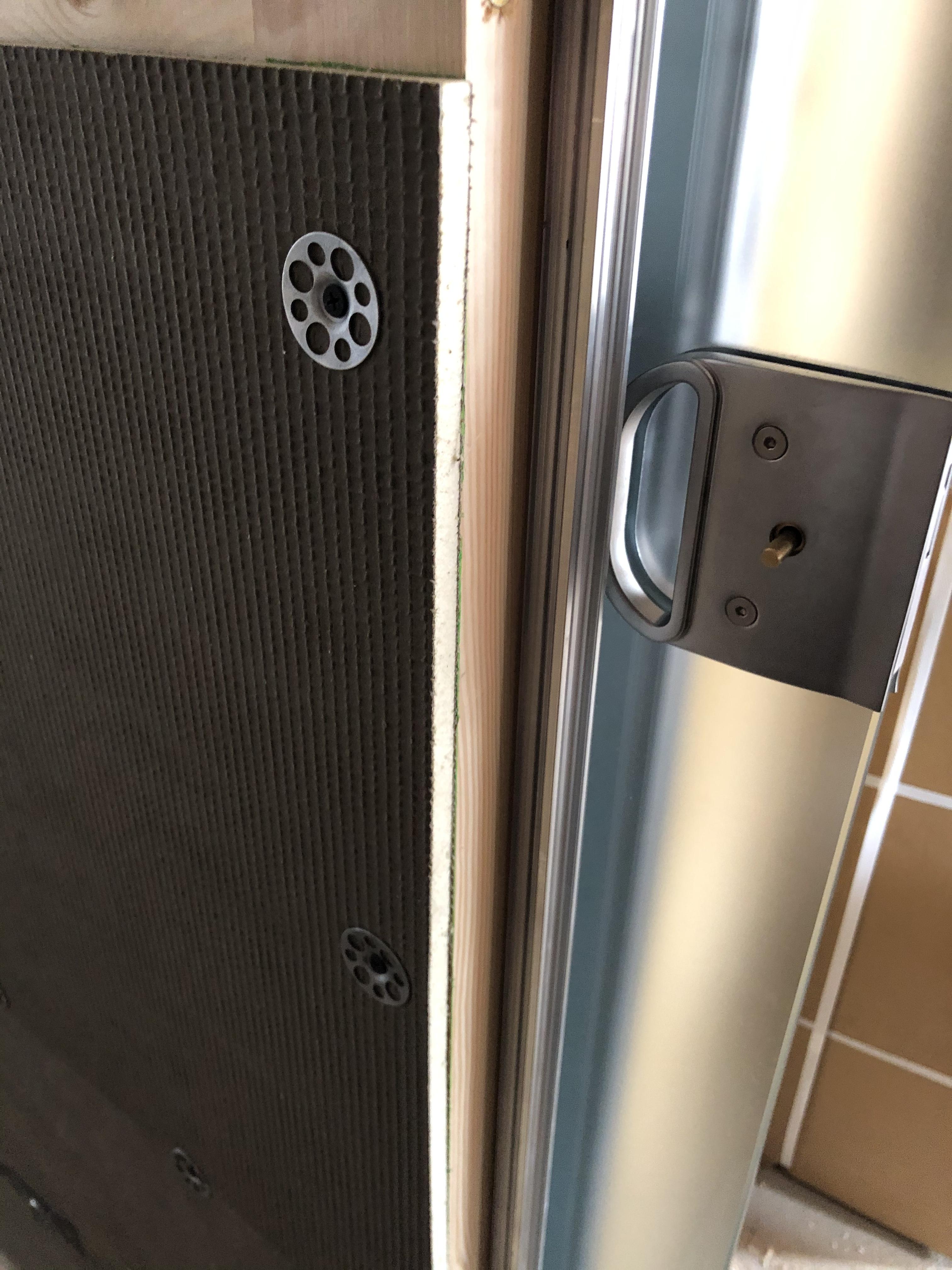

Pocster Posted April 3, 2020 Author Posted April 3, 2020 Like the delta board fixings . Not sure about the ‘special’ screws , sure they are just drywall screws . Anyway , any suggestions what I do at this door frame edge ? . If I delta board the edge and tile it ;will stick out past the Eclisse ( grrrrr ) door frame . Is there some ‘mat’ that can be fixed to timber and can be tiled directly on ? ( answer cannot be ct1 ) ?
Onoff Posted April 3, 2020 Posted April 3, 2020 (edited) Why not just liquid tank that strip then tile? Edited April 3, 2020 by Onoff 1
Pocster Posted April 3, 2020 Author Posted April 3, 2020 42 minutes ago, Onoff said: Why no just liquid tank that strip then tile? Yeah ? . Please link to a liquid tank ? You can just tile straight into it ?
Onoff Posted April 3, 2020 Posted April 3, 2020 (edited) 3 minutes ago, pocster said: Yeah ? . Please link to a liquid tank ? You can just tile straight into it ? I thought you were well aware of liquid tanking systems? This is the one I used. Forms like a rubber membrane. Yes you just prime it with tile primer and tile onto it. Edited April 3, 2020 by Onoff 1

Pocster Posted April 3, 2020 Author Posted April 3, 2020 Important note ! For anyone using delta board . As I was advised ‘printed’ side out . I did have a board that appears to be printed on the wrong side . So check first . Not sure if photo will show the difference between 2 printed sides .... 1
Onoff Posted April 3, 2020 Posted April 3, 2020 2 hours ago, pocster said: Like the delta board fixings . Not sure about the ‘special’ screws , sure they are just drywall screws . Anyway , any suggestions what I do at this door frame edge ? . If I delta board the edge and tile it ;will stick out past the Eclisse ( grrrrr ) door frame . Is there some ‘mat’ that can be fixed to timber and can be tiled directly on ? ( answer cannot be ct1 ) ? Sorry but why not CT1? Or CT1 Power Grab n Bond. I stuck all the tiles to the marine ply sides of my bath. 1
