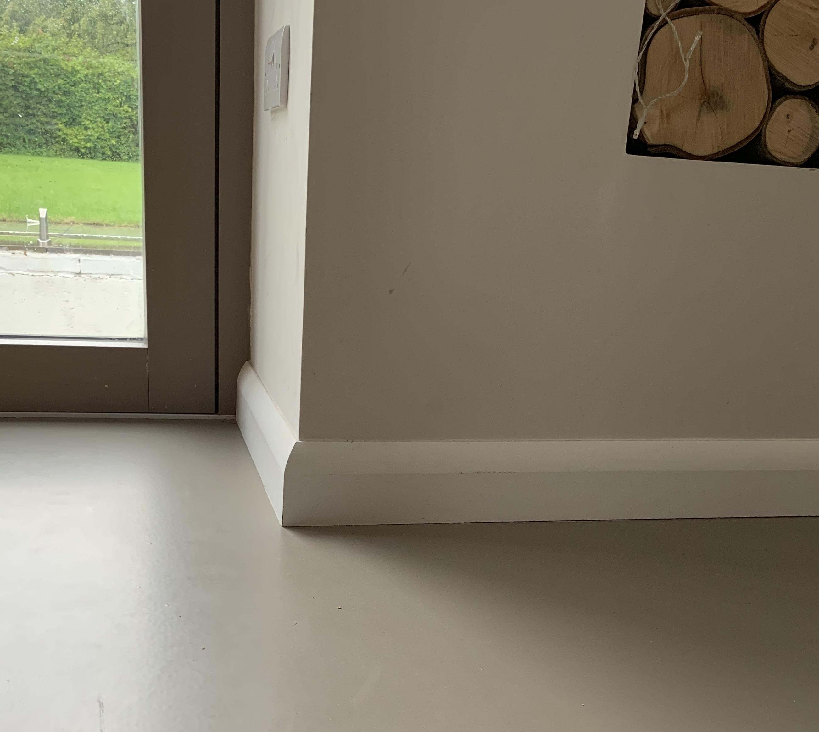

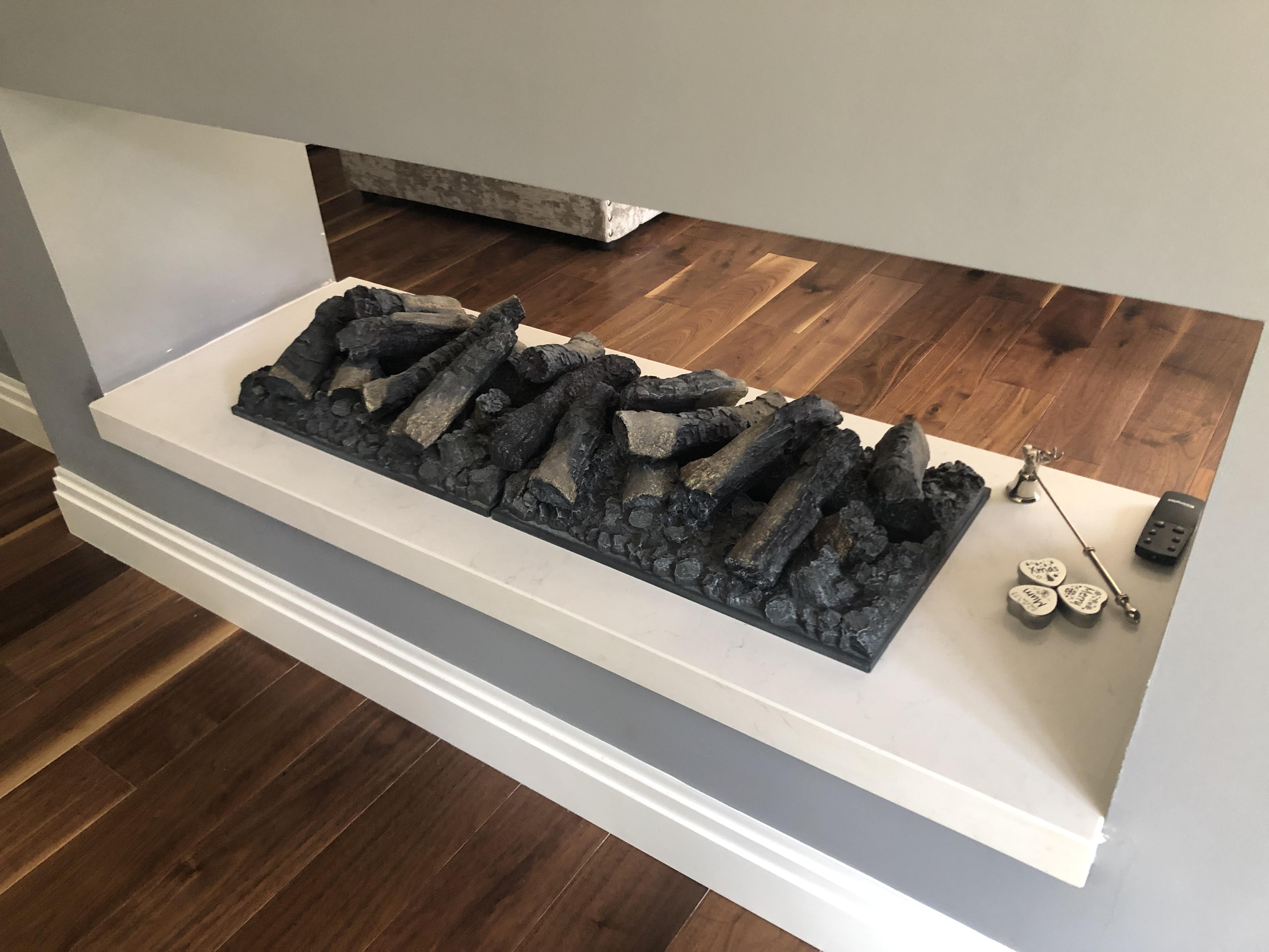

AliG Posted August 16, 2019 Posted August 16, 2019 (edited) We went for a stepped skirting board as I hate anything curved. Builders like to use curved skirting as it is harder to chip the edges so they can bash it about. I had always thought we would have wood but I decided I like the contrast between wooden doors/floors and white frames/skirting. It is way neater to put the flooring down first. I did a bit of research and it seems that a lot of the yellowing is due to using oil based gloss which goes on slightly easier for the painter. We used water based gloss which should not yellow as well as making cleaning up a lot easier when you paint. An issue we have had is that the painters did a really bad job on filling and painting the joints. The builders will have to redo quite a few of them at the 12 month point. Edited August 16, 2019 by AliG 2
canalsiderenovation Posted August 16, 2019 Author Posted August 16, 2019 Hi@AliG I love your fire! The stepped skirting is lovely but is my cleaning idea of hell! I do like the idea of the curved one posted by @Bitpipe. @Bitpipe do you have any pictures of your skirting?
AliG Posted August 16, 2019 Posted August 16, 2019 Thanks @canalsiderenovation It is an Optimyst fake fire, we just had the marble surround installed there. I need to touch in where they scraped the paint doing it. I don't know if anyone else can comment, but with no carpets at all in the house and MVHR there is vastly less dust than in previous houses. I don't know if it is the lack of carpets or MVHR that helps. The skirting boards have not needed touched since building work and the related dust ended. Indeed I just do not see the build up of dust anywhere.
lizzie Posted August 16, 2019 Posted August 16, 2019 I decided against shadow gaps for practical reasons....cleaners are bad enough chipping paintwork never mind plaster.......I went for a skirting tile. Not cheap but it gives me a cohesive look as I have the same tiles running throughout. Would have been a lot cheaper with regular skirtings or shadow gaps and the tiler hated me for the cut outs for the floor washers...had to have a special bit made to cut the hole in the porcelain skirting tile to the exact size. Nothing is easy, or perfect, or cheap!

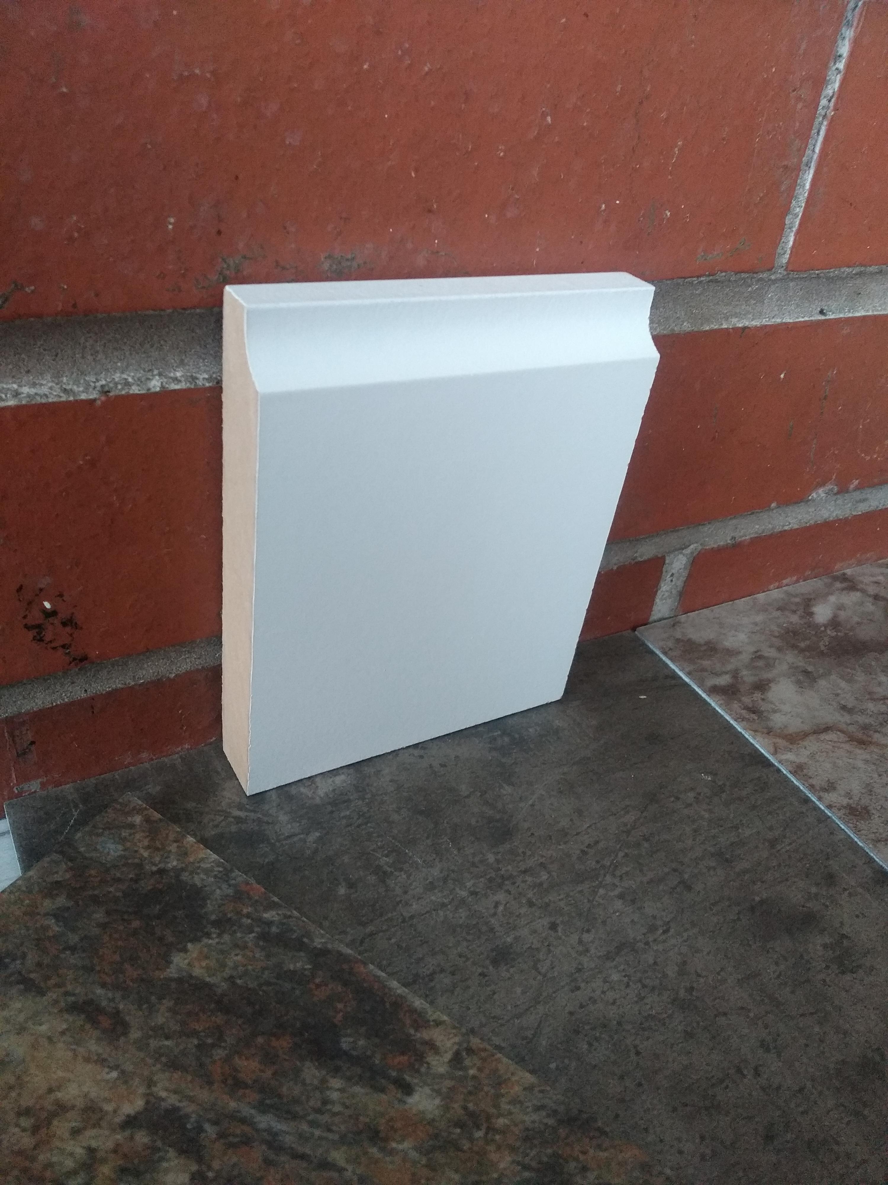

canalsiderenovation Posted August 17, 2019 Author Posted August 17, 2019 @Bitpipe today we went to our local timber yard (actually we went looking at internal doors, but ended up on a right mission at umpteen places looking at doors, kitchens, bathrooms, skirting and a whole range of other stuff and have enough brochures to wallpaper the house now)! We ended up with about 10 different samples. We really like the profile you posted and seems to be the best budget option needing as least maintenance. It only came in 7ft lengths at our local timber yard but I'm sure it would come in longer lengths elsewhere. @Ferdinand @Barney12 @lizzie our little three foster kittens have gone now so I can't blame the dust on them anymore although the ecologist found signs of mice so perhaps it's them ? I think the fact we have our windows and doors open a lot (to air the house) and there is always agriculture activity in the fields nearby (maize, combine harvesters, hay etc) that this contributes as well.

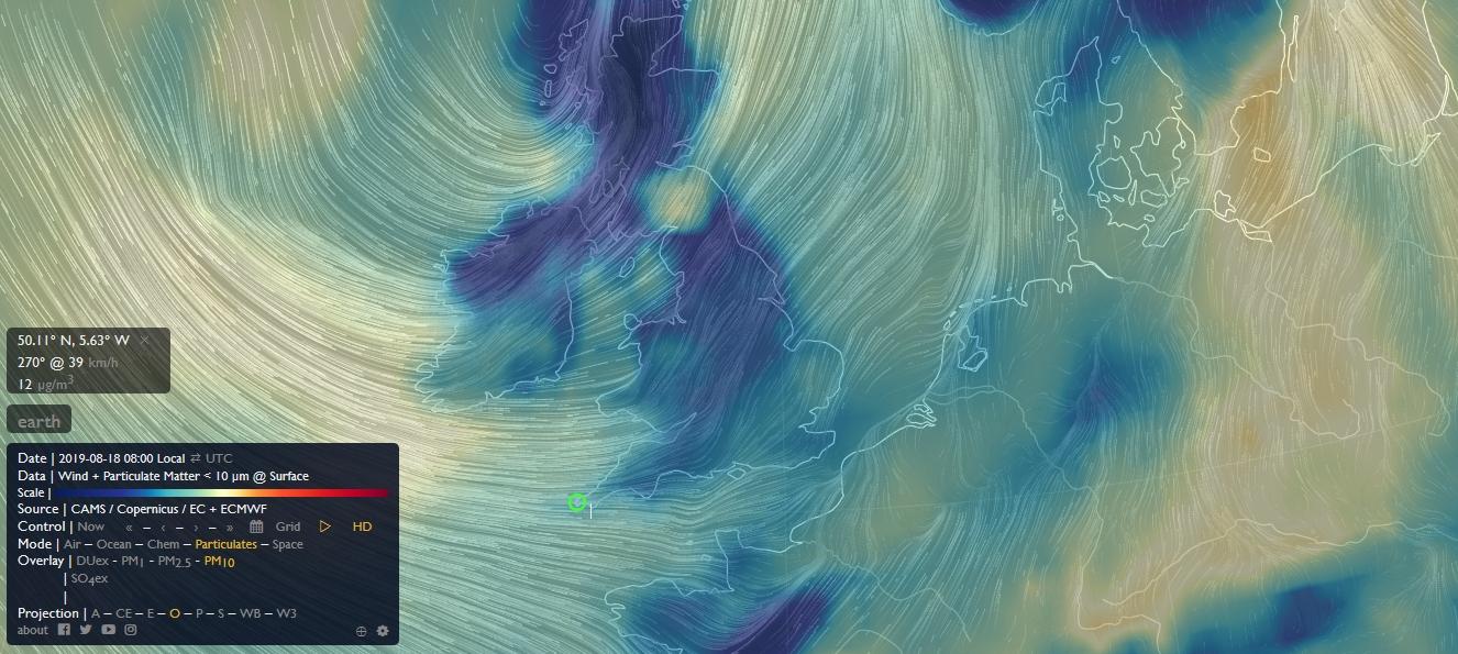

SteamyTea Posted August 18, 2019 Posted August 18, 2019 nullschool.net shows particulates across the globe. I am at 12 ug.m-3 for PM10

Bitpipe Posted August 18, 2019 Posted August 18, 2019 13 hours ago, canalsiderenovation said: @Bitpipe today we went to our local timber yard (actually we went looking at internal doors, but ended up on a right mission at umpteen places looking at doors, kitchens, bathrooms, skirting and a whole range of other stuff and have enough brochures to wallpaper the house now)! We ended up with about 10 different samples. We really like the profile you posted and seems to be the best budget option needing as least maintenance. It only came in 7ft lengths at our local timber yard but I'm sure it would come in longer lengths elsewhere. @Ferdinand @Barney12 @lizzie our little three foster kittens have gone now so I can't blame the dust on them anymore although the ecologist found signs of mice so perhaps it's them ? I think the fact we have our windows and doors open a lot (to air the house) and there is always agriculture activity in the fields nearby (maize, combine harvesters, hay etc) that this contributes as well. The online shops will send you samples of profiles - we got a matching architrave and it works quite well. Got a few duds which were swiftly replaced - I suggest you over order slightly on the skirting as it can be ripped down for architrave if required. Also, this thread reminded me to replace the MVHR filters - they were quite grim! I try to remember to vacuum them every month and replace once a quarter. Our external vents are 1m above ground level as the unit is in the basement plant room. We often have doors & windows open in summer so the exhaust filter gets grubby too.
Ferdinand Posted August 18, 2019 Posted August 18, 2019 4 hours ago, Bitpipe said: The online shops will send you samples of profiles - we got a matching architrave and it works quite well. Got a few duds which were swiftly replaced - I suggest you over order slightly on the skirting as it can be ripped down for architrave if required. Also, this thread reminded me to replace the MVHR filters - they were quite grim! I try to remember to vacuum them every month and replace once a quarter. Our external vents are 1m above ground level as the unit is in the basement plant room. We often have doors & windows open in summer so the exhaust filter gets grubby too. Skirting you need to have your list of lengths and match them to your known dimensions, including dealing with the left over bits. Ferdinand

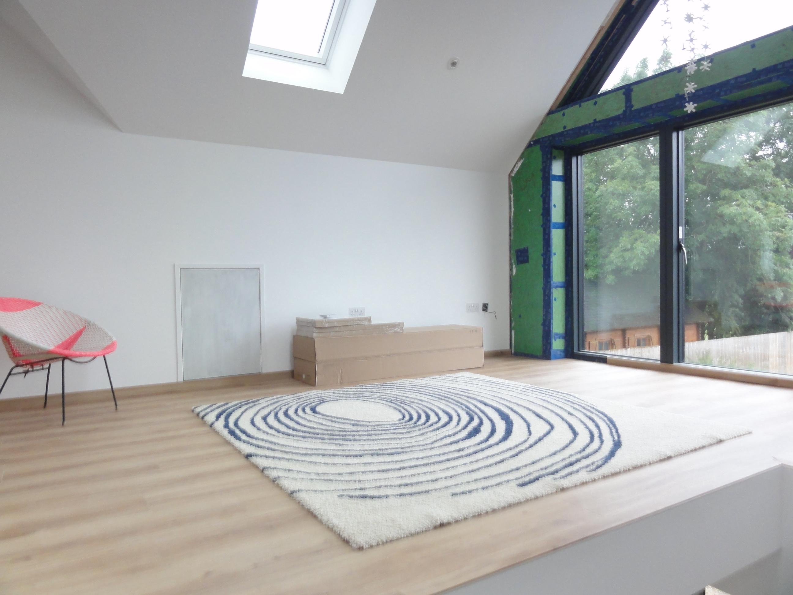

Oldsteel Posted January 22, 2020 Posted January 22, 2020 On 16/08/2019 at 13:20, Moira Niedzwiecka said: I wanted shadow gaps until I find out the cost. Also decided against for practical reasons. I have chosen Moduleo LVT. They do a small up stand as a skirting, so totally maintenance free, no problem when the floor is mopped. It looks great. Really happy with it. Struggling with OH over shadow gaps, she is set on them and I see many downsides, not least allowances for expansion per JH and the extra cost. I can't find the Moduleo LVT you refer to - the Moduleo website has no search facility. What is LVT - can you post a specific link? Looking for any alternatives to the dreaded shadow gap.
canalsiderenovation Posted January 22, 2020 Author Posted January 22, 2020 35 minutes ago, Oldsteel said: Struggling with OH over shadow gaps, she is set on them and I see many downsides, not least allowances for expansion per JH and the extra cost. I can't find the Moduleo LVT you refer to - the Moduleo website has no search facility. What is LVT - can you post a specific link? Looking for any alternatives to the dreaded shadow gap. LVT is vinyl tiles like Kardean, Amtico, Berryalloc, Moduleo and many others and some do matching skirting. https://www.moduleo.co.uk/products/accessories/standard-skirting/standard-skirting https://www.berryalloc.com/global/en/accessories/vinyl-planks/click-vinyl-planks So if you are having moduelo or any other brand of LVT flooring like those I mentioned you can have skirting to match the floor. Great if you're having wood effect LVT but as we are not this doesn't work for us so although I hate skirting we have resounded ourselves just finding one we don't hate as much!
Moira Niedzwiecka Posted January 23, 2020 Posted January 23, 2020 www.moduleo.com Download the Moduleo brochure & the skirting is on page 100-101. I have transform dry back.
